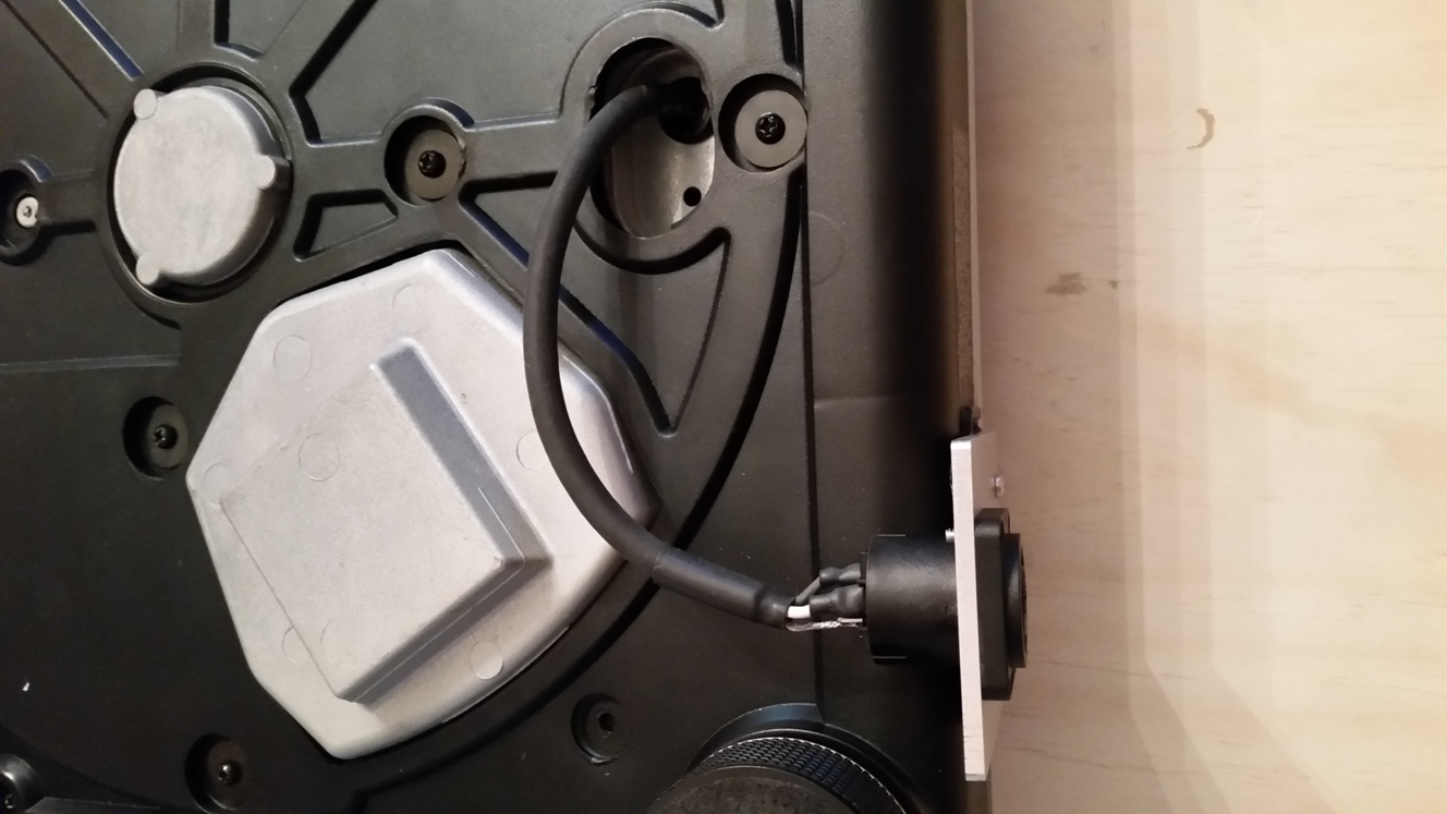

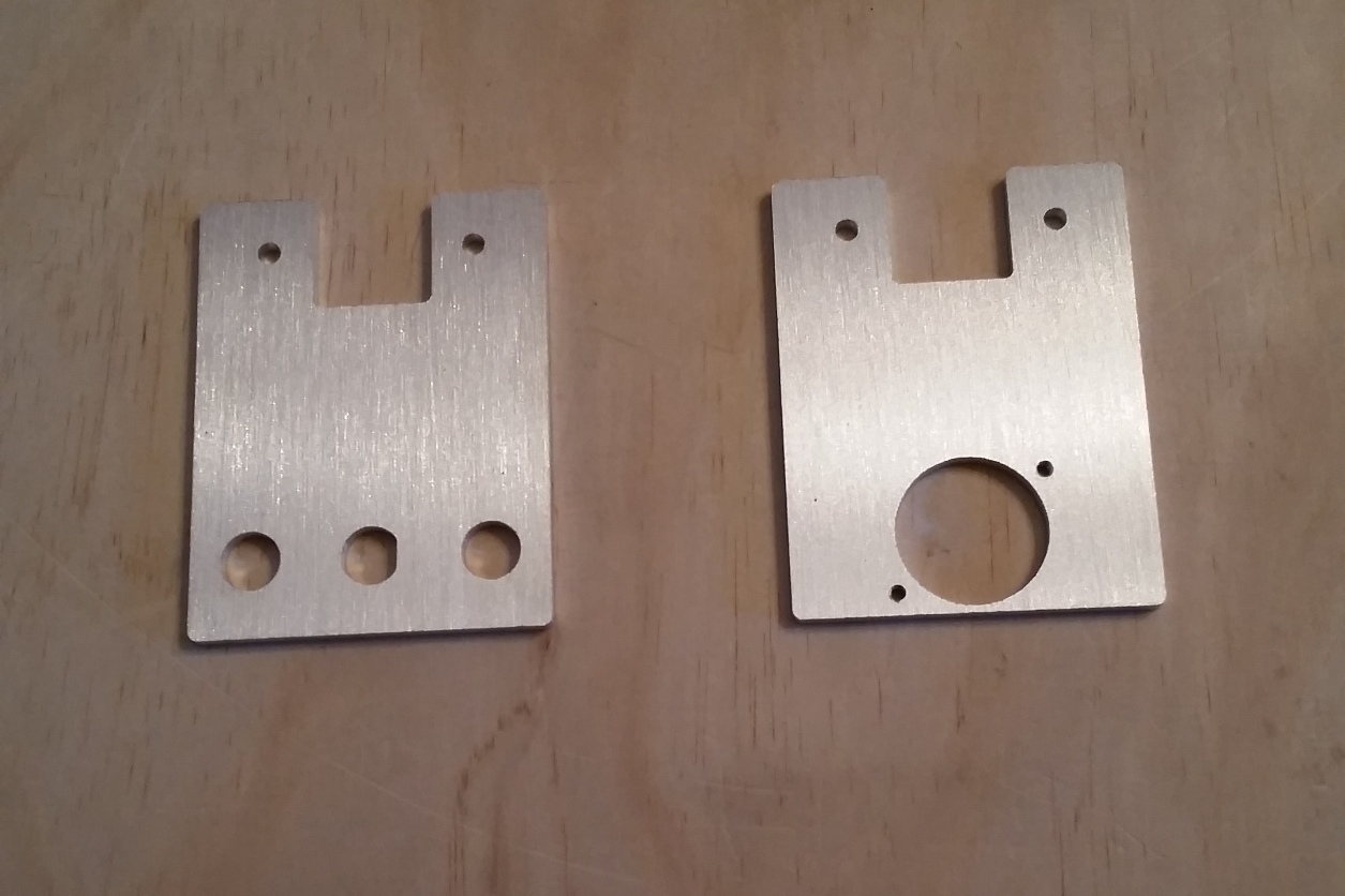

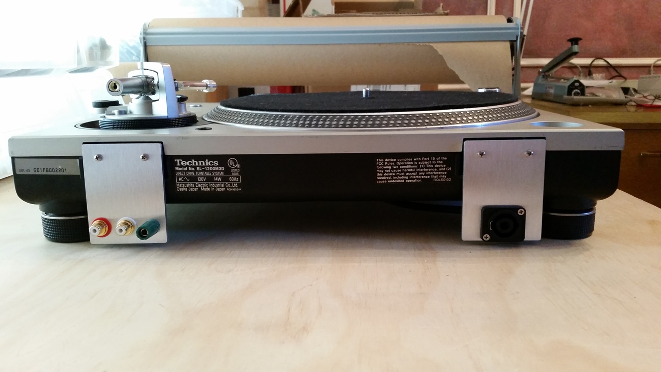

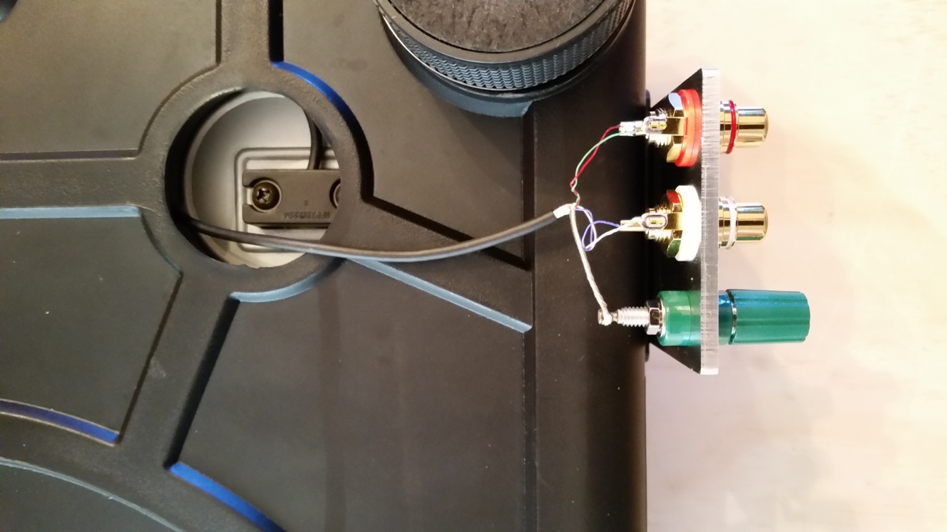

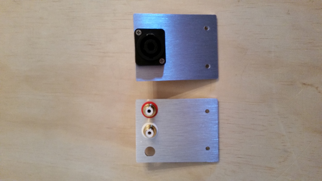

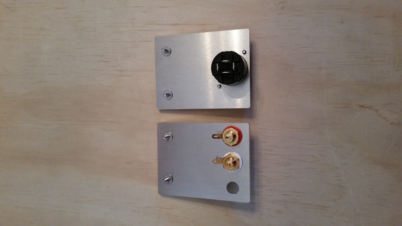

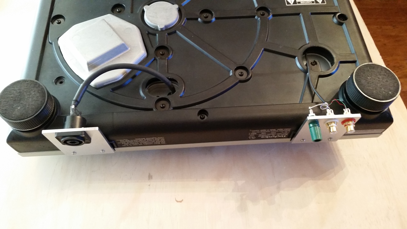

Finally a little down-time to get more info posted. I've had a few guys asking about the brackets so my apologies for the delay.
Below are some pictures of the external brackets we made for RCA and power connectors. Obviously, these are handy if you want detachable cords - I for one prefer not dragging along something to trip over.
The power connector used here is the Neutrik NL4MP, same as the one I used on the power supply chassis. RCA's are Cardas CTFA in a 0.375 inch dia hole. - fairly common. The third hole shown in the RCA bracket is for an insulated ground post. I didn't want to ground to the outside of the chassis through the bracket and through the internal chassis ground as well, hence the insulated post.
The signal wire coming out is Cardas shielded tonearm wire, it's just the shielded version of what I rewired the arm with.
You can see where the ground post is on one side of the RCA's. I've changed that and put it between the two RCA jacks. With it in the middle, the shield wire can be used as a "strain relief" for the 33 awg signal wires - seems like a better idea.
Dave - that looks great!
Fantastic idea using the hinge mount holes for something else. Very clever.
