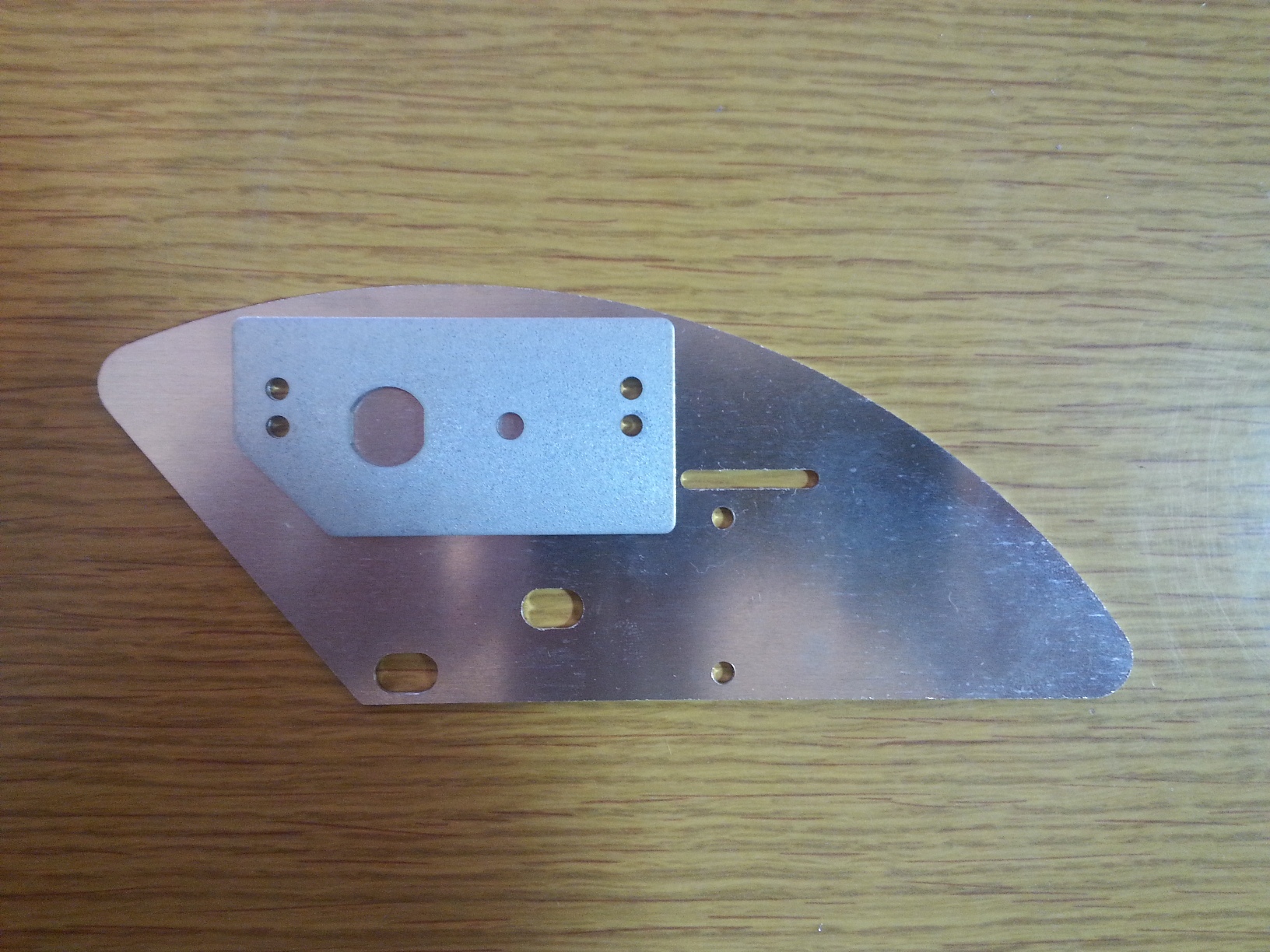

Anyhow, on to the brackets. With the transformer relocated to an external chassis, it's old cavity is a great mounting place for the reg.
By the way, don't wire it as shown here. I didn't bother to look at the bottom of the little Technics regulator board. It's not wired straight from IC pins to solder pads. I have another picture with the wiring fixed. You'll also notice I only used 2 filter caps for twice the original capacitance. I may add more later.
So this is idea #1. We've made this bracket to fit where the transformer was and can make mounting holes for pretty much anything that will fit in the space. I'm putting this out there to see if anyone is interested.
You can also see the other mounting bracket that's where the power cord comes in and where the regulator IC mounts. More on this shortly.

And here's the other bracket. This one is about as big as we can make it to fill the space. We can make it smaller in any pattern that fits your needs, but would like to make at most just a few variants. You can see the original cover plate for the power cord entry on top of our bracket which is about as small as we can go with this one.
As shown, I mounted the regulator IC on top of the bracket. If you're going to do this, you should also apply heat transfer compound to the bottom where it mates to the original heatsink "platform." This will help to dissipate the regulator's heat into the chassis like the original design.
Again, don't wire the regulator IC like this, two of the wires need to cross. Unfortunately I took these pictures before I fixed the wiring and attached the power cord.
I don't have an immediate need for this bracket, but it seemed like a good place for one. Maybe you have a different regulator that could mount here or you need a plate to mount a detachable power cord connector.
Just trying to see if there's any interest.

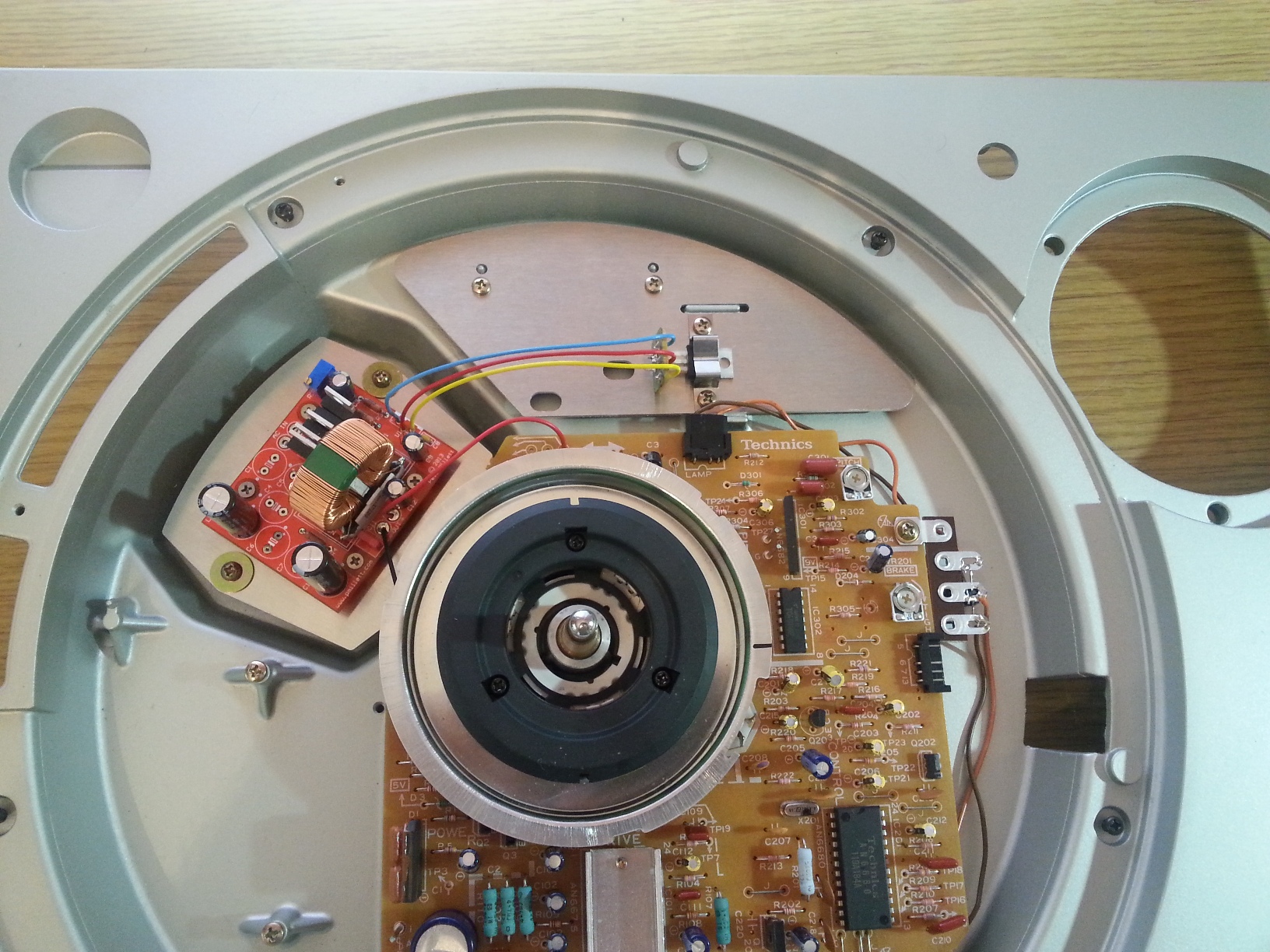

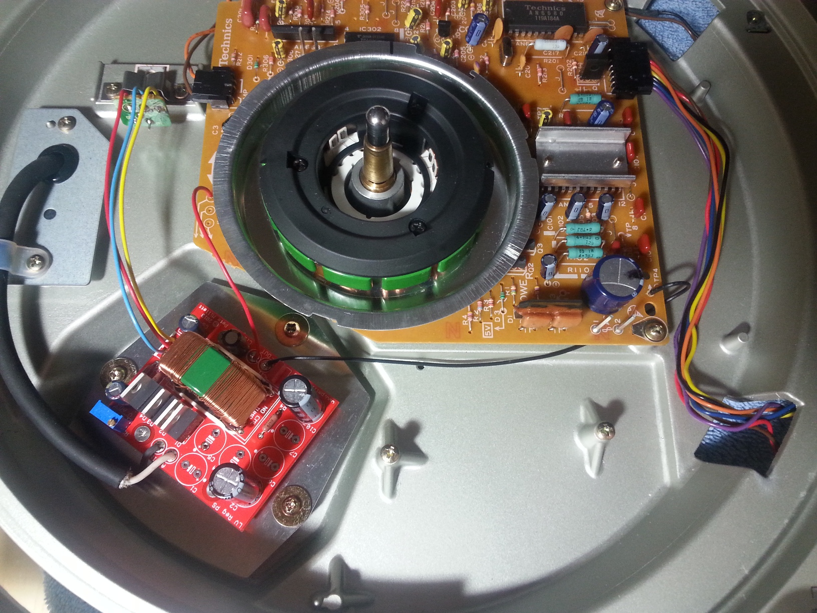

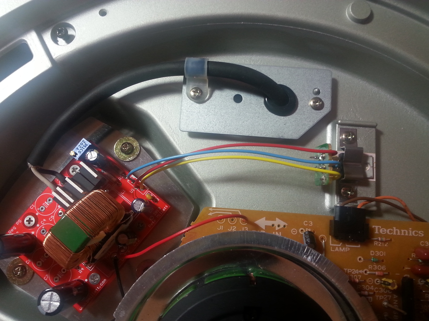

Here are a couple of pictures showing how I wired the regulator into the main board. This also shows the correct wiring between Pete's board and the regulator IC.
Except for removing the factory regulator, I left the main board alone since only a few components are still in circuit. There's no adverse affect on the PS and only minimal current draw from these components. Makes it easier to return to original condition also :)
Out+ off Pete's regulator board is wired to J3 where the original 3-pin regulator was wired. Out- is wired to a handy hole w/solder pad that's real close to the gnd point off the factory rectifier. Some of the other potential ground points are connected to this one by small traces and I wanted to avoid overloading those traces. Besides, it's also convenient.
More on the regulator later.

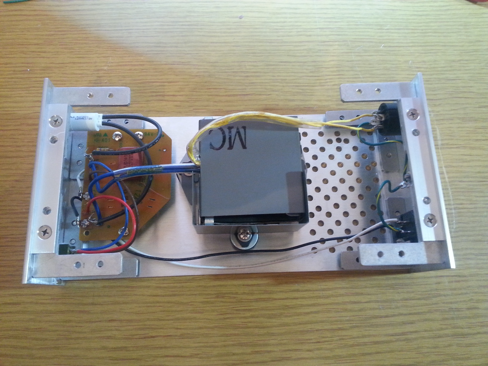

Yes, I used one of our cases. Below is a picture with the xfmr and factory circuit board installed. I'll get more pictures posted showing some layout options, hopefully this evening. I just got the chassis back from anodizing yesterday, so can also show it in the final form.
Pete Millett sells the PCB in his ebay store. He also has a full description with the board layout and schematic on his website. I copied his schematic and listed the component values I used and am checking with him to see if that's okay to post. I'll also get a BOM together for this higher voltage version.

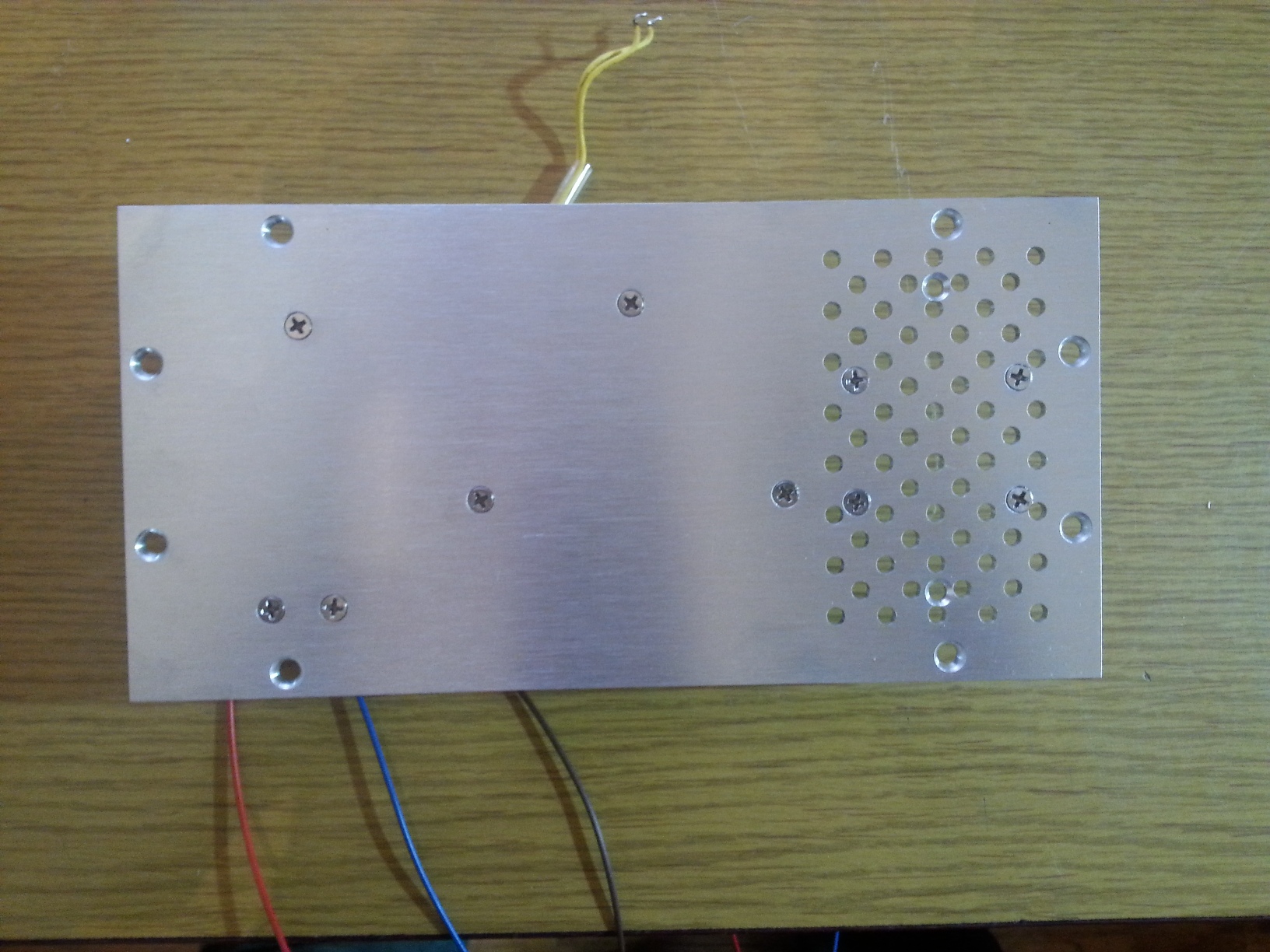

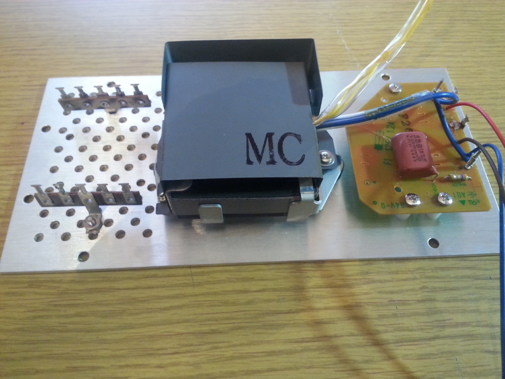

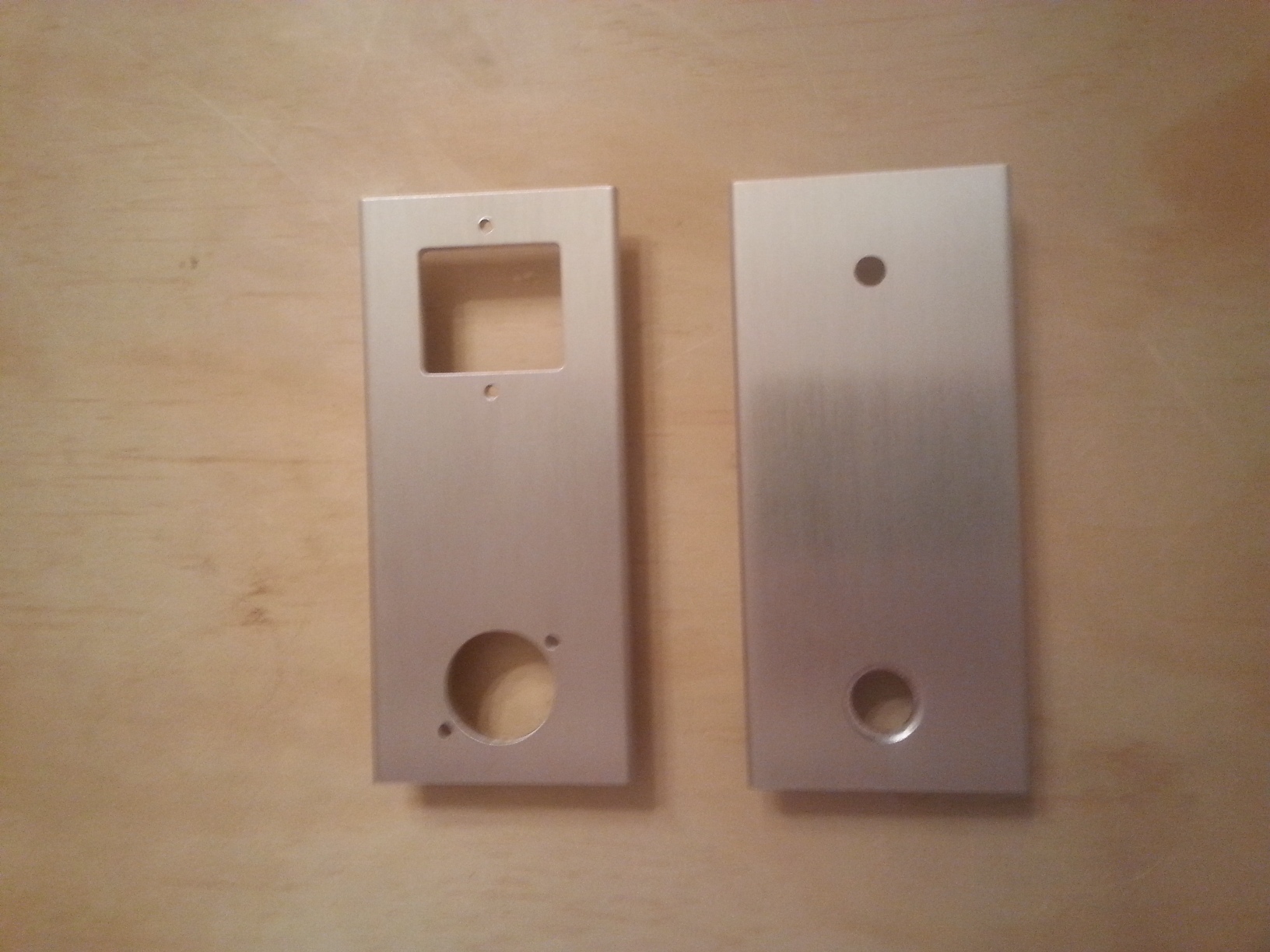

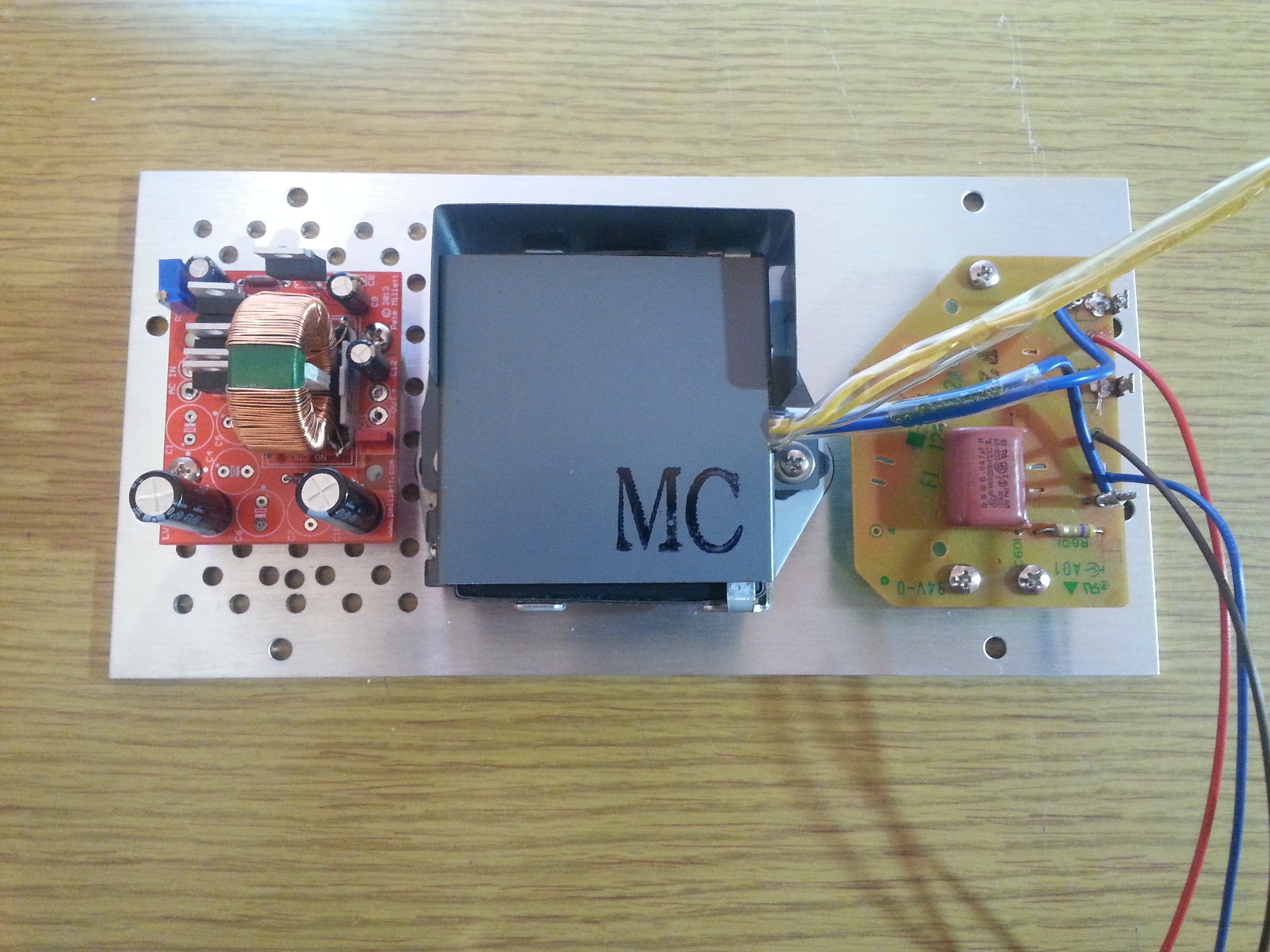

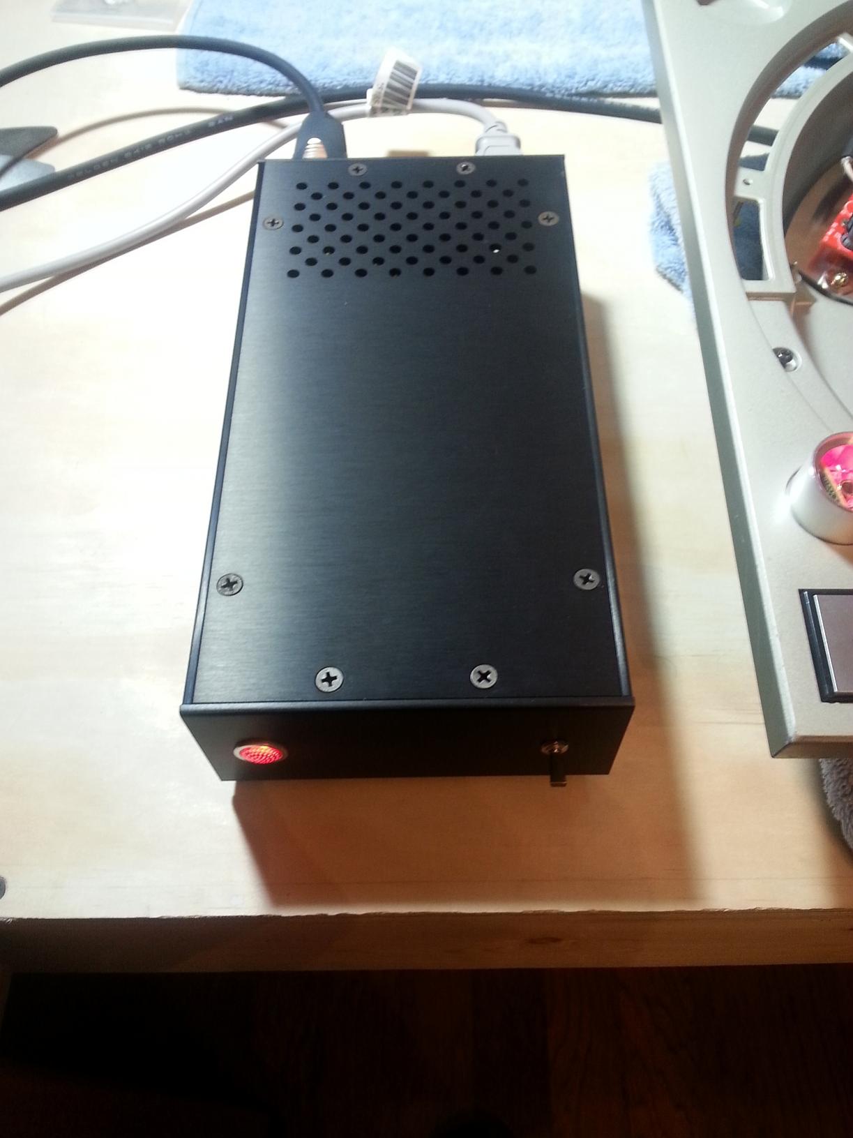

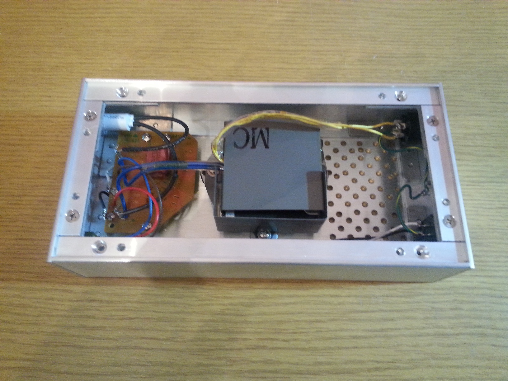

As mentioned earlier, here are some pictures of the external power supply chassis - or transformer chassis actually. The first picture shows the regulator board mounted in the chassis. I agree with the general consensus that the regulator should be in the TT chassis, so wouldn't necessarily do what's shown here. However, you could use one of the regulator boards for just the rectifier and mount that here. You could then use another board for the regulator and mount it in the TT. Fortunately, Pete sells these boards in pairs.
The second picture shows two terminal strips that could be mounted here for whatever else you want to do. We made all these holes on the CNC router based on how I wanted to put my PS together. We're open to other ideas and can change the holes for other layout options.
You can also see how the factory transformer interface board just fits in the chassis. I don't have a 110/220 version, so don't know how big that board is. From what I've seen, it looks a bit larger so we'd have to enlarge the case to fit or shift everything towards the other end.
The other pictures just show what the whole thing looks like and the last one how we machined the front and back for the connectors, pwr switch and light.
I'll shoot to get the schematics and BOM posted tomorrow.

I replaced the pop-up lamp with a 3.3V regulator and an LED. Since the regulator gets pretty hot, I stuck it in a heatsink which I glued to the plinth with some Loctite thermal adhesive. The Loctite is what we use on our heatsink assemblies and it's come in handy for several other things - I'll go look up the part numbers if anyone is interested. Anyhow, current draw with the LED is undoubtedly different than with the factory light bulb.
The strobe LED's I hooked to what used to be the power switch. This is just disconnecting the LED's from the circuit and is not disabling the oscillator circuit or the transistor that drives them. Maybe it helps reduce noise during those critical listening sessions, but I did it primarily just to turn the lights off and to make use of the otherwise abandoned switch.
