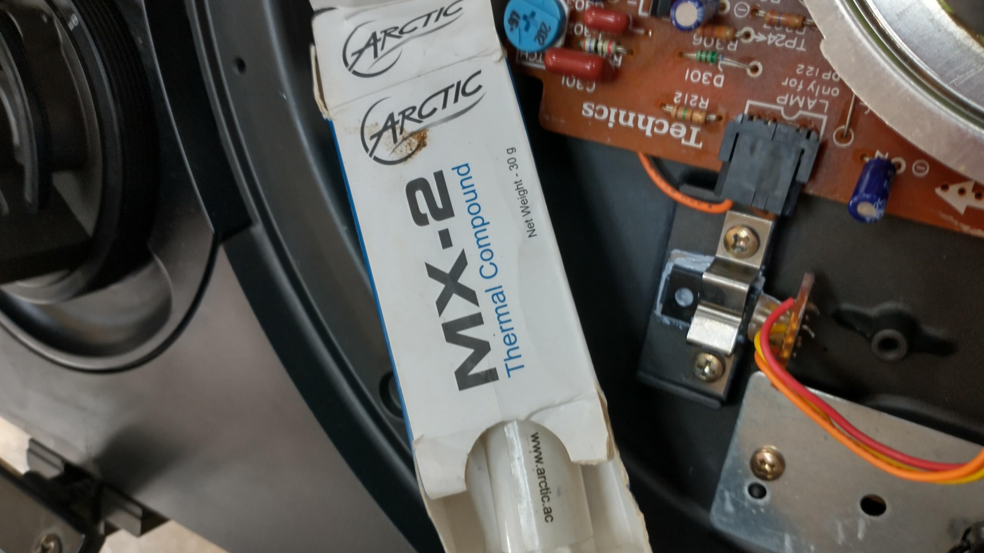

After obsessing about 112vs 120 db sonar on dacs and ignore analog I've decided to refurbish my two 1210 MK2 that have been in storage for more than a decade. After checking the tonearms for compliance, i decide they were worth the effort and cost. They used to be part of a mobile dj set on their prior life. So far clean, order mogami RCA cables and goring , the 10 thick matt, new stylus, oil for the spindle and thinking about the thrust plates from kab.Plates are half worn.
In the power supply , i have cleaned and applied fresh paste. Not sure if it will make any difference, but it make sense to do it .

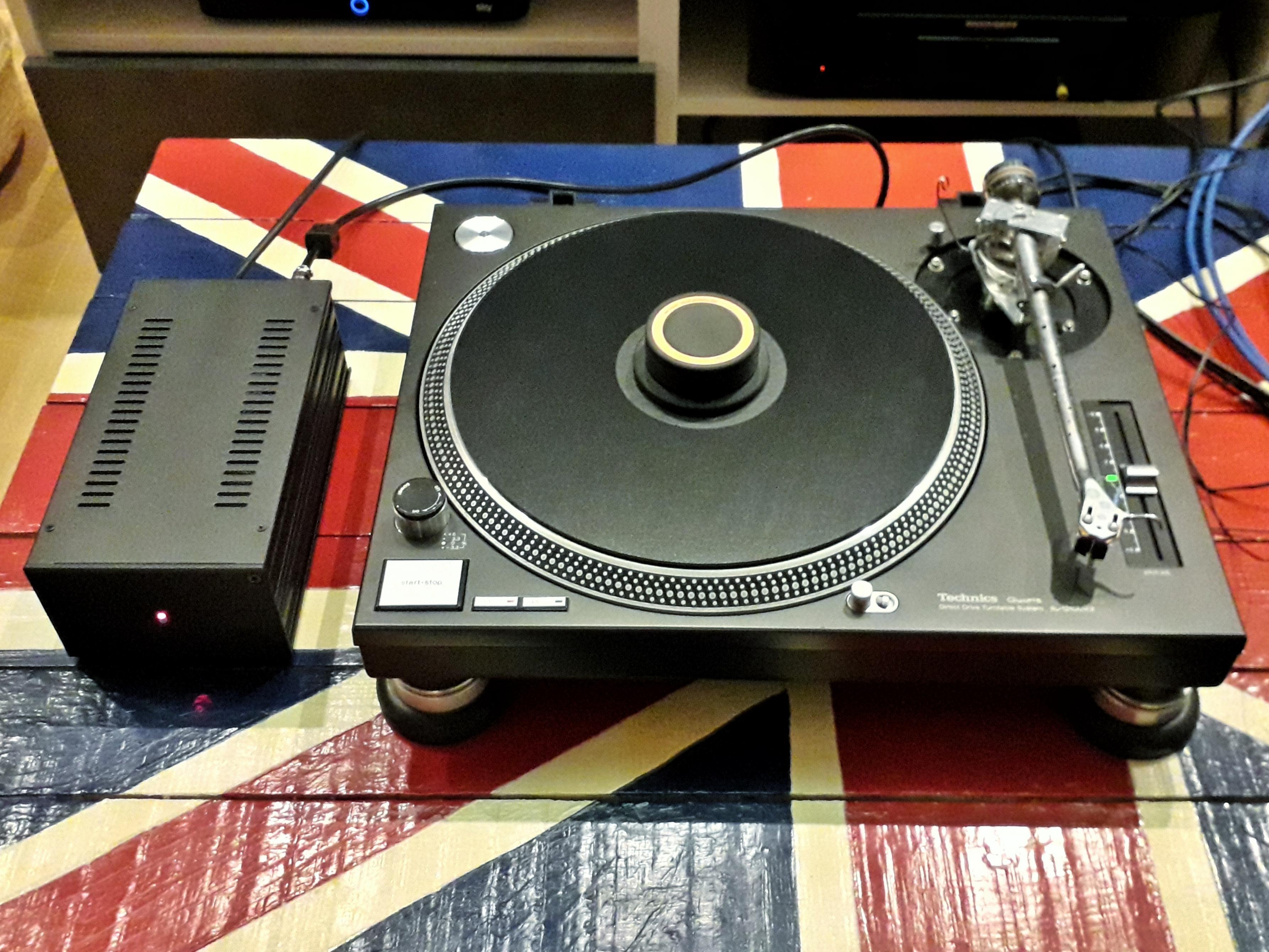

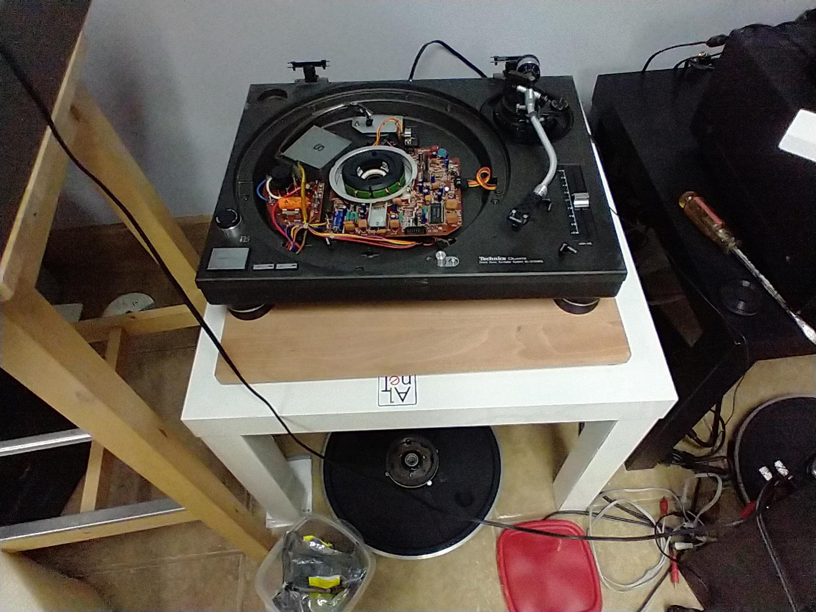

My feet are gone, unless they are screwed all the way up they wobble to much. I have order one of the o original thick rubber mats but will consider either the cork or the acrobat. I have been curious about the power supply mod since I heard Nelson Pass describe his "testing" system: a stock 1200 with the power supply mod
Regarding the cork, any in particular? 6mm like the original 1210 MK2 rubber. Some people say use the original thin mat in top of the cork. I'm confused.
Before I get new feet i need to buy a stronger table. I don't think an Ikea lack with an Ikea butcher block will cut it.

Regarding the external power supply, i am going hold untill all the routine maintenance a is done, folding stylus, matts, preamp and desk. It hurts the idea of not being able to take it back to stock, off felimg. Tempted to get a control board and an smsp to mod and keep all the original preserved.

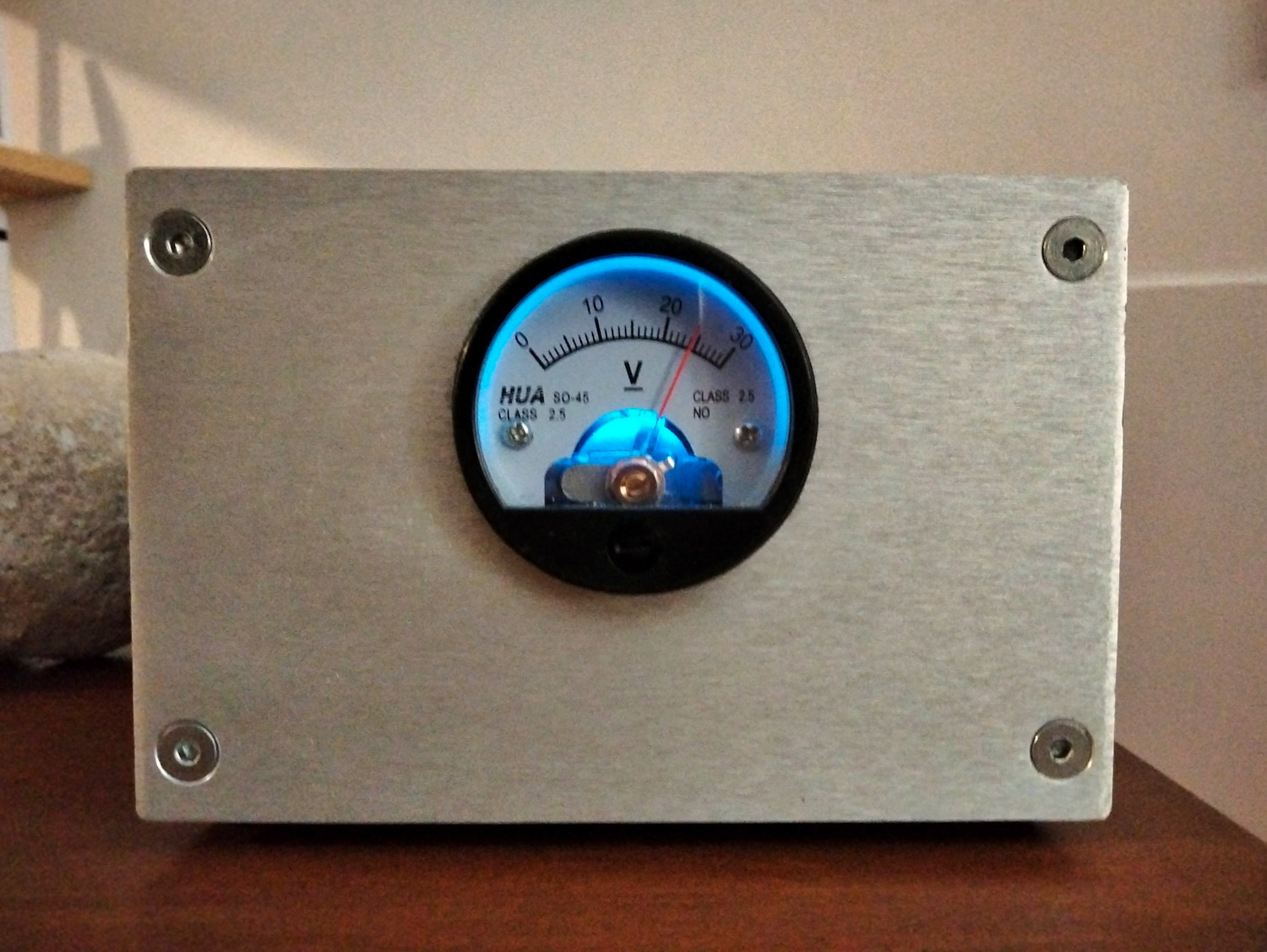

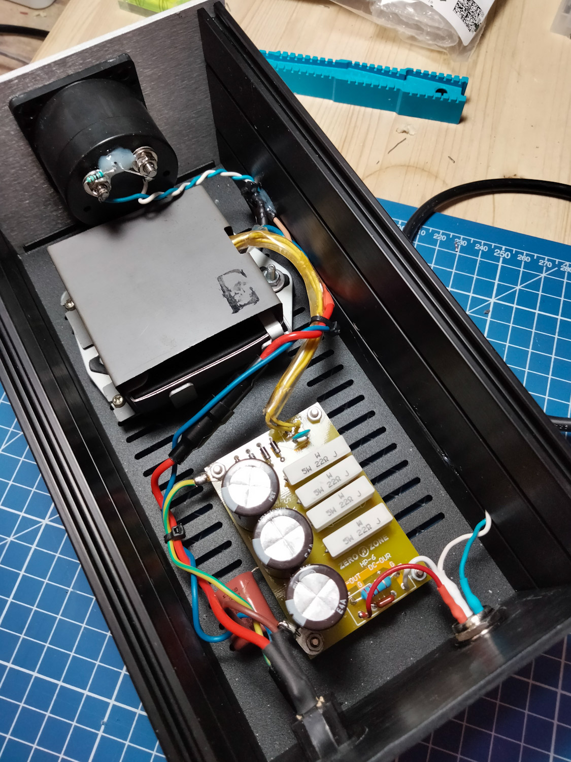

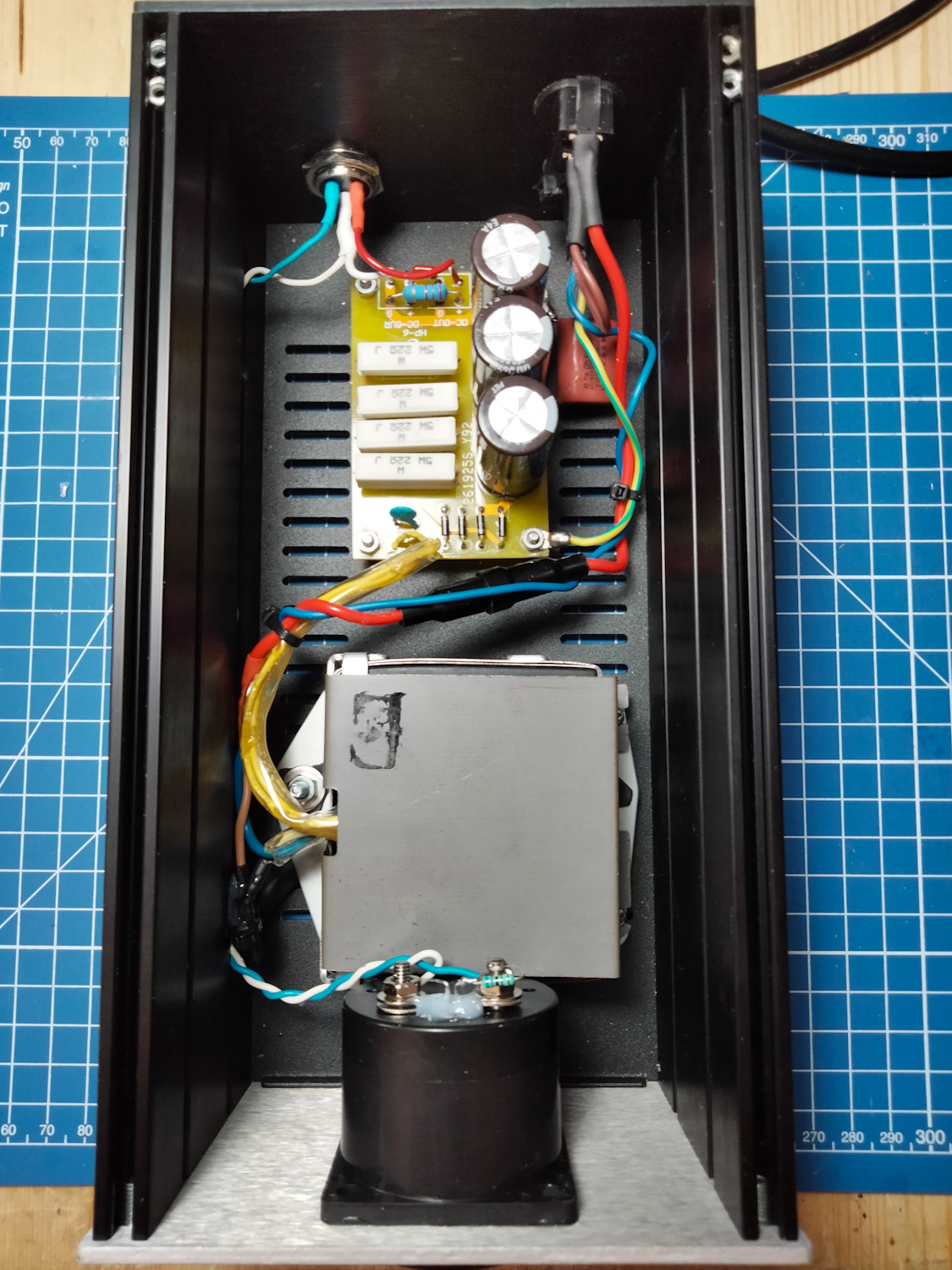

Doing anything to the internal regulator is squarely in the “just because you want to mess with something” category.
The external PSU is the mod with the single biggest increase in sound quality. It’s a “must do” in my opinion.
Tonearm takes a bit of a leap of faith, but totally worth it. Just go slow and enjoy the process.
