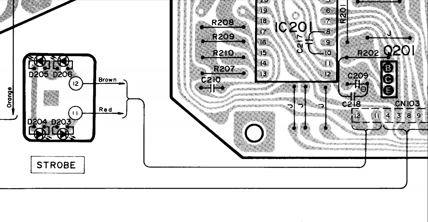

Glad to see you've made some progress. Your image differs from mine: you have red and yellow wires on your transformer, where mine are blue and yellow. The secondary is yellow on mine - but you've already figured this out.
To answer you question about a fuse: YES!! ALWAYS use a fuse. You don't know what can go wrong and without a fuse, it can always get worse!
