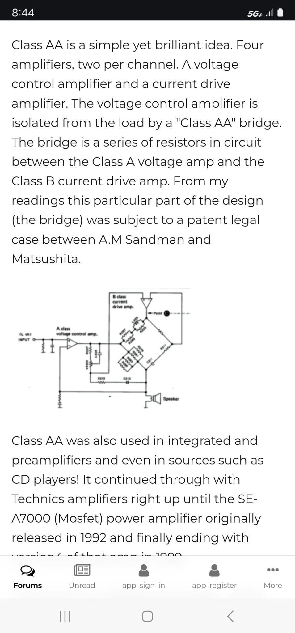

In a nutshell, and if I'm not mistaken, Synchro Bias (a synonym for the later NewClass A) is a classic EF3 topology. And this topology follows the Blomley approach more closely, it has a small number of clamping and switching diodes.
This concept can also be described as ingenious, because the output stage never switches off (and/or on). Unfortunately, we DIYers cannot replicate this concept very well, because we simply don't have the right diodes. If you want to try something similar - the emphasis is on similar - then the only option is the Steve Dunlap concept called KRILL. The essence of the definition for both is that both complementary players never switch off -> this behavior can also be justifiably described as a type of A operation, but only correctly in push-pull mode -> and this is what is present, hence new Class A.
Class AA
is not synchronous bias, this term also fits better with other concepts; this was probably one reason for the concepts being renamed so soon - the obvious clamping diodes were already missing in the later implementations. Nevertheless, the technology used in the SE-A900 or the A1000 is more exciting and unfortunately also more vulnerable; in theory the two power amplifiers could also "switch" (on and off).

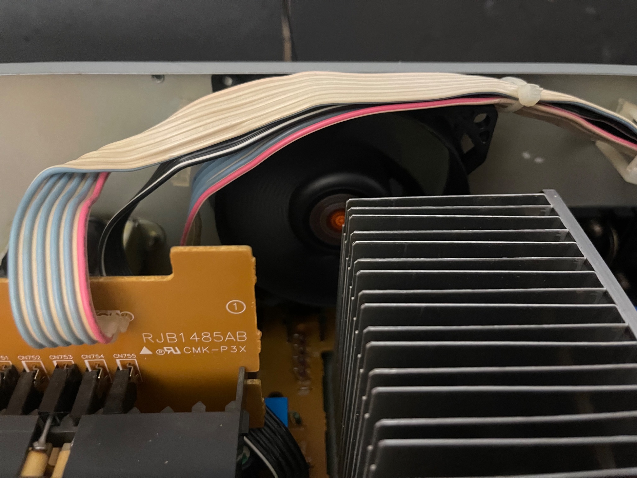

thanks for the good answers my technical background is at beginner level but i am still learning but changing capacitors and soldering is no problem. but today i got my second a900s and it gets as hot as my first one, same with my a800s...

When does the fan engage? At idle, at high power (into the speakers), is it on all the time, or...?

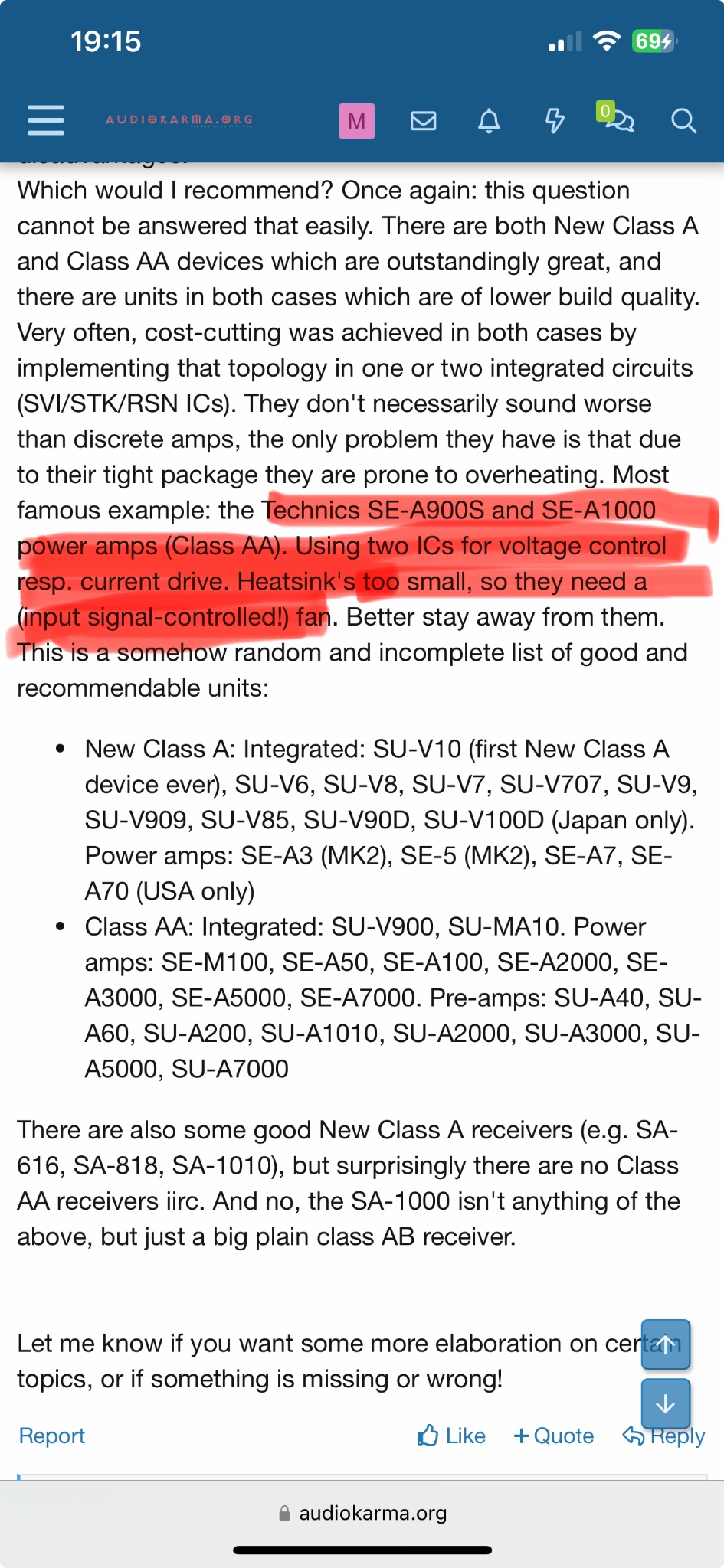

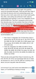

Found this on audio karma : se the marked partThis is quite interesting, and at the same time strange, because then' the hybrid block of the current amplifier would probably have to contain two parallel MOS source followers with quite a large quiescent current... strange, very strange.

Thanks, the fan control is interesting.
Not temperature dependent but assuming that if the input signal is high it has to cool.

I don some testing, I replaced the original fan whit a 80mm noctua computer fan driven on a external power supply so it runs all the time and cranked it the volume to where I use to listen and after 2 hours the temperature on the heat sink is 35c… now i only have 1 problem and that is if I turn volume up to the point where the fan supposed to turn on the amp going into protection (cos it don’t find the original fan) is there a way to make a dummy fan load?
The SVI3205B current amplifier is definitely a BJT Standard EF. According to the original Class AA doctrine, its power dissipation should not be significantly greater than 2 * 2.5W. 5W does not generate 60°C at the existing heat sink in idle mode. The left banger, the RSN6000B with its MOS fets will be the culprit. My guess is up to 2 * 20W (completely unnecessary) power dissipation. If this is really the case, then the temperature found is actually the normal state. With the maximum power output of 2 * 70Wrms (into 8 ohms), i.e. 140 to 45, this would be quite atypical.
