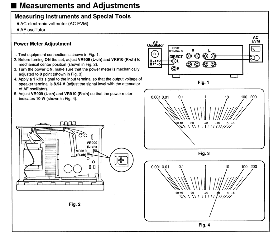

Can you read the corresponding peak watts from the frontal power meters and post them?

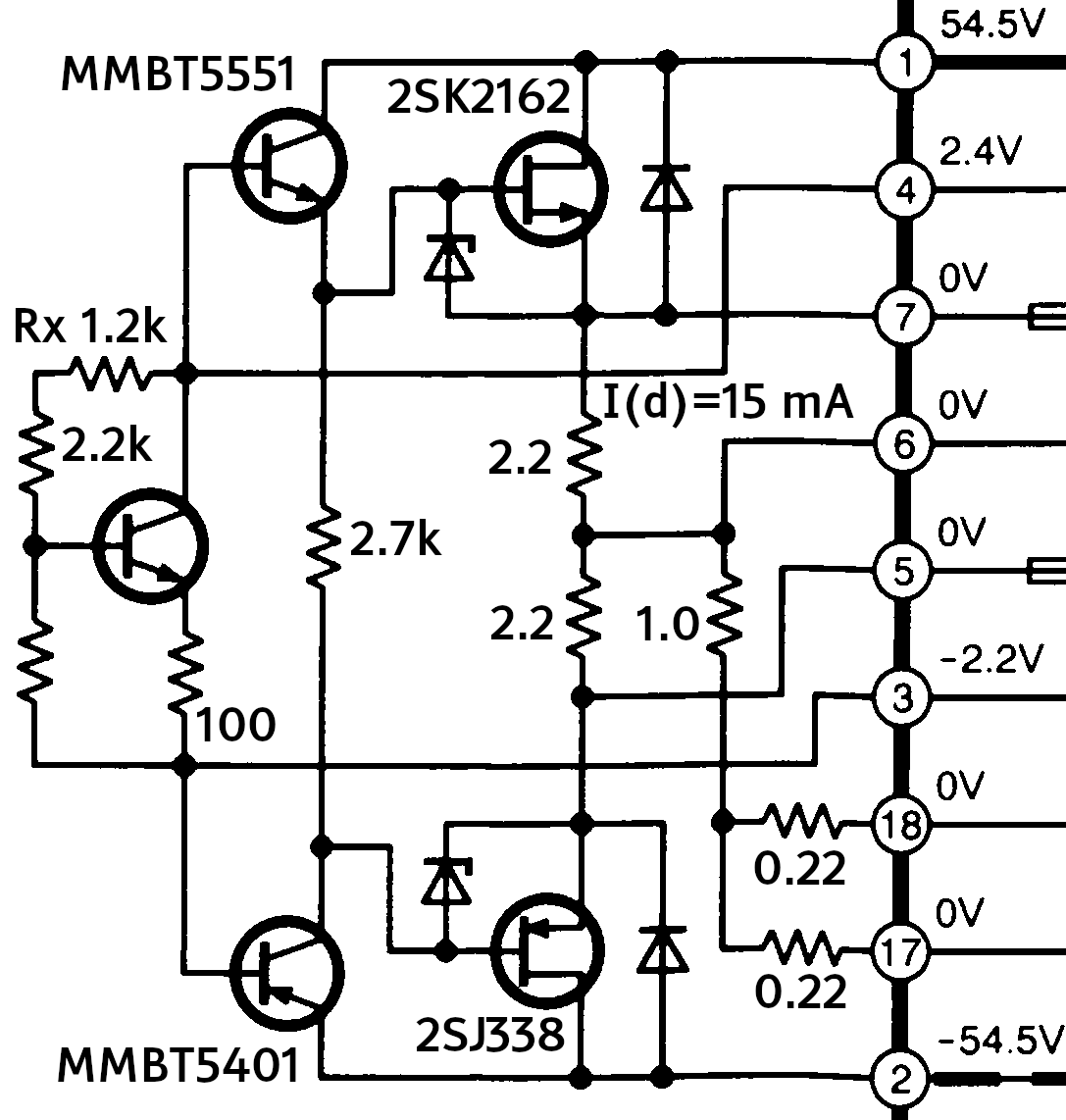

The SVI3205B current amplifier is definitely a BJT Standard EF. According to the original Class AA doctrine, its power dissipation should not be significantly greater than 2 * 2.5W. 5W does not generate 60°C at the existing heat sink in idle mode. The left banger, the RSN6000B with its MOS fets will be the culprit. My guess is up to 2 * 20W (completely unnecessary) power dissipation. If this is really the case, then the temperature found is actually the normal state. With the maximum power output of 2 * 70Wrms (into 8 ohms), i.e. 140 to 45, this would be quite atypical.

In idle mode, the heat sink should therefore not get more than slightly warm to the touch. With a power consumption of 10Wrms, for example, this is no longer the case.
