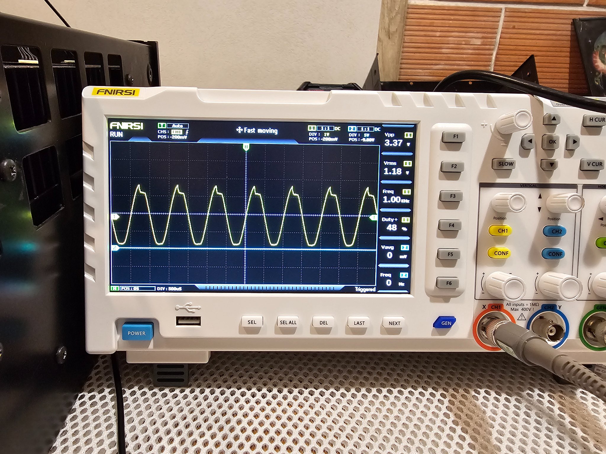

I have a problem... I recently visited a technician who has all the necessary instruments to properly adjust amplifiers, distortion analysis, etc...
Basically, although the amplifier works, it doesn't function correctly. Specifically, on an 8-ohm load it reaches 200W without clipping — that's fine.
However, there's some sort of distortion — the 3rd harmonic has an elevated amplitude. The clamp trimmer doesn't respond — neither on the left channel nor the right.
When we turned it, as per the manual instructions, nothing happened. The distortion remained the same.
Later, we discovered that the clamp trimmer actually affects the bias current. When turning the clamp trimmer — surprise — the bias increases.
But we can’t lower the bias under 40 mV per transistor when the amp is warmed up.
Increasing it is somewhat possible though.
The second, and even more serious issue, is that at 4 ohms, distortion starts appearing at around 25W output.
We noticed this with the technician using his equipment, and I’m observing the same at home.
At 25W into 4 ohms, a waveform deformation appears — some sort of distortion.
What could be causing this strange behavior?
Has anyone had a similar issue? I don’t know what else to do anymore…
Which component should I check?

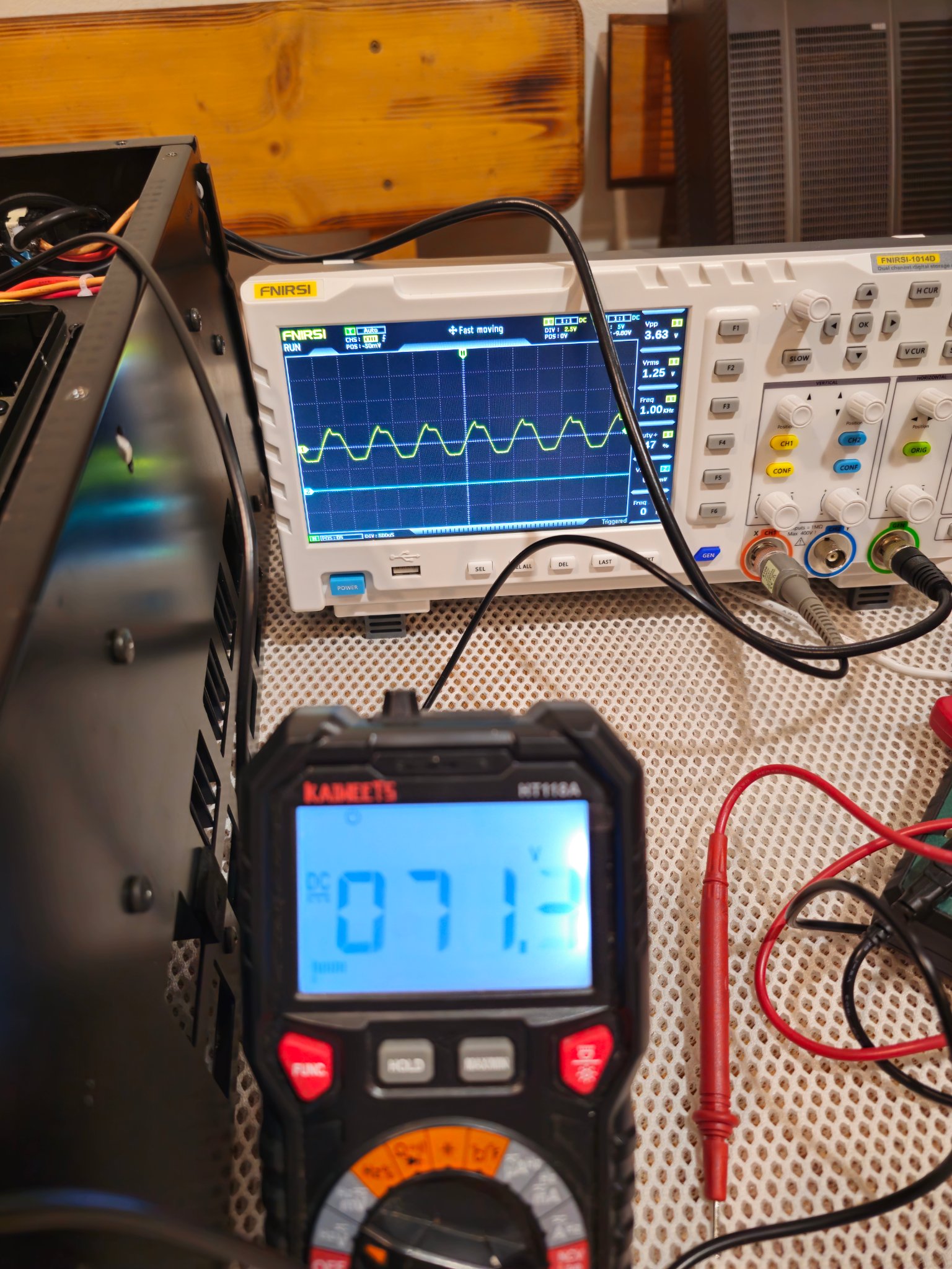

If that scope shot is showing the input (the generator output) then something is effectively modulating that signal. Ground problems maybe. Impossible to say what is going on without seeing it for real.

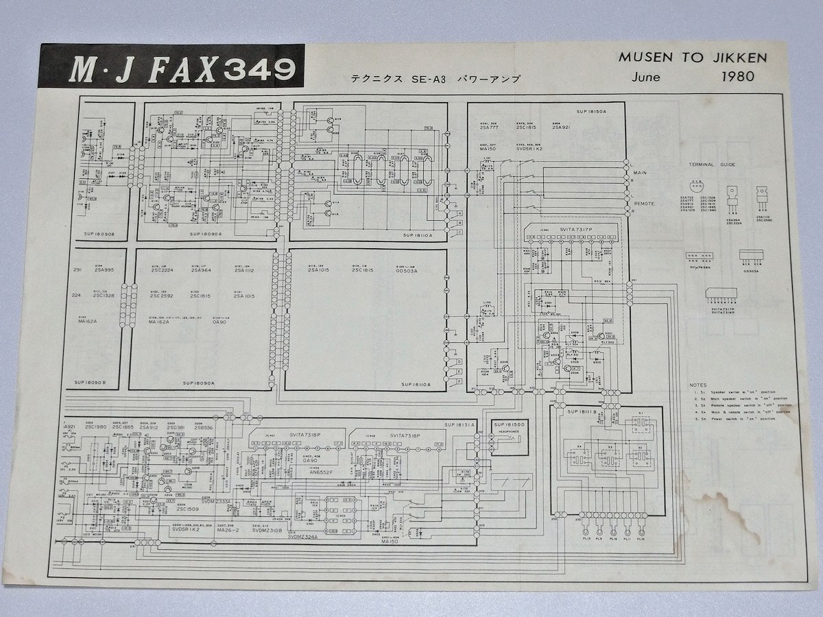

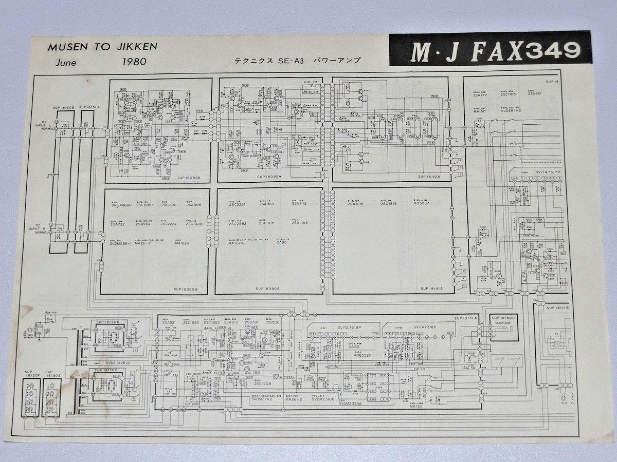

I can't come up with a full and readable circuit for this. There also seems to be two versions of this amp.
That's right. In Japan, they sold the version I have, which is 100V, and near the main capacitors there's a small circuit board. As you can see in the picture, it has one rectifier and one thermistor. The European version has all sorts of components crammed in there. The Japanese built a different version specifically for their 100V market.
However, there's no manual to be found anywhere.
I would like to buy the manual — I’m willing to pay 50€ if necessary — but I can’t find it anywhere. How is that even possible? Should I write to some Japanese technician?

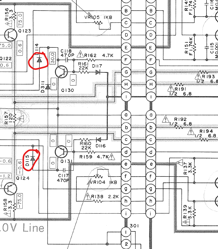

The distortion you show actually looks like it might be some form of current limiting coming into play.
1/ Does the distortion disappear if you remove the load?
2/ Try removing these two diodes and see if things improve.

Are you sure it won’t cause any issues if I desolder them?
I wouldn't mess with the bias diodes but I'm not an expert either.
After I measure the PSU voltages everywhere I would follow the signal to see where it does get distorted. Is it in the preamp, driver board or elsewhere?
They look to be a standard way of connecting the over current protection to the driver stages. Normally they do nothing and the transistors that drive them (Q130 and Q131) also normally do nothing.
Having said that there are no guarantees but given the amp works and you have little to no bias current I can't see any issue.
Where exactly do I measure the voltage once I disconnect those diodes?
You just see if you can get past that point you showed on the scope where distortion set in. Does the lifting the diodes remove that distortion and allow more output.
