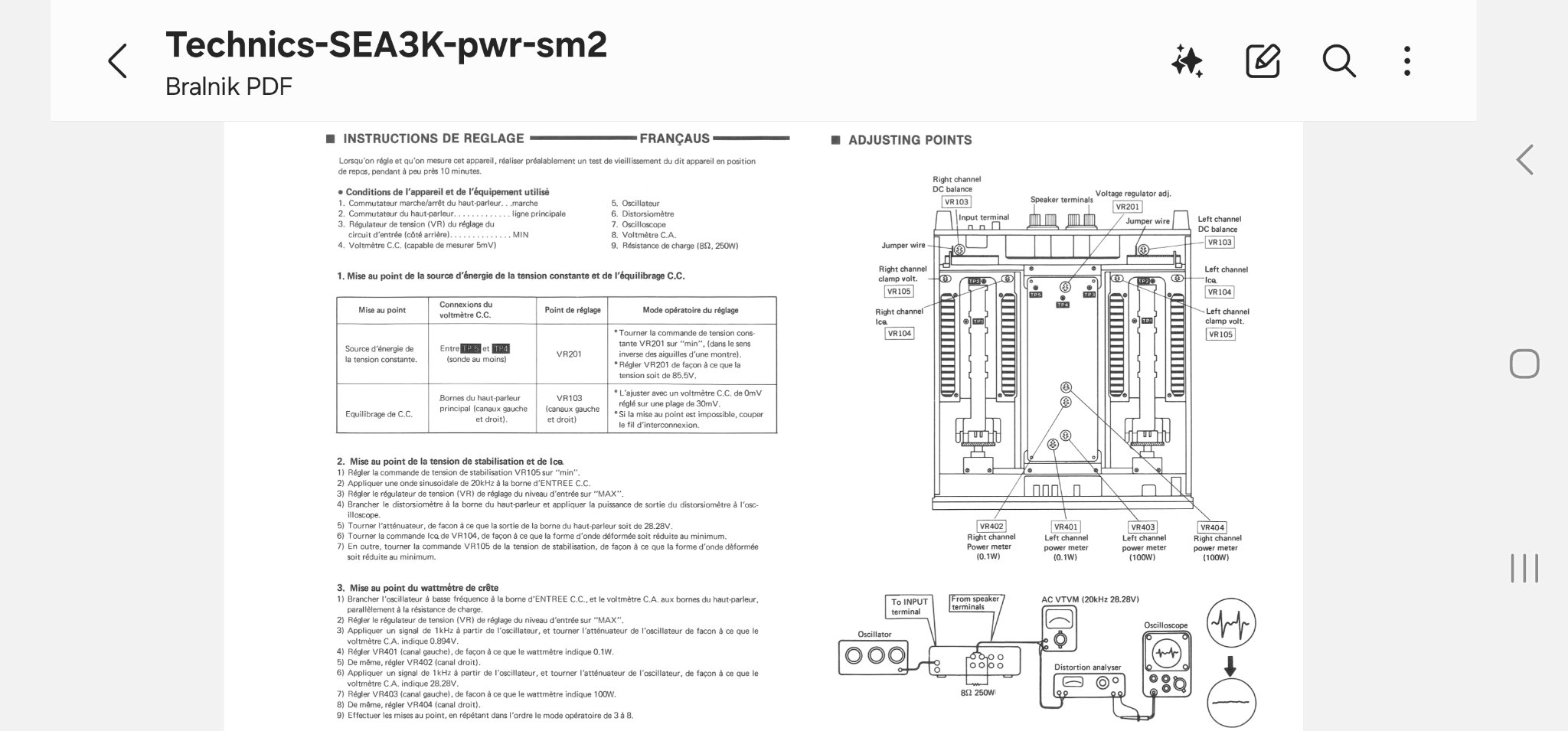

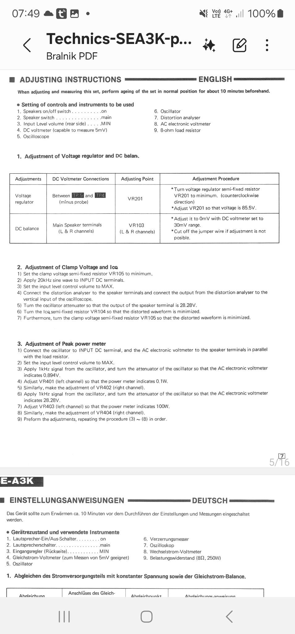

So how should I set it up to make it work optimally, as the factory recommends? The potentiometers ICQ and Clamp Voltage are a bit confusing... I don't have a distortion meter, but I do have an oscilloscope and a 200W dummy load.
With this amplifier, it seems that the idle current (bias) isn't adjustable??? Or am I mistaken, hmm.
It's not entirely clear to me what the clamp voltage is and how to set it... Ugh... I might have to go to a technician?
Here are two pictures from the service manual...

Icq is bias current adjustment. Without a distortion analyser you can not set it according to the service manual, all you can do is aim for the theoretical setting that was mentioned back in posts #7 and #8. You won't hear any difference even if you set it much lower, and lower is better for heat dissipation and reliability.
You will not see any distortion on a scope alone so I would just leave the other adjustment as it is, particularly if it has not been altered.

For a start set the Iclamp at the middle and adjust Icq accordingly. You'll need to wait like 20 minutes for the current to settle. The inside part of the heatsinks will be warmer (less ventilation + PTs warming up) and you'll have different idle current readings there.

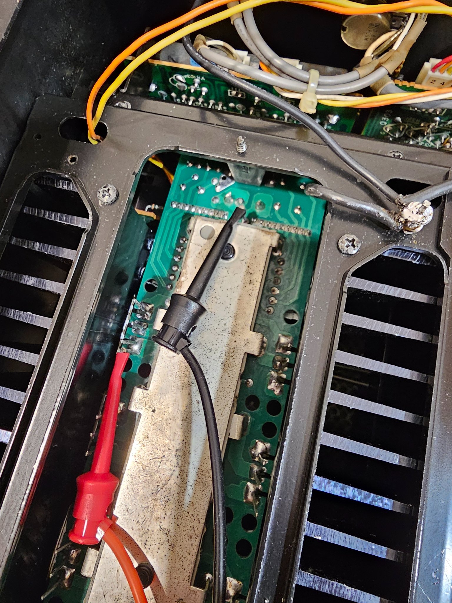

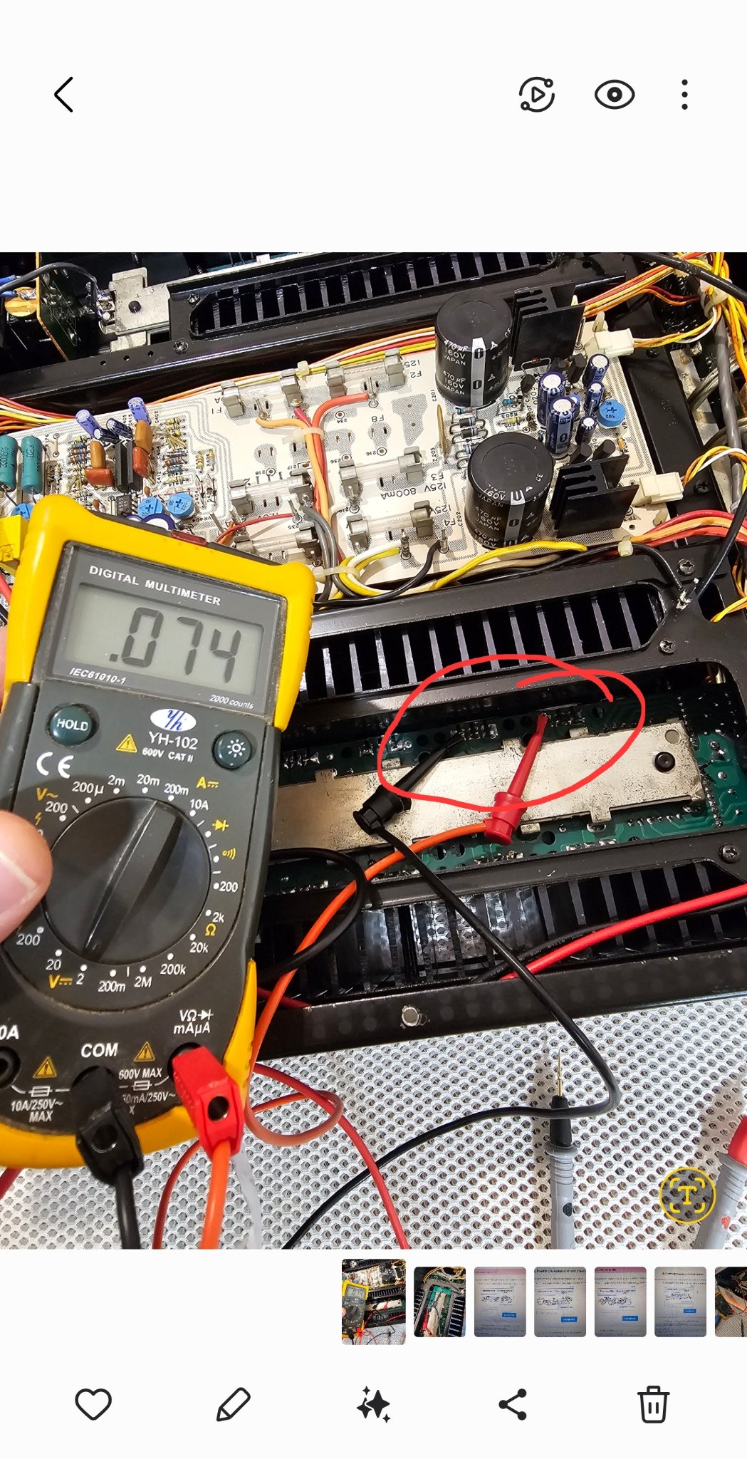

am measuring the bias here. Is this correct?
Take a look at the picture

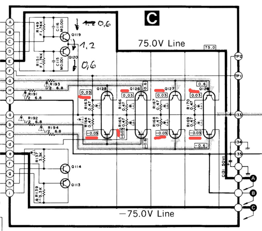

"I have adjusted the PNP and NPN to 60
millivolts, approximately 30 millivolts per
transistor.
I managed to lower the left channel to 60
millivolts, but I couldn't do the same with
the right channel.
The trimmer reduces it to a maximum of 75
millivolts,
I'm not sure if these are the correct values
as specified by Technics
I read in a thread on page 7 that someone
adjusted it this way.
Could the trimmer be faulty, or is there
perhaps a resistor on this board, which was
previously operational, that is 'sleepy'? 🙂"

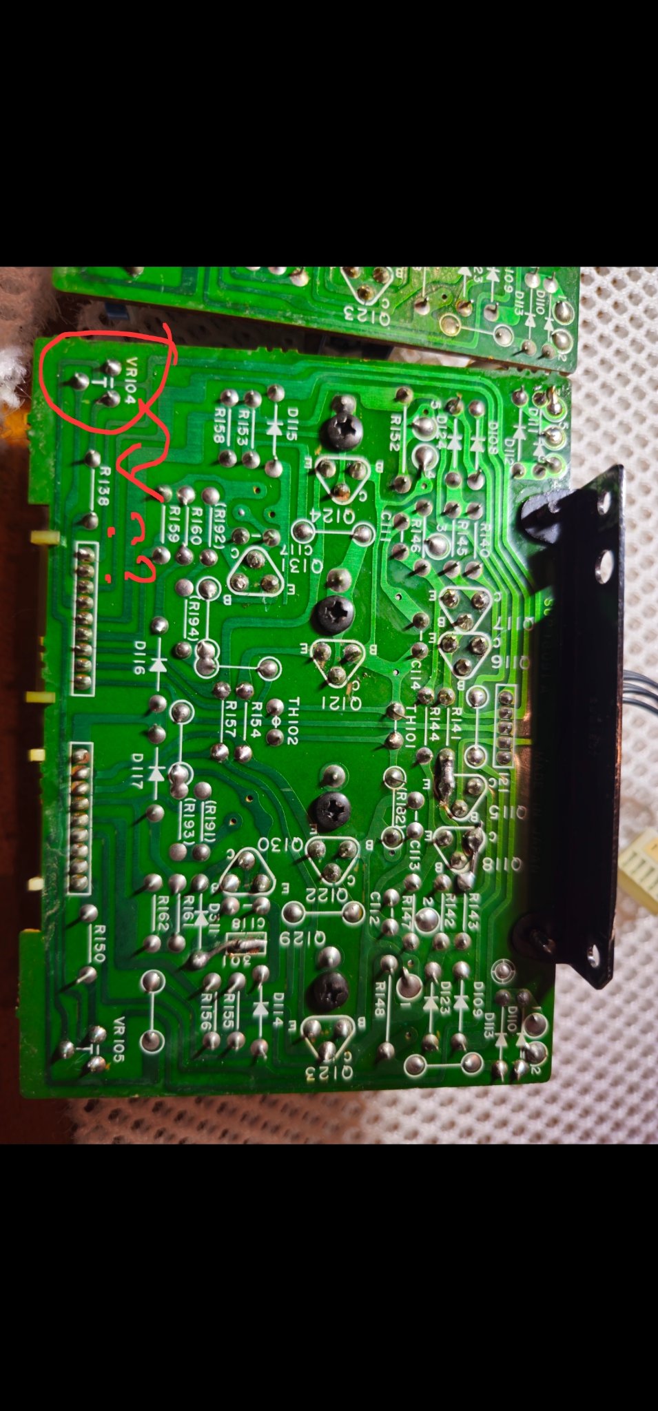

I just need to figure out why I can't reduce the bias on the left channel below 80 millivolts once the amplifier has been on for more than 30 minutes… meanwhile, the right channel still has some room on the trimmer to reduce it further.
On the left one, the trimmer is turned all the way.
Does iClamp also affect the bias?
Yes yes.. , well that’s the one I circled in the picture, the top post..
I’ll measure it to see if it really shows 2.2k ohms..
But what if the fault is in the sensor transistor? Those two small ones that are next to the main board near the possible transistors.
Q113, 114, 119 and Q120
All the transistor packs need to be of the same rank (same gain and forward B/E voltage) per channel to ensure equal current sharing. If you fit mixed ranks you will find the bias current different for each pack.
