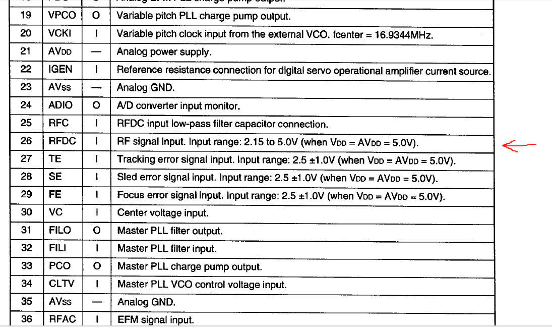

After looking over the manual data, I am still unclear where to measure the RF signal. Is there a test point? Where do I look?

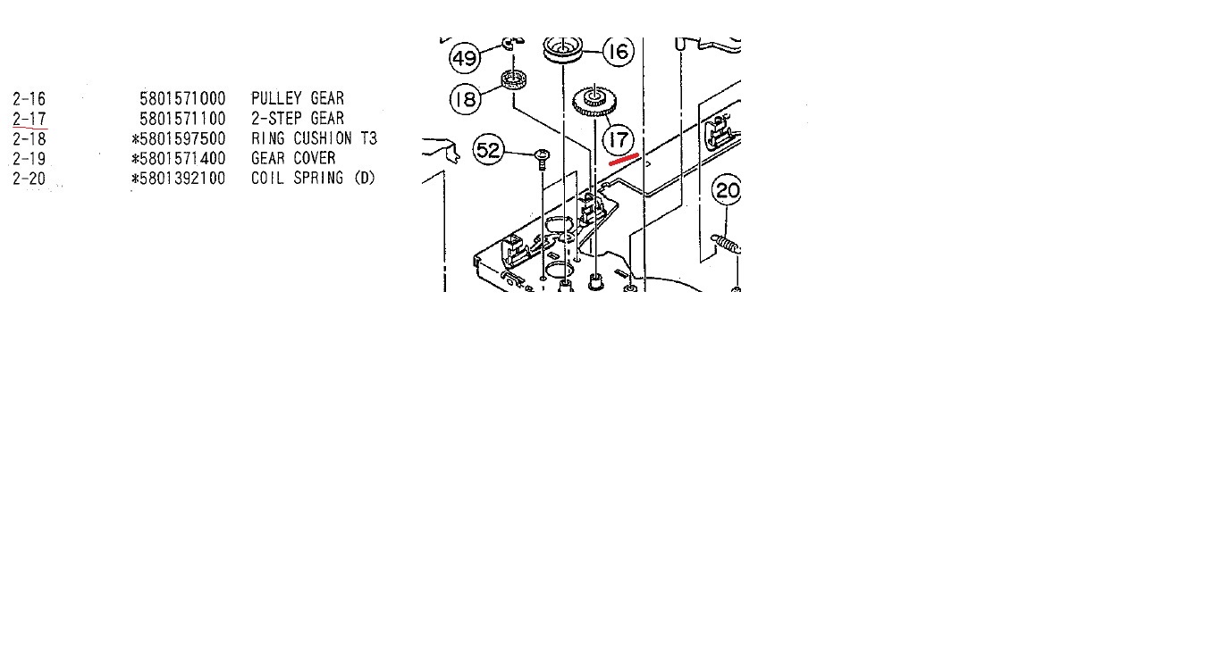

The gear is now alternate PN: M02646000A Gear 2-step VRDS-9/ VRDS-7

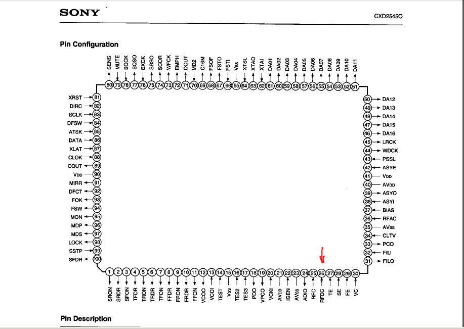

Can you tell me what is the first IC, the RF amplifier, which receives the cabling from the KSS pick-up?
Tried to find a service manual for your KRELL, and so far no result.

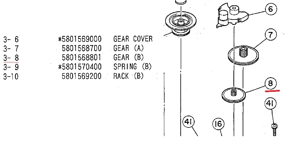

With regards to the gears, please find enclosed the numbers and cropped images for them. I know they are supplied by TEAC America, the problem is that TEAC does not agree to ship outside the U.S.
I once bought a pair, two years ago, and a friend ordered the parts for me, then sent me the package to Bulgaria after receiving it in Reno. So, a complicated situation here.
I am not in a hurry to buy second set, just would like to have one at hand, if something happens with the transport.

I soldered 30g kinar wire to pin 13, 15 and 9 for ground. At first nothing worked and after I disconnected the scope, I noticed the disk reading. !!! I forgot to float the scope ground. oops Maybe I shocked it.. or got lucky. It is playing, but seems to skip more as the track # increases. Now If I can just get a look at the signals before the optical swap. I am getting - 2.9 V p on pins 13&15 at 60 Hz. I wouldn't mind a little practice before the swap. The new KSS213C arrived today. Shall I just instal it and not worry about the signals?

Hello!
Do not leave the wire soldered there, as it might bring interference in the signal path.
Better option is to trace where pin 26 is connected, and take measurements from there.
Of course it will work, that is its purpose.
The question is, does it play music, apart from working? 🙂
Hello!
