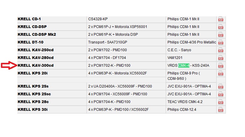

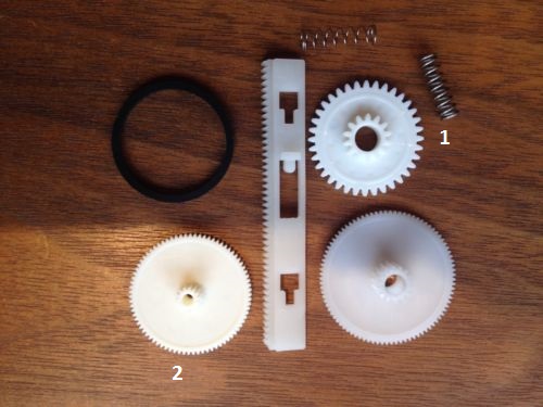

Hi, new to the forum got a Krell KAV 300 CD player and the cd drawer won't open. As I understand its a teac cmk-4 transport, but what I don't understand is people refer to the Teac VRDS 1? What's is that? The name for the complete transport system?
Could also do with someone confirming the part numbers of the two gears I need to fix, looking at ordering them from CHS. Many thanks Jon

The same problem with broken gear...
This one from lousy material, totally teared apart.
And the other is not like it should be but seems it is good.
maybe it is the solution to find some "master" to made this gear?

Update....
Triplex were really helpful and both gears will be replaced, the lazer gear too, as preventative maintainance.
All for just shy of 70 Euros!!! including taxes and P+P!!

VRDS T1 gear available
I am selling 2 aluminum gears of the VRDS CMK 4 transport. The original plastic gear breakes with time due to the lubrificant which weakens the plastic. Anyone interested drop me an email.

Hello all!
Aluminum, or brass gears are an option, BUT think about the other gears that these two make contact with. The plastic will wear off times faster than compared to the all plastic set-up. Apart from that there will be an added noise, which is not that important for the drawer gear, but still. I was about to make brass ones for my VRDS, but then decided to buy original plastic ones.
The plastic of the gears, in my opinion ages due to the higher ambient temperature within the case of each unit, and besides they are all made of regular poliamide, so the idea is for them to actually get broken and we seek out and buy spare ones at the end of the day.
Had they been injection-molded from glass microfiber poliamide, that would have been a completely different story.
Hope that helps
Radko

aluminum gears
well, I had to replace the plastic gear which was broken. I realised that the transfer of force is quite high on both gears due to the difference in circumverences of the white and the black big gear which controls the drawer. A few of the dents on the white plastic gear were broken. So I decided to design a copy of the white gear in aluminum. In fact I am quite happy with it. I cannot detect an increase in the noise when the drawer moves. Wrt the wear out, I use the aluminum gear extensively for a year or so w/o pbs.

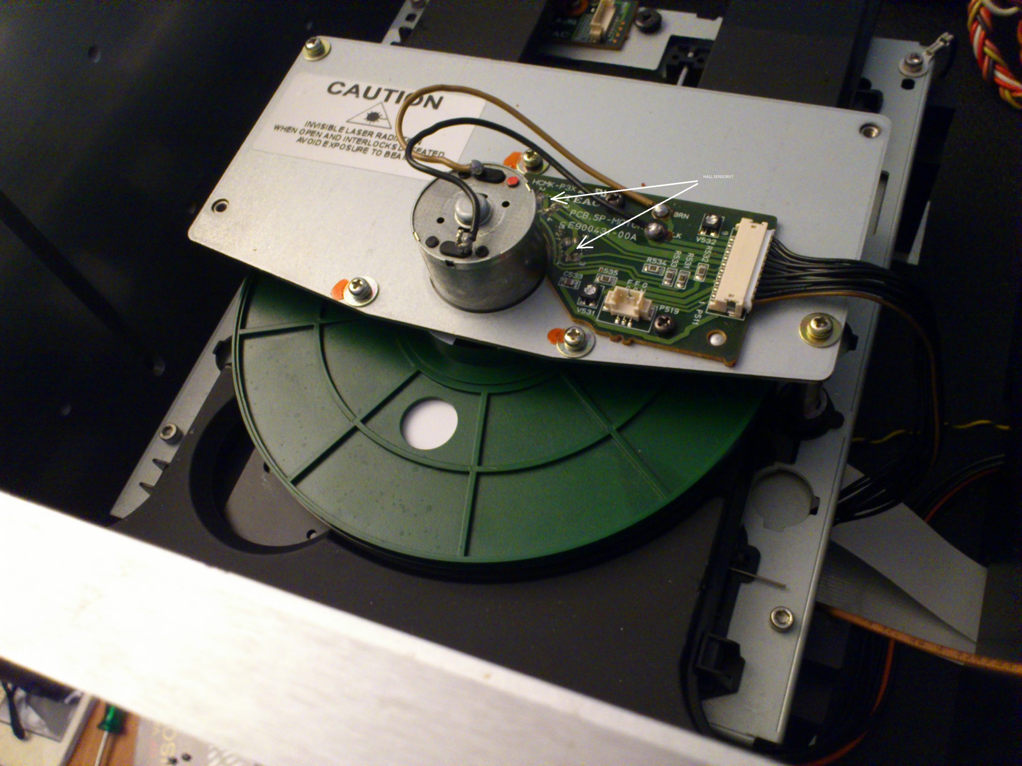

I have taken the foray into cd player repair. I just replaced the gear in a Krell kav 300cd with vrds-? The optical pickup is a KSS213C, not the KSS240A the parts list indicated. How do you know which version it is? -7, -10, -12
I am hoping someone here can provide a clue to this. At present the drawer now moves and the disk plays, however the disc will not index and no music. What is involved to perform the alignment procedure for the optical pickup replacement? (or just to make it read again?) All help greatly appreciated.

Are you sure you have the KSS-213?
I checked the CD DAC list, and for your model is listed with KSS-240.
With regards to the alignment procedure, do check the service manual for VRDS-T1, although I am not sure there is anything particular there, given you have used genuine spare parts. I will check what I have and let you know.
Is the laser emission ok?
Yes, it is indeed the 213. Odd I think, since as you point out that is not common. SN of the unit is: 9097110899 I can see the faint red light with the platter removed. The optical pickup seems to endlessly search. Sometimes the # of tracks and the time appear on display, but the track data never shows up when I press play. Dalbani Corp. in Miami has lot of these repair parts. You may not be able get them in Bulgaria, but they do list on e-bay. The 213 has only one trimmer to adjust. Might it be focus? I do not have a manual. Krell is usually not forthcoming with manuals, but the VRDS-T1 would be good to have.
KSS 213 KSS240

With regards to the KSS pick-up, the only trimmer on the 213 is the one for the laser emission. You can try increasing it a bit, but first mark the trimmer with a colored marker, so you can reverse the process if needed afterwards.
A good option is for you to buy a spare pick-up, since it seems to me that the emission of the laser diode is low. I have several players showing the same problem, and all of them need a new pick-ups.
I enclose a service manual for the KSS240 plus the service buletin from Sony on the same pick-up.
Hope this will be helpful in terms of adjustment procedure.
