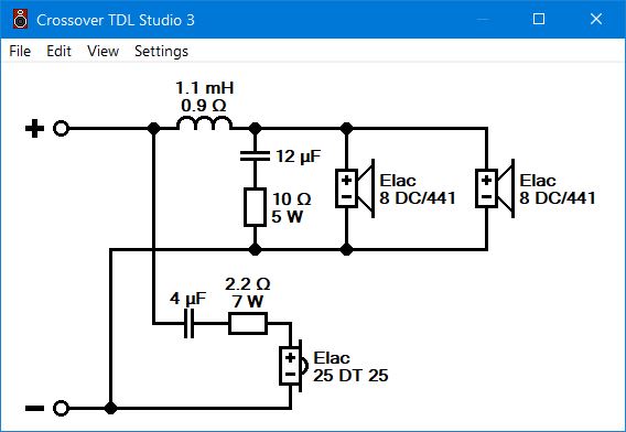

They are completely dead, no sound at all. Attached is the schematic which someone sent me many years ago. I've had mine apart and all the values are correct but I will double check and send a picture of the crossover when I can.

Interesting to see that schematic - it is much simpler than in my MKII's which have a 3rd order xover, plus zobel. I guess the newer woofer design allowed them to have a shallower forced roll off.

Is that definitely the only xover board in the speaker? ..I ask as it looks like all the right components for just a 3rd order high pass filter. Are those leads the only ones in and out of the board? ...if so, may be another board somewhere?

For those who are interested, I think I have found the sweet spot configuration with the Audax tw025a0.
A 3.6 ohm series and 20 ohm parallel resistor nets you a 5db drop whilst maintaining the 8 ohm load on the crossover. Even though the stock TDL matches the Audax’s 90db sensitivity, the Audax driver needs attenuating a fair bit.
This configuration gives an incredibly neutral and balanced sound stage. In my opinion, this is the most ideal Studio 3 upgrade configuration.

Unfortunately, I got the calculation wrong! That 20 ohm resistor should actually be 10 ohms. 20 ohms is actually out of spec! I looked back inside my speakers and I had fitted 10 ohms resistors, so I’m not sure what I was thinking when I made my original post. Apologies!
That being said, I have recently dropped the tweeter to -6dB which sounds spot on. Honestly, the blending is absolutely ideal and I encourage you to try it (not least to ditch the 20 ohm resistor I mislead you with!)
I’ve attached a picture of the ideal configuration.

Ah brilliant, so you’re working off exactly the same setup as me.
I’ve personally found -6dB to be the sweet spot where it feels like everything is balanced. -5dB initially sounded great but over time I found the treble a tad too prevalent still. It was a very fine margin but enough to cause me to tweak and drop it that extra dB.
The values for -6dB are 4 ohm series and 8 ohm parallel.
