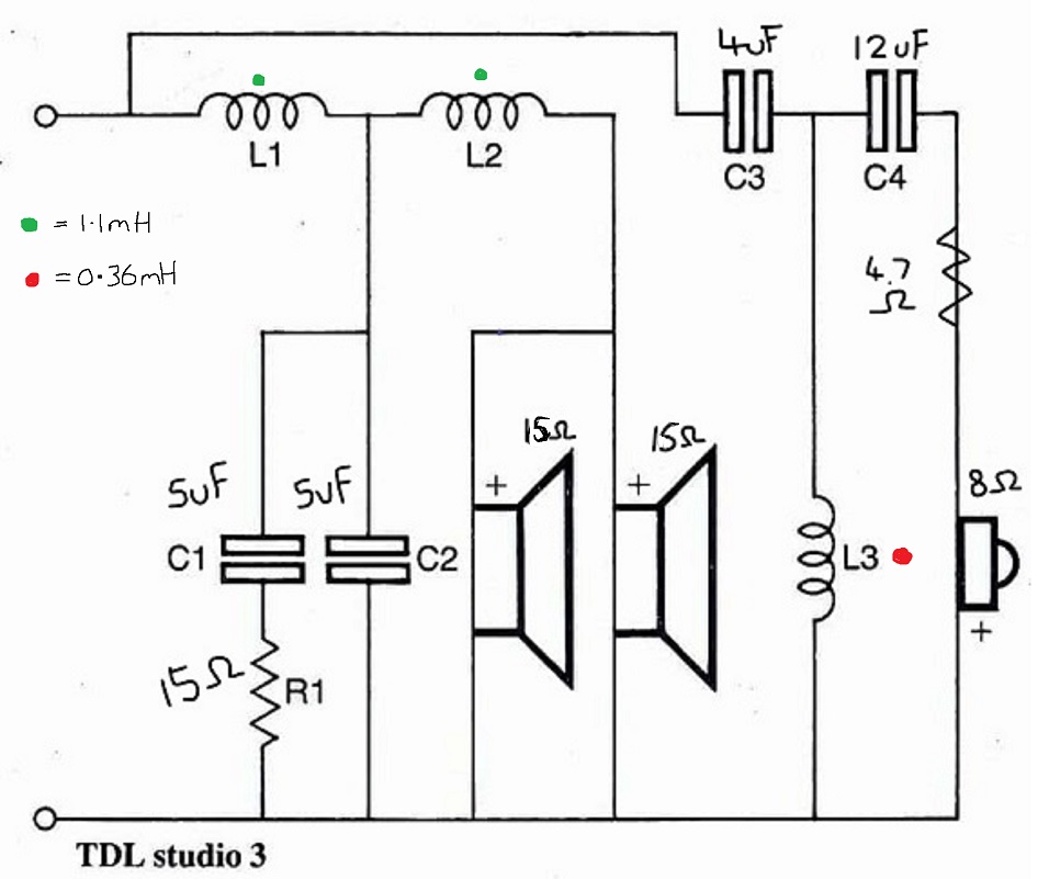

Morning Steve and Jaco
These 404's seem mighty odd to me having the appearance and size of the Studio 3's MKII bar the cabinet design. I've only recently become aware of the 101,202,303 and 404 series. I'd be interested in seeing a photo of the crossover to compare with the Studio 3's.
The 8DC441's definitely need a Zobel to tame the peaks in the upper mids - something in the region of a 5uF cap and 15 Ohm resistor.
They work very well in the Studio 3 cabinets as a TL but can't comment on how they work in the 404 cabinet as I've never heard them.

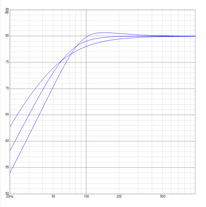

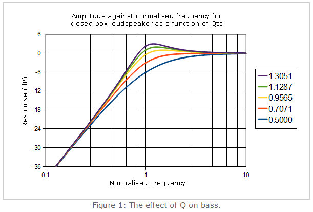

Morning, closed box fans! 😎
Every closed box builders knows this formula by heart... or should... 😀
Vtc = Vas / ((Qtc ^ 2/Qts ^ 2) - 1)
For Qtc = 0.7 and Qts = 0.5 it comes out at the Vas for maximally flat (orange) BW2.
Bigger box and you are overdamped, the blue line essentially, with deep bass but lousy power handling.
100L seems a lot even for two drivers. Might be better with transmission line.

Thank you for the feedback Mark.
These were South Africa specific afaik. One of the distributors bought up a huge quantity of the drivers from TDL before they went bust and then built a standard ported enclosure to "match", but not to the fullest potential of these drivers.
That's why I want to build copies of the Studio 3 cabinets - it's just that I cannot find any information online.
So my next option will be sealed.

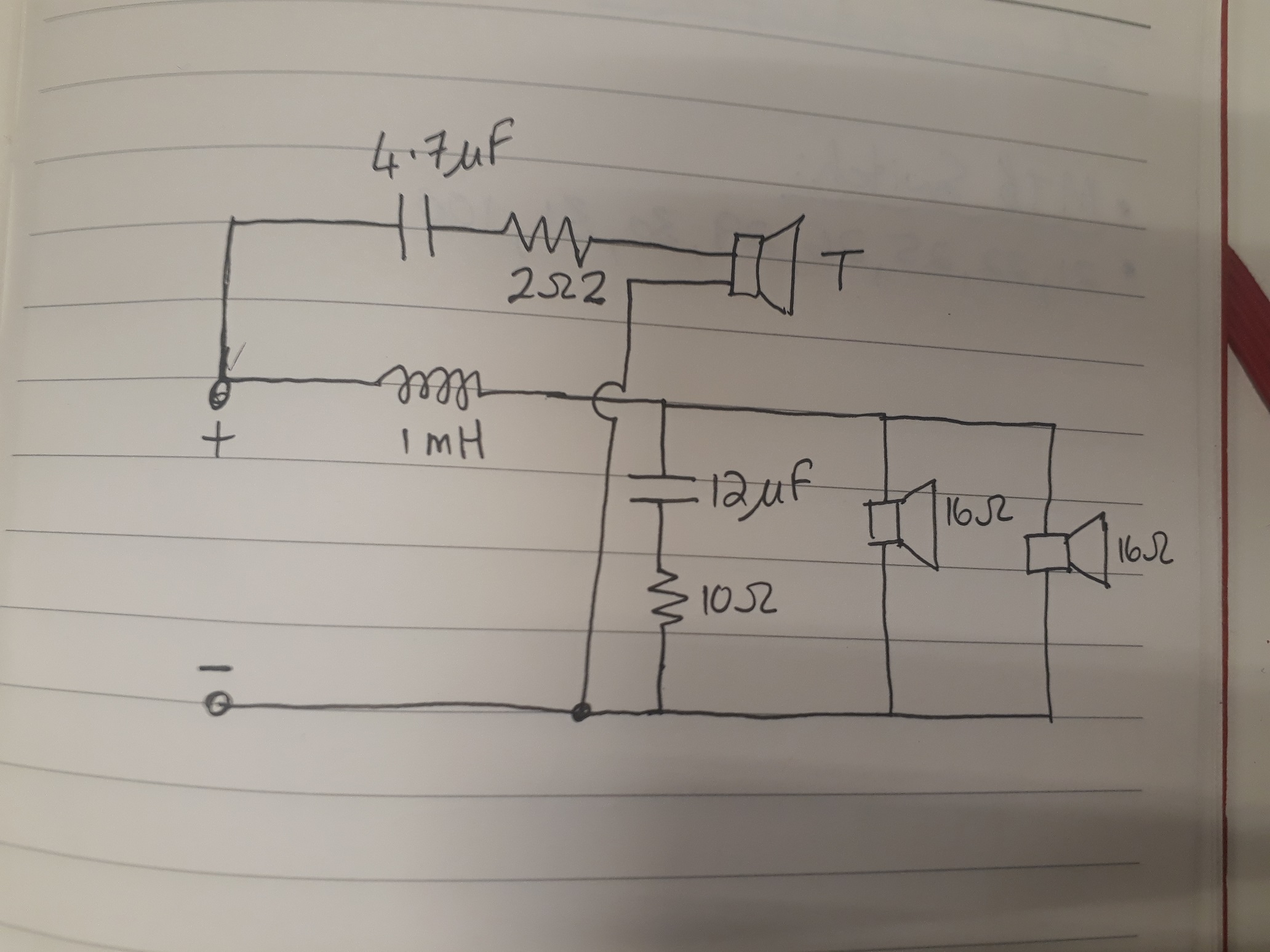

The crossover is bog standard; see below.

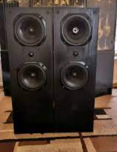

These cabinets have back firing ports, no bigger than 50mm I would guess.
The upper driver also seems to be isolated from the rest of the cabinet; basically in its own enclosure with its own port.
Apologies for the bad quality of the photo, but this is what they look like:

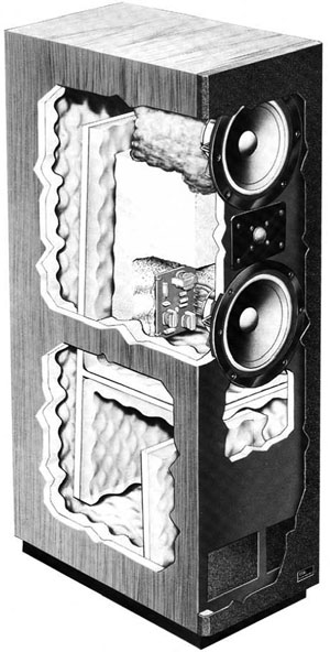

The attachment shows the internal structure of the Studio 3 ..not sure if that would be enough to work from?
I believe this is the first version with the crossover behind the woofer but later versions had the crossover attached to the back of the junction box on the back afaik. I can't imagine they changed the internal structure though.

Morning Steve, may your joy spread to us all 🙂 That has to be a contender for the first Thiele/Small related formulas I learned.Morning, closed box fans! 😎
The next was fs, the box size changes it. 0.7 always comes out with the lowest f3
Here showing 0.5 0.7 and 0.9 from the same speaker in different boxes.
This is what I also found, but I need the physical measurements of the transmission line, etc. 🙂
