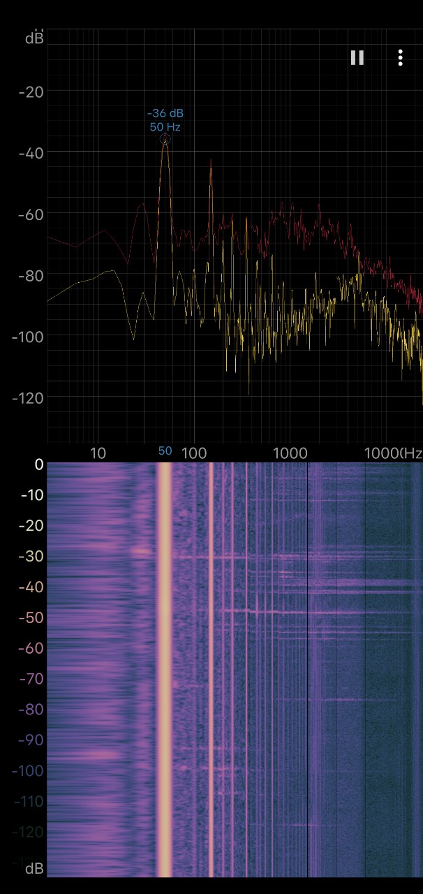

I already done:
* replaced the initial snubber components with correct values (10 Ohm/220pF/220pF) > DONE
* used a slow-running, low-noise fan for the heatsink > DONE
* replaced the six “ChongX” 2200uF/50V power rails capacitors with Nichicon types > CHONGX CAPS still there but I add 2x20.000uf nichicon caps connect to power rails
* replaced the initial 1 Ohm noise reduction resistors with 10 Ohm ones > Board has 100 smd resistor in the begining
* added two 1uF ceramic capacitors in parallel with C20 and C21 for better noise decoupling > DONE
* added two 47K resistors between each input terminal and ground > I connect 22k resistor between + and – inputs, idk if it has any effect?
* inserted an insulating sheet between the TDA7854TH housing and the heatsink, adding a fine layer of cooling paste on both sides > DONE
Compare with origin board, the hum noise decreases like a half after doing changes above. When no input or I short circuit + and – input, it is dead silent. But when connect input, play music and pause, the hum still loud enough to hear even I stand 1 metre nearby

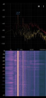

This picture I mesuare hum noise with my phone 0.3m near my subwoofer driver before changes. now it decreased, hum noise remain about -50-55db but still hearable
I sure think this loud hum is the reason I get this board for very cheap price. Is there anything I can continue do to remove this hum sir?

@ponyta,
You have done well and tell us important information.
When the amplifier is not connected to a source or the input is short-circuited, there is no noise. Thus, it seems not to be the amplifier power supply in itself that causes the problem.
When you use a source but stop the music playing, you clearly hear hum. Thus, the hum origins from the connection with the source OR, if you use a smartphone as source, the smartphone disables the headphone output when you stop the music in order to save battery.
First test for you to do is to connect your smartphone as source, without being connected to a charger, and play music from the smartphone while you slowly reduce the volume on the smartphone to zero (don't press stop or pause). This way the headphone output is not disabled. Do you still hear hum-noise?

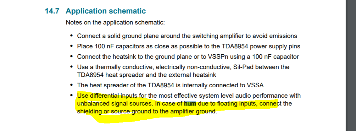

Reading tda8954 datasheet have some info, so I think maybe mass connect both 2 boards could fix that 50hz background hum.
(GDN mass connect, ground shield... etc I don't know what exactly it is or how to do. I'm so amateur, really need help).

I just thought about floating input in tda 8954 datasheet
A and C have 0v as (-) sound in signal so just connect signal wire and they are grounded together
but B is BTL, I don't know whether sound signal (-) (0v in A) can be wired to 0v in B to fix hum??

Sorry, this time I am late.
There are two types of constructions:
a) Those with two symmetrical supply lines (+ and -) with a further ground connection (called GND or 0V).
b) Those with only a single supply line (+ only) with a further ground connection (called GND or 0V).
The grounds are always connected together, never GND from a single supply construction to minus (-) of a dual supply construction.
