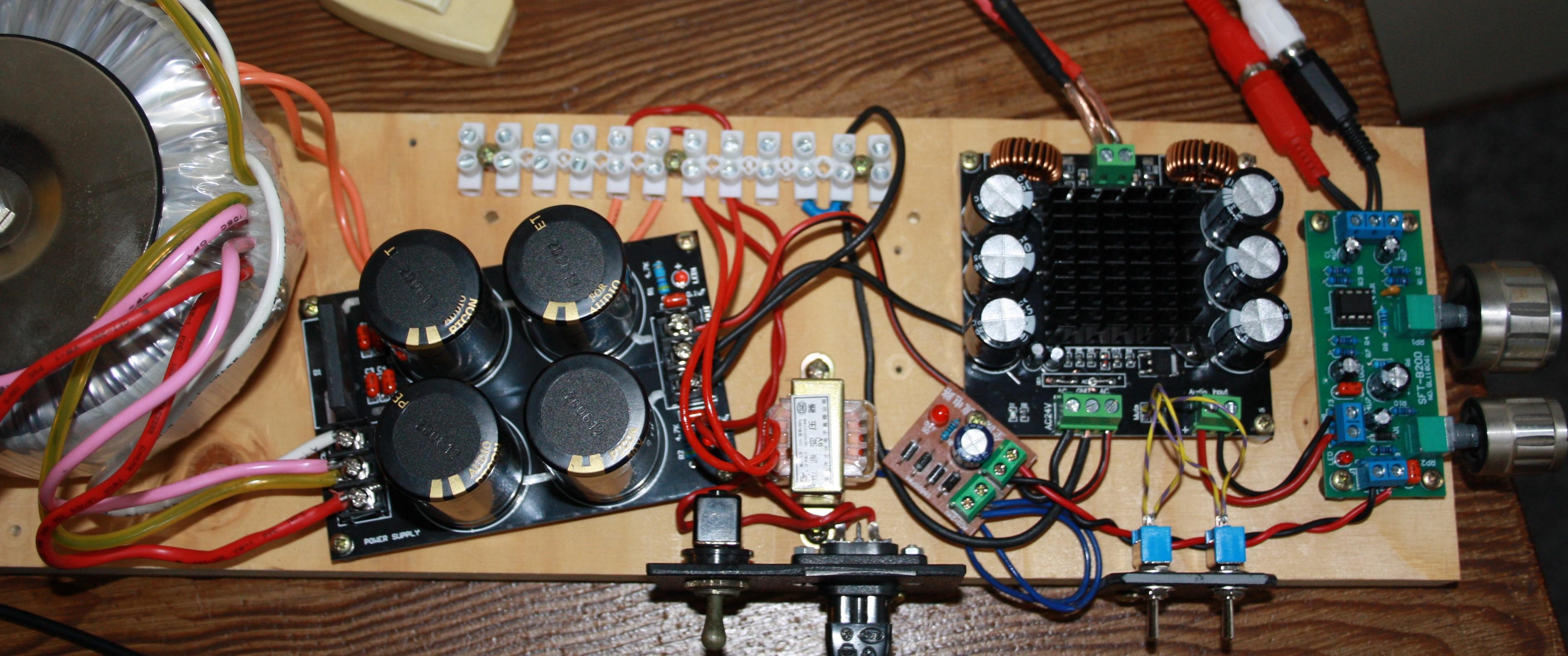

How to engage mute?
As my configuration suffers from a distinct 'thump' when I power down the amp, I added a DC protection relay circuitboard with a seperate powersupply, no more switching off noise.
I was made aware that D class amps need to see a load and are prone to damage if that is switched off by a relay.
As this board comes with a mute solder pad, I wondered if I could make use of that by muting the amp a fraction before the power is switched off, effectively avoiding the 'thump'
Unfortunately I have no idea how to engage the mute function; having read the specs on the subject doesn't help, as I don't understand what's being written...
Suggestions please.
Regards, Jan.
Answer: Yes, it's that simple.
As you can see in the picture, the two small switches on the right are conneting the two sets of solder pads, mute and standby.
I'll have to find out what the difference between 'mute' and 'standby' is, regarding powering down the amp without a 'thud' when the supply voltage sags...
Regards, Jan.
