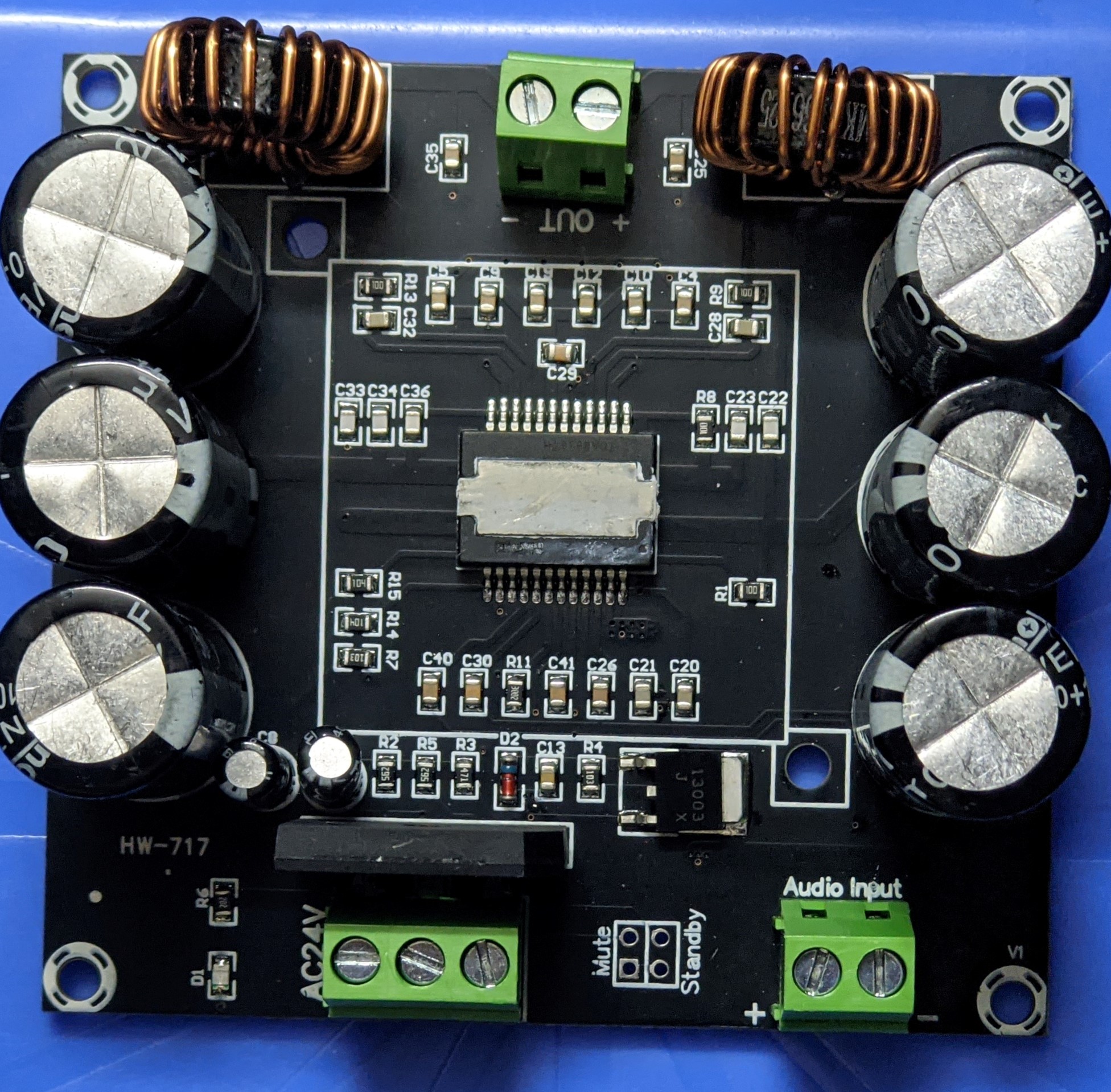

help mod fix hum for use as mono subwoofer amp
my board is a bit different with yours, HW-717 version ??!
I bought it for only ~10$
I plan to use it as a subwoofer amp, it is strong and gives a solid bass but it has noise and hum loud in the background (seem like 50hz noise but when no input wire connects, there silent, no noise)
Please help me, I already add a cooling fan, 2 big 15000uf capacitors for power but still hum, no change. Sorry because I am very amateur, Thanks!!!
I will test it tonightThis is my first suggestion to you: remove protective earth from the chassis and make a connection to amplifier ground instead. That on its own may solve your problems.

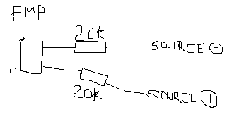

Is this scheme ok? :With your board, connect the 20K resistor between the two input terminals, in parallel with the input from the source.

Cabling at the input as before. But, further with the 20K resistor connected between the "+" and "-" input terminals.
Tested with resistor between - and + input and source connected (mp3 player).
Nothing better. Still have the noise when I connect something on input connector.
