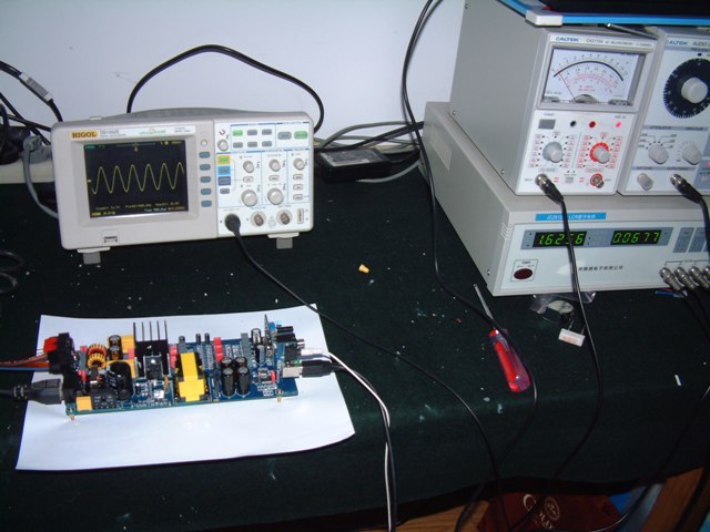

Burn in my Genius100(we named tda8920+smps+pcm2902) over 24hours@2*15W/4Ω.feeling warmer ahout 30℃(room temperature ahout10℃),I finaly use ±20V/7.5A supply(SMPS,90-265VAC),output voltage: 12Vrms/4Ω/0.5%THD.About 36W/CH.

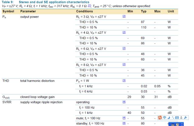

Some funs asked me,NXP write parameter high in datasheet(view picture below),why you test so little,I have to tell you,at this situation,excellent sound than Tripath,because at high frequency section(5.1KHz-20KHz) will degradation if voltage higher.of course,Inductor also important,choose carefully.our aim excellent sound then more power out.

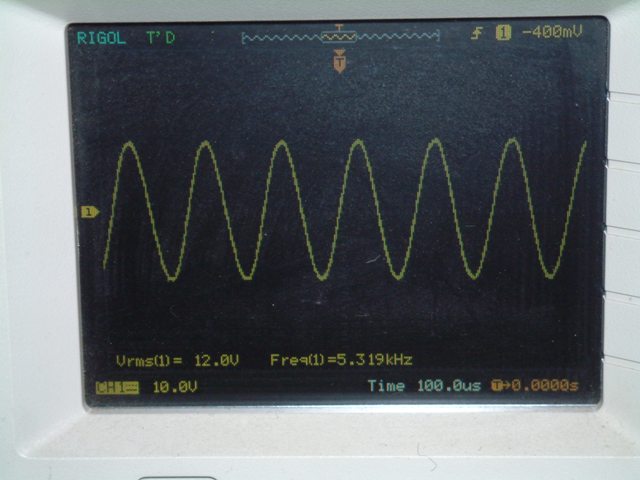

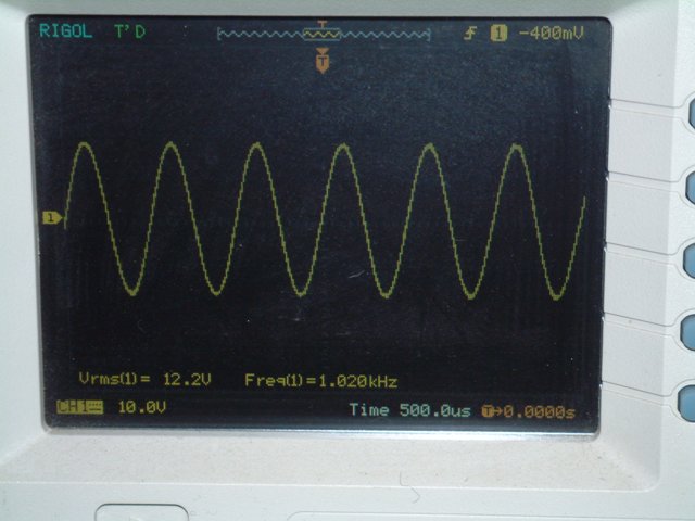

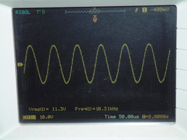

Upload oscilloscope signal wave picture.
I use this module drive two wooden box(SPL:100db/PO:150w/4Ω),Sound good.
