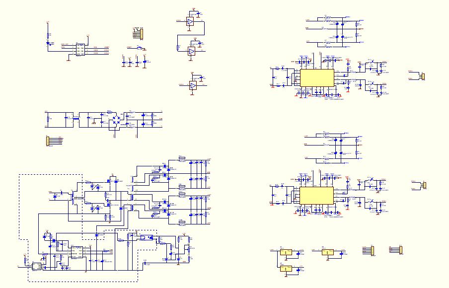

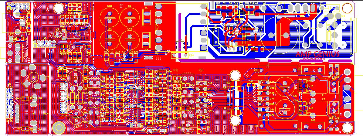

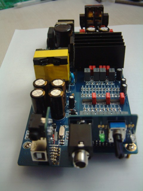

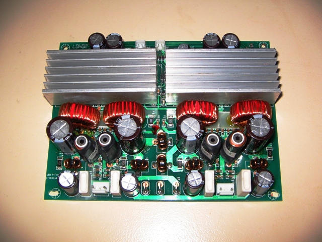

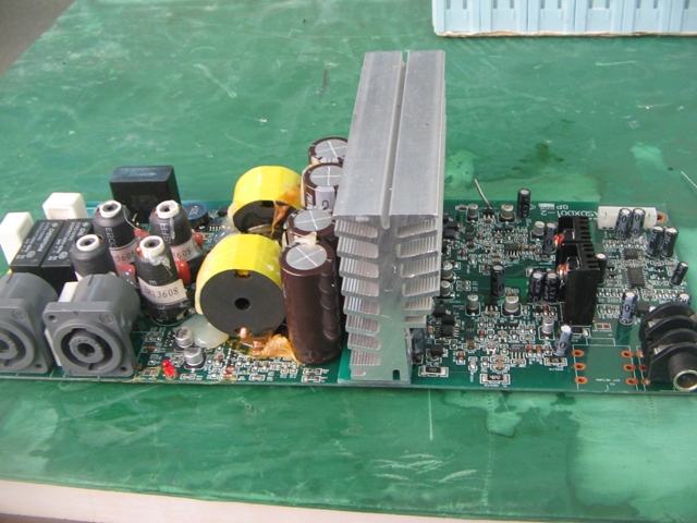

I believe smsp and amp in one board design difficult but use easily,my friends told me you have to think about DIY,they always like do it youself,so i design other board for him.
this board i have used in product 2007,use tda8920.it's strong structure.so i change pcb route fit for tda8954.

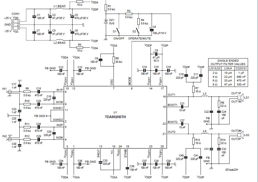

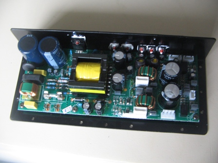

Can you tell me what to do with the middle input pin (pin 3 - Mode pin)
Anyone who can help me. There are 5 input pins. 4 of them are left/right input the fifth are a MODE pin, and I don't understand how it should be connected. I have tried another class D /from CAD audio) where the mode pin shpuld be shorted to signal on either right or left channel.

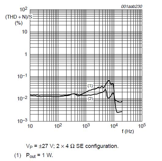

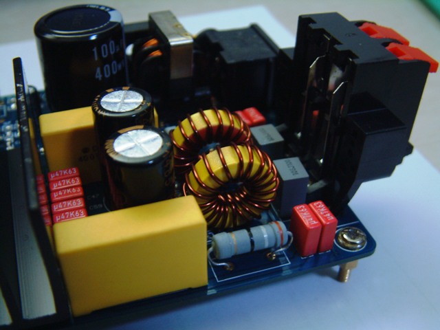

Since the output filter is outside the feedback loop, the THD plots are more an indicator of the quality of the output inductor used in the test circuit than the quality of the ICs themselves.
If you take a look at the test circuits, the type of output inductors used is clearly not the same. For TDA8924 it's is round shaped, probably a pot core with good linearity and high saturation at the expense of a high stray field. For TDA8920 it's square shaped, probably a shielded gapped type with lower saturation and worse linearity at the expense of very low stray fields.
different core
Different module use different inductor,environmental conditions is important,for low EMI,Use round core like jar core and PQ ferrite core,for hi-fi use I suggest gaped toroidal core.or use red gray toroidal core。I use a little other ferrite core or magnetic shielding ferrite core.current room little.
some picture use different type core.
you can choose a simple schematic like series resister and zener,parrel electronic cap for slow up,0v-5v6 two state ,when power up ,mode pin slow up to 5v6.

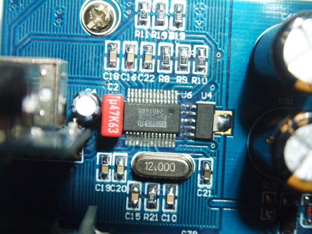

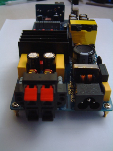

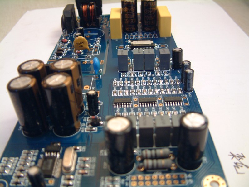

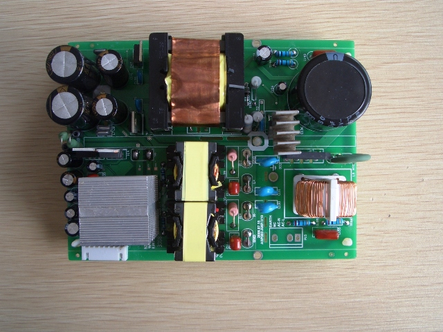

tda8920+smps finished!
I'm so tired tonight,I have finished all works until now,BeiJIng time 23:31pm,All function good,PCM2902 sound excellent connect with tda8920bth.
Because I use prefilter in preamp section.so there is no digital noise .I have to burn-in 24 hours tomorrow.I'll write specification here.
For my Block Diagram ,I forget draw headphone AMP unit.this modules I designed headphone AMP
