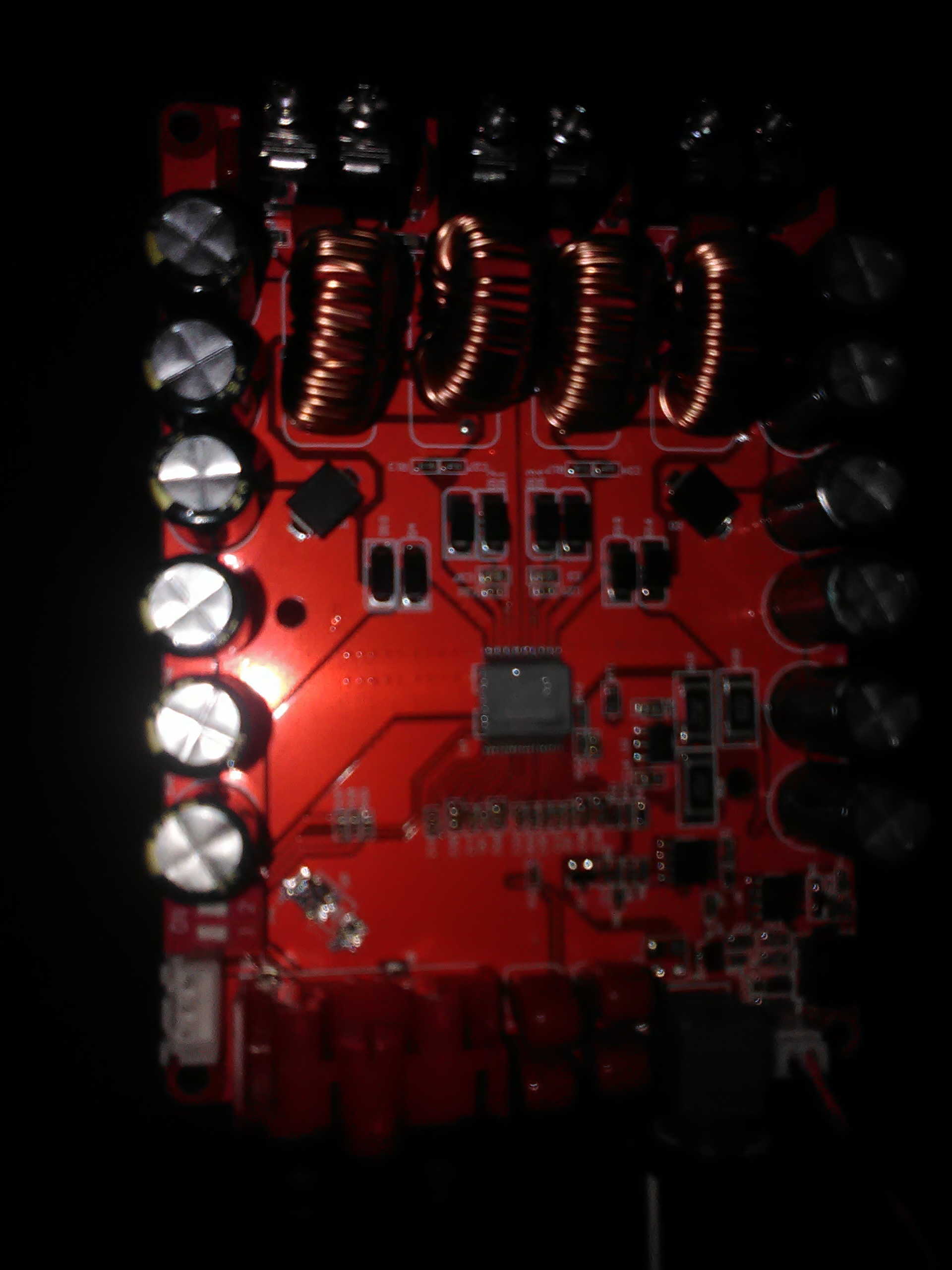

Hi . I have the similar problem with a red board sanwu 7498E.
It doesnt make sound. No parts burned. No D8 diode...

I also have a 7498 with no sound. Any fixes guys. Some pics of mine. Tested 9-24 volt still no sound. Bought a year and sat there till 2 weeks ago. Contacted the seller to see if he has any advice. I'm sure it's too late to get it replaced.
I return to the subject. When I removed the heatsink from the red 7498E board, I saw that the circuit was a 7498 without E. The seller gave me my money back. I ordered another 7498E board, this one is black and it doesn't sound either (they also gave me money back).
I feed it with a 90W 20Vdc laptop power supply, speakers are 6Ohm 60w
No things burned. Led power ON.
I have changed the gain jumper for 33.1db (by default) to 23.6dB, same result.no sound.

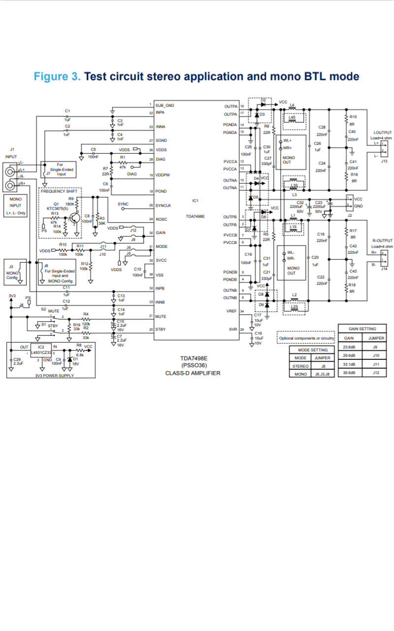

Measurements (and photo with points were I'm metering, same as 7498E pins):
20: 2.9V
21: 2.77v
22: 0.02V
29: 0.8V
*note: the voltimeter I have now is a little bad
Should I need change pin29 capacitor 10uF?
Thank you in advance
20: 2.9V
21: 2.77v
22: 0.02V
29: 0.8V
Do you know other points to test it?Hi,
check PIN 20 & PIN 21= 3V if yes then replace 10uF capacitor (SMD) connected in PIN 29 to GND
MANOJ
Could you do change it?I will try replace this capacitor.
more measurements:
pin 6-7 (PVCCB):21V
pin 12-13(PVCCA):21V
pin35 (SVCC):0V
18 (PGND)0V
19 (VDDPW)= 0V
20(STBY): 2.9V
21(MUTE): 2.77v
22(INPA): 0.02V
29 (SVR) =0.3V
34 VREF=0,15V but its decreasing connected with the voltimeter
36 VSS=0v
