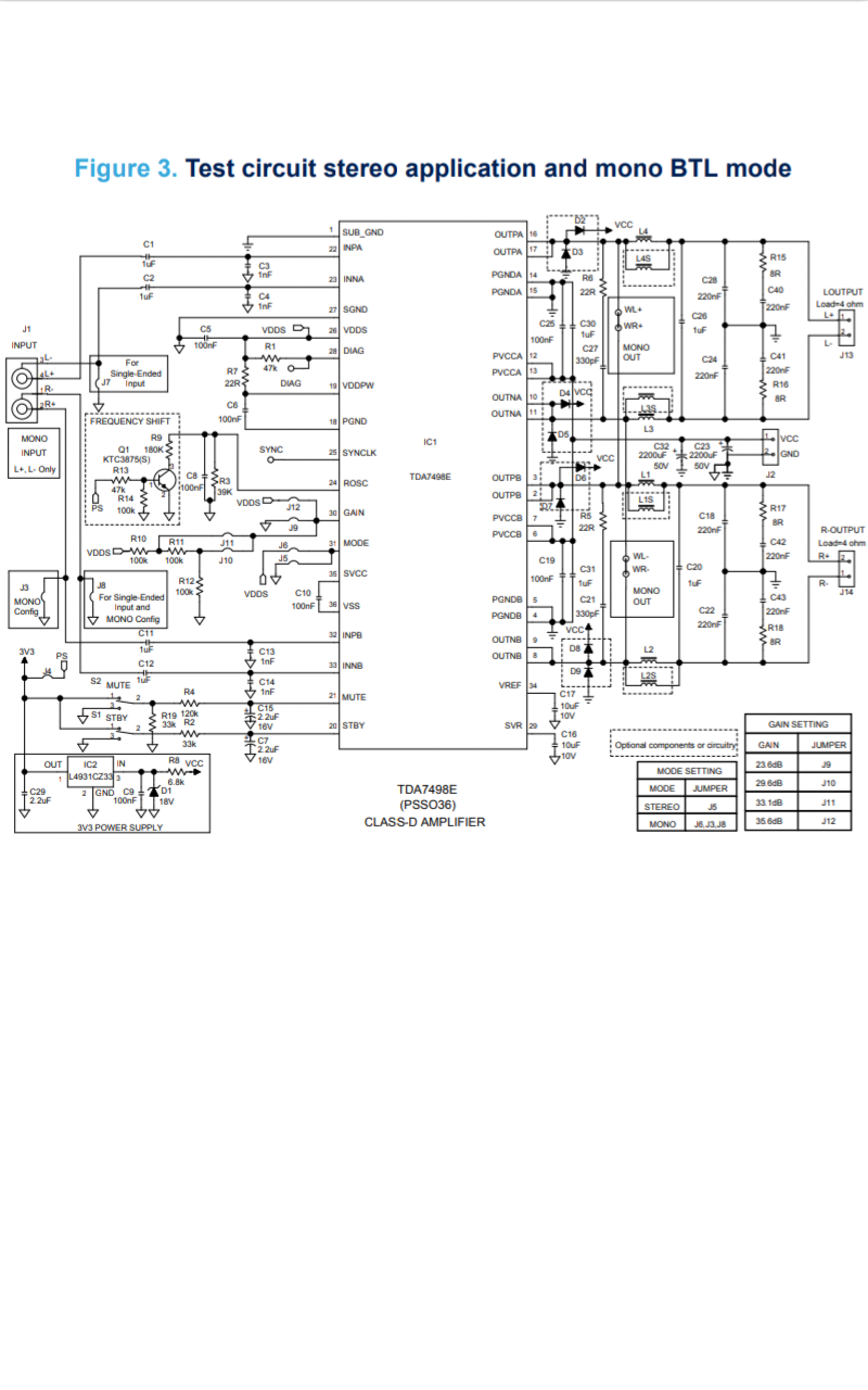

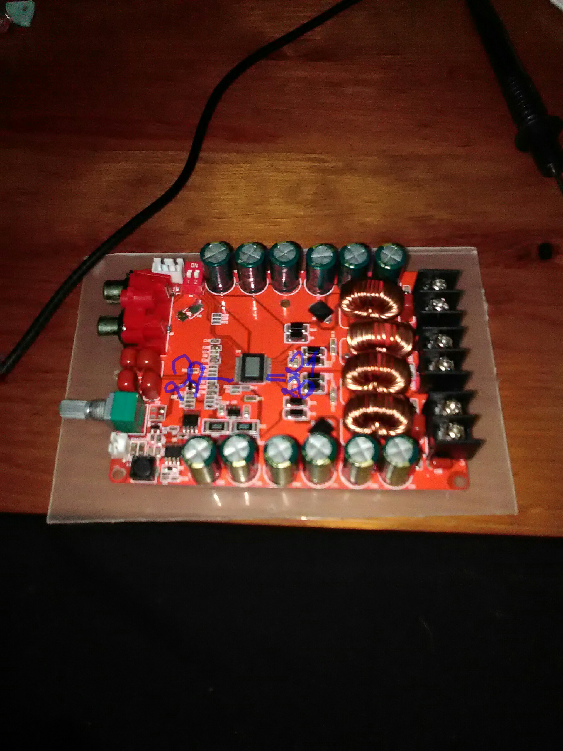

Those diodes clamp any voltage spikes to either ground or to the positive rail (depending on the polarity of the spike) and so prevent the output pin of the IC being taken either above the supply voltage or below ground potential which could damage it.
The type of diode is not critical but it must be a fast switching type and have a voltage rating equal to at least twice the DC supply voltage plus a safety margin. The current handling needs to be at least a couple of amps or more.
Just try whatever you can get that matches that requirement.
I will try buy the schottky diode SMD SS86, my power supply module is 36 5A (cheap module from eBay). I hope this diode fix the problem, it's rated for 8A 60v. If doesn't solve this, maybe the IC TDA7498E is damaged, or some other problem, of which I have no knowledge to identify it. In any case the seller has already sent a replacement module, now I just have to wait.

I hope my pins is right, but you can see on the picture if my schematic is righ!
If you can give me some help.

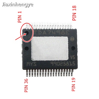

you counted wrong direction i think
you can see a dot mark (punch) on IC
Regards
MANOJ

Hi again my dear NANOJ, i hope you have an nice day.
This time i measure the PINs of my TDA7498E the right way, use your picture as reference and this is the values from the PINs of the IC:
PIN 20 = 0.96v
PIN 21 = 3.15v
PIN 22 = 0.13v and the voltage drop to 0.08v
PIN 29 = 0.00v

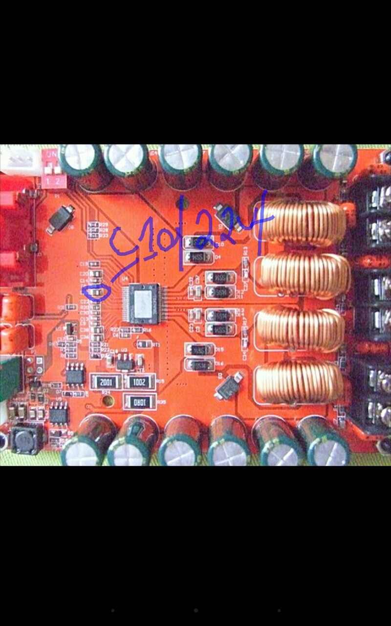

PIN 20(STBY) & 21(MUTE) should be minimum 2.5v{pin 21=3.15v is ok} and pin 20=0.96v may be it is taken to High(because 0.5v= low) but PIN 29=0v is low it should be 1.8v.I already said replace 10uF capacitor with new

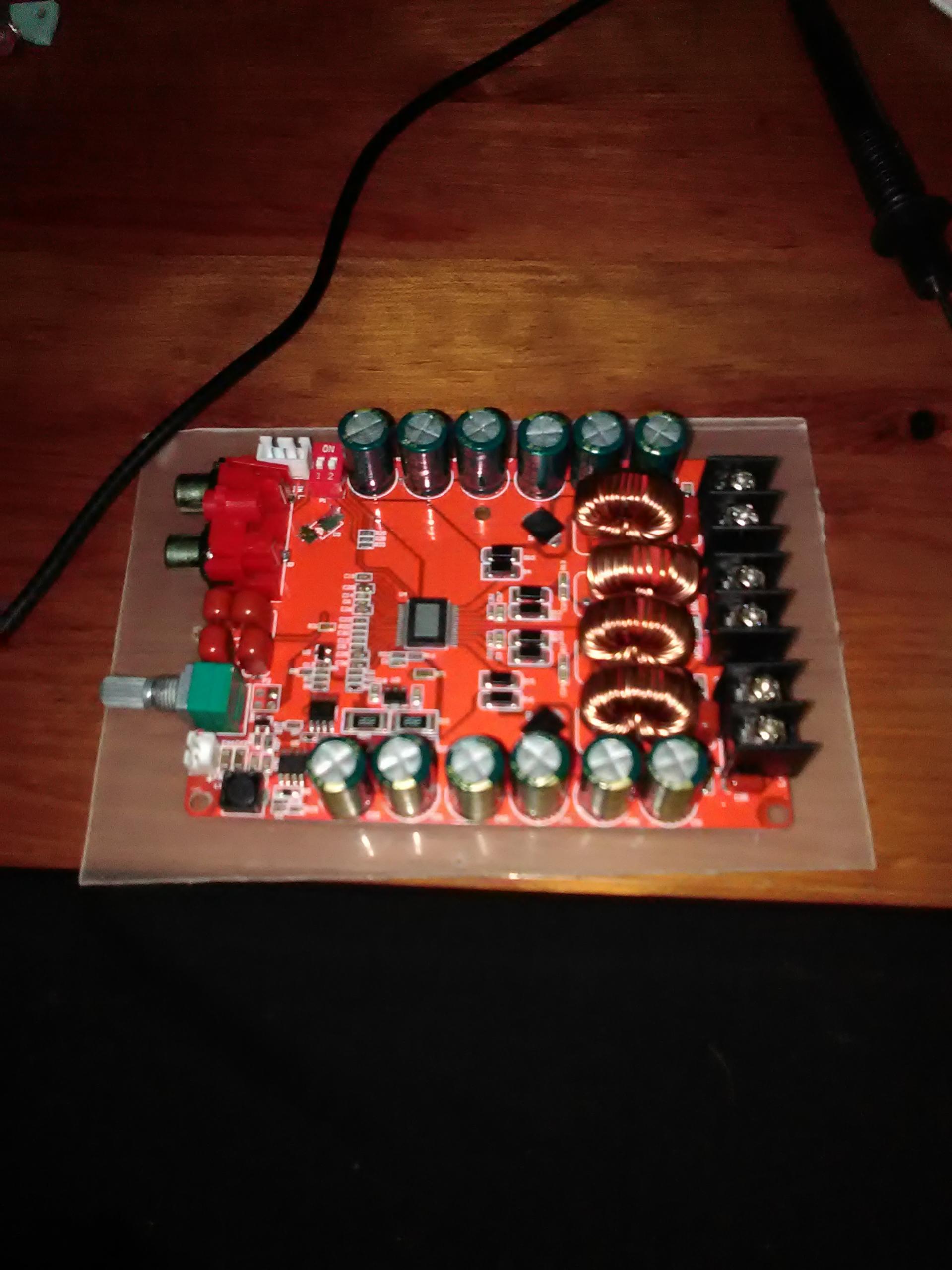

Hi my dear NANOJ, i hope you have an nice day.
Can you give me a help?
Is that capacitor i mark on picture i need to replace?
