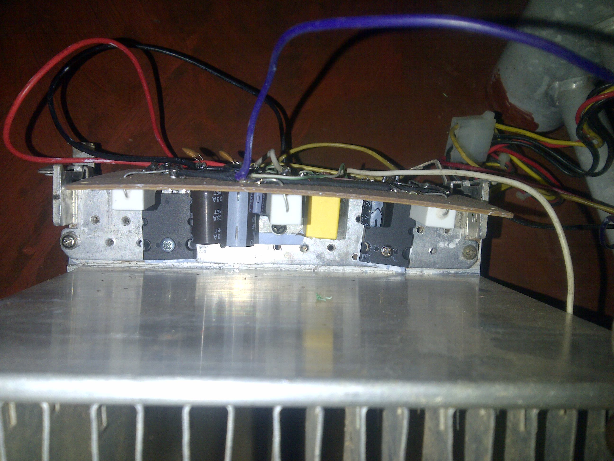

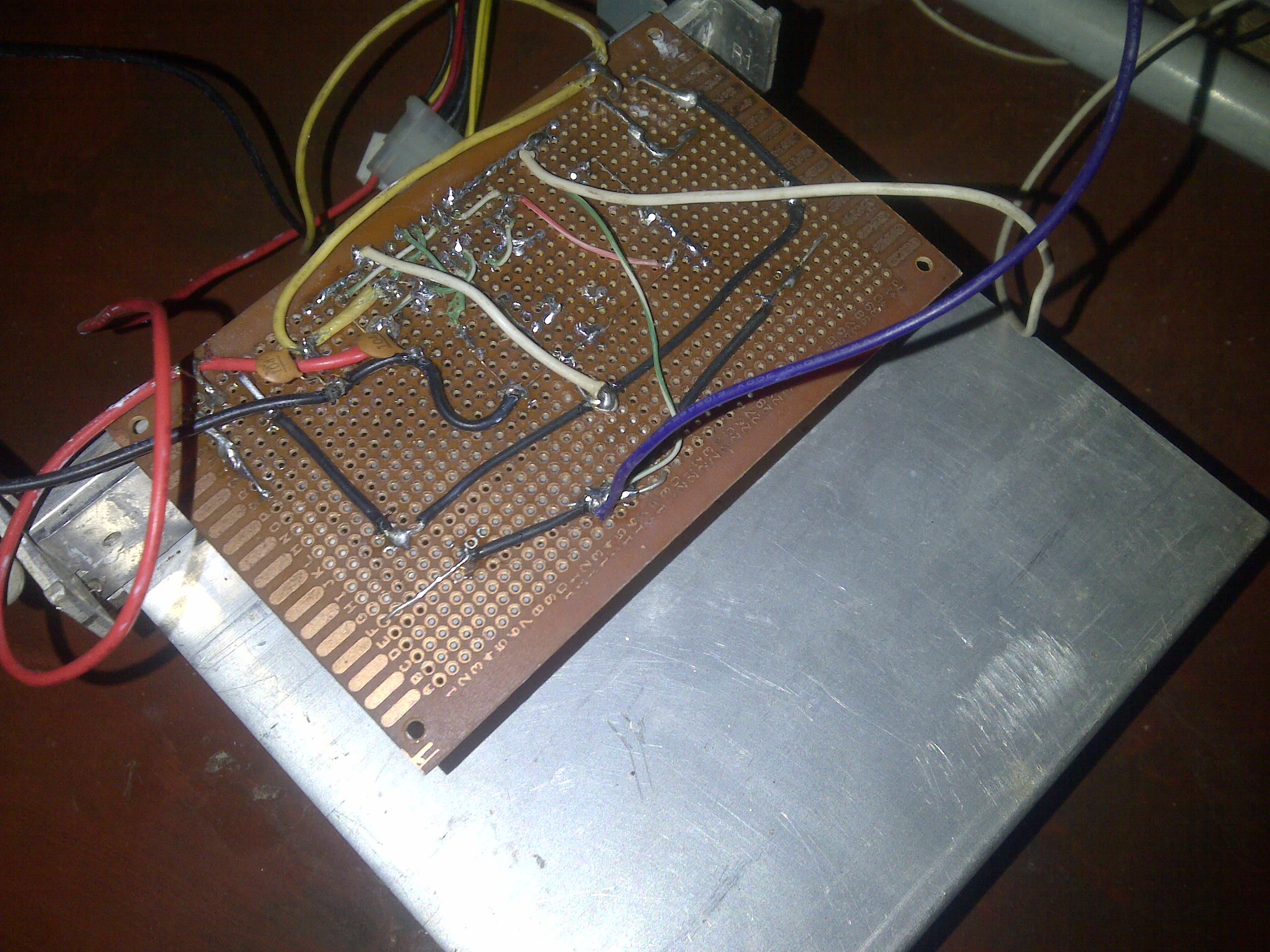

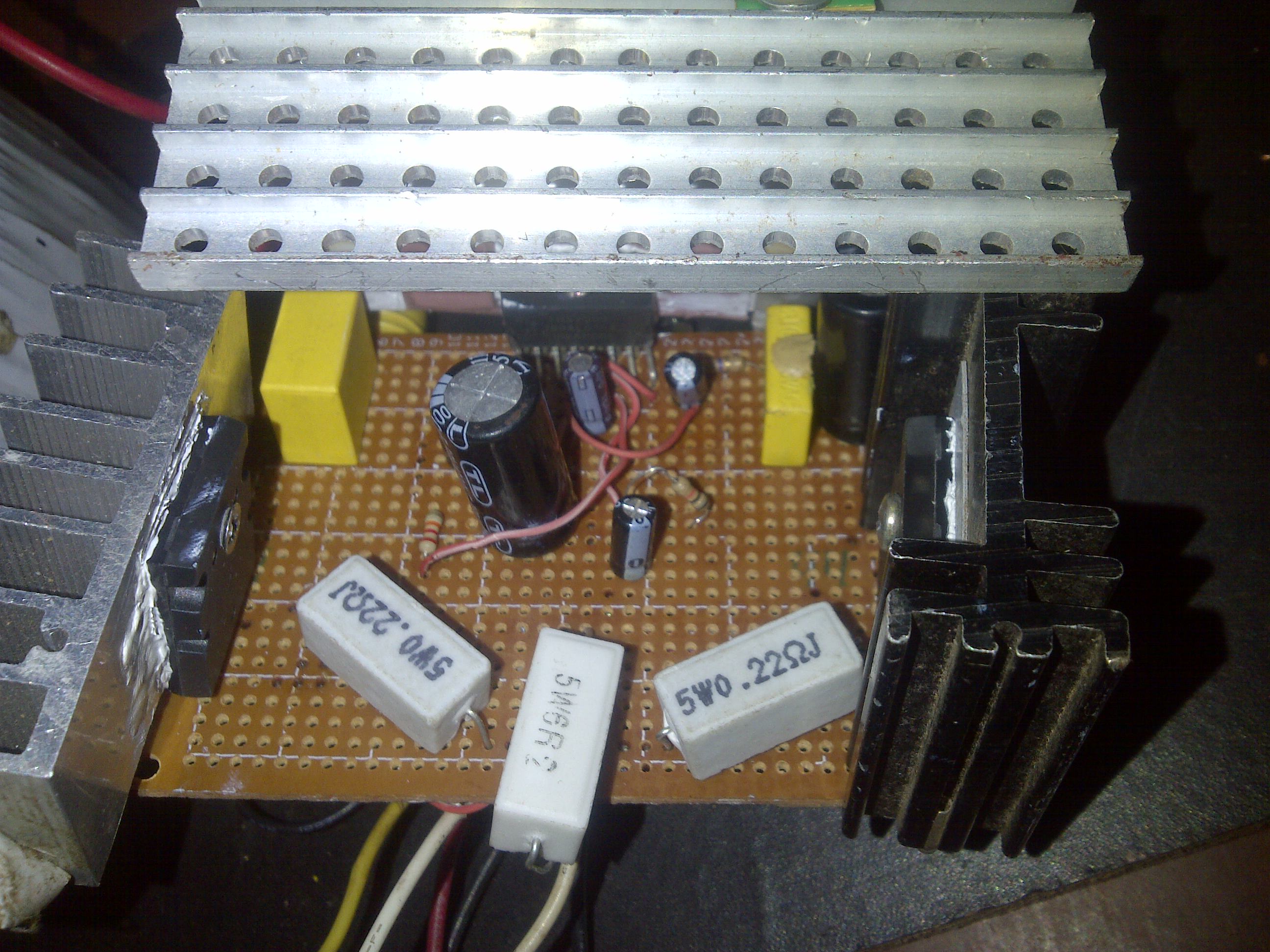

Some pics for my current setup, I bilt these mainly for test purposes so a bit messy but I plan to build a bridged amp with transistors on one PCB as Kebbz but with TDA7294 very soon.
Thank you for the pics! Impressive work. Using such big radiators do you plan to avoid using cooling fan(s) ?

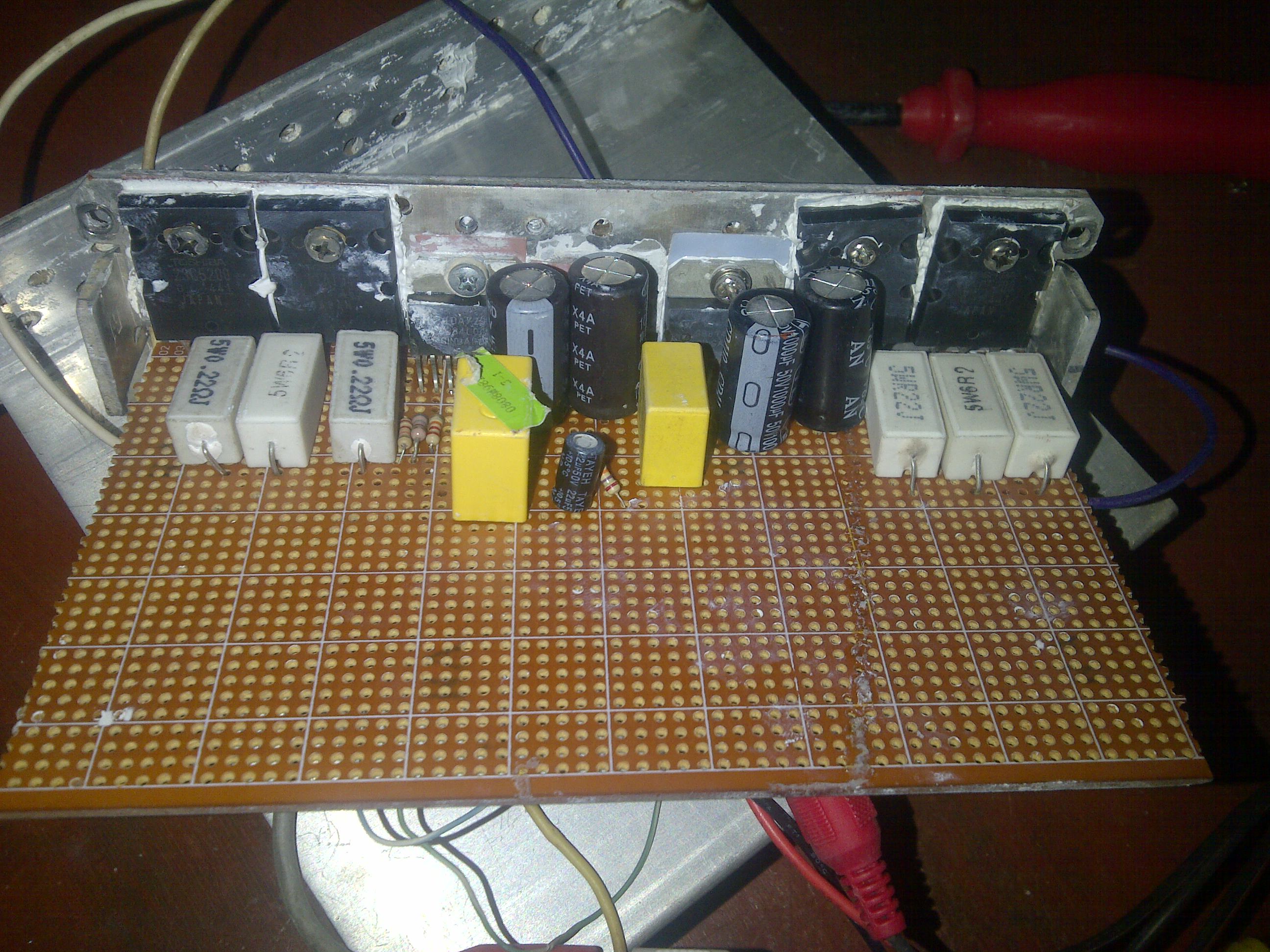

Thanx I will definitely add that cap ASAP, last night dismantled both amps and reassembled on a single PCB so now I can use just one heat sink, oh it was quite some work I couldn't get it to work it was just a loud distorted sound so I knew it had to do with the feedback string, I spent the whole day on it, disconnected out puts, un bridged the amps and tried them separately, one worked the other to no avail I wondered till later this evening I took a closer look only to realize I mistook the 2.7ohms for a 680ohms, I guess I was too overworked. Now reassembled and bridged all is fine.
Here is a pick of transformation. I will test its full capability at 3ohms in the morning as previously the other amp with smaller heat sinks would heat up too much so I couldn't, I hope to keep heat dissipation as low as possible even at full capacity.
By the way as it is in this bridged/ sinle output transistor setup is it 1ohm or 2 ohm stable and what will be the advantage of adding another set of out puts? I have another set I would like to add.
The picture you posted I think is not of the finished amp, some components are missing I don't see the bootstrap capacitors that are essential, and one of the 22uF of the two feedback loops. Also the 0.1uF decoupling caps are missing. Anyway the radiator in the picture definitely is too small to dissipate the heat of this bridged amp even if you add a ventilator!
Hi cmurarui, the bootstrap caps are there one is just next to the tda but hidden by the yellow cap and the other is at the bottom of the pcb, I also soldered the 0.1 mf caps right onto the filter caps at the bottom, and yes I omitted the two 22mf caps following the bridged schematic in the data sheets were 680ohms resistors are grounded. As for radiator that's what I could find for now but I will change it ASAP. Thanx.
