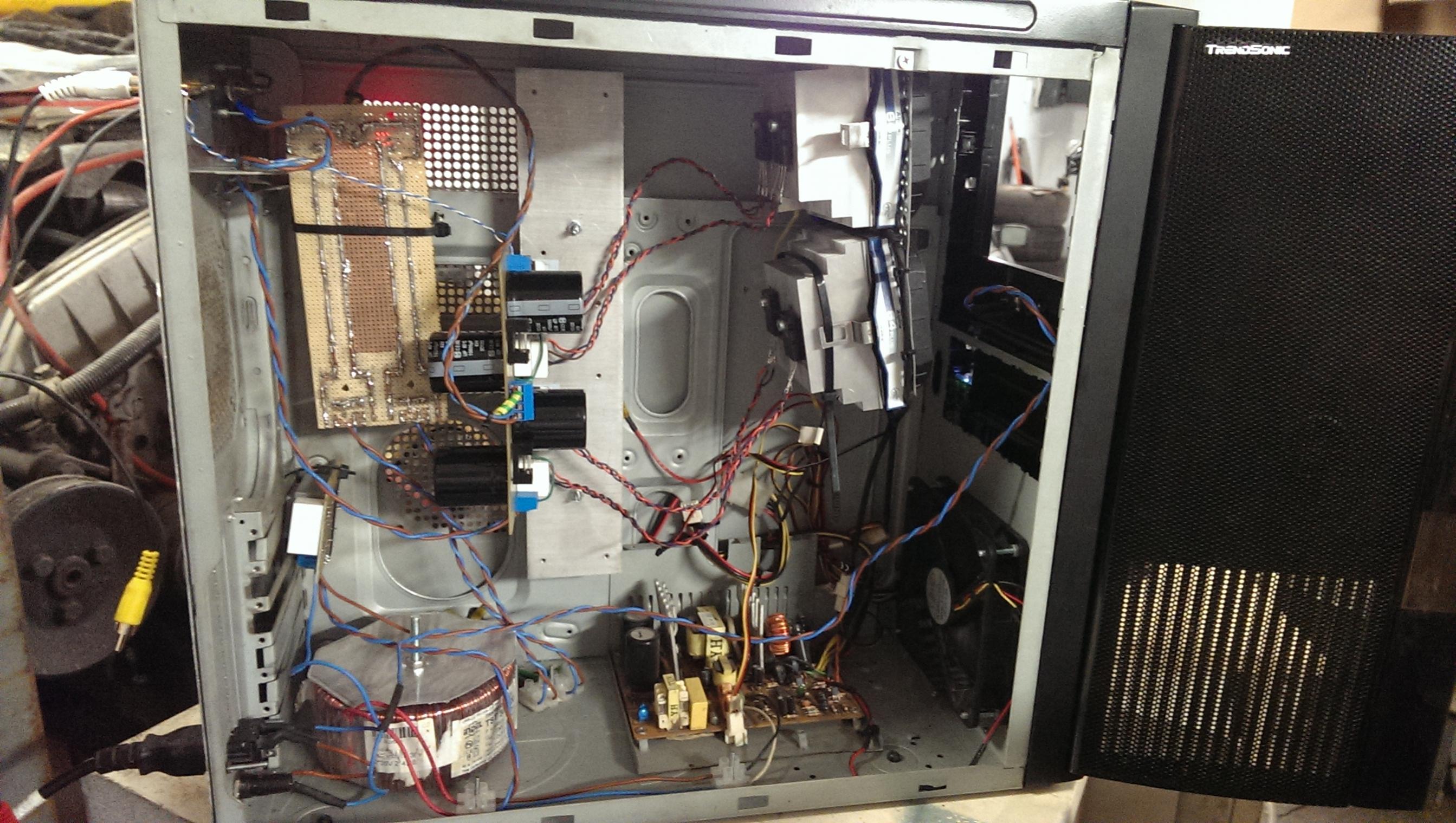

This is how it currently stands. Working 🙂

It seems ok at the moment, though it needs definitely tidying.
The cpu coolers are indeed some nice pieces to work with and also with fans for some extra cooling.
I used my old pc case, which just got left over. It has got a couple of temp sensors and a small display. An old pc psu for it, and the fans.
JaanusJ i did however notice that the wires to transistors (collector & emitter are quite thin), you should use thicker wire to get all AMPS out of the transistors, and of course as short wire as possible.
And as i said im all for using what you have laying around, that's why i used the ATX-Power case as it's size was good for the Transformer i use.
Next AMP will be a 4x TDA7293 with a SMPS and also in an ATX-Power supply case, just a different layout as the SMPS takes up very little space.
When i get on the project ill make a new thread 🙂,
Looks nice and especially the wires. In so many gear they have expensive parts but cheapass cables with just one core , often too long, so twisted around..., i'm busy with a technics mk-5 turntable(1200mk5) and though it's not old , it has the open variable resistors and shitty unshielded cables and offcourse the connector, like in active speakers , which are crap . Don't replace them for one core silver ones, cause silver doesn't like to be bend at all, just copper, not solid which has way longer molecules.
