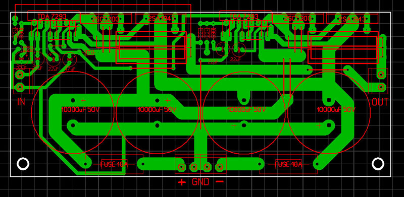

hi, i got so much interest in your bridged amp but i have questions; what,s the value of resistors underneath the 6.8 resistor?, where do their leads go?, and there's a red jumper from the final stage of the amp to somewhere in between the amp where does it actually go?
pliz help i really need to try this one.
These are 0,15R resistors. See the schematic in the previous page.
I used the pcb design by kebbz, provided by him on page 9.
The board i used, was just a bit smaller than needed for this design, so i had to run some tracks on top of the board.

First I want to say I'm happy he used my component layout. He asked earlier about the insulation of tda and transistors. You can only insulate 2SC5200 and mount TDA and 2SA1943 directly on the heatsink. But then you must insulate the heatsink from the amplifier case (box) cause it will be on the negative power supply line.
Also a hint: This amp needs a speaker delay circuit cause it has a nasty pop noise when you turn it on and some high pitch hiss noise when you power it off. So first power it on and then connect the speaker wire not to fry the speaker .... should of mention this before 😛
There is a nice and simple to build circuit with UPC1237 which offers speaker delay and protection. If someone has a tested PCB I would be glad if he could share it.
