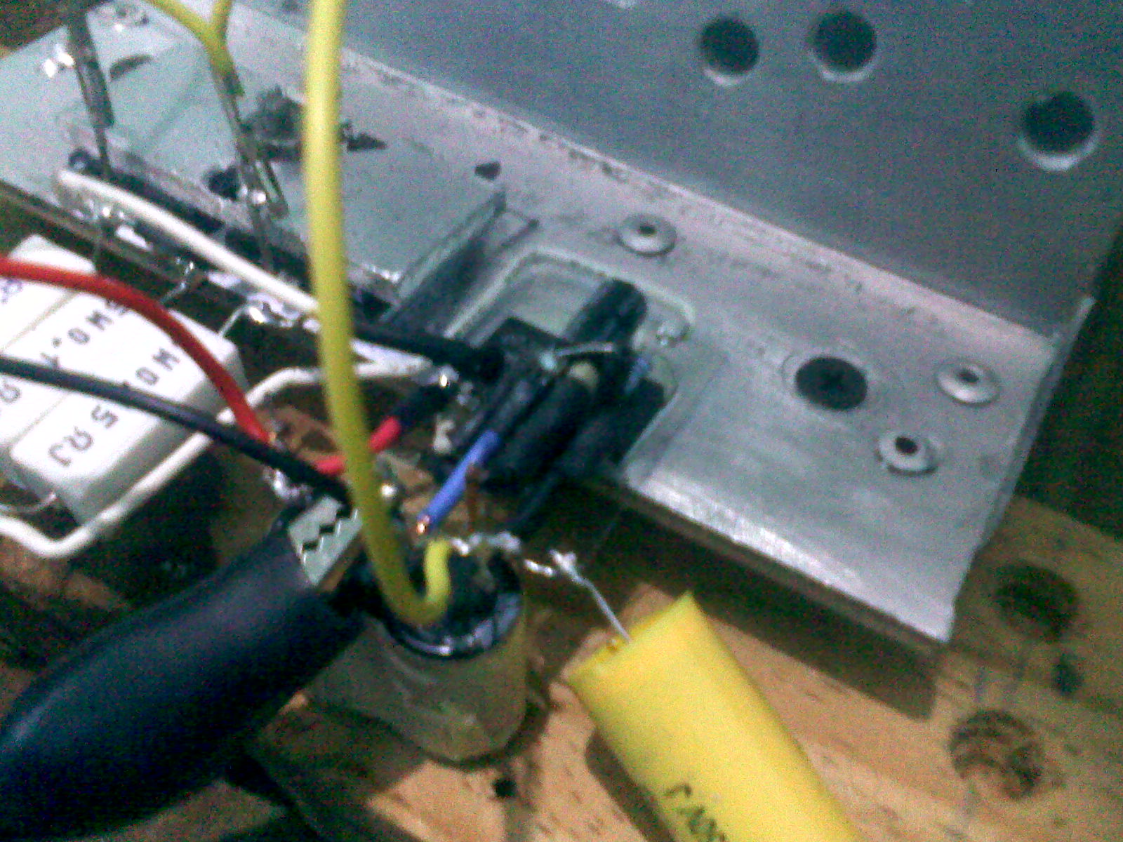

this is new one:

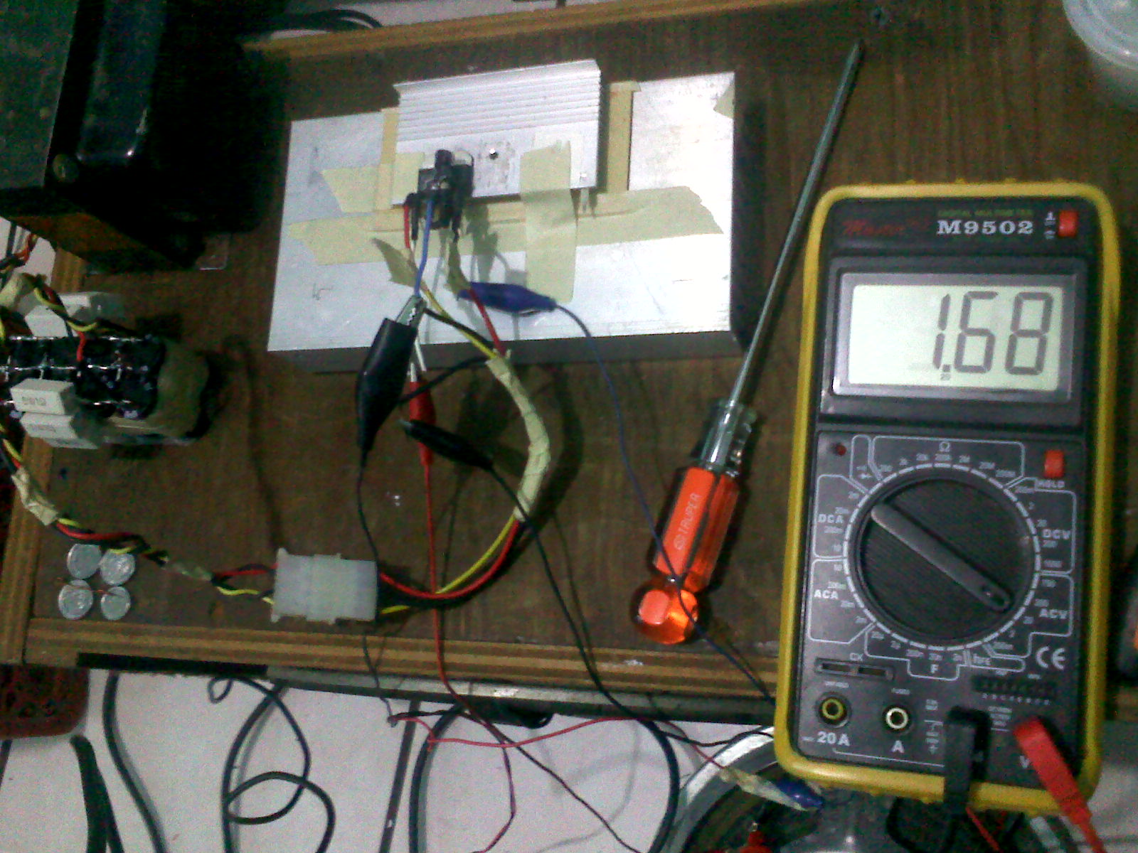

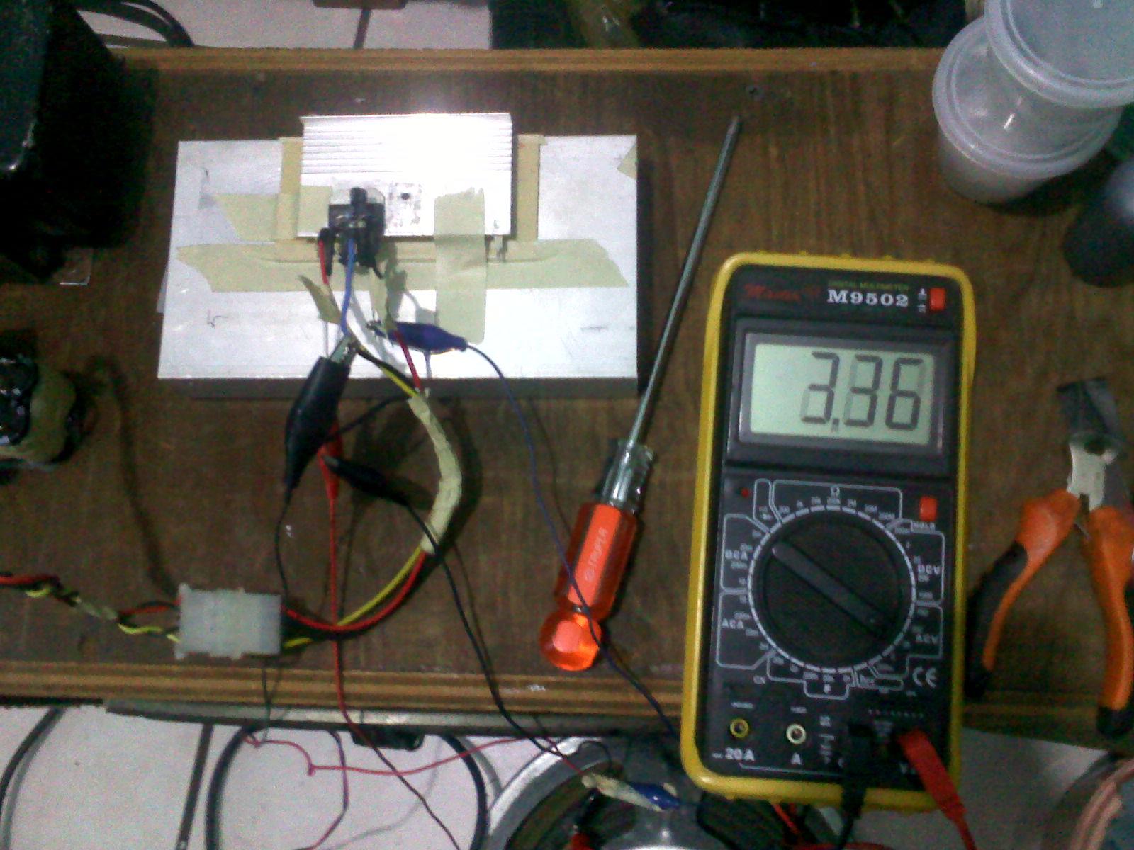

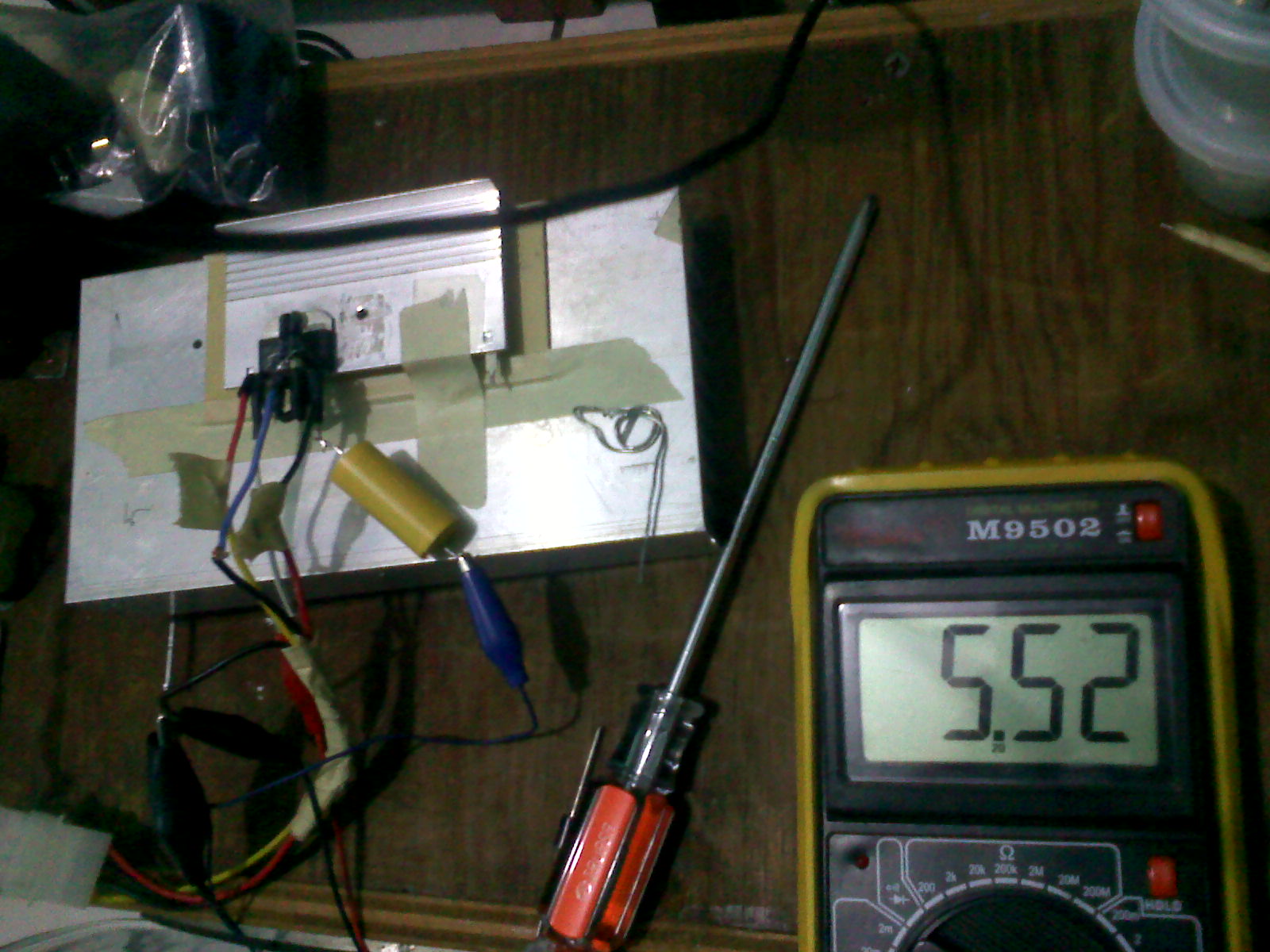

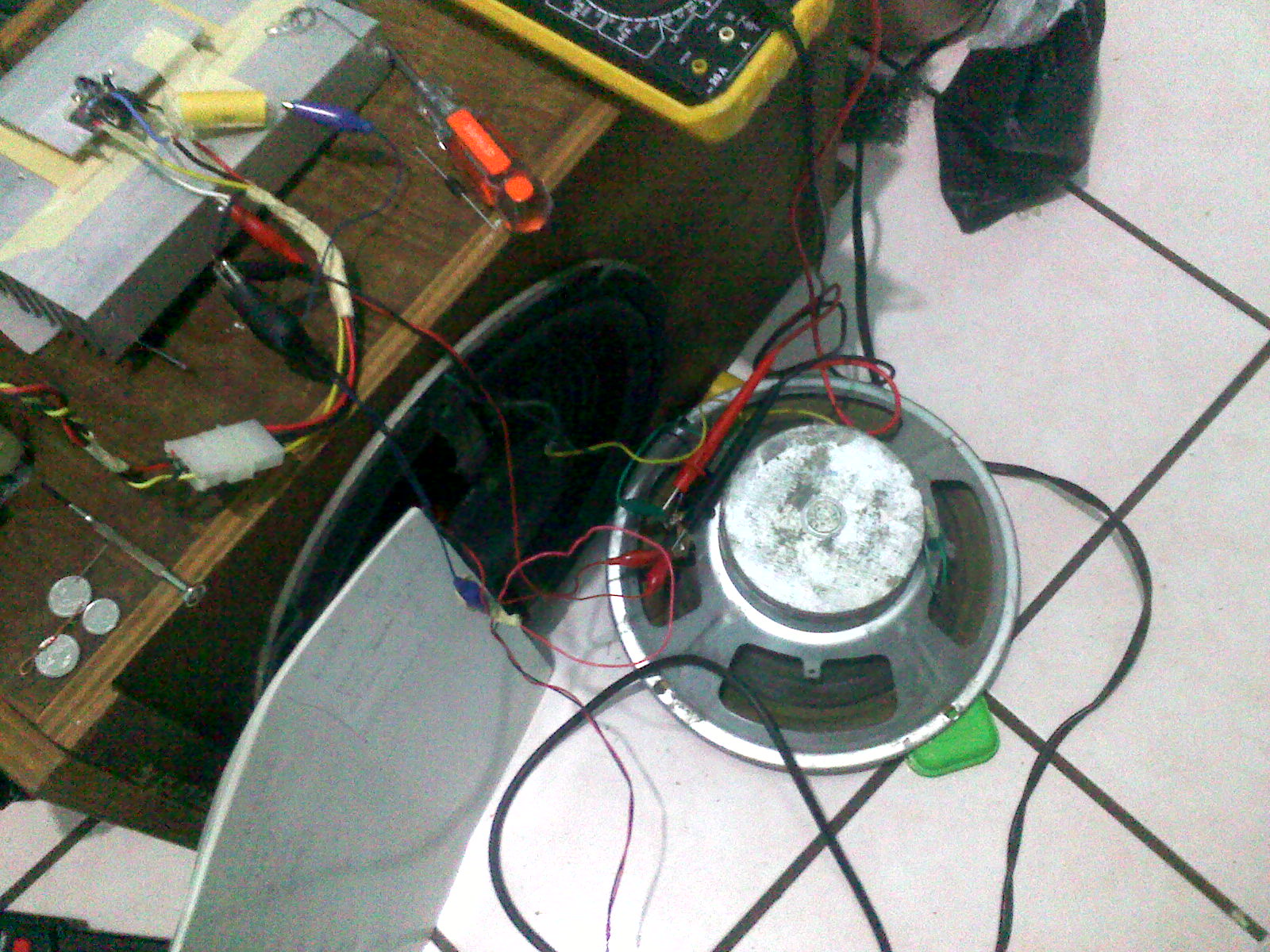

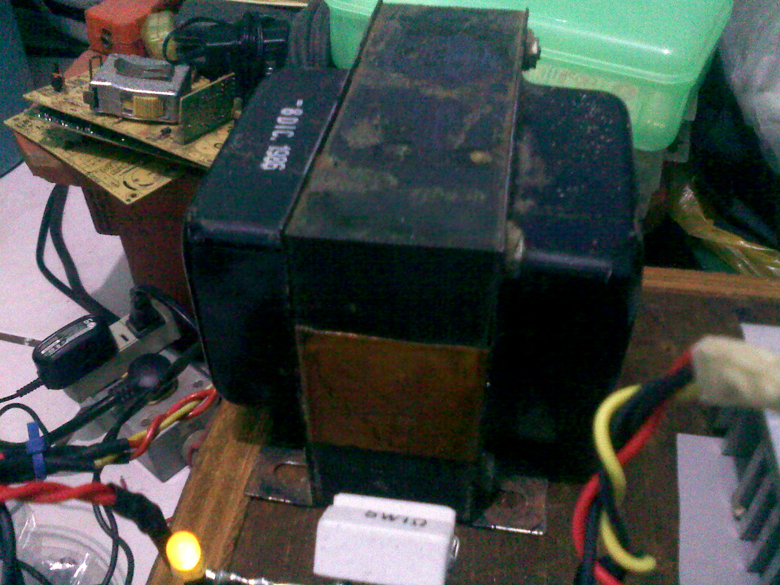

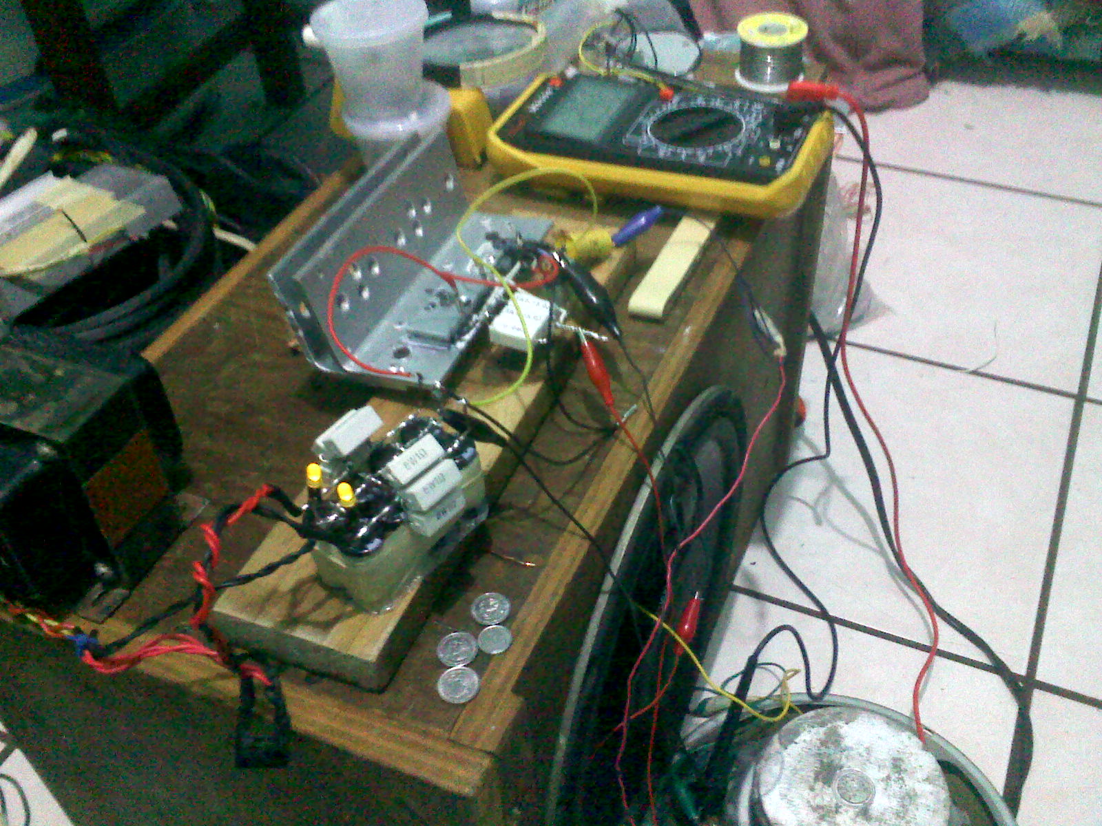

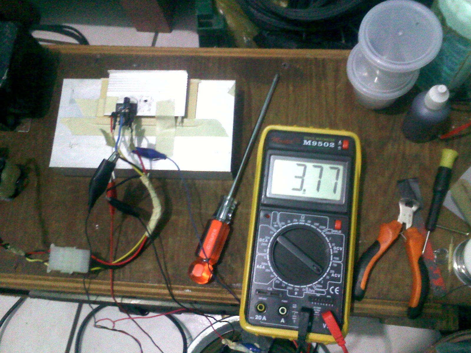

the second clone, 3886 with a fbstrg : 22k-1k-47uf, testing alone with a +-43VDC psu, no local pscaps, and with the speaker lose onthe floor, added a tweeter with a paper cap;It´s running warm and sounds good - not so loud but the speaker is very bad and i think its kind of hard or sticky or something but its very ineficient. i´m getting decent bass for the kind of situation...
after burn in i´m going to fit a pair of MJL3281A/1302A and test again.
the speaker is moving around, vibrating with the o freq content of the music!
added a 3.3uf film inputcap.
the meter is showing ac volts across the speaker terminals.
it has .5 mV dc voltage at the output, no signal.No noise, depends on the input cabling, just needs firm connection and noises go away.

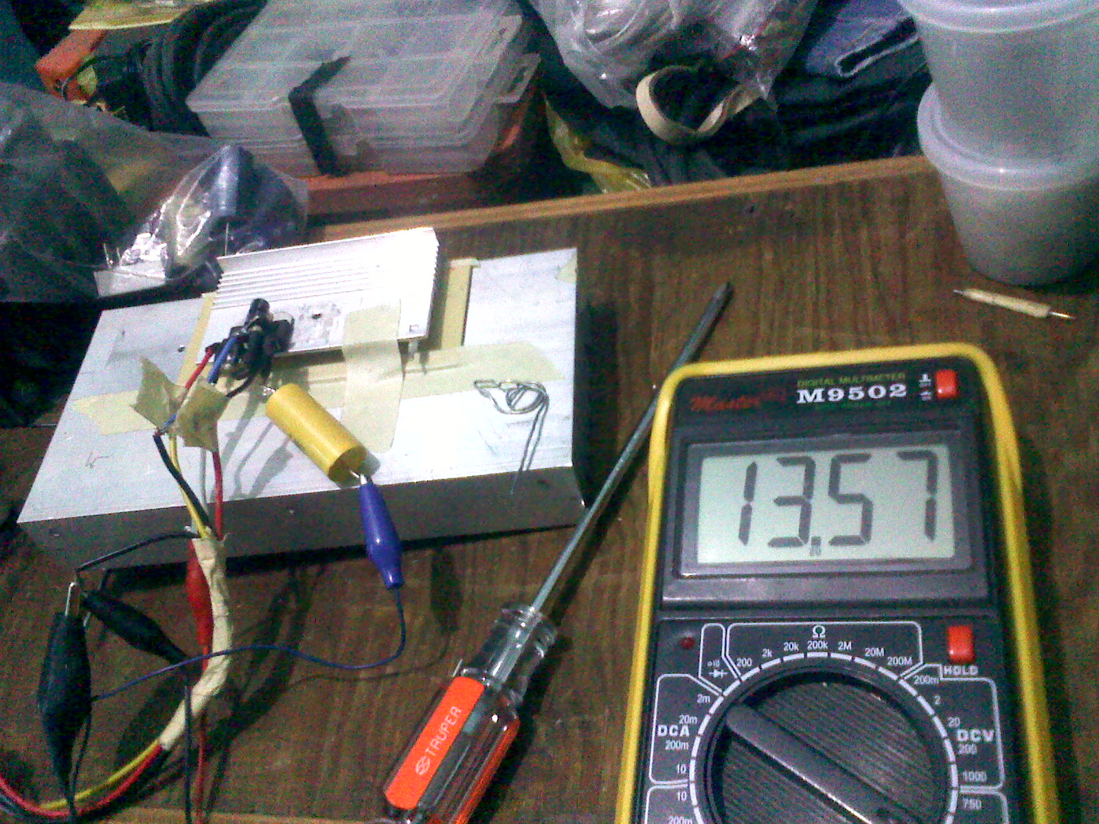

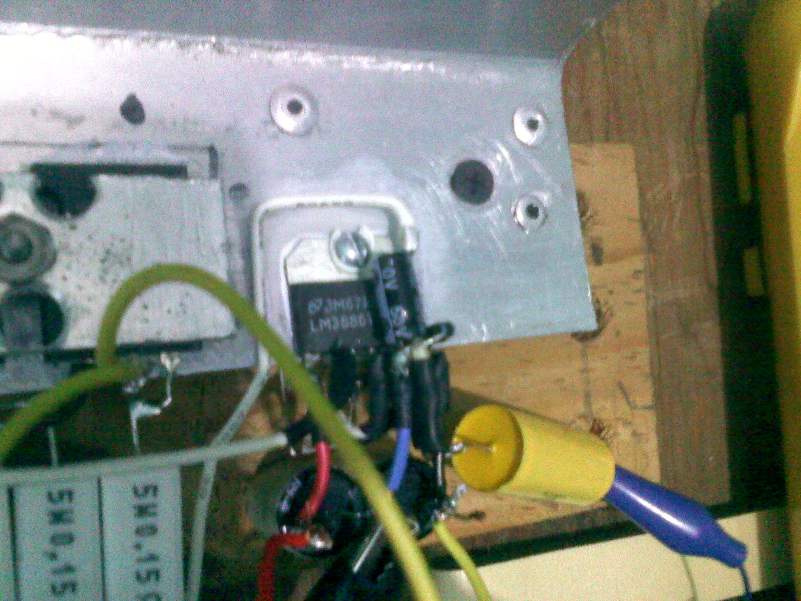

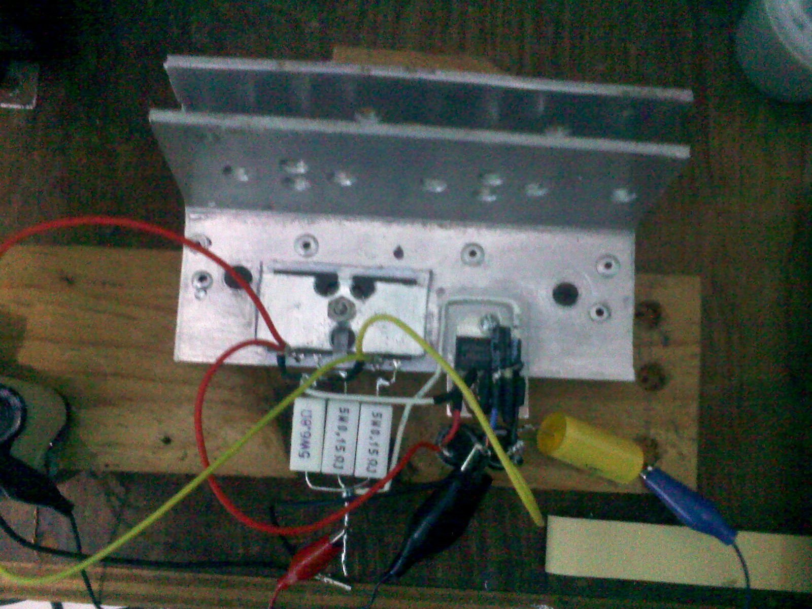

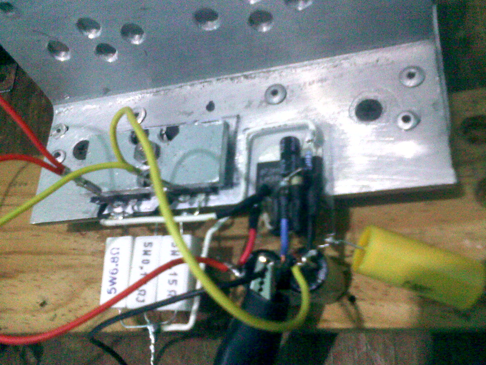

hi it´s alive!
Here´s it with the 2SC5200/2SA1943 pair. It was running very warm by itself, maybe hot; it might had to do with the thin heatsink, and it was lying on its back, the 46V rails etc. Now its warm to cold and sounds OK! bass is deep and clear punchy even tho i´ve the bare speaker lying on the floor. still need to test on 4 ohms. Haven´t tested fets, was about to get a MJL3281/1302A pair, but did not wait.The mids are really good with 3886, need to test with better speaker for lows; highs are nice with my old paper cone tweeter thru old paper cap, destiny speakers are two 8 ohm -4x6in driver- cabinets.So you just need to try...

hello wiljj78: check this one is very good same circuits with some mods: 2x470uF very close to the chip, local decouple, 3.3uF input film cap and 47uF fbcap. Also higher V rails +- 43.6V noload sounds really good and runs cool! with just a chunk of aluminum from an angle piece, cut and riveted.

Martin,
your clamp on the two output transistors has just one bolt between the devices.
This is very likely to give a poorer thermal transfer than using the normal one bolt through each transistor.
If you adopt clamping instead of through bolting, then you must use a mechanical system that ensures the whole transistor backplate has even contact pressure across it's whole surface. This is normally achieved by inserting at least one bolt on each side of every device and located fairly close to each device.
Hi there everybody, this amp is very good sounding and cool, still have to check at 4 ohms, full bast.
Mr. Andrew, used this way of clamping the transistors, copying from another amp, but as you pointed maybe i will change that to a larger piece of metal and use two screws, or three? Thanks for your attention!
Still waiting for those MJLs! maybe for the double pair of transistors amp, next amp.
