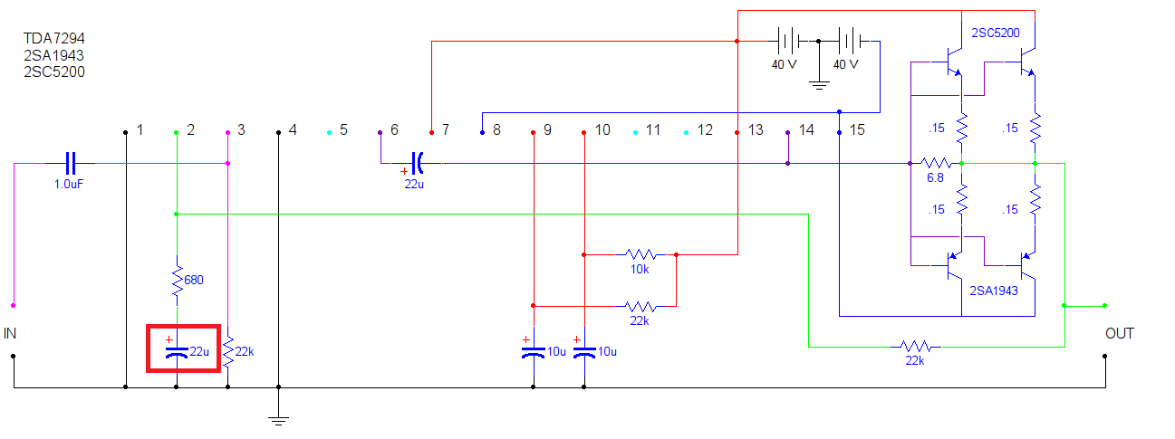

hi , i am very sorry if there is misunderstanding; the feedback string in my amp is:
22k, 1k and 22 uF electro, with the positive facing the chip.
And it is based from many examples found on the web, maybe itis not correct, this schematic was adapted from the one i found at Soundwesthost , ESP or Elliot Sound Products web.Mr Elliot uses that, so i made the last one that way too. I must say that all my previous clones were made without a cap, just the 22k-1k resistors and they sounded very good; also i am about finishing another amp with the Fbk string values as recomended by Mr Daniel W from this forums that is 100k-2.7k-220uF but still have to finish it and test.

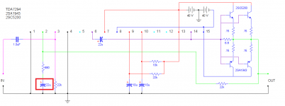

Thanks for clarifying this point martin, in reference to dr frost scheme i follow the electro caps polarity as per below.
There's that 22uF again.
The passive input filter using 1uF and 22k gives a turn-over frequency (F-3dB) of ~7.2Hz
The NFB using 680r and 22uF has F-3dB of ~10.6Hz.
The input filter should be raised to >=15Hz, or the NFB filter reduced to <=4Hz
If you don't get a suitable ratio between the input filter and the NFB then the NFB capacitor will have significant AC voltage across it. That is not good for amplifier performance and not good for sound quality.

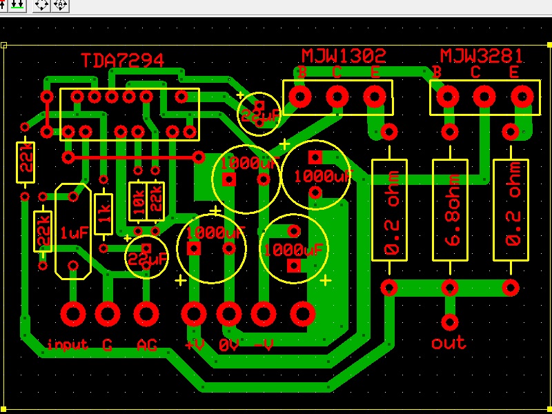

I got a bunch of MJW3281A/1302A transistors , they supposedly have a 200w/15A capability.. Do you think they would be suitable for this project ??
Thanx
Thanx
yes, any transistors and mosfet's IF YOU USE THE DESIGN POSTED A FEW PAGES BACK!!!, if you blow your mosfet's then that's ALL on you.
But again for Minion, yes the 3281/1302 should work just fine, and quite powerful transistors i might add, as always you just need to play with the 6.8ohm if it sounds bad

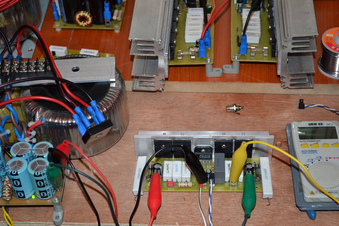

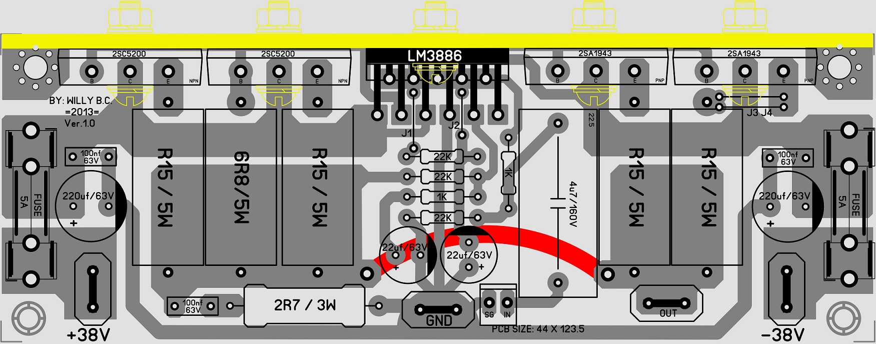

Tested and working LM3886 + 2 pair 5200/1943 Power transistor.... Rail supply +/-38VDC offset is 0.8mV and bias reading is 482mV on 10R/10W resistor at +/- rail, the amp is dead silent and no power on thump......
@ dr frost and Martin, please advise what need to change to increase bias on 10R/10W resistor.

Hello Martin and Sorry if i didn't elaborate my message clearly because it's kinda late already in my place when i try post my message....😀
10R/10W resistor have used instead of light bulb tester when powering up the amp for the first time and Yes i'm getting .8mV dc offset at +/-38VDC rail supply.
10R/10W resistor is connected under the board instead of fuse on my first power, and measuring voltage across 10W resistor I’m getting 482mV on + rail and 556mV on –rail at iddle, I must say that this is the 2nd way how i get my output bias reading in my other amps (aside from the primary way of course by measuring the voltage across output emitter resistor).
Also I notice on heat sink temp. (Behind the IC portion) was getting warm a lot quicker when i crank up the volume compare to the power output transistor portion.
I'm really curious how to increase the bias on the output transistor in this typology at lease by achieving 1.5V per rail across 10W resistor.
Anyway I’ll try to play around the sync resistor as dr frost said and will update the result.
Thanks for your quick response Martin, really appreciated...
