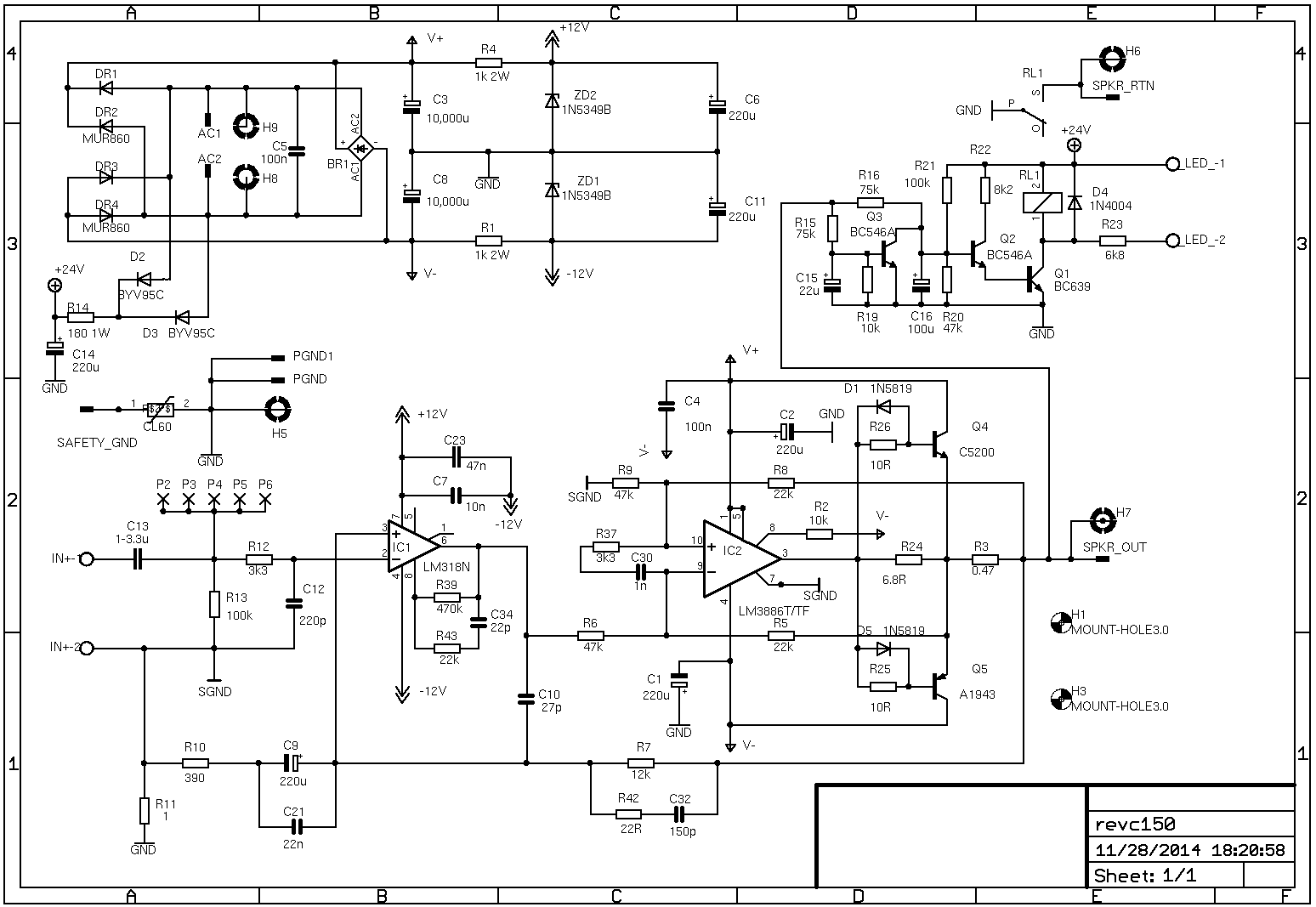

I have just finished an experimental schematic and layout for a MyRef Rev C derivative with 1x LM3886TF + 2sc5200/a1943 as a Class-B emitter follower. Intended rails are +/- 40V, expected peak swing before clipping is +/- 36 Vp, giving a nominal 80W into 8R (almost double the regular MyRef's 40W).
The LM3886 is not expected to source/sink more than 0.2A in this configuration, so it should effectively keep SPiKe disabled even at relatively high rails of +/- 40V. It should also be possible to use output transistors (Sanken, On Semi) with more robust SOAR and potentially drive 6- to 4-ohm loads comfortably.
The Howland feedback loop as well as the GNFB loop are outside the Class-B power stage, so they will do their bit to contain some of the crossover artefacts, apart from turn-off speed-up diodes connected to each base.
No idea how it will sound, but it can't be worse than just a chipamp + Class-B BJT current-booster, which many people seem to be very happy with.
interesting coincidence, i'm working on a nearly identical approach but using dual chipamps (LM4766 and LM4780)
Cool - LM4780 will work for a 2-channel board. I need to check on the maximum supply voltage specs of the LM4766, but IIRC it's quite a bit lower. It's also a bit harder to find locally than the LM3886. TDA7265 is readily available and inexpensive, but supply voltages max out at about +/-30V or lower.
