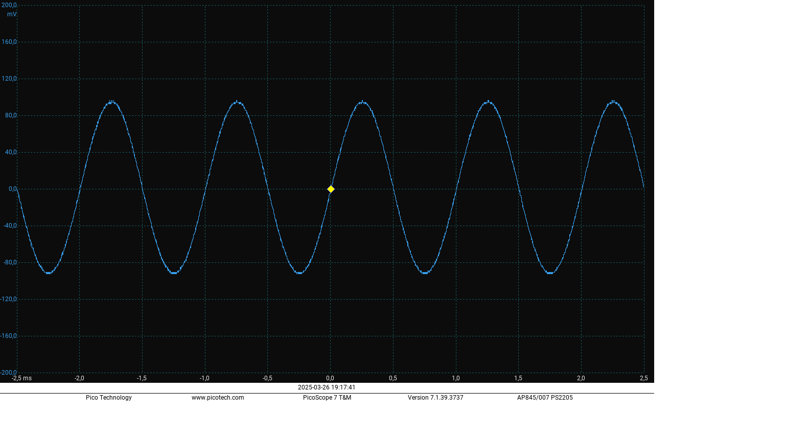

Oscillation and/or eventual clipping?Not really sure what is going on here?
10 ohm load seems way too low for a 741.
Also do make sure the op-amp is unity gain stable. I could not find any information regarding that on the data sheet ...
Yeah its pretty low, what i found though, I went from 800, 100 and then 10.
While loading with 800 or 100, I seemed to get a very random oscillation that was actually not even a sine-wave, it was a squarewave.
So i must have messed up somewhere, but I do not really find with what

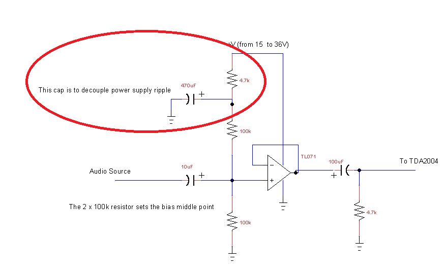

Alright,
Thanks everyone for chipping in.
So first off. I did try feeding it (TDA2004R, not opamp) with 2 different mp3-players and lately a more modern mobilephone via the headphone jack. It is the same 2nd harmonic, unfortunately.
Later I did pull out a TL081 instead that i found, moved it over to a "new" circuit with a soldered protoboard instead. With the exact circuit as the one posted above, including values.
Unfortunately results are very poor anyway. This time around i get my sine-wave, but output has a very very low amplitude compared to the input for some reason.
Turns out this op-amp adventure was way more finicky than i thought 😵
I need to tripple check this also of course, but looks like this op-amp thing might introduce more errors then its helping right now, especially since its being very very delicate if I understand correctly.
When I get more time I will see if I can redo the whole thing again!

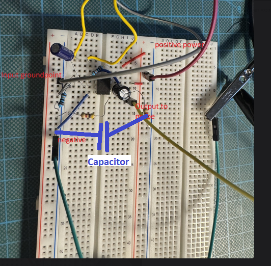

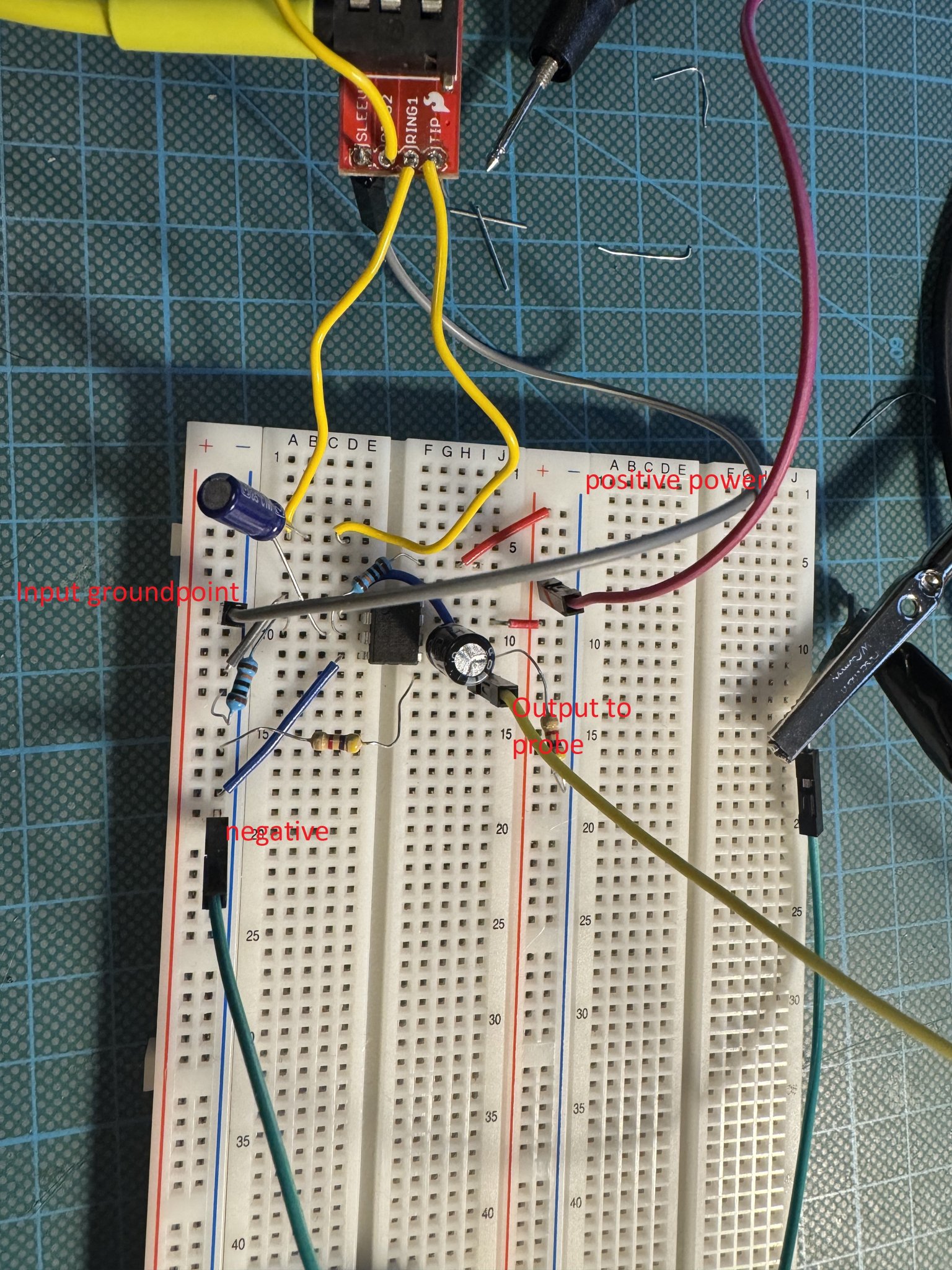

Hi!
It's not easy when in protoboard or in untested PCB.
See below, what my setup looks like while we were discussing since the begining so you can compare with yours.
In the protoboard, I added the opamp with single voltage, the same of the TDA2003 following the schematics I suggested.
Note that there is no ground high current flowing in the protoboard.
Ground goes directly to the heatsink and from there to the speaker.
High current only in a single connection from TDA to the output capacitor and the +V rail, which only feeds the TDA and the opamp.
This way, I don't create spurious GND voltages along the protoboard connections.
This setup has less than 0.3% of THD as seen in the picture.
But if I play around with decoupling capacitors, move the GND connections, move speaker connections or put big resistor (>47k) in series with TDA input, the 2nd harmonic shows up at around 1% same as yours.

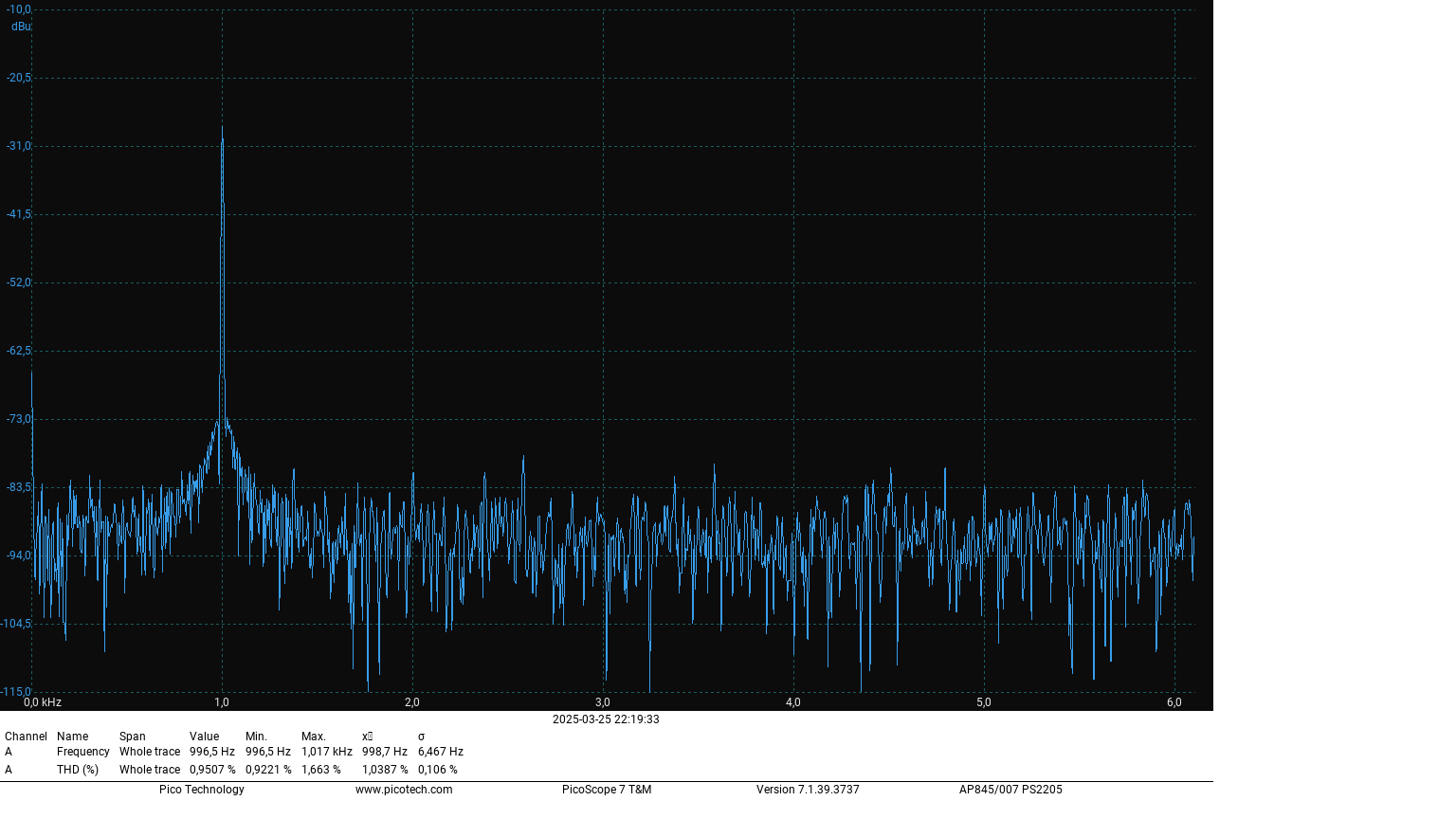

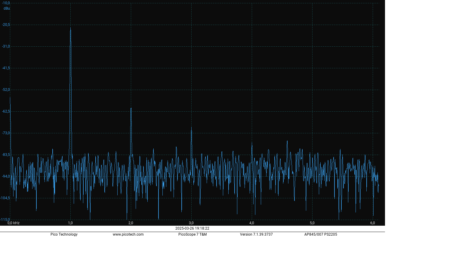

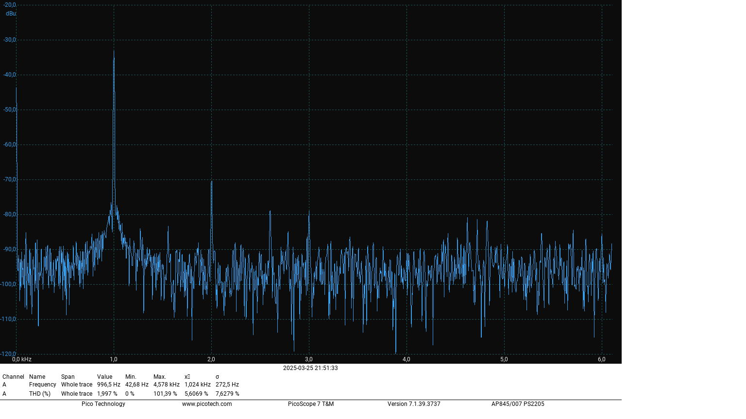

Alright! So third times the charm. Now at least I got a signal, about the same in as out, and this is what is intended I hope? As we are aming for this as a buffer.
However, In my first measurements I got some really disappointing results. Its even noisier in the output than the TDA, please see the attached screenshot.
Clear 2nd harmonic is still there, plus a lot of other stuff going on I think it looks like?

Just one "click" below when 2nd harmonic dissapears:
Now some observations on tonight's tests:
- I did dab around a bit with decoupling capacitors, however it did not really make a difference.
- At least now this 2nd harmonics or the others does not reflect on the player side, so that's a good start?
- There are a very distinctive difference in the 2nd harmonics if I go above 50% volume on the player
Since the circuit feels pretty noisy and we hunt a pretty small issue on the "real" problem, i guess a attempt to move the circuit to a soldered stripboard would be next course of action?
Oop, should add that the above measurement is still just the op-amp stand-alone. Only the 4.7kohm resistor and then the oscilloscope hooked up,

Hello!Oop, should add that the above measurement is still just the op-amp stand-alone. Only the 4.7kohm resistor and then the oscilloscope hooked up,
Ok, at least some buffering function we are getting - there is no 2nd order harmonic reflected to the source.
I understood that when opamp is disconnected from the TDA, it is clear (2nd screenshot) and when you connect it to the TDA, you get all the noise signal (1st screenshot).

Hey! Thanks.
So lets back up a little bit, I might not have been as clear as i thought i was 😀
I still have not tried the op-amp with the TDA, all measurements so far is a standalone circuit, before involving the TDA.
The two different measurement you see, is with only oscilloscope and the 4.7kohm resistor from the circuit.
The measurement with distortion is when i go above like 50% or 60% volume on the player, and the one without is just one "click" down from it in volume.
So, Maybe the op-amp needs to be loaded down more or something of that sorts? I wanted to get the op-amp as good as possible before messing with the TDA again, just so we can know we are not introducing even more errors.
However it is still true that the 2nd harmonic observed on the output of the opamp does not "taint" the input of the opamp, as the situation is with the TDA currently.

Alright! New measurements incoming. These are a pair, normal time domain in one and FFT view in the other!
What do we think about it? I dont think its a matter of clipping at least, but today one can clearly see that we even got a 3rd harmonic now even 4th maybe?
So it got more unstable over night 😀

Hi! Ok, THD is -40dB (1%), so the sinewave looks clear. This is the point where we really need spectrum analysis to check harmonics.
In this case, is the input real clear from harmonics? Cause the opamp looks quiet and the signal is small (100mV), thus way far from clipping.
One thing I missed is the bias decoupling RC as shown below. In single ended like this, it is a must.
If you don't do that, any noise from power supply, including ripple, will be injected to the opamp input.
Values are not critical, but use an RC with fc way below 1Hz (fc=1/(2*PI*R*C))

Great! Okey, I see now that I missed to put back the 470uF capacitor at the 4.7kohm resistor, I tried to clean the circuit up a bit, and forgot that of course.

BTW I see also now when checking my own picture that I might have confused something.
In the schematic, is offset N2 directly connected to V+? If so, I see I made a major mistake 😀 😵💫

Hi, I didn't understand the question. What is N2?In the schematic, is offset N2 directly connected to V+?
