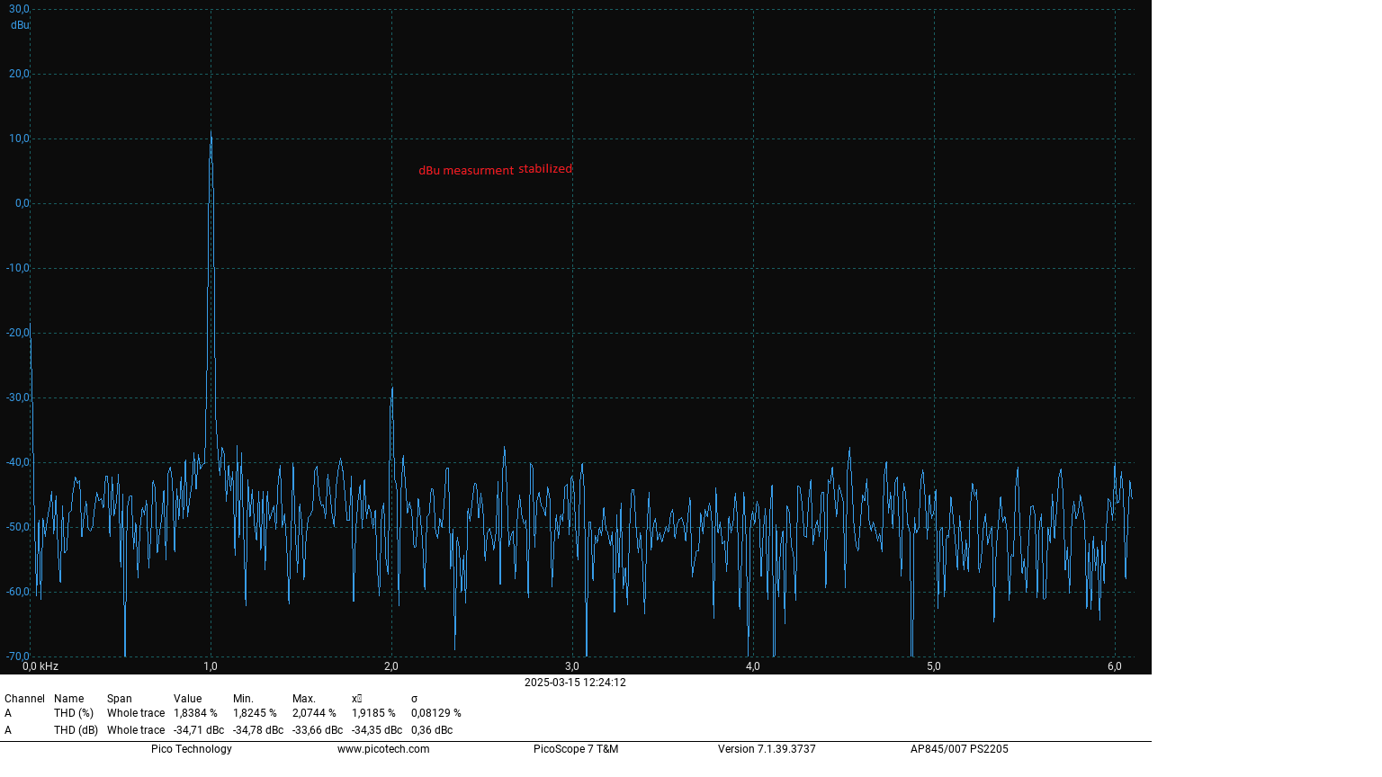

So, finally got some time over to do some more measurements as per your ideas, thanks for that.
Still using the exact same circuit until all measurements is made.

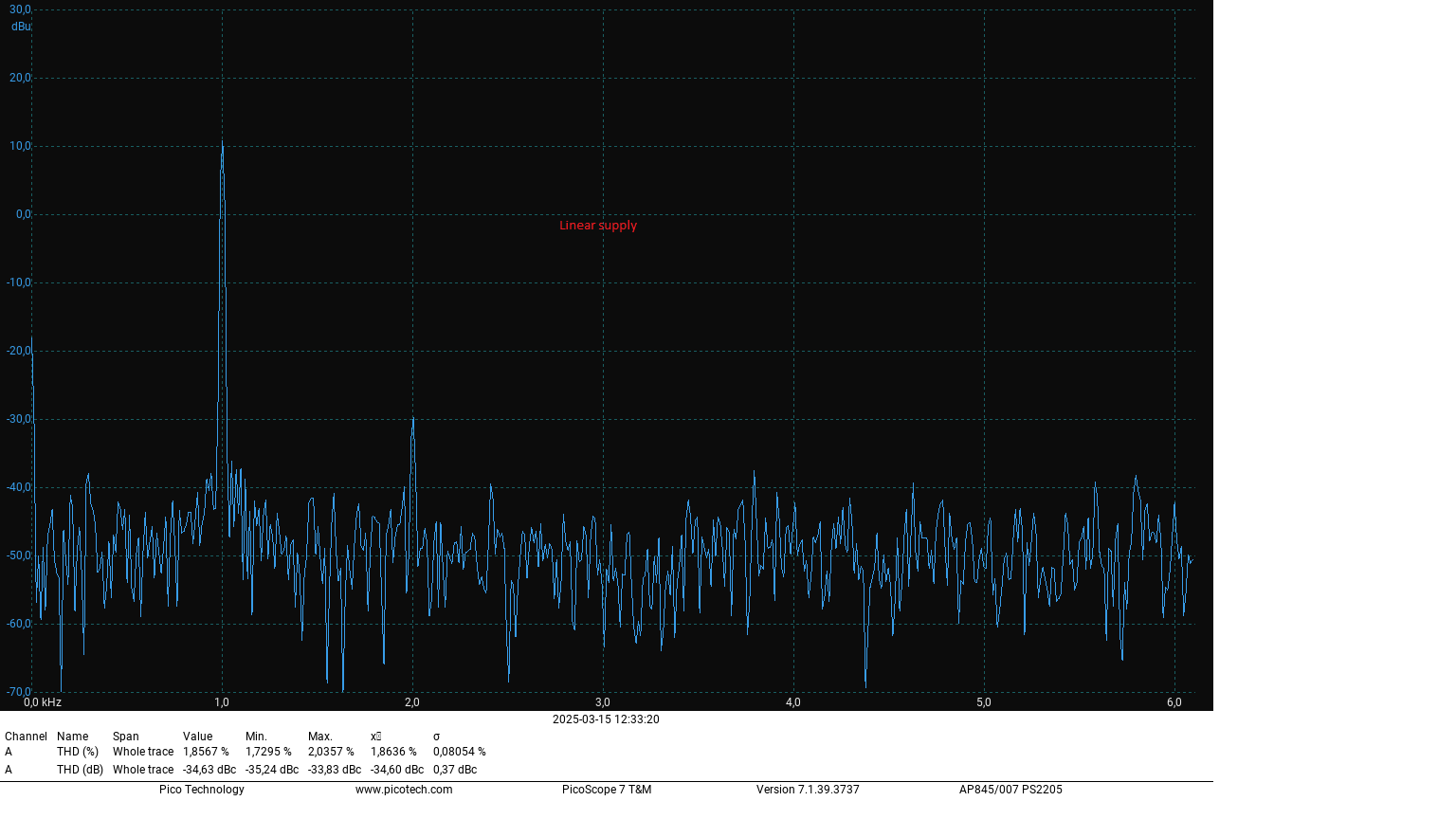

This time using dBu instead. Now this is a measurement i am not familiar with at all, so bear with me and the settings 😀
Settings: 512 bins with window function "Hamming". The second harmonic is clearly visible in this mode also, so i think i got the settings right.

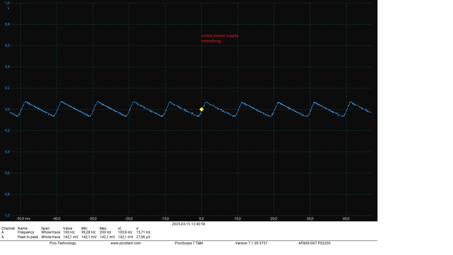

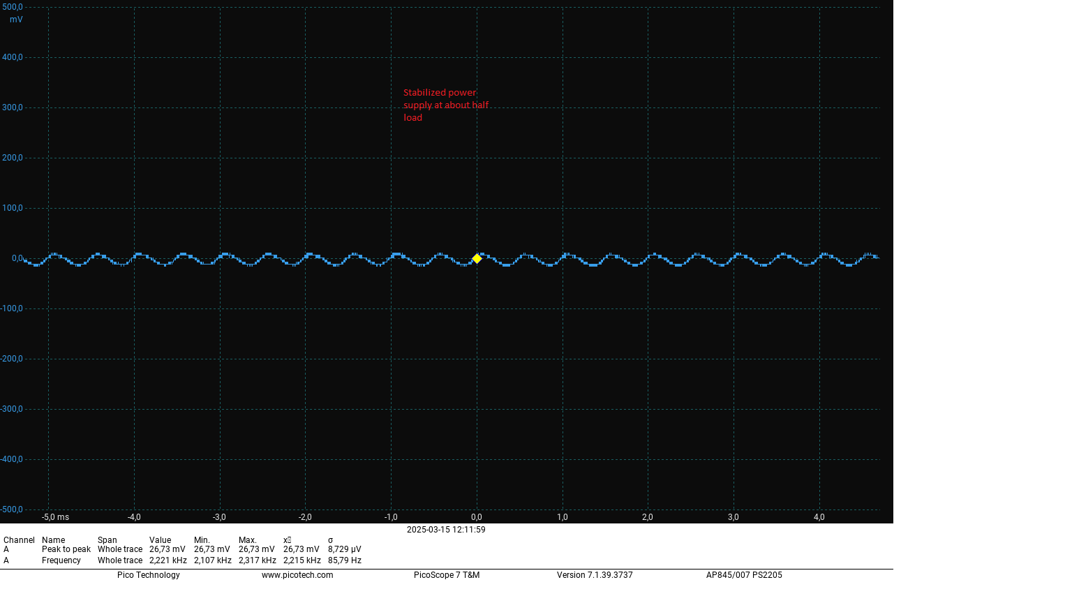

I did measurements both with my stabilized PSU and with a linear supply i pulled together out of scrap parts. consists of a toroidal transformer 12v 50VA and 4x 3300uF smoothing capacitors.
Surprisingly (or not?) the second harmonic is about exactly the same.
Now, the linear supply might need some more smoothing, I include a measurement of that also, if anyone wants to have a look at that if its acceptable cap charge ripple or not. However, don't think that might be the cause, since distortion is nearly identical between the different power sources
I did tag all the measurements in the pictures themself.
dBu with stabilized psu:
dBu with linear supply:
AC scope view of stabilized psu:
Smoothing caps analysis of the linear supply:

Hi! You can see now that is much better to look in a dB scale when comparing very different values. The difference is around 40dB, which is 1% - it's the same circuit as you said. But now you know how to better observe harmonics. Just a hint: before going to this FFT mode, always make sure the scope input is not saturated and not so "small" - set the sinwave to be clearly within the scope screen and then go to FFT.This time using dBu instead. Now this is a measurement i am not familiar with at all, so bear with me and the settings 😀
OK, so you concluded that the power supply is not the problem. And this is the normal troubleshoot procedure. We cannot disregard anything and we have to continue to narrow down until find the root cause.Surprisingly (or not?) the second harmonic is about exactly the same.
The 120Hz ripple is not a problem, since most class AB amp has high common mode noise rejection.
We have to go back to the PCB design or even consider a possible IC problem (is it original? We never no).
Maybe now you could try the list of suggestions I gave you.
With dB scale is much easier to see if anything changes.

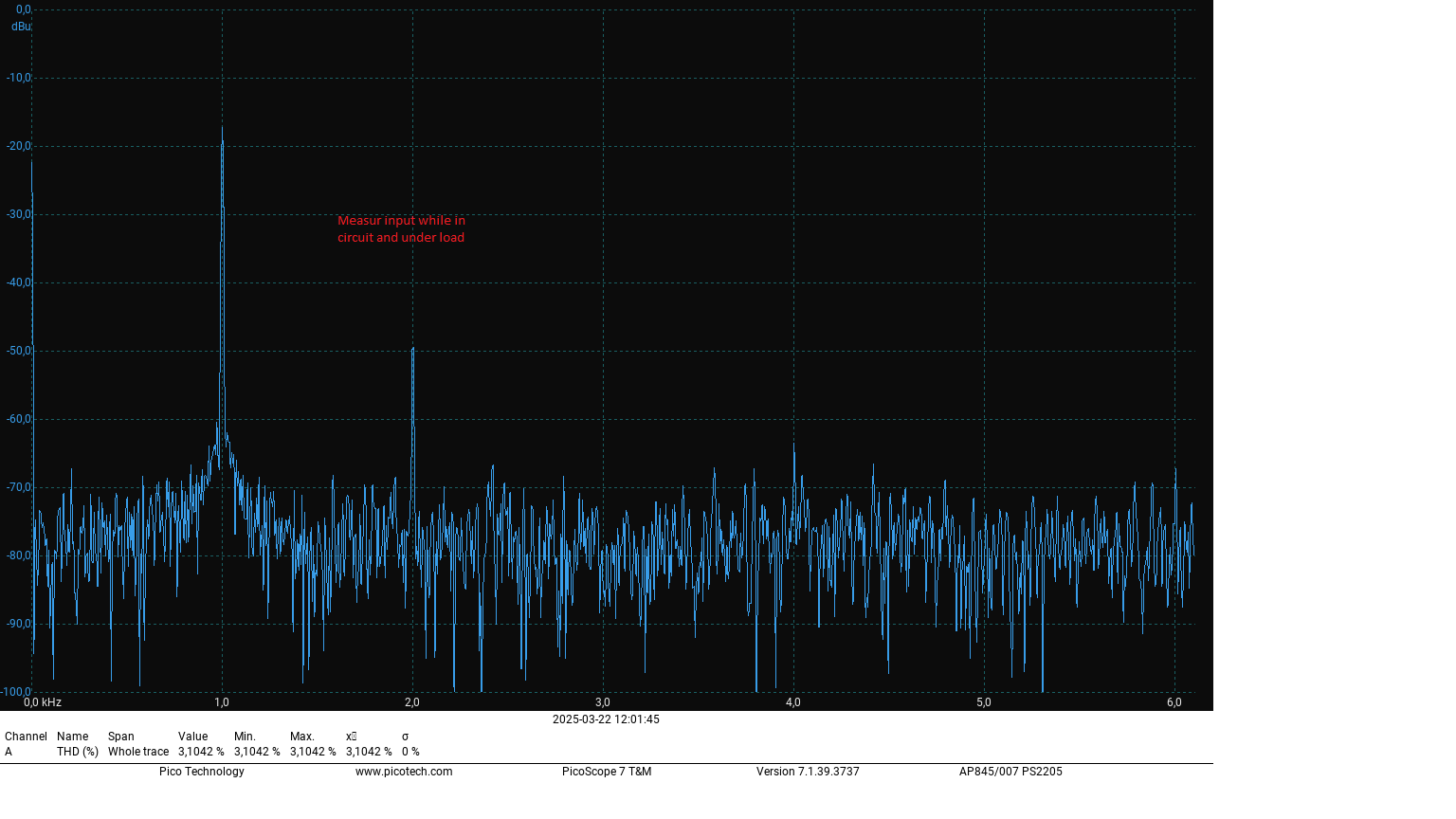

So, picked up the diagnostics today again, and just dabbed around a bit with grounding. Tried to ground on different places on the PCB, and also just straight to the GND-pin on the chip. What I noticed, a little bit to my surprise was the 2nd harmonic stayed virtually the same, no matter what I did or how i handled the PCB, it just stayed "stable".
Before pulling out some more caps from storage to try and add in the circuit as suggested, I did one more last sanity check. I used a different player, same.
Once again I measured the player output, the 2nd harmonic was still not there, so player good.
BUT, then I had the idea to measure the output on the player, but while in circuit and amp powered up, then the 2nd harmonic shows up exactly as it does on the output.
This to me points to a issue with player output/amp input while the source is "loaded"? Or can we get fooled in other ways while measuring player output while in circuit?
To add to this, if the circuit is powered down, with just player playing in to the circuit, the harmonic is not there. The amp need to be on, if that is of any indication.
I add a screenshot to show, this is measured at earliest input from player on PCB.
What do we think about this?

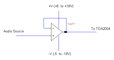

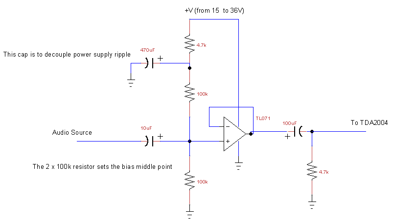

Hi! Interesting.
So the amplifier itself is not creating this 2nd harmonic, it's just amplifying what is in the input.
I'd make 2 tests:
1) GROUND ISSUES: Check the ground point of the input source (player). Try to connect the ground to another place, such as close to the ground power supply or exact on the speaker ground. This way, we check if there is any spurious current flowing in the PCB track, generating voltages along the PCB and causing this distortion. Also when measuring, try to put the scope ground lead to different ground points such as the input ground, power supply ground and speaker ground.
Since you mentioned that with speaker connect the 2nd harmonic is there and when the speaker is not connect the harmonic is not present, it might still be a ground problem.
Ideally, all ground points on PCB should be equal, but we know the resistance or even the impedance of a track is not absolute zero.
2) INPUT IMPEDANCE: The minimum input impedance of this amp is quite high (70k ohm) and should not influence the source. But it might be not linear and might be loading your source of signal.
In order to check, you can lower the input impedance using some resistors (just for testing) or driving the TDA amp with an opamp.
Here's a suggestion, but you can play with different resistor values, The lower the resistor that goes to earth, the lesser will be the influence of the TDA2004 impedance, if this is the case.

Oh, and also the OP-AMP idea is interesting.. I think this might be my next way?

What is interesting here, is that there is virtually zero difference, which is weird, or good? I did expect something to happen at least, especially if its the circuit itself that create this distortion.
But then again, the PCB is constructed with GND-flood, so I think this makes sense.
As for the input impedance test, I don't have a good way to put a series resistor as I'm stuck with what i have before the POT.
However, for sake of science, I did add a 1k to GND at input, but no difference there either. That test though, might not be as effective as the one proposed!
Short of rebuilding the circuit on a breadboard, The only way to test the suggested input impedance change is to remove the pot and replace with the 10k ohm resistor. That might be the next step then I guess?
One thing i gathered so far with this, is that the 2nd harmonic is very "stable" no matter how i mess with it its always there and just changes amplitude together with the output.
Also, we do get this distortion on the input when amplifier is on. What could cause that?

You can test with the opamp, if it's easy for you, cause opamp has a very low output impedance and should not be affected much by input impedance.

Since we get this distortion also on the input, while under load, it makes a lot sense that it has something to do with the input impedance.
Next course of action must be the OP-amp if this can rule it out.

I see your diagram, but guessing I would need some further components, power and so on
I'm not familiar with exactly how to use that in circuit though, will have to do some research.
The opamp in this case will just act as a buffer with unitary gain (G=1).
What comes in, goes out. Very simple.
Just power it up with, +V and -V if you have a symmetric power supply.
If you just have single power supply, it can work too, but you need some more components.
See below the options.
Symmetric Supply:
Single Supply (it can be the same you use for your TDA if it is up to +36V.
Resistors/capacitors are just one solution. You may vary them according to what you have on hand.
Symmetric Supply:

Perfect, thank you so much for your schematic and all help, really learnt a lot during this work.
I was able to find a UA741CP among my parts, that does seem to have the same pin-config as the TL071 and is a general op-amp.
Checking the datasheet, it looks to me that it might work as a substitution for TL071. What do you think? Maybe even your suggested values can be used?
I will be using single supply though, as that is currently the most convenient.

I gave it a shot to hook up the 741 opamp i had with the diagram above, but no go.
It gives me some strange output, no matter on the input. I think i checked over everything at least 10 times, but must have missed something.
