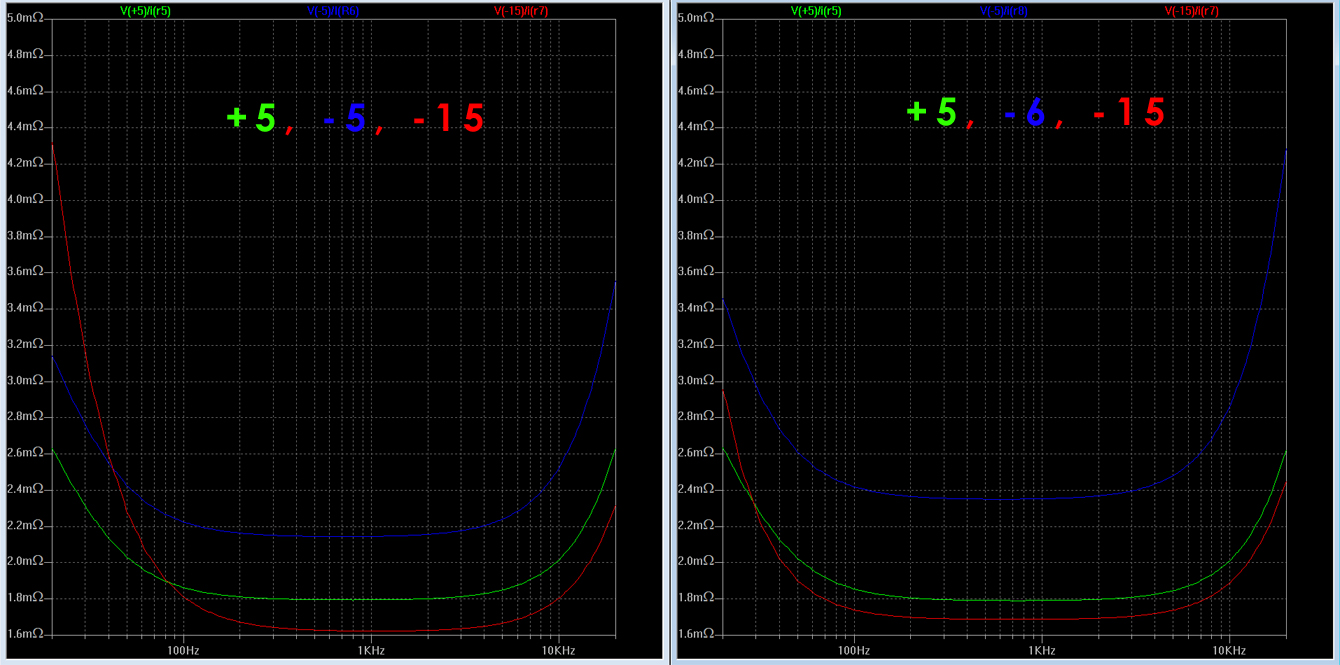

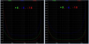

Hi All,
Just wanted to share this comparison between two slightly different PSU configurations.
In the pic attached there is a side by side comparison between -15,-5, and +5 VS -15, -6, and +5.
In this configuration with the stacked -6 and -9v(-15V referenced to ground) regs, the output Z for the -15V seems much better at the lower frequencies but at the cost of lower performance for the -6V reg.
A bonus is less heat dissipated on the -15v PNP pass transistor (940mW vs 790mW).
This idea is based on the fact that a lot of philips CD players had -6V instead of -5V (from what i've read on the net). Looks like its worth trying anyway.
Ryan

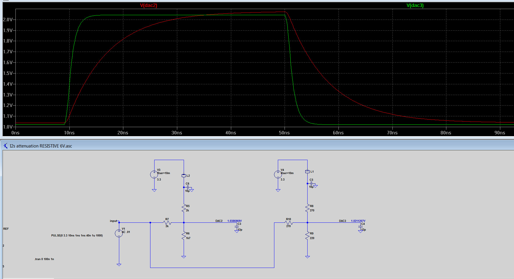

Hi All,
One last experiment before I commit to the final design.
The level of noise on the 3.3V reg was a little much for my liking, so i've modified a few values and added a ferrite bead to supply the reference voltages.
The trace in red is the scenario I will try for DATA L, DATA R and BCK. The trace in green is what i'll apply for LE (sample is triggered by LE in simultaneous mode). Note that if I was running in I2S i'd have BCK with the green trace (triggers the sample in I2S mode).
The idea for applying a much slower rise time for DATA L, DATA R and BCK is simply to minimise polluting the surrounding circuitry with high frequency noise, this includes power supplies and leakage into the substrate of the 1541a. These inputs are not as important in terms of timing, so long as they make it to the shift register when the sample is triggered.
Cheers.
PS. Ive installed a new clock using a citizen crystal (11.2896), The PCB is by Anton (amc184) Click here to check it out. Andrea Mori took some measurements of phase noise - better than the craptech 957. Im liking what im hearing with this new clock...

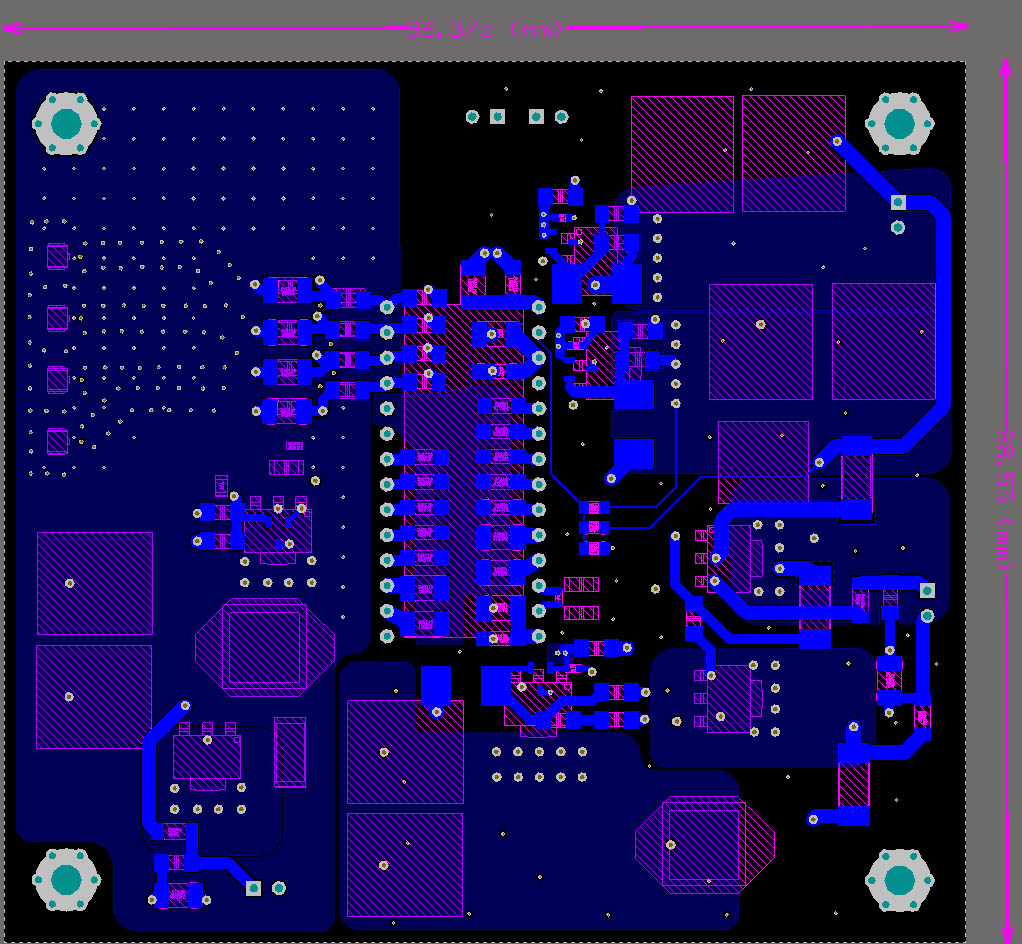

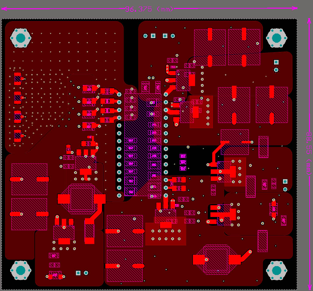

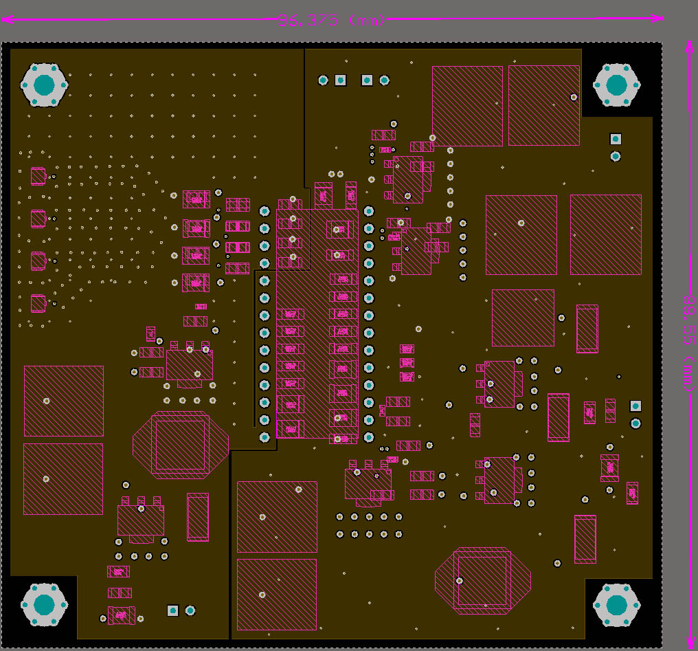

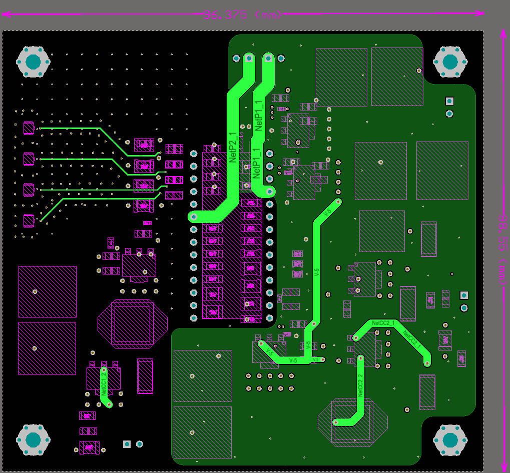

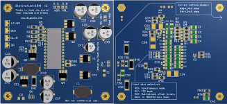

Update.
Hi All,
Distinction-1541 v2 is nearing completion.
I've added a 3.3mH inductor to the digital supply to be part of the current setting element, same as zenner string.
Added an extra cap to each power rail to bring impedance down past 100k (~5mohm).
Squeezed in 1210 footprints for pins 12,13,18, and 19 (MSBs)
Over the next few days i'll order one last prototype PCB to verify the changes I've made (not major changes, but i'd kick myself if there was an issue with 100 PCBs...).
Ryan

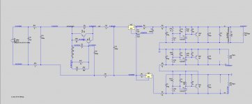

Hi Ryan,
can you post a necessary part list?
what about the psu? what is your proposal?
many thanks
Part list soon to come, just have to go through it again and make sure all is well. I will have time over the next few days.
For the PSU- I'll attach a simulation I've been working on. It's a basic schottky rectifier, CRC then to a Capacitance multiplier (kean tokens K-multiplier) + RC. Ripple rejection by the k-multiplier on its own simulates at around -60dBv. The k-multi has been reported measure very close to these specs. Not too bad for such a simple, clever little circuit. Output impedance will be about 50 mohms at 120mA (IIRC).
Ill attach the spice sim as well.
