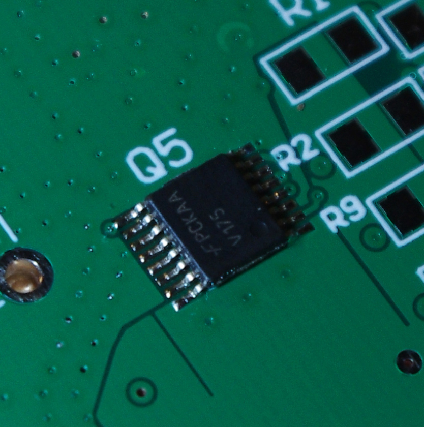

TSSOP soldered
Thanks for everyone's input.
Solder paste with a hot air gun (Mine is a Saike 898d) will be the easiest way to go by far - I had great results tonight. Picture attached.
All I did was smear solder paste on both sides of the footprint, not even worrying about getting any in between the pin pads, aligned the chip, and set my heat gun to 240 degrees celsius. It took about 1 minute to solder. Makes SMD soldering a piece of cake.

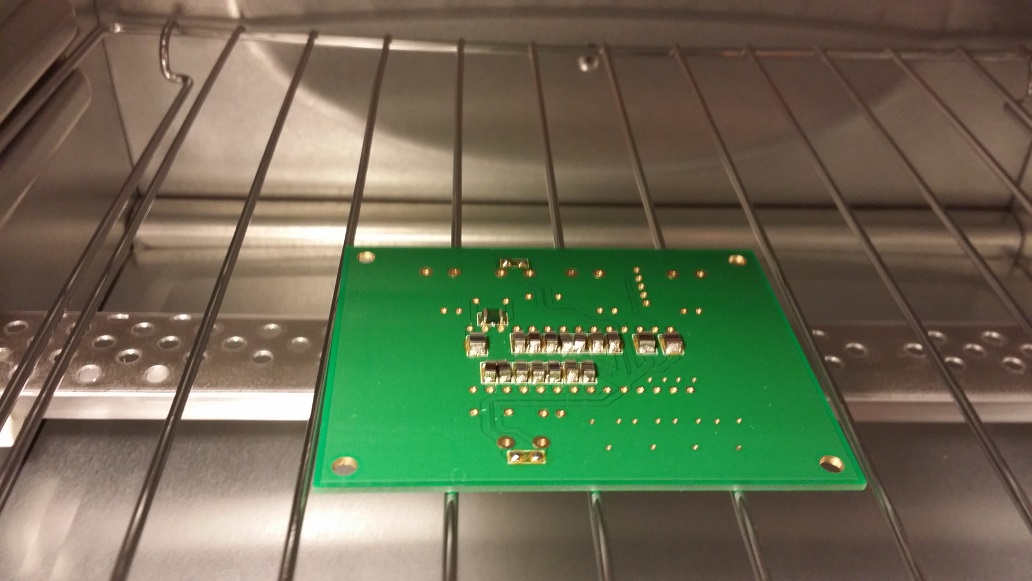

Hot air is good. Tips on the toaster oven include the obvious... the oven is used only for soldering. This stuff is poison. To do the flip side, just flip it over. The surface tension of the liquid solder hold them in place.

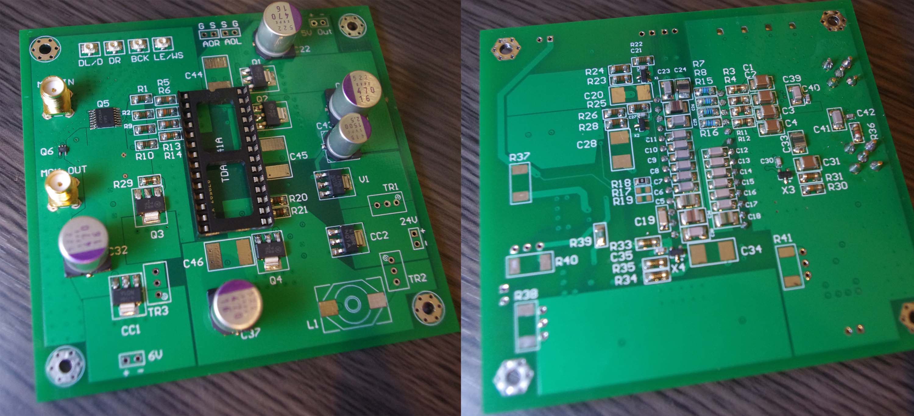

Progress.
Hi Guys,
Thanks to those who posted their advice/help on how to solder smd, i'm sure it will help many people out.
Just thought I'd post a pic of my progress. All going well, only minor hiccups so far. Unfortunately the 10uF film caps (C28, C20, and C34) are on backorder and won't arrive until early November. I might put a 10uF X7R there for the time being for testing - which is not too far off. Almost every part this far has been soldered using solder paste and hot air.
Up until now I haven't done much work to organise the prereg supply so i'm going to test run from batteries until I do.
