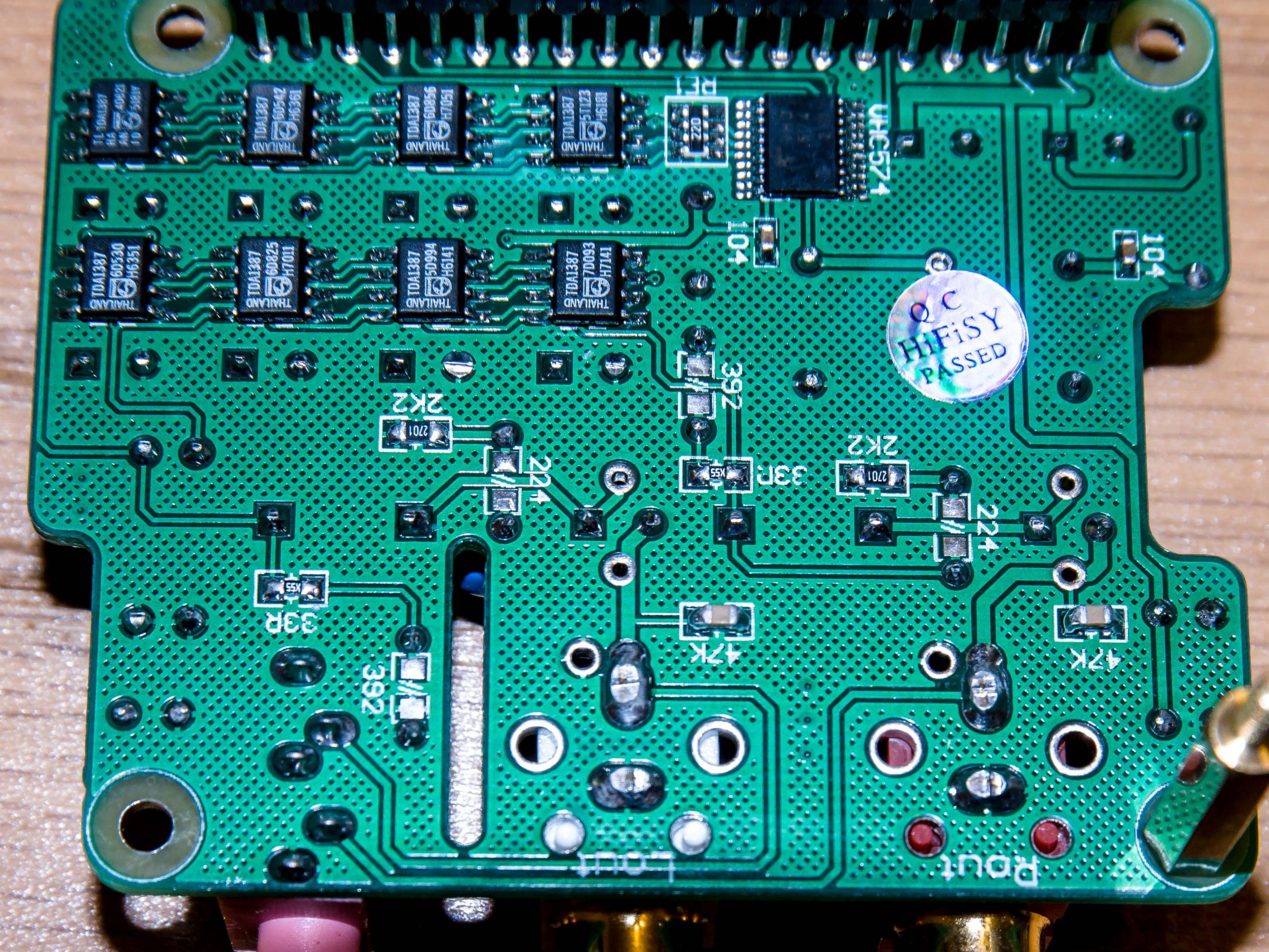

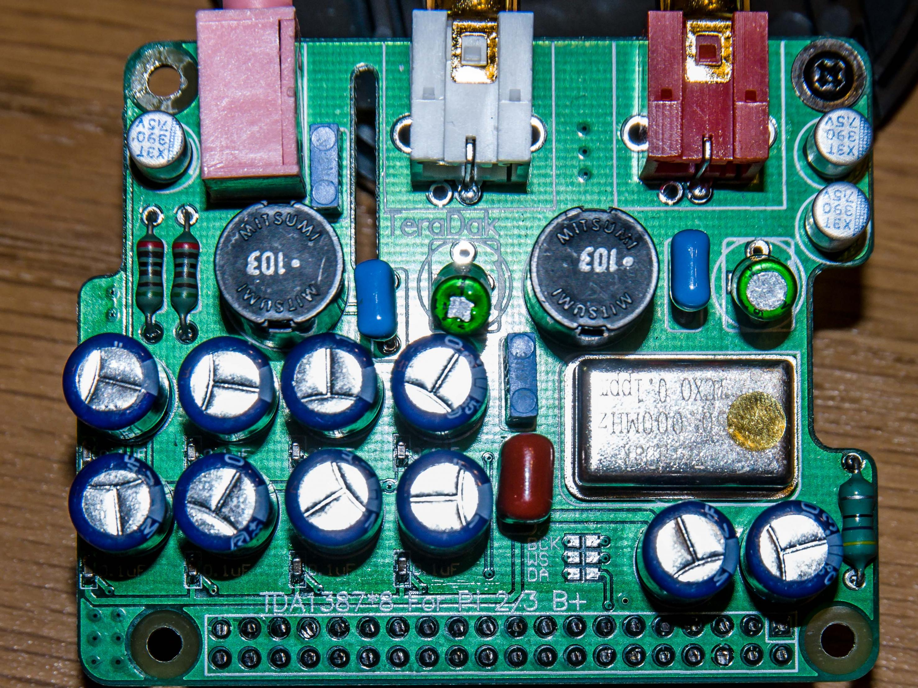

Hi, I just got the hi-hat 8 x tda1387 dac for Pi. Burning in right now, its a smooth sounding dac with decent bass. I am powering it with a portable phone battery with 2.4A current out.
This dac uses passive I/V out with caps and inductor for filter and Muses BP 10uf for coupling. My version has a 50mhz TCXO 0.1ppm crystal .
I worked out the signal out from tda1387. The inductor is use for filtering high fz noise from dac output. I suspect the passive out filter can be further optimized. I have a cheap portable scope, but I don't have the knowledge to measure the output.
TDA1387
=> I/V resistor 500 ohm
=> RC to ground 33R +3.9nf (square blue cap on board)
=> Inductor (marking 103)
=> RC to ground 2.7k + 0.22uf (round blue cap, but resistor label 2.2k)
=> Nichicon BP 10uf for coupling
=> smd cap (label 47k) piggy back with COG type at bottom (my guess as the cap looks lighter)
===> RCA out

As far as I can work out this board is using passive I/V (the 560 ohm resistors look to be the best bet for doing that function). Whereas the mod to the original DAC deletes the 2n2s in the feedback loop around the output I/V opamp. Meaning that if you've got harshness you're not likely to tame it by removing the 2n2s.
560 ohm is too big a value for I/V - given the full-scale current (assuming 5V supply) is 8mA then the swing (peak to peak) of the output signal is going to be 4.5V which exceeds the compliance range of the DACs. Seeing as this looks to be USB powered 5V is a reasonable guess which means lowering those 560ohms to 430ohm.
The harshness in HF you're experiencing could easily be the result of having no isolation on the USB. Worth putting a USB isolator in between this DAC and your computer. You can get them cheaply on Taobao nowadays - for example https://item.taobao.com/item.htm?sp...7w1do&id=522874428774&ns=1&abbucket=12#detail

I can only guess why 560ohms chosen - perhaps the designer didn't read the DS carefully. Or perhaps it really does not clip at 4.5V output because the DS is too pessimistic? Its common to see DACs with the wrong values for I/V resistor - I seem to recall my Lite DAC-AH needed the values changing (reducing).
With the 560ohms you run into the likelihood of clipping at the highest levels of output. Yes they're the values where 620 is shown on the silkscreen.
I'd advise getting rid of passive I/V but such a mod isn't a simple matter, at the very least you'd need a handful of discrete transistors and a voltage reference. I'd then suggest a passive (LC) filter - partly to remove images as the DAC's NOS, and partly to EQ out the NOS droop.
The simplest mod though is to add at least 2200uF to pin7 (between pin7 and pin4) which gives a more clearly delineated bass.
