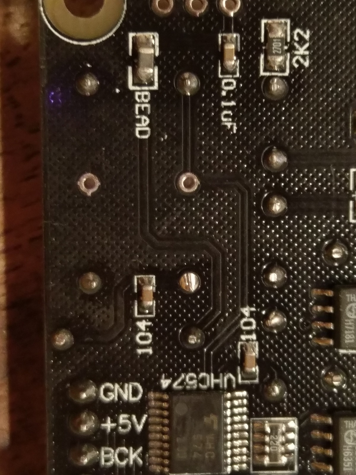

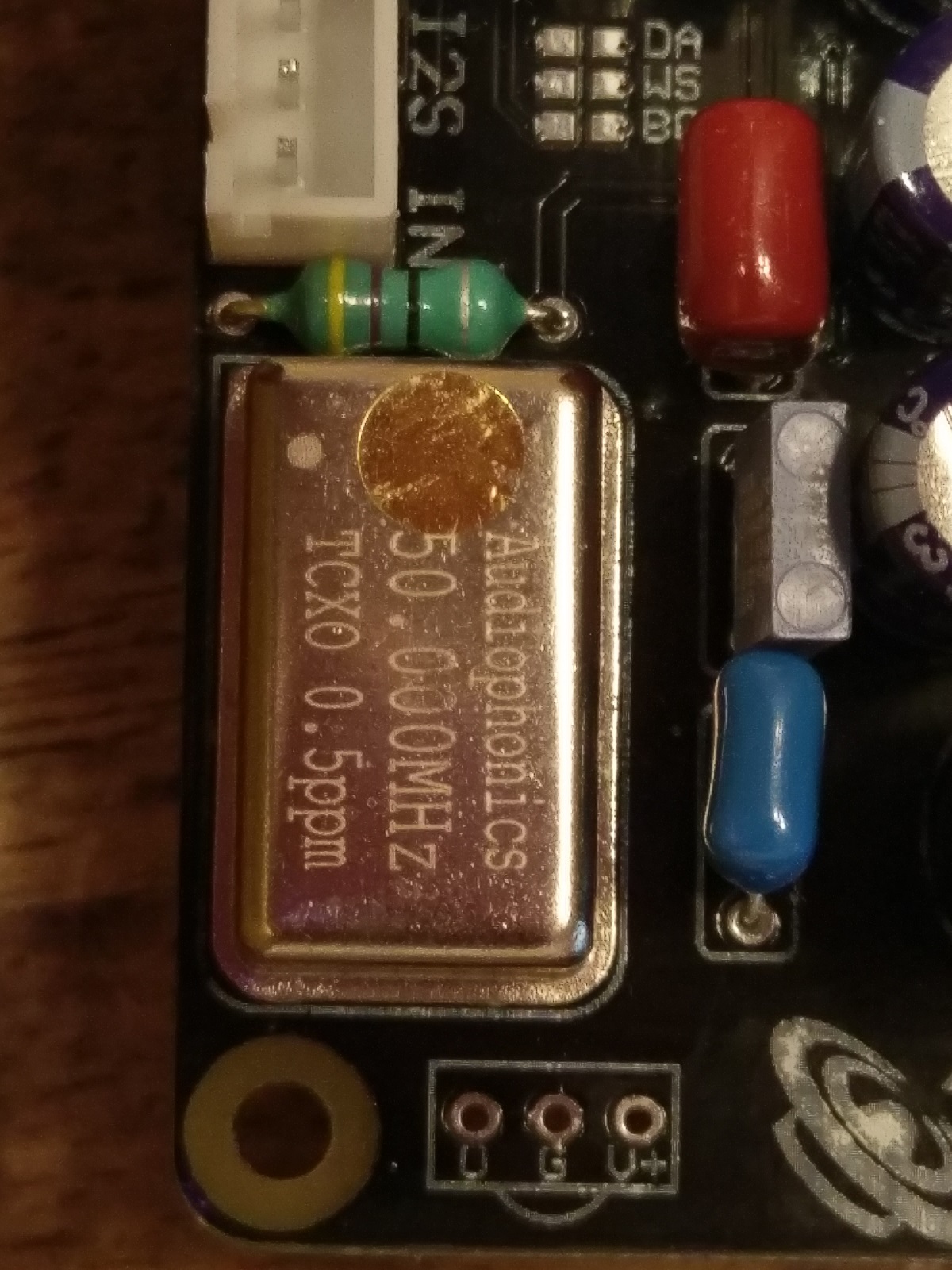

I've had one here since early this year, but haven't tried it yet. I'd REALLY like to understand why they included a 50Mhz clock on the board and what they use it for. I've asked and gotten 2 nonsense useless answers. I asked:
"I do not understand how you use the 50Mhz TCXO. When I read the datasheet the TDA1387 only needs the I2S Data, LRCK, and BCK to work. What does the 50Mhz clock do?"
And got back:
"It's right.
Normaly in the TDA1541 we have the SCK input in pin 4.
On the TDA1387 the TCXO input in the logical door to distribute to the 8X TDA 1387. We think the signal is matrix in the BCK / SLK and DATA like an spdif..
We asked to the designer for a more accurate answer. When we have the better answer. I wil send to you an email."
and when I asked again
"Did you ever get additional information on the purpose of the 50mHz clock on your TDA1387 DAC?"
I got:
"This DAC is a slave and need a clock to work correctly (50mhz clock are common for 192khz decoding)."
Both are nonsense answers AFAIK. Anyone know why and how?
Greg in Mississippi
Joined 2003

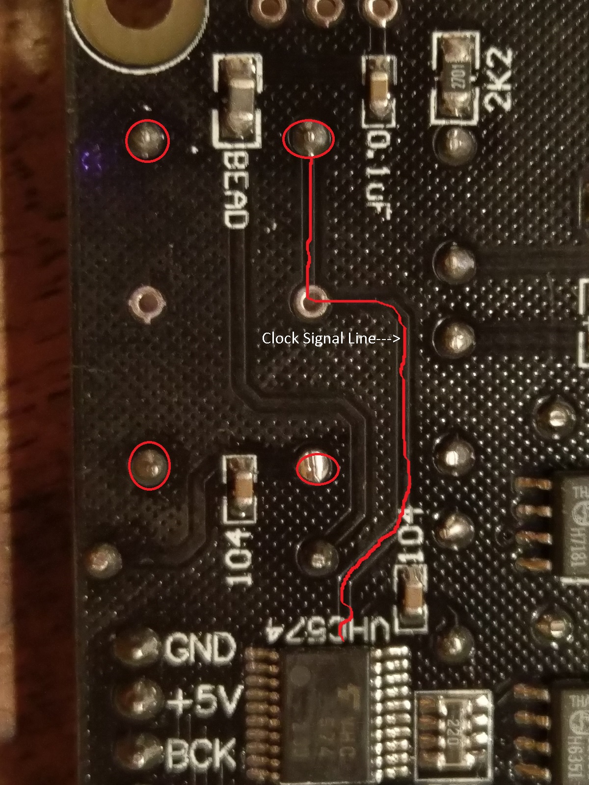

Nope, right on the board and it looks like the clock signal is input to the VHC574 that I suspect is used for distributing the I2S signals to the DAC chips. I'll have to download the VHC574 datasheet and trace things a bit, I guess.
Since this chip doesn't have ASRC like the ESS ones, a single clock frequency doesn't make sense, especially when it is not integer-related to any of the sampling frequencies.
If it is used to reclock the distribution of the I2S signals, I'd be tempted to un-power the clock and route the clock signal from an Allo.com Kali to the VCH574 to accomplish the same, but at least using a sampling-frequency-related clock.
I've posted closeup pix of the clock and the board under the clock showing the output trace going to the VHC574.
Greg in Mississippi
P.S. Did crude MS Paint markup to show clock pins and clock output signal line.
P.P.S. And you are right, passive I/V with bipolar Nichicon Muse ES caps for coupling caps. There's room for improvement.
