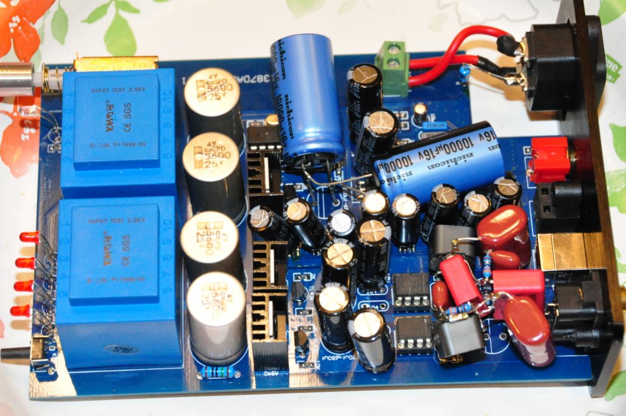

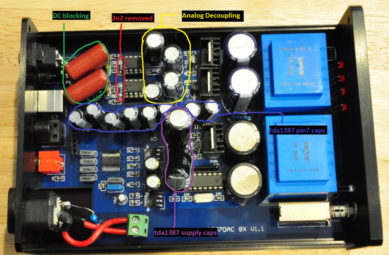

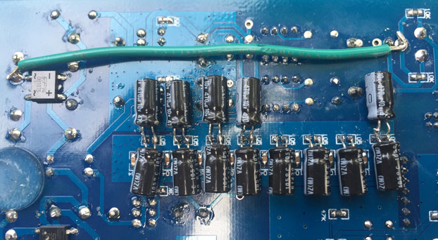

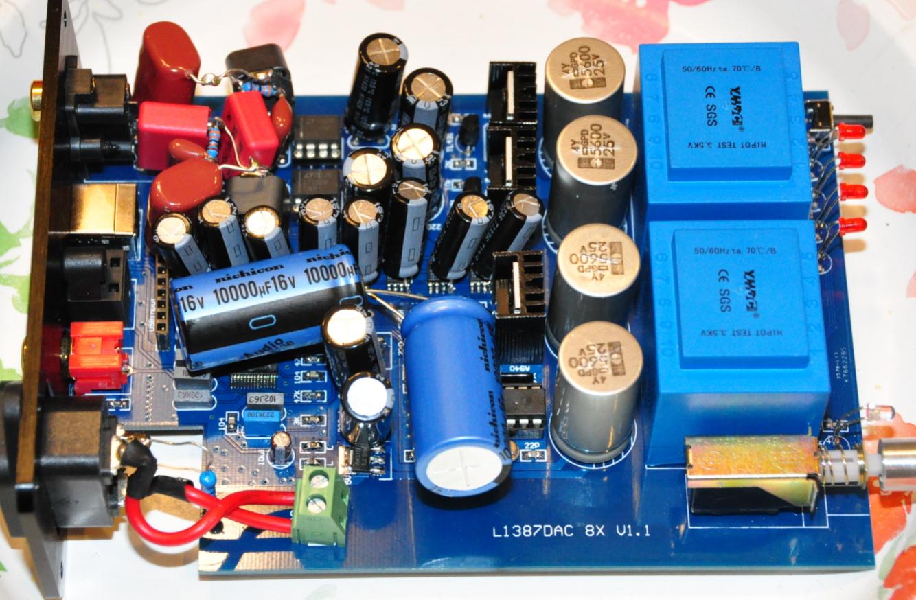

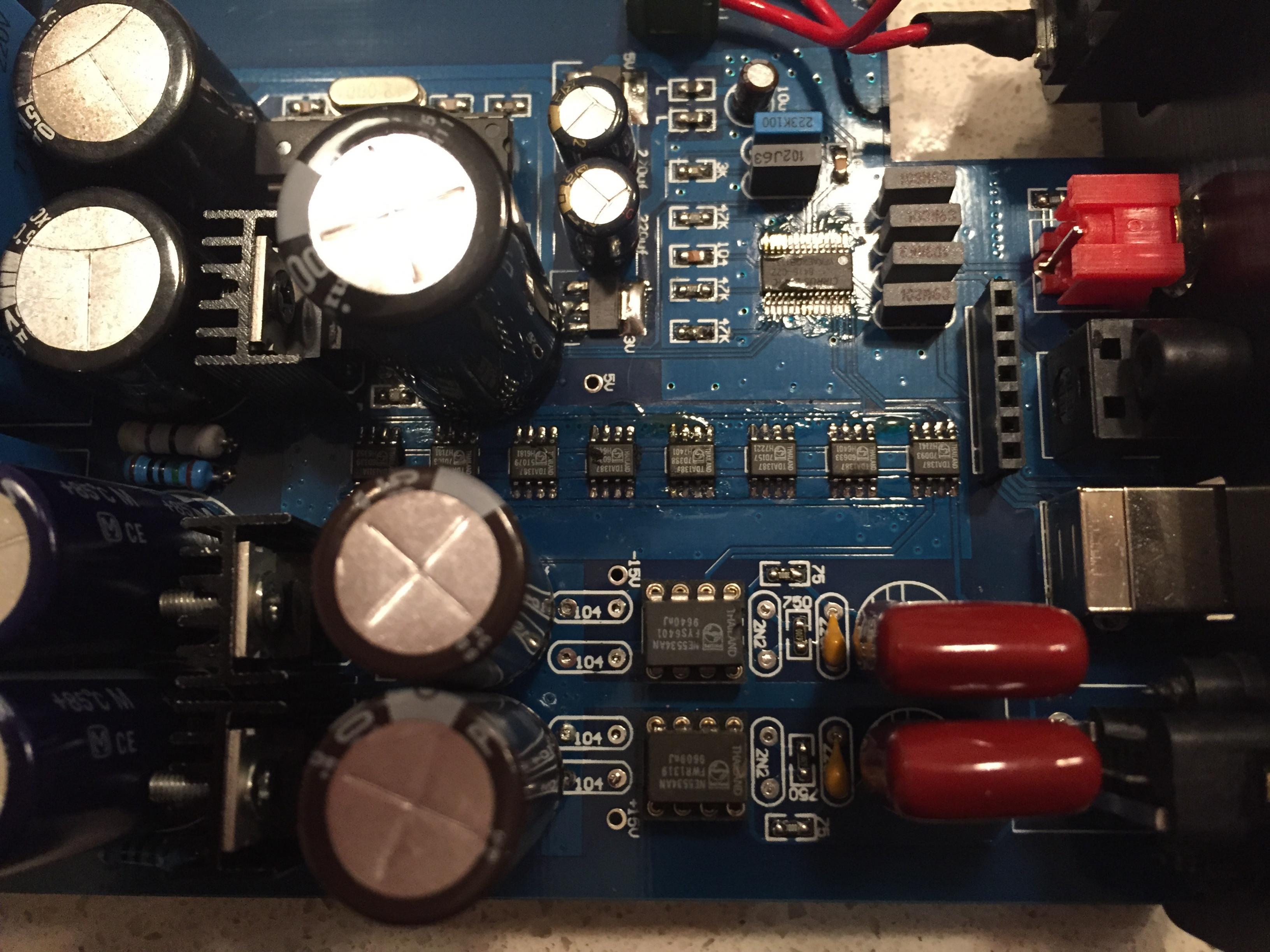

Until yesterday, all my mods have been only on one tda1387 8x unit. Yesterday I spent a little time on a second unit, previously entirely stock (special ordered with 110v transformers). Before I apply the next-gen mods to unit #1, I wanted to have a backup in place. :) Also, unit #1 no longer fits in the case, so I wanted to re-do the easier mods cleanly enough that the case could continue to be used.
I also wanted to use the opportunity to take a couple hopefully decent pictures, with annotations, that others can use as a visual guide to the mods. The mods I did took me about three hours. The hardest part was doing the precision soldering of the caps directly to pin7 of the tda1387 chips. Not really hard so much as tedious.
Starting in the upper-left of the annotated picture, going clockwise, the mods I did to this board are as follows:
  • DC blocking (green) - this isn't in the wiki, but this particular unit came with some cheap electrolytic capacitors for DC-blocking. I replaced them with those great big brown film caps. They are Panasonic polypropylene 4.7uF caps.
  • 2n2 removed (red) - "Remove 2n2 Opamp Feedback Capacitors" on the wiki
  • Analog Decoupling (yellow) - "Increase Decoupling of Analog Stage" on the wiki
  • tda1387 pin7 caps (blue) - "Increase Capacitance Across TDA1387 pin7" on the wiki
  • tda1387 supply caps (purple) - "Increase TDA1387 Chip Supply Capacitance" on the wiki
It's not annotated, but the stock opamps have been replaced. (Those are the 8-pin chips between "2n2 removed" and "analog decoupling".)
The only thing not shown that I did was remove the eight "105" capacitors on the back of the board. These are the stock pin7 capacitors. On my other board, I used the 105 solder pads for bigger electrolytic caps. However, you have to use small caps and carefully trim any solder points on the bottom of the board to get them to lay flat enough to fit the board back in the stock chassis. I also found those caps then interfere with the opamp constant current source mod. So this time around I soldered directly to the pins. It's not hard, but tedious. I would first trim the capacitor leads, then use pliers to form the leads to match the pin layout. I pre-tinned the cap leads, then simply held the cap in place and soldered one lead, adjusted the cap if necessary, and soldered the second.
If you're going to solder directly to the tda1387 IC pins, I suggest doing it after removing other big caps on the board (e.g. digial supply, DC blocking, analog supply), but before replacing the caps, as it gives more room to maneuver. I didn't do this, so at one point I did have to get help from my wife to hold a flashlight for me.

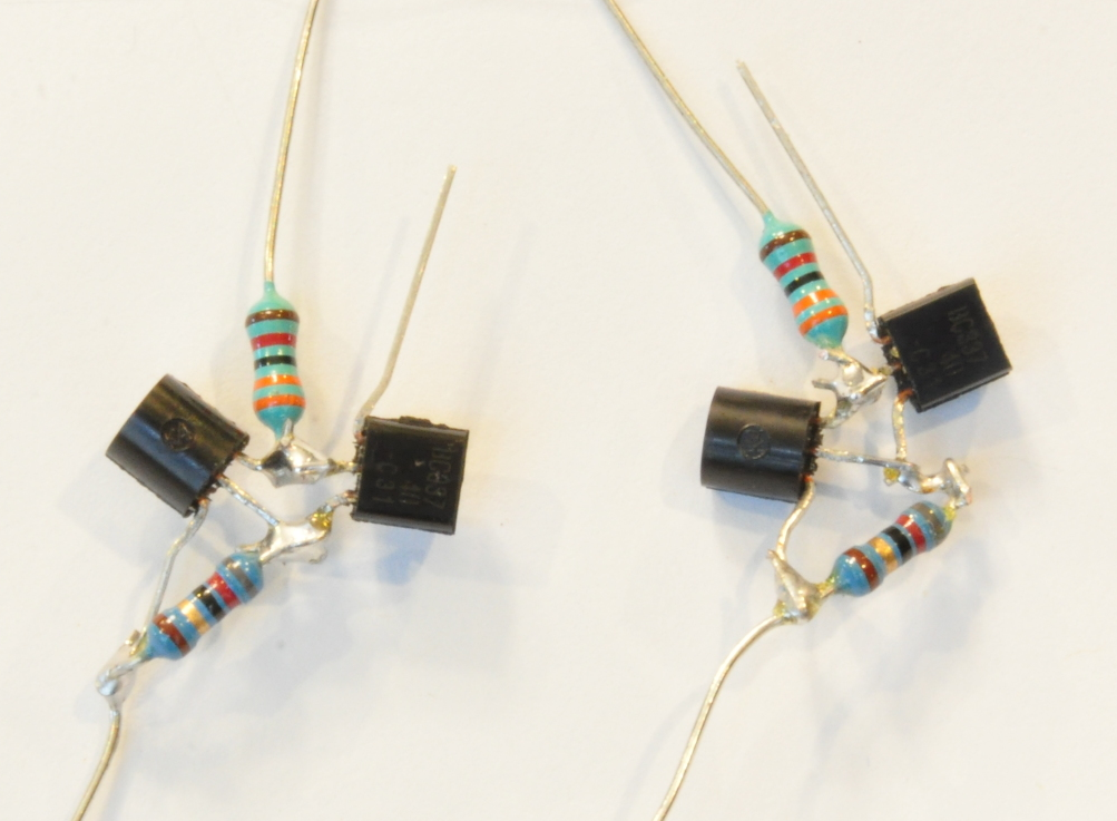

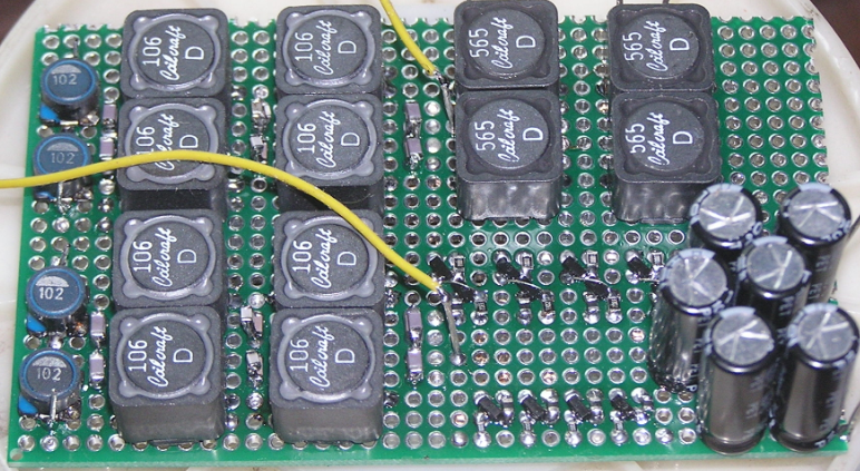

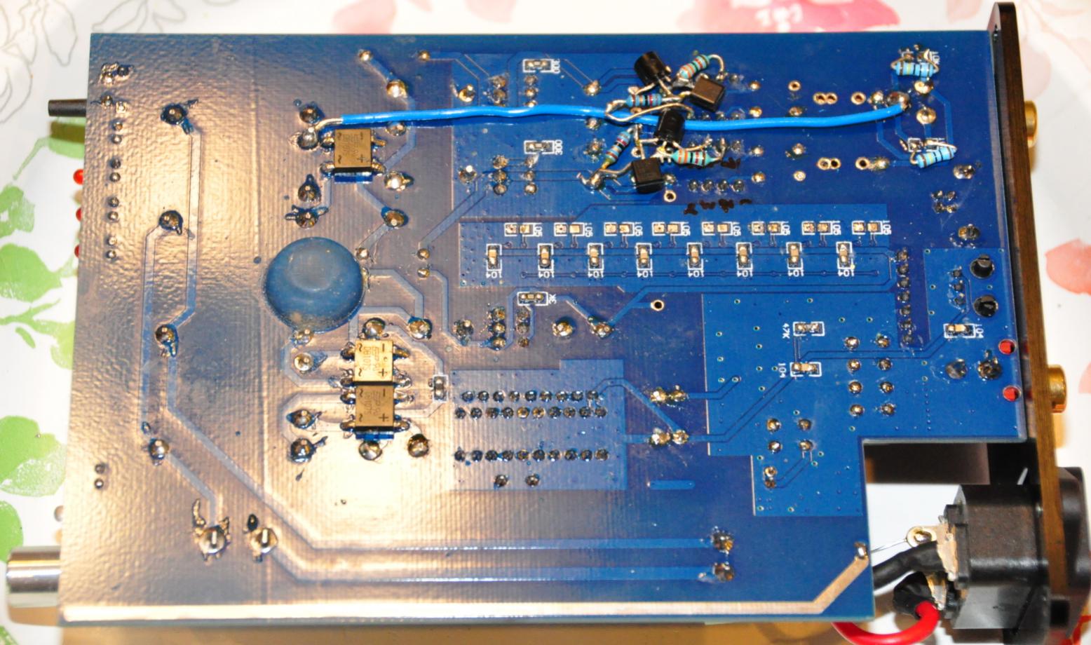

...and here's another constant current source mod, prepped and ready to be soldered to the board. Earlier in the thread I posted pic of my first implementation of this mod, but I think this is a better pic. Better focus, higher resolution. Hopefully useful to someone!

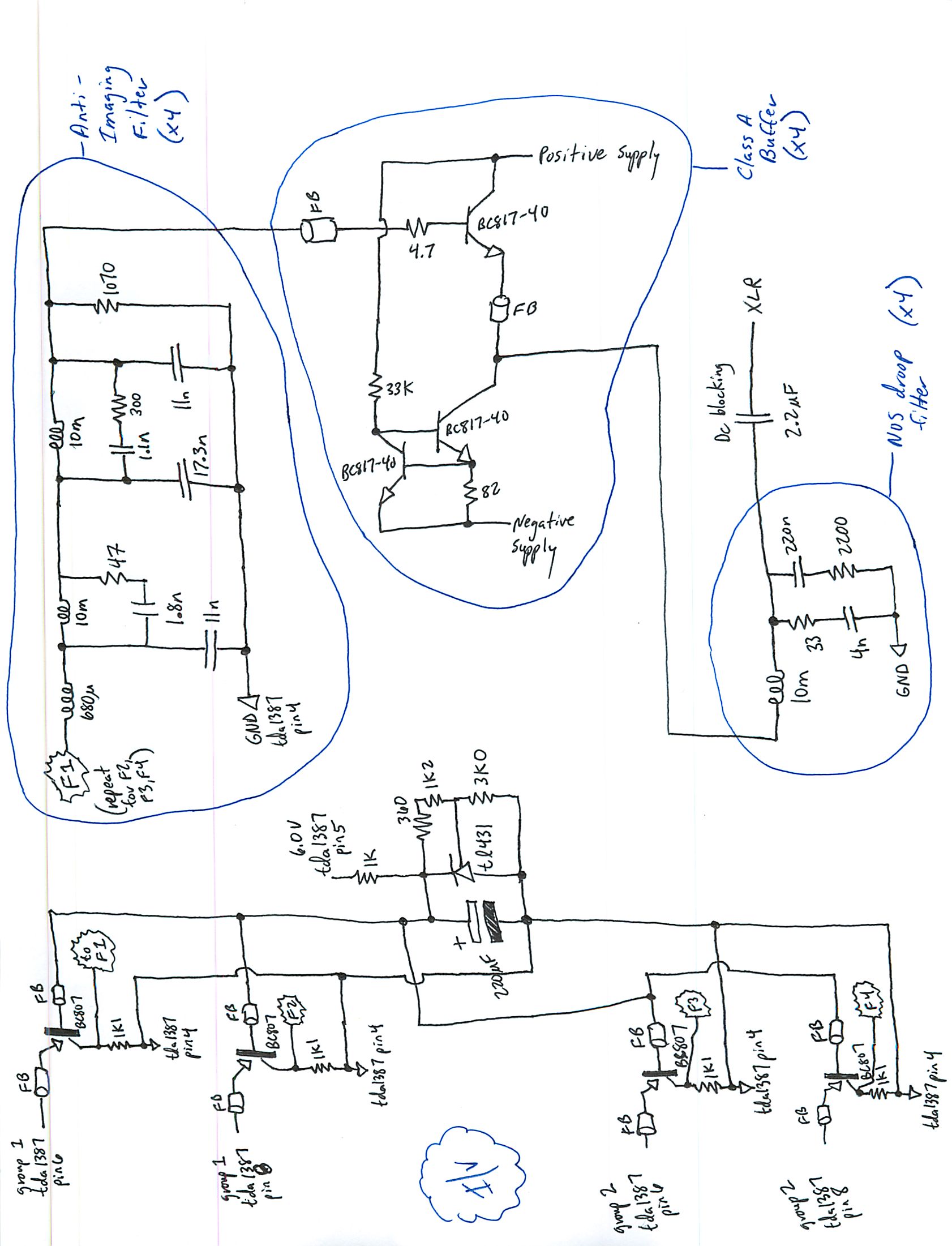

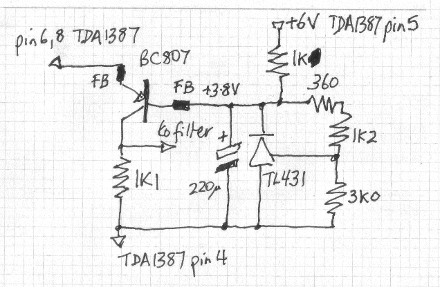

At long last here's the schematic (hand drawn as LTSpice's TL431 symbol is really confusing) for the discrete I/V modification.
Implementing the balanced outputs requires four of the BC807s (or BC327s if you're doing this non-SMT) plus associated FBs and 1k1 resistors. Only one TL431, 220uF and set of voltage setting resistors is required though - there's plenty of current available to feed the 3.8V voltage reference to 4 I/V transistors.
Maybe I'm missing something, but looks like you have a 360 ohm resistor in series with a 1.2k ohm... any reason not to use a single 1.5k ohm?

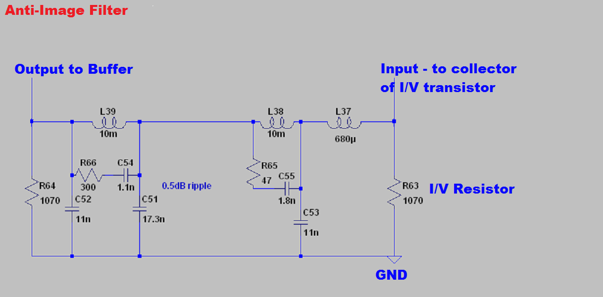

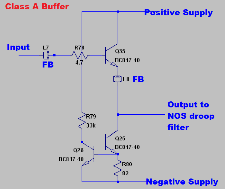

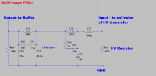

Next-Gen Consolidated Info
I annotated the anti-imaging and class-a buffer circuits. Abraxalito, can you confirm I got these right?
I'm also re-posting some previous pics and circuit schematics, in the interest of convenience (Abraxalito, I hope you don't mind me re-posting your pics). Eventually I'll add this to the wiki...
In order, the pics are:
  • Anti-Imaging Filter Annotated Schematic
  • AI Filter Pic
  • Class A Buffer Annotated Schematic
  • I/V Circuit
  • I/V Pic

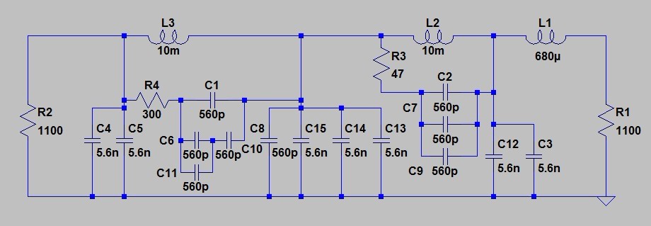

Next-Gen Consolidated Info Part 2
OK, I attempted to draw out one big circuit (sort of) for the next-gen mods. Abraxalito, if you're willing, would you mind taking a look at this to ensure I got it right?
I drew out the I/V stage literally, but for the following circuits (anti-imaging filter, buffer, droop filter), I only drew one instance. I believe there would need to be four instances of these circuits, one each for R+, R-, L+, L-.
I am doing this assuming balanced output.
If I got this right, I'll draw up a BOM.
Note: I posted both in JPG and PDF format, content is the same otherwise.
  • tda1387x8_next-gen_cct-20150820.pdf
I had a look over the schematic - its correct assuming you're not using an output trafo. Looks like you're going balanced out to an XLR.
As regards your question about the CCS mod - that's the one biassing the opamp into classA is it? If so then putting the CCS onto pin6 of the opamp won't bias it into classA, rather it will introduce a significant positive voltage offset at the output (pin7). The TDA1387s are already biassing the opamp's output negatively so it might just undo this effect - I have such mods already on my version of the DAC.

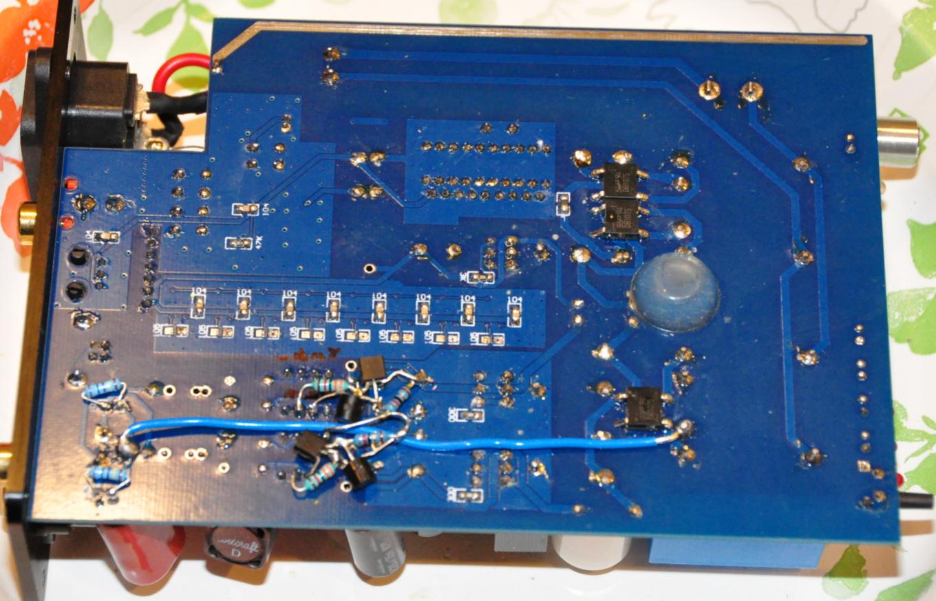

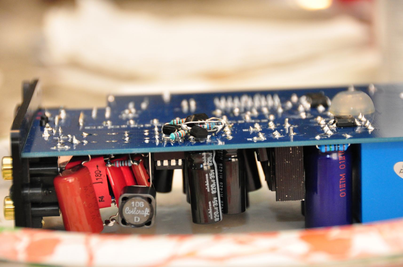

Joined 2008

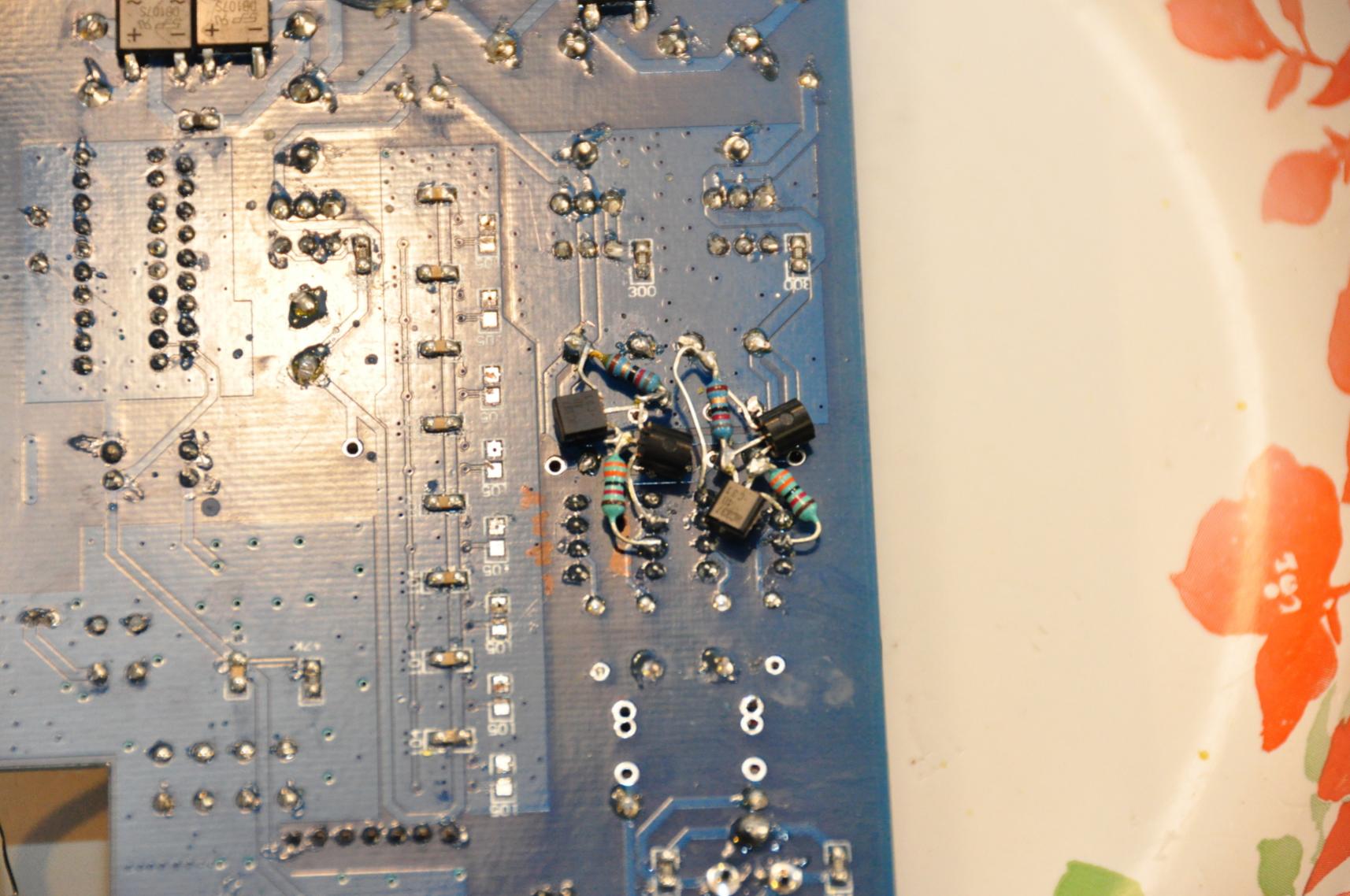

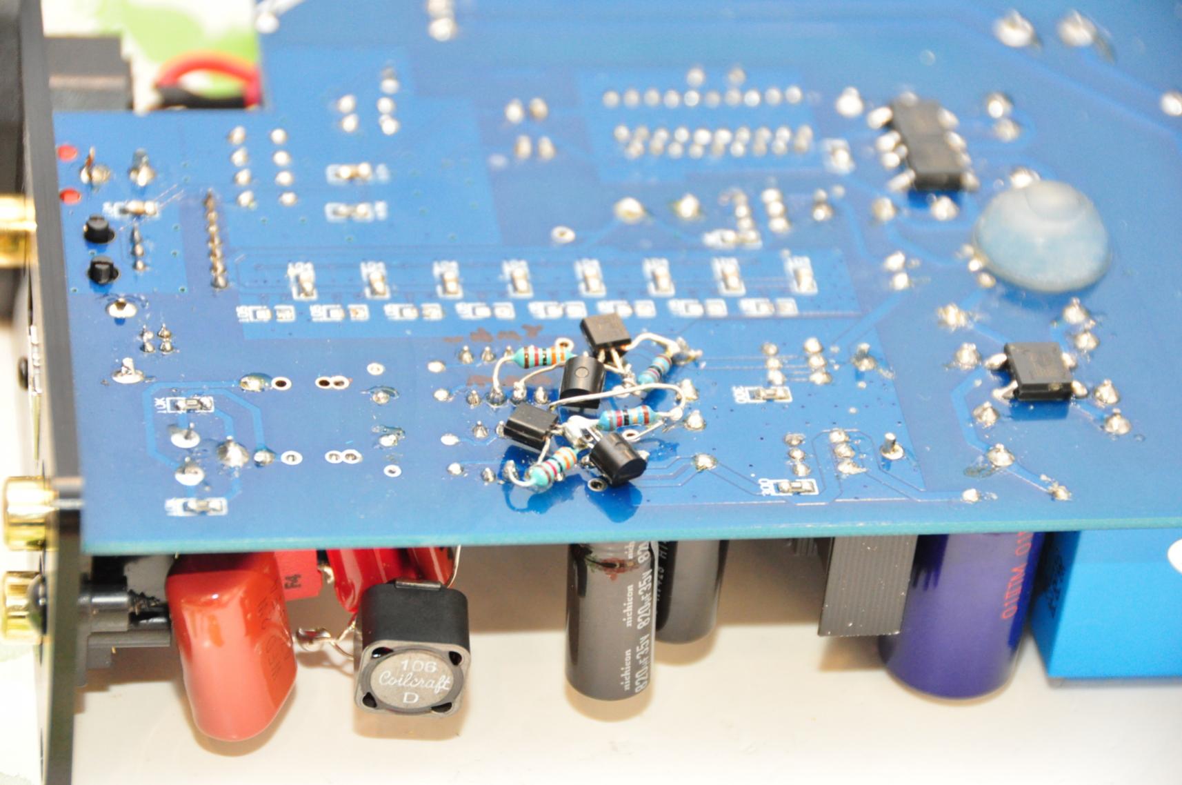

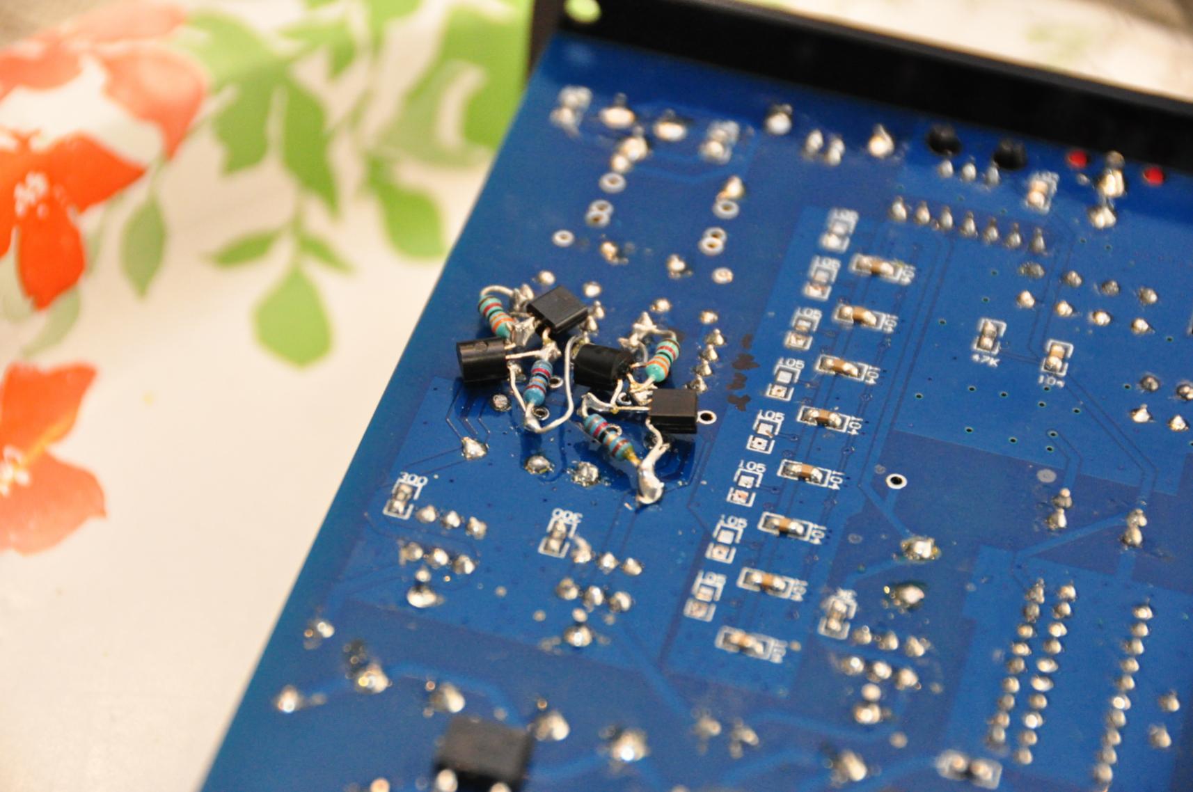

So indeed, on board #1, I flopped pin6 and pin7 for the opamp CCS mod. Now fixed.
Here are some pics of CCS mod on board #2. This was a bit challenging to keep close enough to the board that I could still slide the PCB in the case. I almost ordered some SMD components to make it easier, but in the end, I think it's a decent solder job.
Just to be safe I coated the bottom of the chassis with electrical tape, just in case anything hits on it. But as far as I can tell, it's not touching the case. Better safe than sorry, either way.
If you look closely, you'll see I wrote the pin numbers on the bottom of the PCB this time around. :)

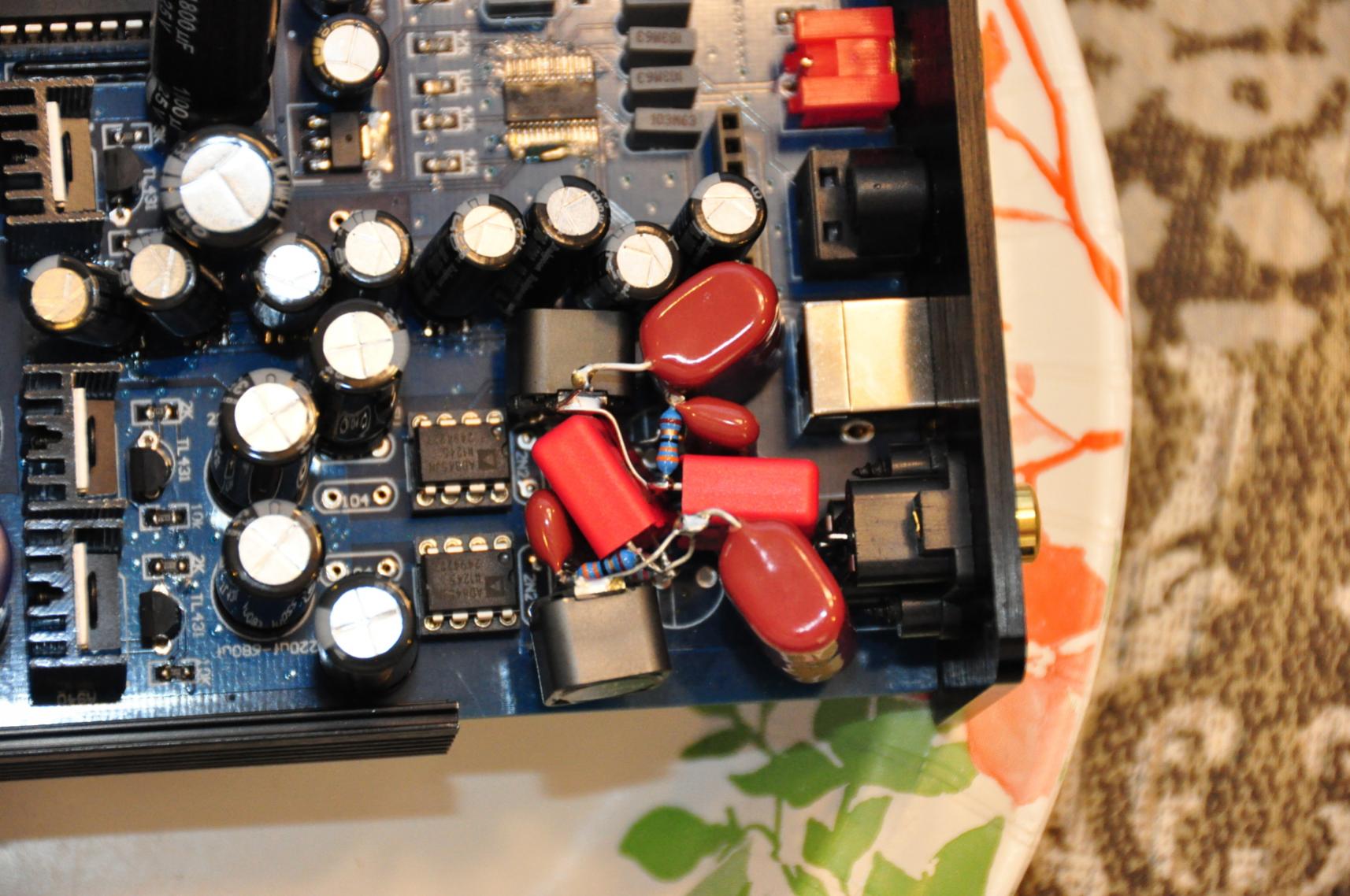

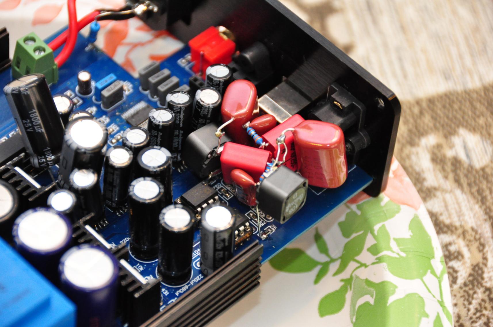

Joined 2008

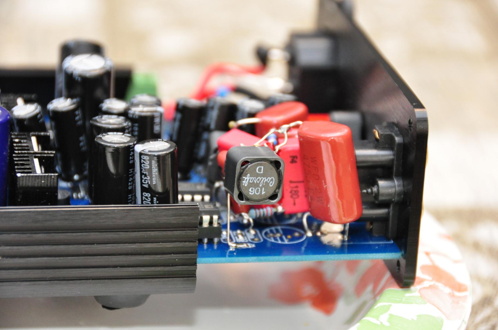

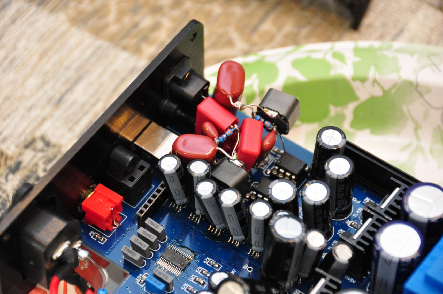

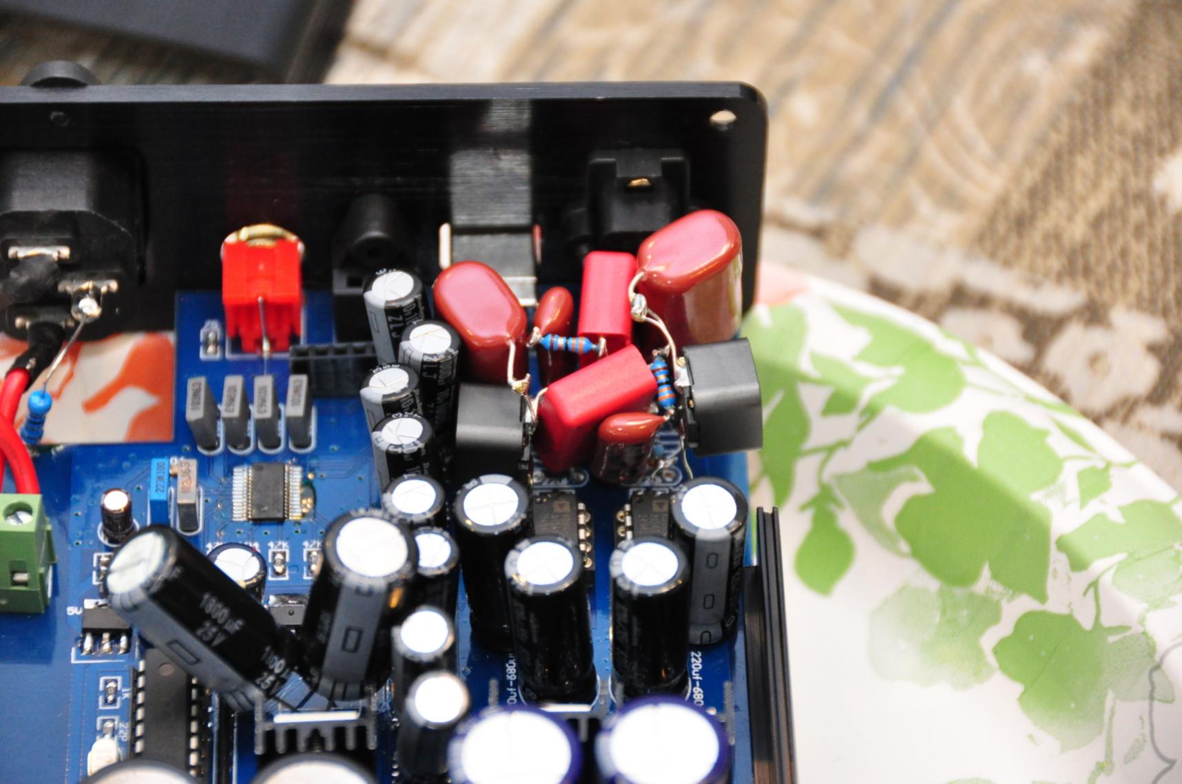

And here are some pics of the NOS droop filter on board #2. I used great big Panasonic polypropylene 4.7uF caps for DC blocking. This made it a challenge to actually fit all the components of the droop filter in the space, and leave room for opamp rolling. I think I pulled it off.
I think Malefoda's filter implementation is much neater. But I'm using much bigger (physically) caps and was afraid they'd give me problems sliding the PCB back into the chassis if I put them on the bottom.
Another exercise in "air sculptures" for those who enjoy the pics!

Simplified BOM anti-imaging filter
I went over to Mouser just now to look at the pricing on SMT ceramics. Typically prices for 100+ are about a quarter of the 1offs. Hence it makes some sense to avoid cap values where only two are needed. In that vein, here's a cost-reduced version of the filter which uses only two capacitor values - 5.6nF and 560pF. 0603 560pFs are cheaper than 0805 but if your eyesight or hand steadiness isn't up to such small packages then 0805 will be fine. I'd just suggest go for 5% or better and steer clear of the lower voltage parts - go for 25V working or higher. TDK 0805 looks to be the best bet for the 5.6nFs.

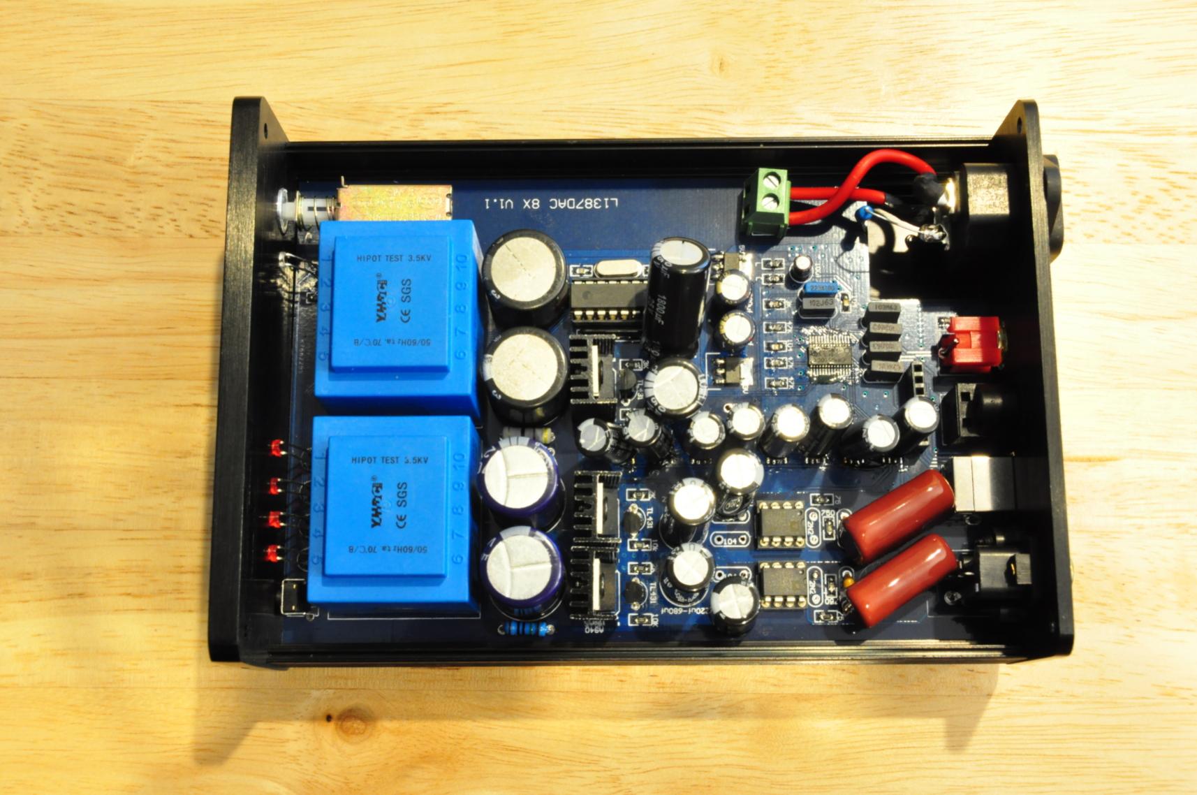

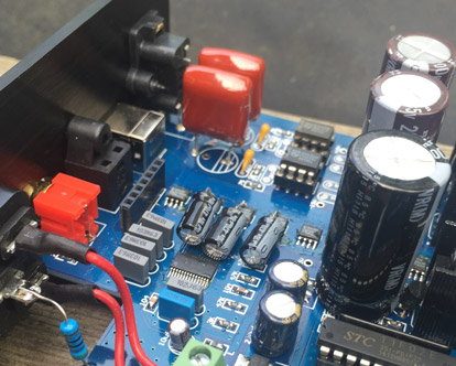

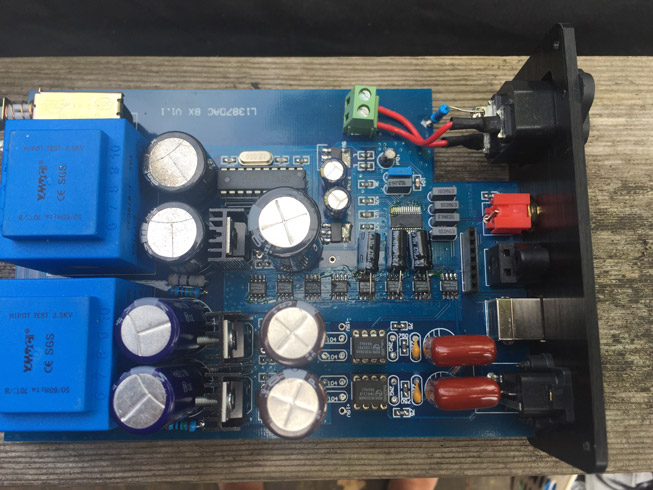

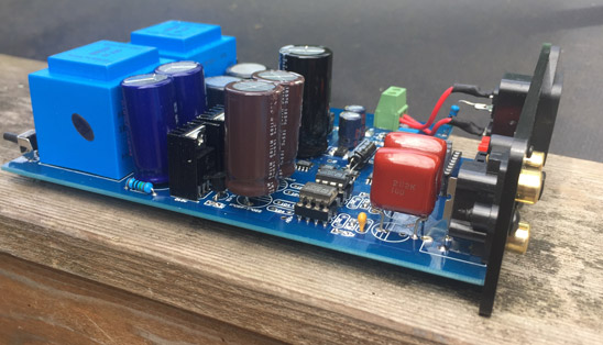

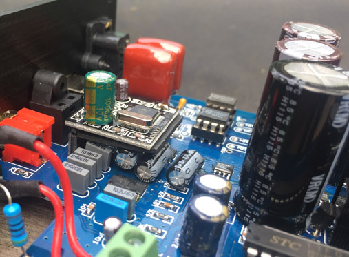

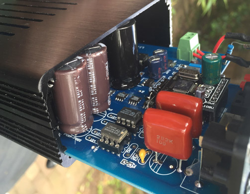

Hi guys,
I recently received one of these from Cart100, and have tackled some of the mods in the wiki. Thanks to all the excellent information in this thread and on the wiki, it's mostly been pretty easy.
My board came with axial 'lytics for the output coupling caps, so I replaced those with 2u2 film caps, although all I had to hand was 100V.
I'm still waiting on the opamps to arrive, so haven't done that mod yet.
I used NICHICON UVZ1A471MED1TD 470uF caps for the TDA1387 pin 7 mod, originally intending to install them all below the board. I found that the caps have to be absolutely flush against the PCB to allow the unit to be installed in the stock case (as has been previously pointed out ;-), and I couldn't trim the opamp socket pins down enough. I ended up with a hybrid below/above board solution - the ones on top got a bit messy, but it works. I also needed to accommodate my USB module, which complicated things slightly. As an aside, the L108 USB module works fine with my raspberry pi and volumio.
I used a NICHICON UVR1C103MHD 10000uF cap for the digital supply. These are 35.5mm tall, and even when installed flush to the PCB in replacement of the stock cap, only just fits into the stock case. Similarly with the analogue decoupling caps, I used two NICHICON UPW1V222MHD 2200 uF units. The spacing of the original caps doesn't allow these replacements to be installed flush to the pcb, so they're also a tight squeeze to get back into the case.
Overall it's been fun learning, fun making the mods, and the improvement to the sound has been significant. Just wish I had a stock unit to compare it against!
Next step, other than the opamp upgrade, are the CCS and NOS drop filter mods. I'm not overly confident in my air sculpture abilities, so I've been thinking about making a module that plugs into the opamp sockets - I'll post back when I've made some progress.
Jon
