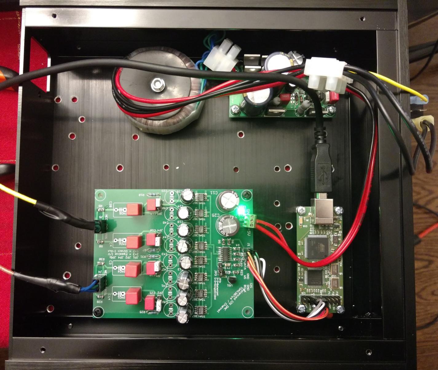

Since you asked, it motivated me to spend some more time with the x8 front end. I have it in a case now, along with an Amanero and 5v regulated power supply. Listening to it on test speakers now (still not confident enough to put it in front of a powerful amp and expensive speakers).
I did find one of the boards has a problem, didn't feel like debugging today. (The GND+NEG output pins are totally noisy, in either single-ended or balanced mode. Suggests I have another solder bridge somewhere on the "lower" four tda1387 chips.)
The board in the picture works, but I think one of the tda1387 chips isn't soldered correctly (or I have a bum chip, but most likely it's my bad soldering job). I have the output wired for single-ended mode (POS and NEG pins tied together), but accidentally configured the HC86 for balanced mode. This I believe should have resulted in no sound at all (i.e. the signals should have cancelled each other out). But I still got sound, although it was very faint. I fixed the HC86 jumper, and now there's a lot of gain (relatively speaking anyway). FWIW, I'm using software volume control, and have it turned almost all the way down.
In short, still feeling the pain of the initial sloppy soldering job. 🙄
Hopefully I'll have time tomorrow to finish the case work. I just need to drill out the real panel.

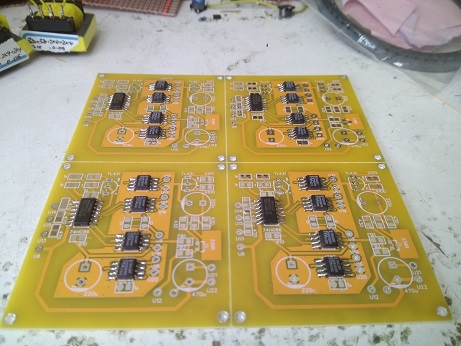

My gf's first PCB design has just come back from fabrication - its a quad chip version of Matt's board, 5*5cm, so we've panelized four to fit the 10*10 footprint that PCB vendors seem to offer their best prices on. Once its stuffed and proved working then anyone can build one - not that I'll be shipping out boards (as Matt's shown, that's not cost-effective), rather the data will be free to use on request. The cost of this first batch worked out to be around four boards for 1 USD.
One of these boards, together with the up-coming filter I/V board (about to enter layout any day now) will allow construction of a lingDAC.

Thanks Matt - I haven't listened to lingDAC on speakers yet as I need an amp which is up to the job, haven't built it yet. Have been working lately on an amp to drive my 600ohm DT880s from this - the trafos for that are in the top-left of the DAC boards pic 🙂

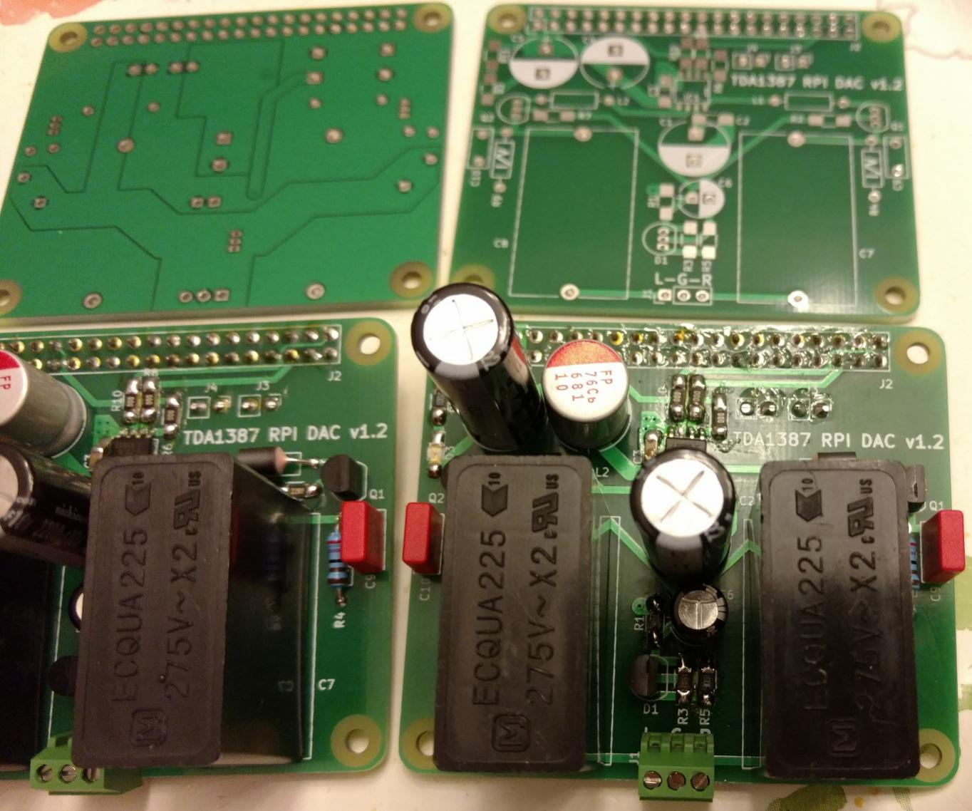

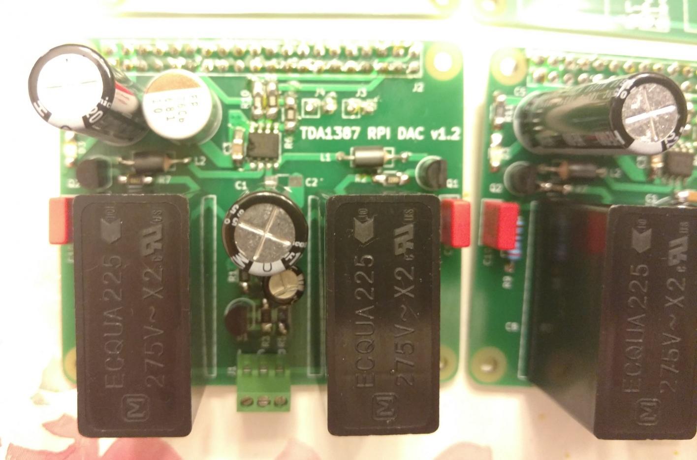

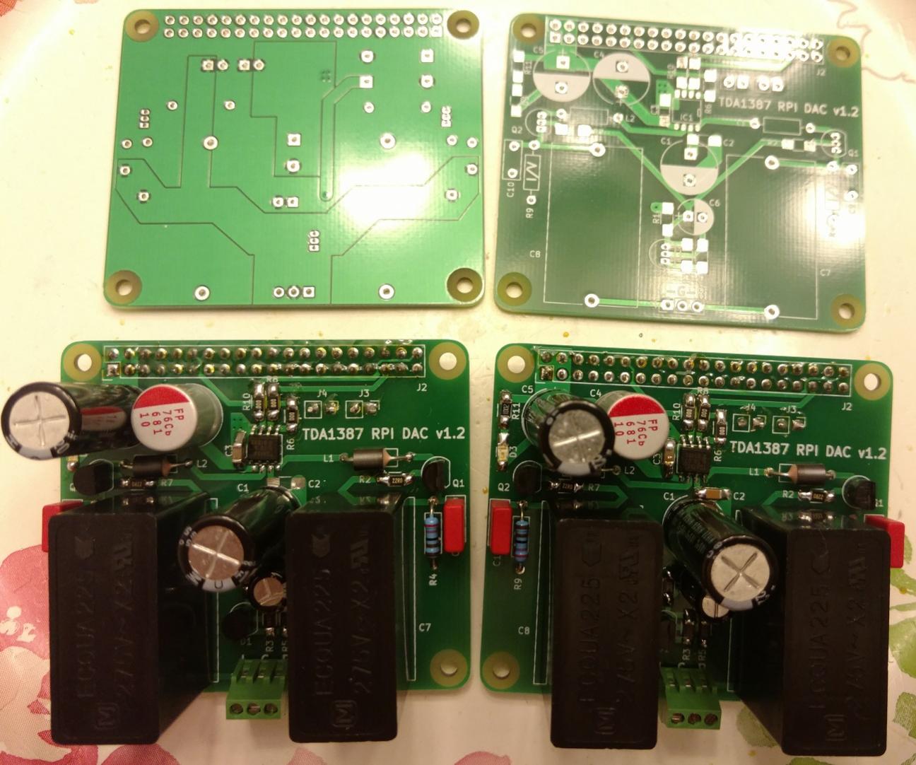

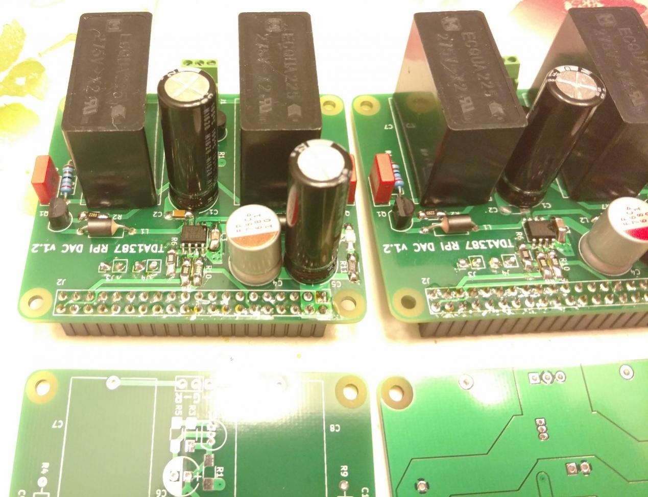

OK, third time's a charm (hopefully). First batch of these I used the wrong footprint for the tda1387 chip, so they were worthless.
On the second batch, I made some mistake exporting the Gerber files, so the boards came back without any ground plane. I suppose they are not technically worthless, but I didn't want to deal with it.
This batch corrects the above two mistakes. I soldered up a couple boards tonight. Testing will have to wait for another day.
I hand-soldered everything, my last couple attempts at the "stovetop reflow" ended up not going as well as I hoped. So I thought I'd keep things simple this time.
Let's hope they work!

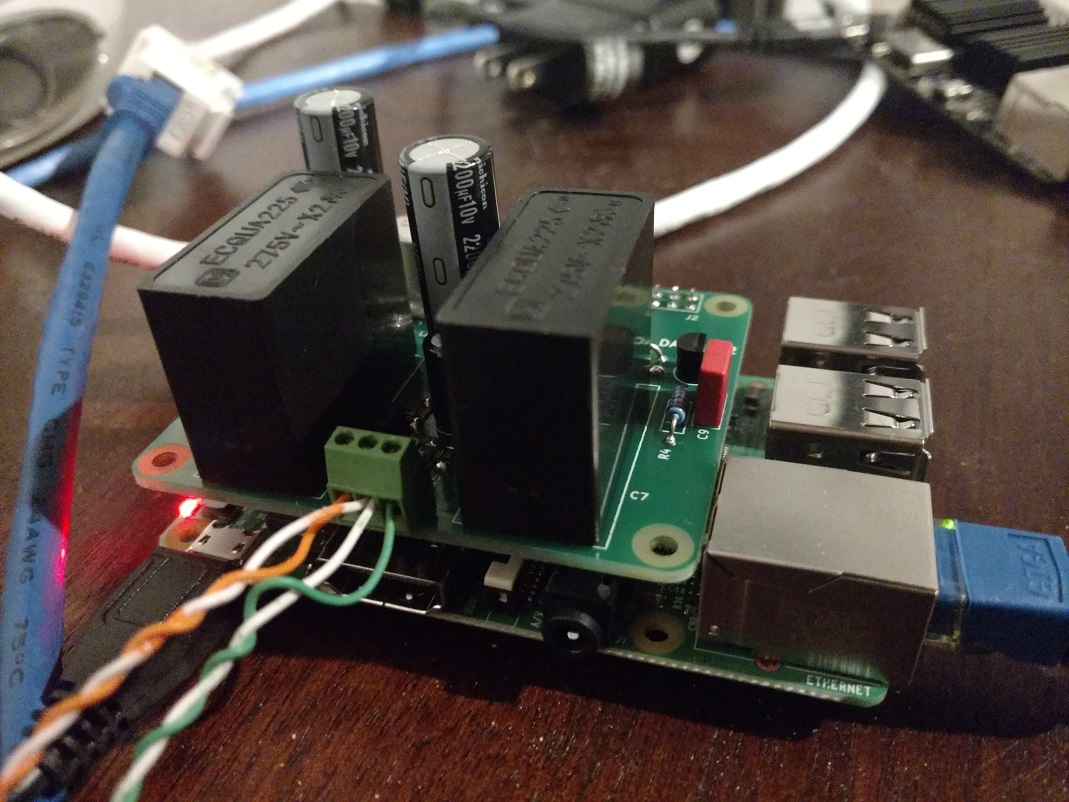

At least one board is working! I had a little time to give one of the completed boards a test. Worked without any issues. I didn't have any time for any kind of serious listing, but no obvious problems.
I have a pair of Overnight Sensations speakers I use as test speakers (the drivers are cheap in case I blow them up). As soon as I was confident this DAC won't kill speakers, I switched over to my Speedsters. I can say the DAC is at least resolving enough that the quality difference between the two different speakers was immediately obvious.
Once again I have a few extra boards, free to anyone who's willing to cover shipping. (I wonder if I could just drop one in an envelope and send it via first class mail, i.e. with just a stamp?)
