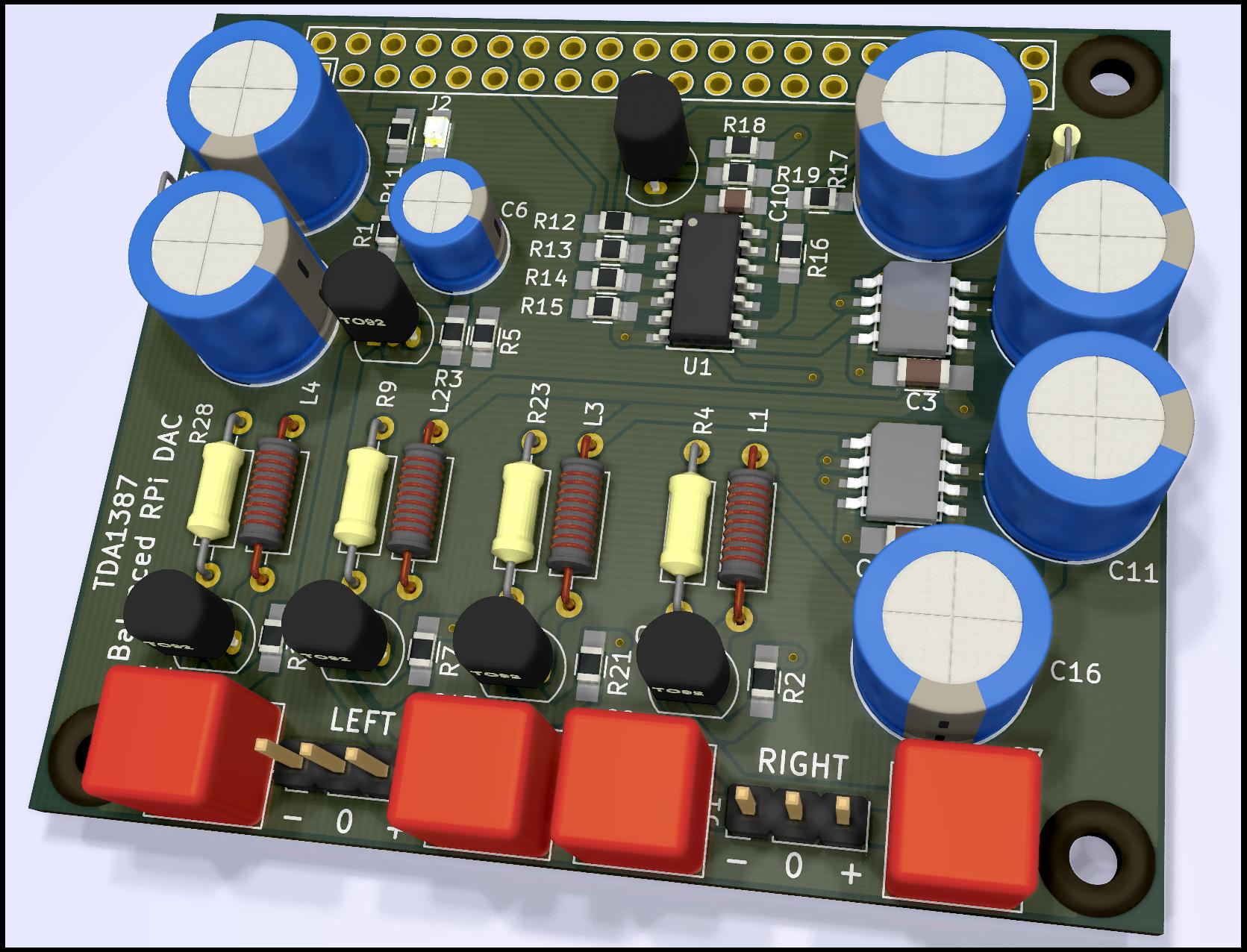

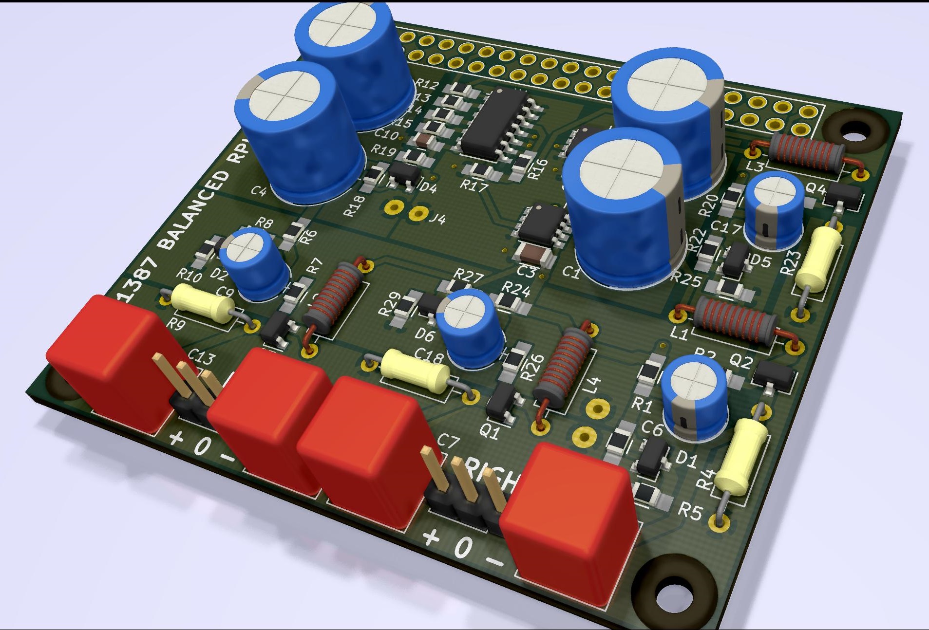

I ordered PCBs for the RPi hat shown above. In the meantime, I whipped up a balanced RPI hat.

Here's another spin on the tda1387 theme: a Raspberry Pi HAT DAC.
I realize I'm probably too late with the comments to intercept this board before it goes to fabrication but I'll just point out anyway that the TL431 reference can be shared between the two I/V transistors. This'll save you a few parts - each transistor needs its own 22ohm base resistor but beyond that you only need one instance of the voltage reference.
Definitely not too late. I want to have the single ended hat working first, well before I have the balanced hat fabbed. So thank you! Board space is tight with the balanced implementation - and I just found out the tda1387 footprint I used is too small. So removing a couple components will help offset the larger (correct) footprint needed for the DAC ICs.
Ah glad to hear my belated feedback isn't in vain. You'll save 3 resistors, an electrolytic and a SOT23.
I just realized you were talking about the single-ended HAT board; when I replied earlier I thought you were talking about the balanced board.
Yeah, I already had the single-ended one fabbed, but the tda1387 footprint is wrong, so I have to have them re-made anyway. So your feedback, though technically late, is still not in vain. And certainly still appreciated!
The component savings won't hurt on the single-ended board by any means; and will be a big help on the balanced board.

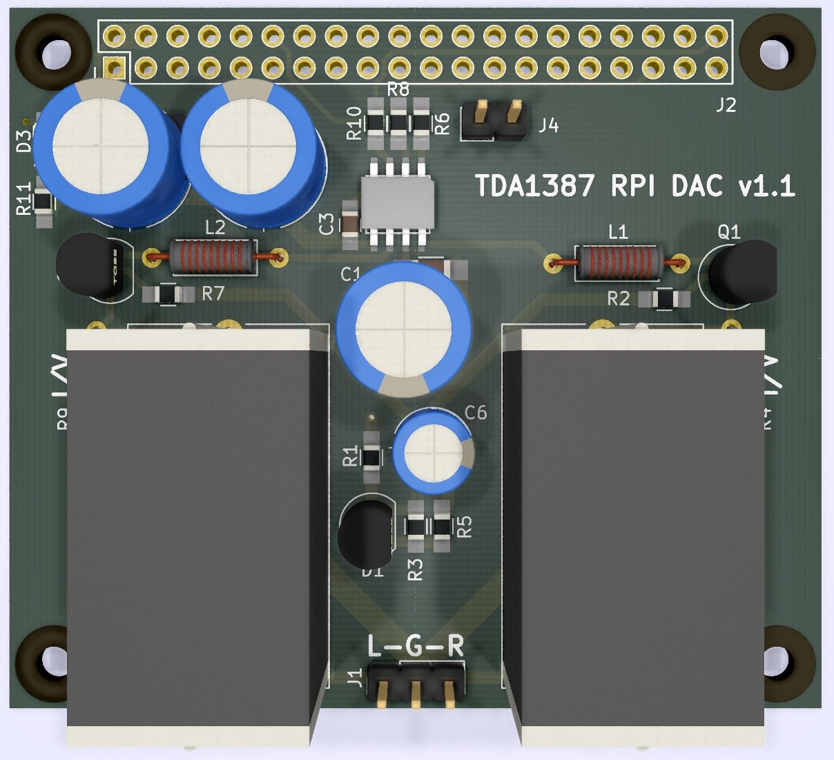

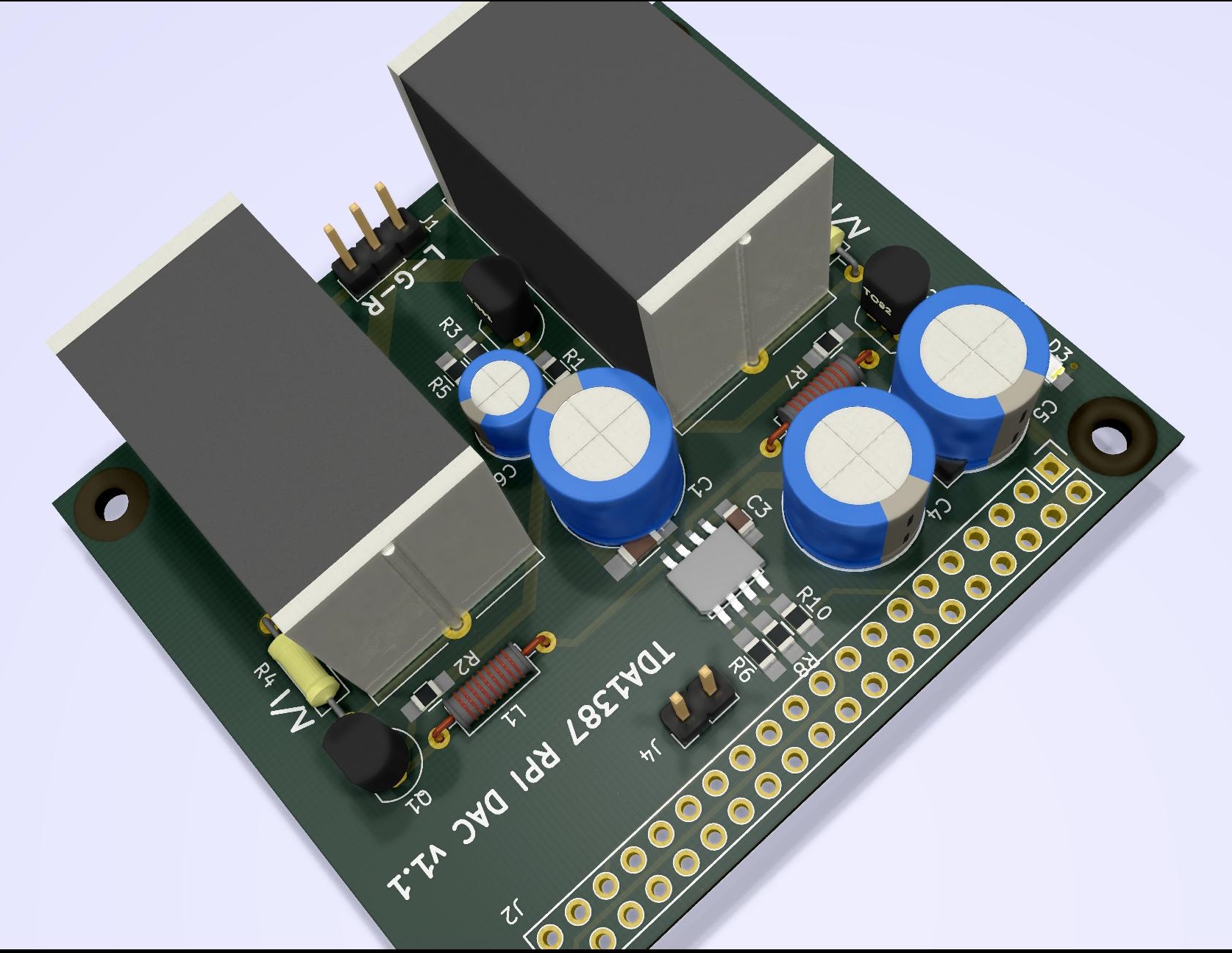

Here's revision 1.1 of the single-ended RPi HAT. I fixed the tda1387 footprint, and also simplified the tl431 voltage reference per Abraxalito's suggestion.
The only other change was to add resistors in front of the tda1387's I2S input pins (1/BCK, 2/WS, 3/DATA). Not sure if that's really necessary, and if so, what the values should be... easy enough to use a 0R if they don't need to be there.
These KiCAD raytraced renders look better than the real thing IMO!
Can the TL431 reference be shared between four I/V transistors (as in the balanced design)?
That looks really nice, KiCad is a great tool.
Yes sure, why not? According to LTspice the base current is plenty low enough not to load the reference significantly.

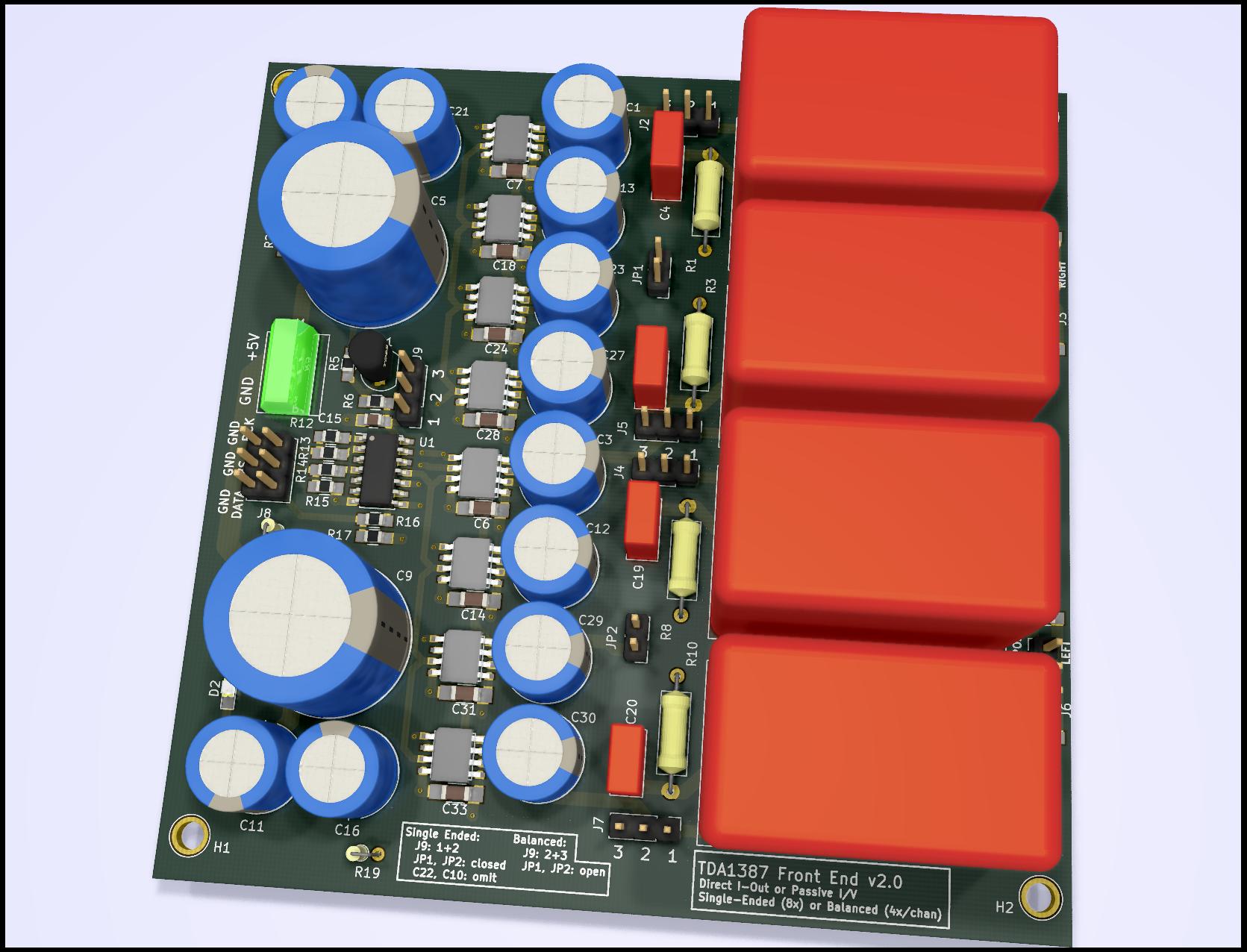

I re-designed the 8x front-end board. Mostly just for fun, original design was done in Eagle, and I've since moved to KiCad entirely. Also, the original board had a few annoyances: bottom-mounting of some components, a couple inconsistently-sized components, no easy way to combine outputs when running in single-ended mode, and only one giant ground plane. Version 2 addresses all that.

Have you had a chance to compare your front end to the 8x dac yet? I'm curious to hear what the tda1387 sounds like without the op amps.

I have not... My modded x8 DAC (the opamp based one from the other thread) has a noise issue that I never got around to debugging. Rather than fix it, I just designed a whole new DAC. 🙂Have you had a chance to compare your front end to the 8x dac yet? I'm curious to hear what the tda1387 sounds like without the op amps.
But, based on hearsay (mostly abraxalito's numerous writings on this chip) - passive IV demands a really good power supply, and also is sensitive to downstream components... If that is true, then it implies results will vary significantly from one system to the next.
