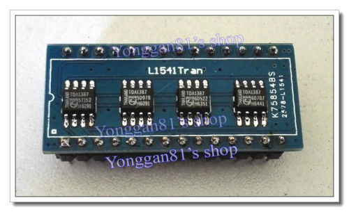

The TDA1541A is pretty much the 'reference' multibit DAC, but its rather expensive and very power hungry and something of a devil to get right in terms of implementation (layout, decoupling, DEM tricks). If you're looking for something more affordable and less easy to screw up as a DIYer, I reckon the TDA1387 is it. They both share Philips' dynamic element matching architecture - in the TDA1387 they call this 'continuous calibration'.
My thinking too - that it would be good enough to start with. I've stuck with it for a few years now and not felt an urge to move on to better things, rather my DACs were limited by implementation details I'd overlooked. Now I reckon I've fixed those and the TDA1387 is fully satisfying. Of course its not doing 192k in my designs (though it can) and nor is it doing 20 bits, so if one has material that calls for those, then in and of itself it may not be enough. I reckon though by using 16 chips in parallel it might well do 20bits - something I have in mind for the future when I have a DSP in my DAC....
