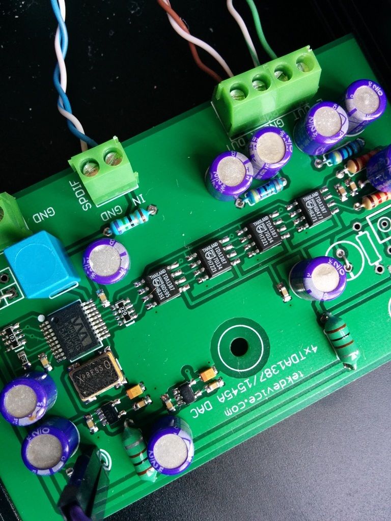

4 chips are sharing one sm bypass and OSCON?!? All through different routes that are cm long.
You could try to bypass each chip but for the last 3 chips on the right, the sm cap connects to a small gnd island that is attached to the back gnd plane by one tiny via.
Edited for clarity.
This is bad HF PS design that looks like it can't be fixed (tiny vias). [Maybe with a lot of work ...]

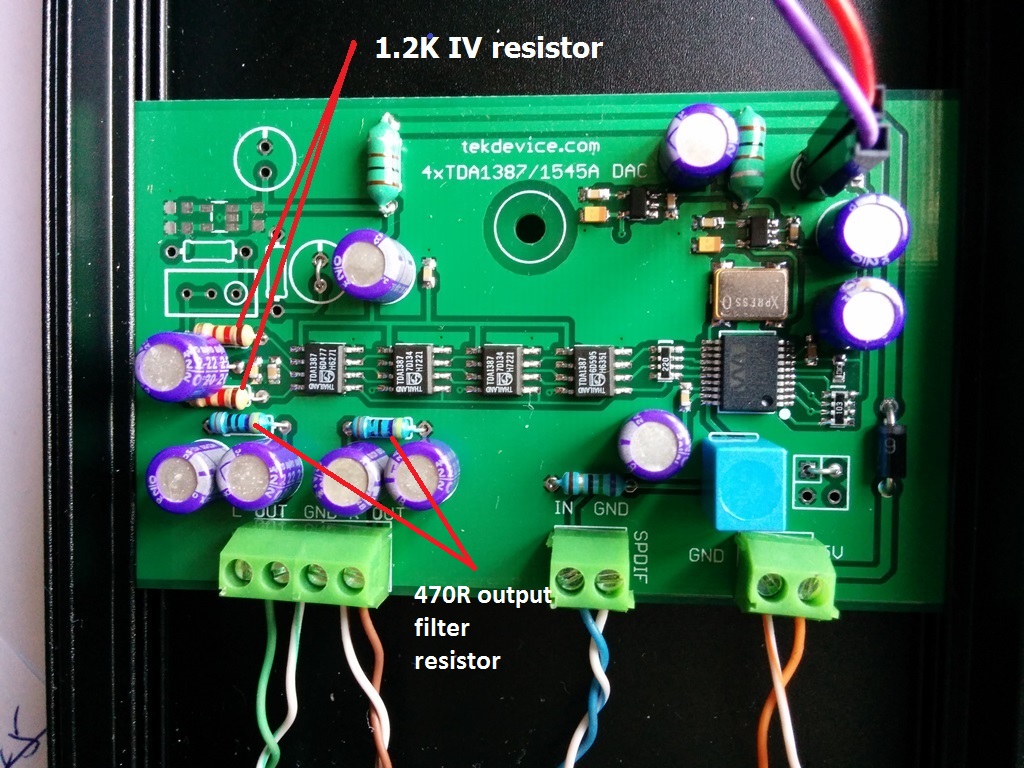

Abraxalito - there seems to be some kind of digital filter after the iv resistors, can I still put the transformers between the output terminals on the pcb and the rica sockets on the chassis, or do the transformers strictly need to be placed directly after the iv resistors?
I can't understand 'digital filter' - post a picture or a schematic or something to help me out?
Ah thanks, nice pic 🙂
Looking at the 470Rs, one side looks to be connected to the ground plane. So they're shunt resistors I take it. Which you definitely don't want - they're going to reduce the output level from the DAC if they're in circuit. Suggest removing them and you could wire the 'raw' DAC output, via a coupling capacitor, to the edge connector. Then you can put your trafo in the sensible place you already mentioned - between that connector and the output RCA.
Yes you are spot on - one side is connected to ground. So basically they've set the circuit up as follows; the DAC chip -> IV resistor -> shunt resistor -> os con capacitors (2) -> output terminals.
So I've already reduced the iv resistors from 1.2k to 120R, all we need to do now is simply snip out the 470R shunt resistors, correct?
Yes. There are at least two reasons to remove them - first one being the impedance. Second because they're using a ground plane the noise currents aren't being well controlled. So those 470Rs can easily introduce noise.
ok well i'll snip them out, and leave the capacitors in place, then put the trannies and and see how it sounds, report back soon.

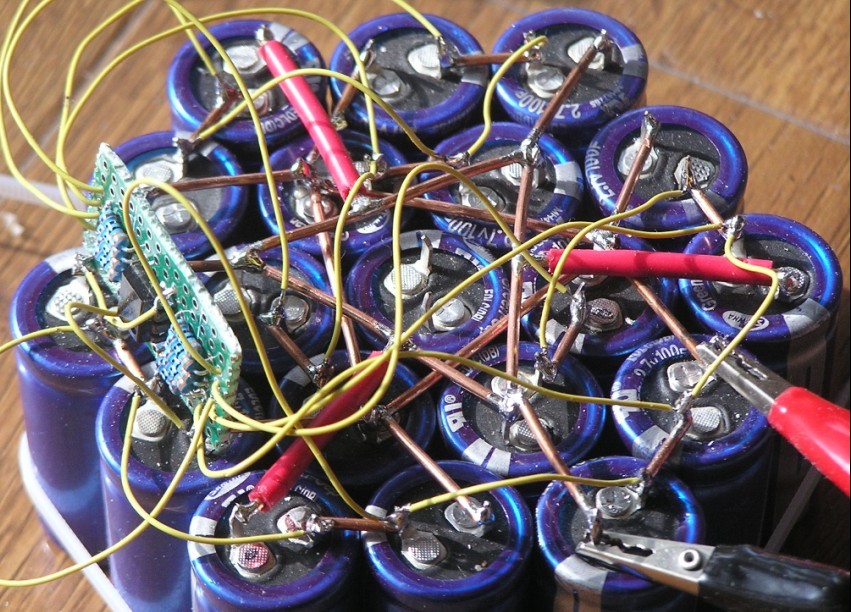

Speaking of cap arrays, here's my latest DAC PSU (for initial testing of the Aune card on my blog). Its a series-parallel array of 100F EDLCs. Since each cap is only rated to 2.7V I need to put two in series - the yellow wires are to the balancing circuit attempting to head-off any overvoltage on each.
Far out Abraxalito, that is incredible. Is it with the express aim of tightening up the bass? What other sonic benefits does it give?

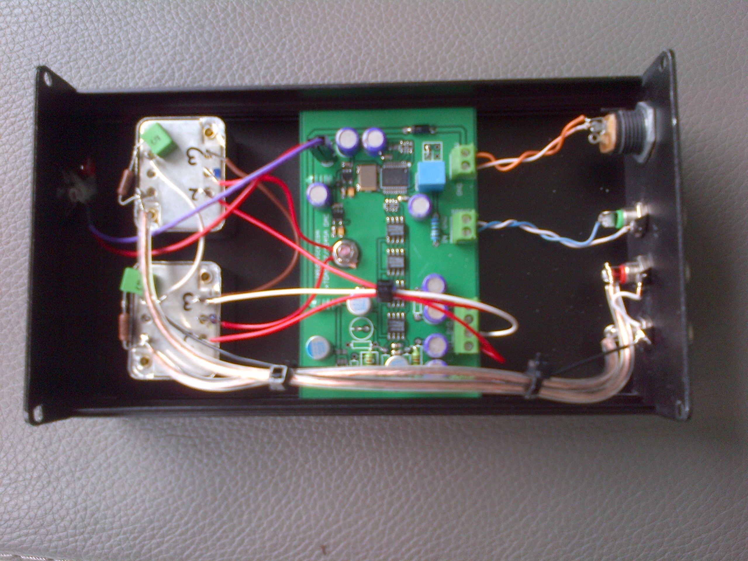

And here's my 4X TDA1387 with the output filter taken out, the iv resistors reduced to 120R and the output transformers installed.
Plenty of volume, no need for preamp, running it straight into power amp. Only been listening for a few hours, sound is excellent.

Actually the most enjoyable sonic benefits are the increased ambience noticeable at the lower frequencies. It gives a more impressive impression of spaciousness, more 'you are there' feeling. Tighter bass I haven't noticed (not to say it isn't there) just my attention gets drawn to the LF spaciousness.
So the trafo mod is definitely a winner then? 😀 Looks like a very clean, simple build. Good stuff.
