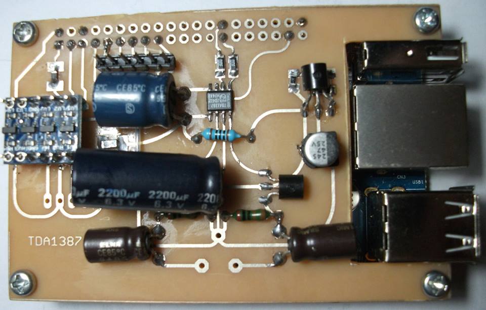

I use 2200uF, and its sound good on my Orange Pi PC 😀

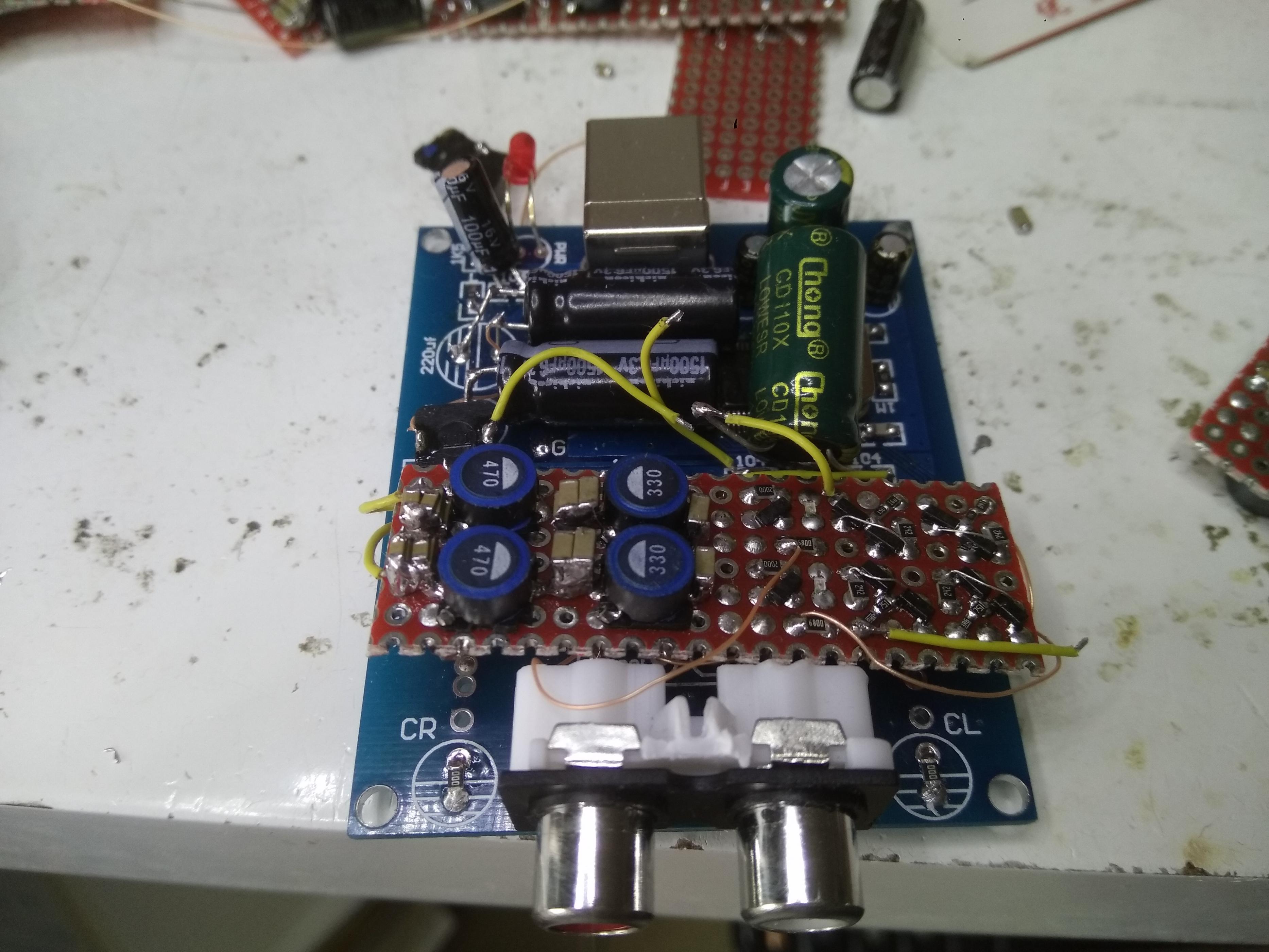

Cool! 😀 Next step up then is putting the 5th order CLCLC filter before the I/V transistor. I've compared with and without filter and having the filter in 'cleans up' the soundstage allowing every instrument to fall into its allotted place no matter how loud they're playing.
The red board you can see in this picture holds the CLCLC filter (left side) and the right side is the I/V stage. Because the filter needs a well-defined load, I bias the I/V transistor with more current (about 20mA) to get this particular load impedance. The extra transistors on the right are biassing current sources.
