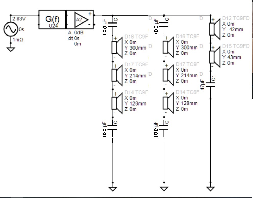

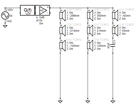

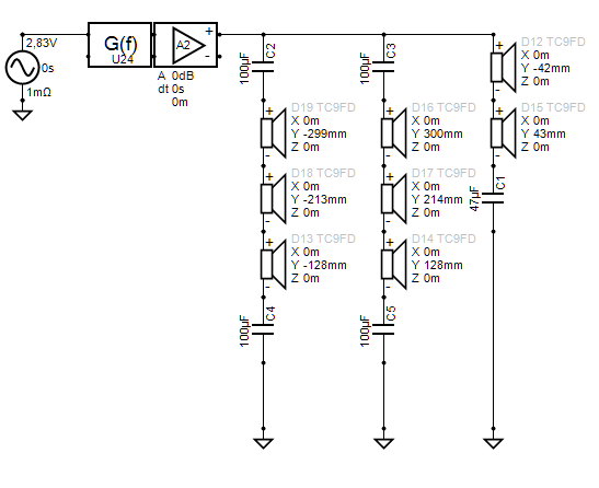

The "power shading" you discussed in post #40 would make the two center drivers just over 3dB louder than the outside six. The roughly 200Hz high pass capacitor on the center two would advance the HF by (about) 90 degrees relative to the other drivers, this may be what increased the apparent HF vertical dispersion at 10 feet, at the expense of reduced clarity at greater distance.

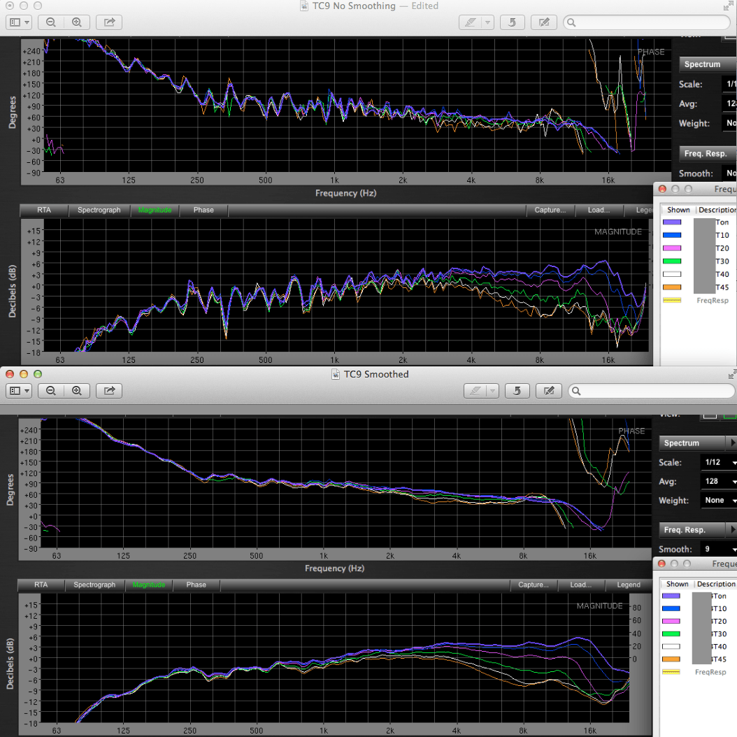

Bevels and horn/flare shapes as you depicted will if anything narrow HF dispersion and degrade the frequency and polar response. You could narrow dispersion with waveguides, but to widen it would require a slot exit of 1 inch (or less) wide, which would also would degrade the frequency and polar response.

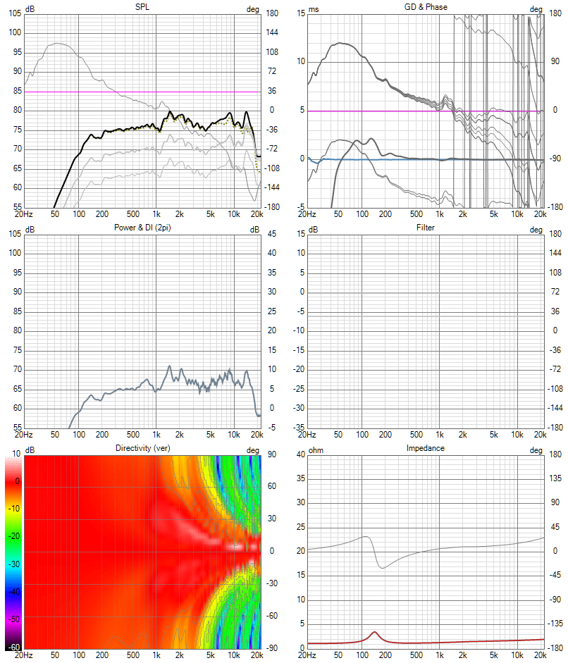

The horizontal dispersion of your line will be dictated by the TC9's native dispersion, which goes from near omnidirectional (with no baffle) at about 600Hz, narrowing to 90 degrees (-6dB @45degrees off axis, "T45" in the graphs below) at 3.15 kHz.
At 8kHz, dispersion is only 40 degrees (-6dB @20 degrees off axis).
The TC9 actually has unusually wide and smooth HF dispersion for a driver of it's diameter:
If you want wider controlled directivity you could use a HF horn (like in your EV SX200..) crossed in at around 3.15kHz above the cone drivers.

Assuming the capacitor is causing (90°?) phase and that's helping the Vertical(?)....what about if I added 2 fairly pointless ones just for phase increase on the other driver banks ? (forgive all the wrong labels, I used snip and paint!)

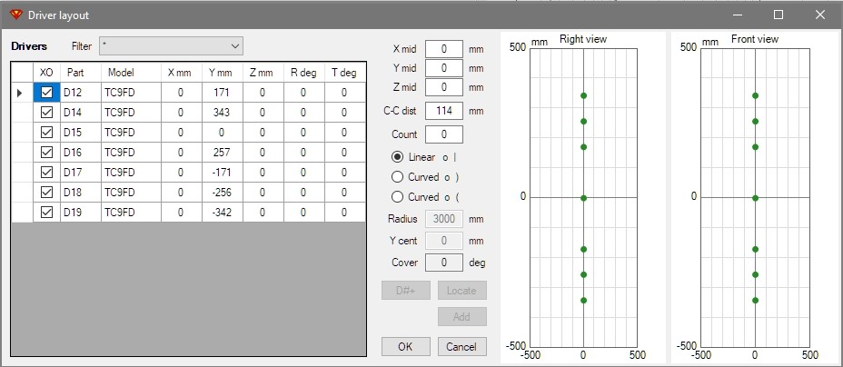

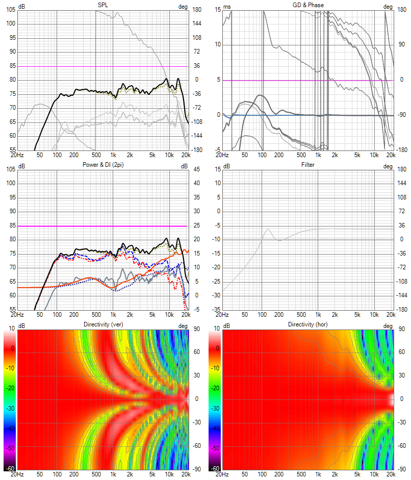

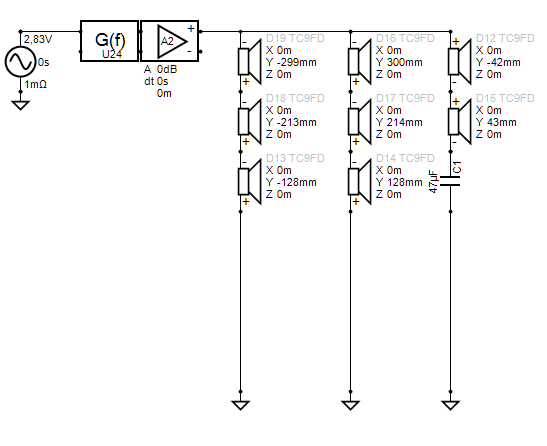

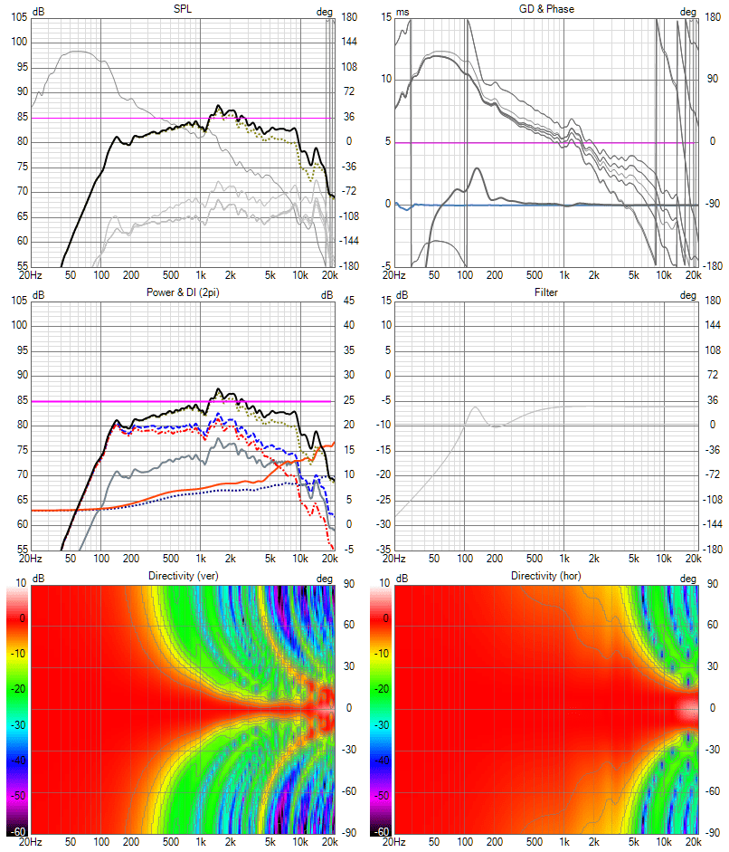

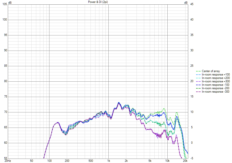

At a distance of 5 meter I plotted the in-room simulation at the center of the array height and 100, 200 and 300 mm above and below it:
So you see how narrow that top end really is. +/- 10 centimeter (4 inch) you'd be fine, any more than that and it drops of fast vertically.
Even at 5 meter distance.
Thank you for modelling that for me. The simulations are so helpful and it seems, accurate!

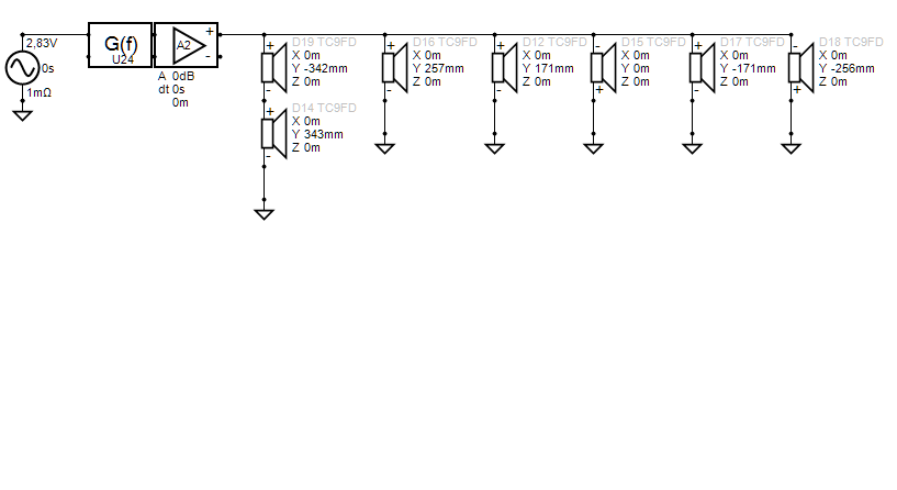

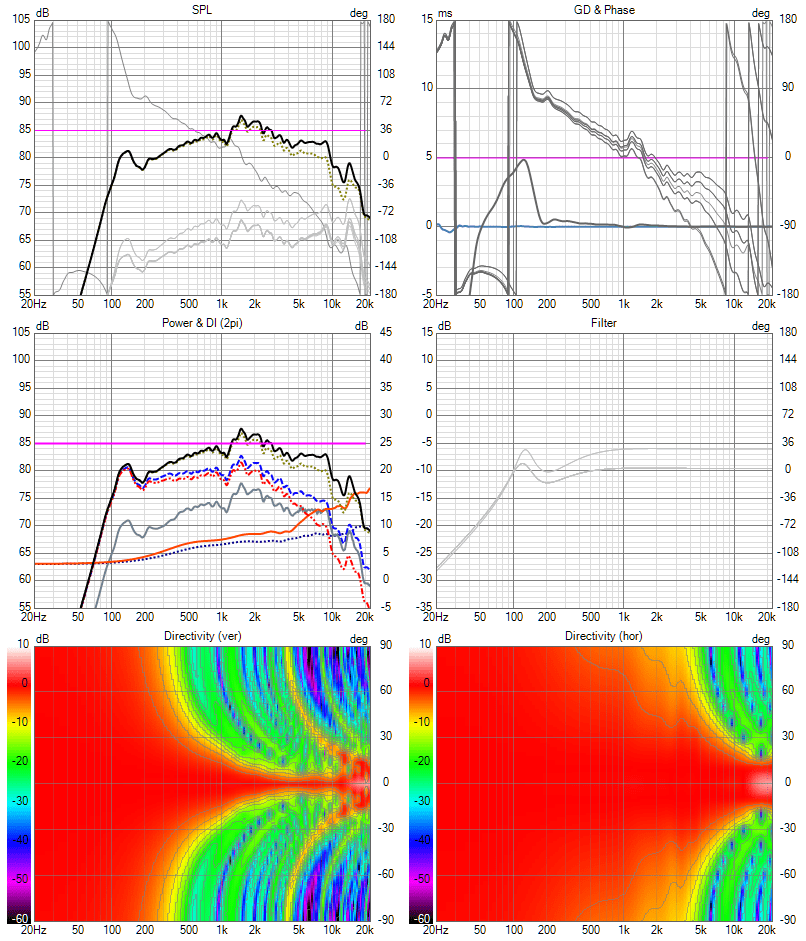

There's always the Bessel array that will restore the vertical pattern to mimic that of a single driver:
This is a 9 driver Bessel array, but within a 9 driver bessel, two of them do nothing, so it only takes 7 drivers that are spaced as a 9 driver array.
To quote from the linked text:
Nine drive units will have a function ratio of A:B:C😀:E:F:G:H:I = 1:2:2:0:-2:0:2:-2:1, thus two may be omitted.
See:
Two empty spots at 85 mm and -85 mm (the zero position being the design/listening axis here)

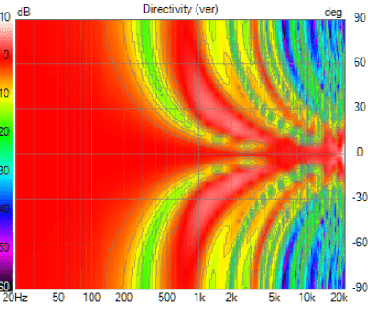

The bessel array will have a vertical coverage that resembles the coverage of a single driver:
But it does result in a very low impedance with all those parallel connected drivers and the step up in sensitivity is pretty much gone.
So you'd have 7 drivers but it's output is only about 5/6 dB higher than a single driver with the same amount of power applied:

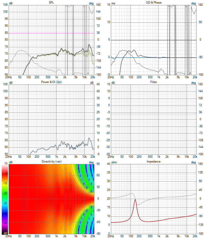

A single driver in comparison.
Power frequency AND phase are forms of shading?
Yes, all three can be of influence when edited separately. One could use frequency shading, by applying shelf filters instead of power shading. That's what I did with my 25 driver array, to 'bundle' the vertical output. That way I kept the higher sensitivity of the array at bass frequencies, as all drivers still worked equally hard (more or less depending on the resistance of the passive components used).
Editing phase can also alter the sum of the drivers. See the bessel array for example, where 2 drivers are connected in reversed polarity (180 degree phase shift) plus the two outer drivers only get half the amount of power (the two drivers connected in series in the schematic).
