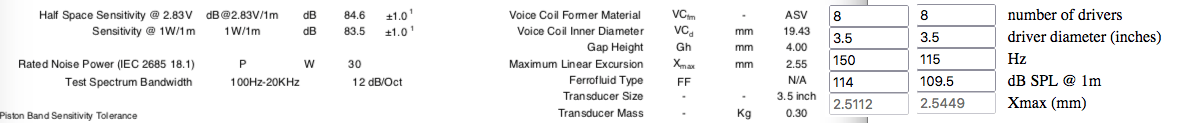

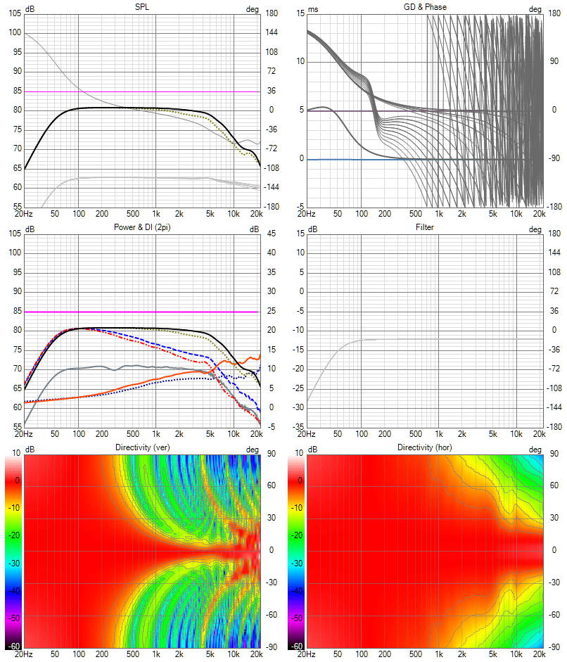

1) Sensitivity goes up 3dB per doubling of drivers and cabinet volume, so 8 of the 83.5 sensitive drivers =93.5dB sensitivity for the array.
The 8 drivers can hit around 110dB without exceeding Xmax at 115Hz, 114dB at 150 Hz. With 200 watts, should hit around 115dB.
By comparison, that’s less than a decent single 8”/tweeter output.

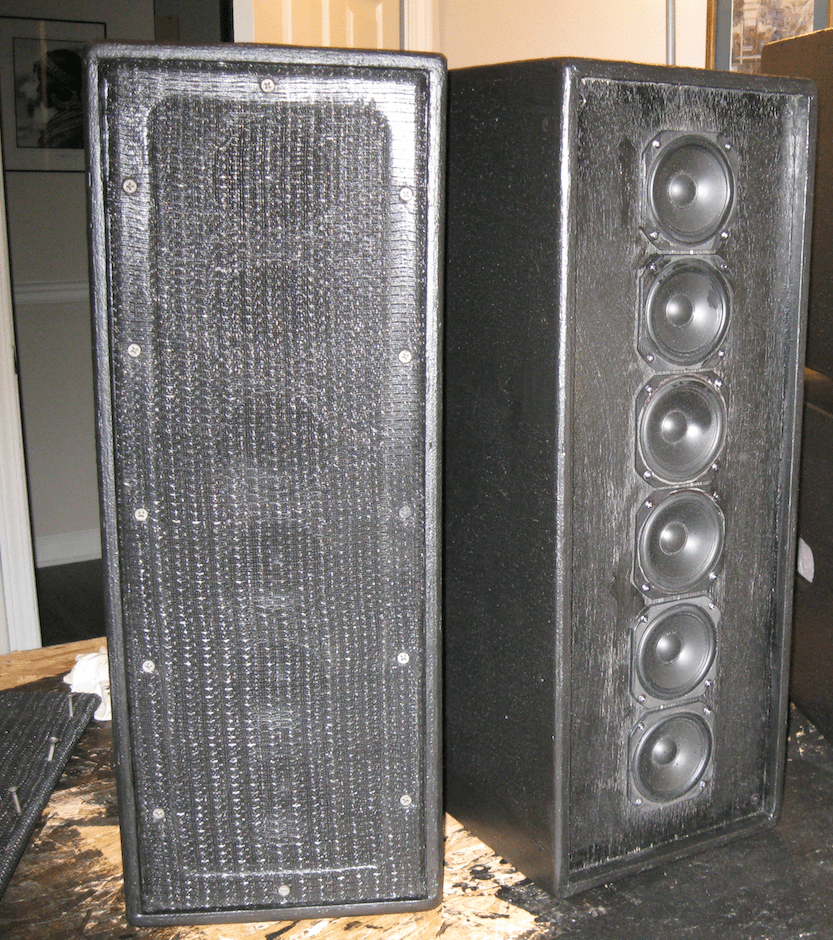

Put pole mounts in the top and bottom so can stack them with a pipe between.
5) The multiple HF sources do not combine constructively until the far field, consequently in the near field there is HF “comb filtering” going on, reducing the HF level there. In practice, the reduced HF near the source and added “presence” at distance helps with intelligibility and cutting through bar noise, without too much HF level near the source.
The near field for the low end ends at less than one meter, and the line without EQ drops from F3 to it’s top end. Reducing the outer or lower drivers HF level with low pass XO will require a large HF boost for center pair, which could be enough to burn the remaining drivers or clip the amp.
6) The splay would widen the VHF dispersion a bit, but reduce coherency at distance. Better to simply use a single tweeter and cross all the in line cones lower if you are concerned about the frequency dependent change in response from near to far field.

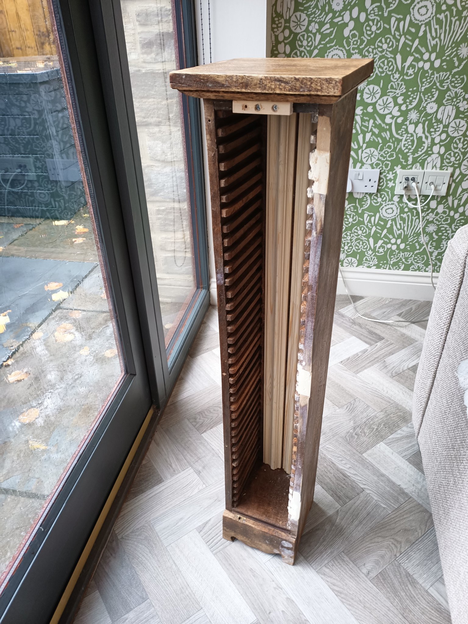

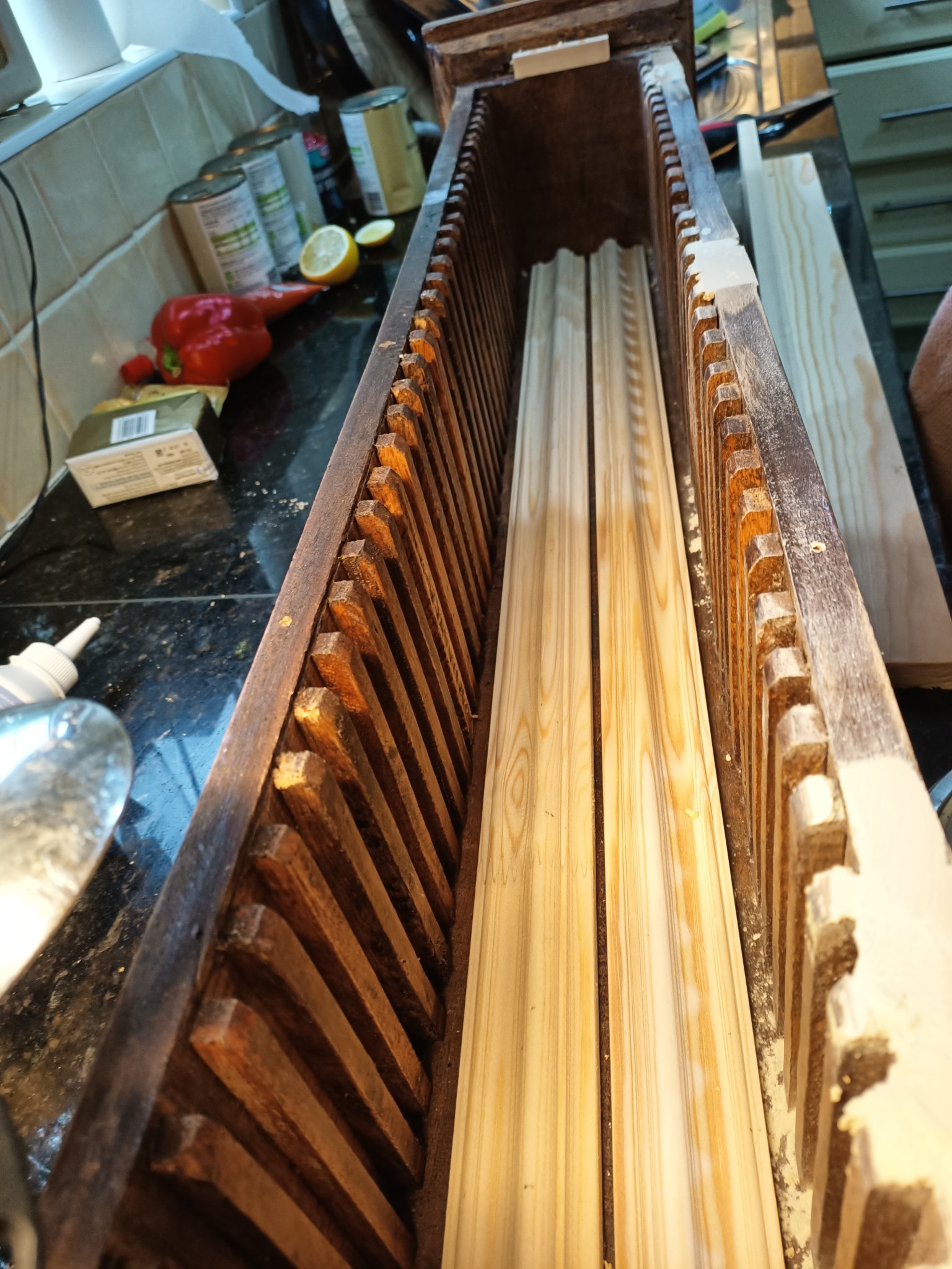

I'm sorry to say I have already fitted the bead strip into the back of the cabs before your reply came.
Yesterday, I was trawling through the classifieds, trying to find something ready-built that resembled a cabinet.
My wife had the great idea that a CD rack is shaped like what I was looking for, so I had one within the hour for £10!!
Anyway it seems to have a lot going for it, in that the internal size (of a CD!) seems good Vs the Vas and the ribbing inside might be sonically helpful? The volume per driver will be slightly bigger than the internal dimensions of a CD because I will be adding a front baffle which will lengthen by 15mm. I make it 1.67L.
-It's pretty sturdy too although I will add a brace in the middle as you suggested.

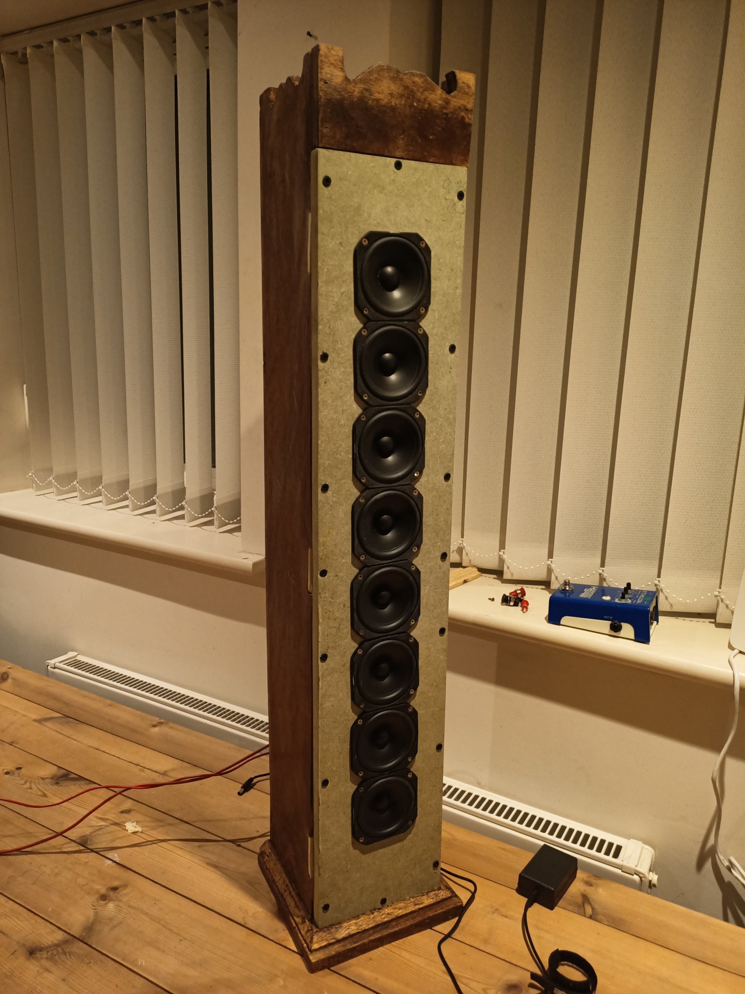

I didn't document my 6x 3.5" lines, never had them outside the house so far.
Definitely need subs, they are rolling off and run out of excursion below 100 Hz, there are another two+ octaves below that to cover. I'm using a pair of 15" under them for my home stereo.
At around 114 dB (each), they are not as loud as decent single 8”/tweeter cabinet's output, though I never play the stereo that loud.
Your line cabinets will have less volume than mine, so will require a bit more power to drive down low, though no problem if you cross as high as 150Hz.

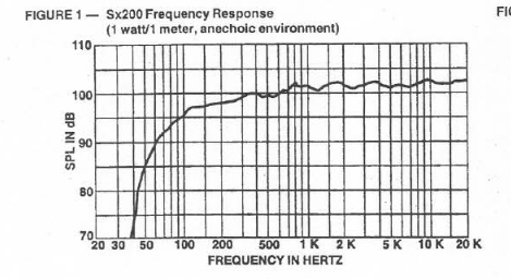

Yes, you could use 2 Aiyima Max's to make your Electro Voice SX200's active.
They would be considerably louder, go lower and are more efficient than the TC9 x8 line.
With 200watts, the line hits 115dB, and about 125Hz is the bottom.
With 200watts, the SX200 is 125dB, (sounds twice as loud) and about 80Hz is the bottom- the Low E of a 6 string guitar. Unless you are doing a lot of hand thumping, you probably would not to use subs with them.

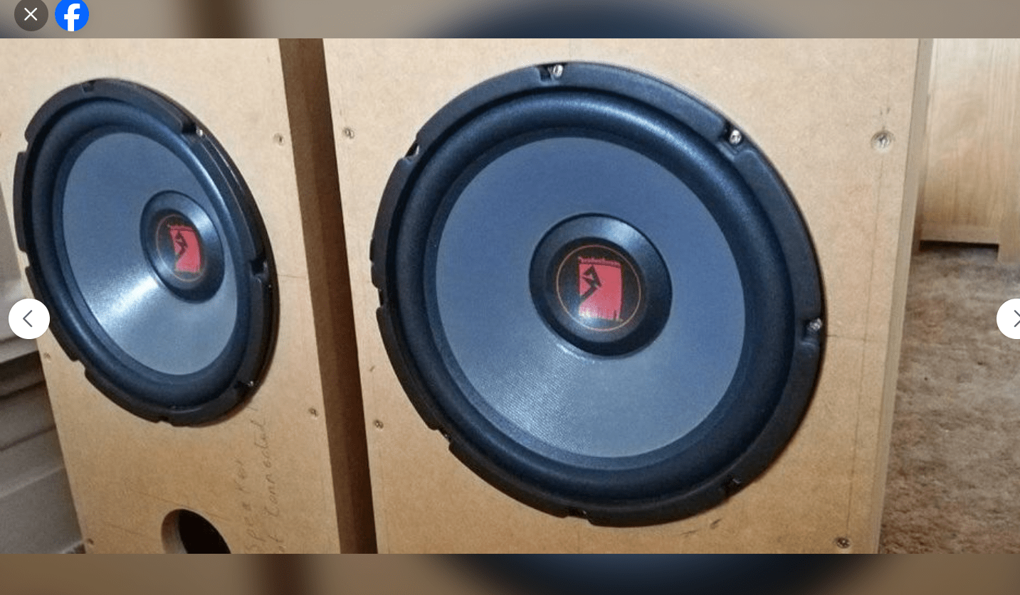

I have found a pair of nice looking home built passive 8 Ohm 10" subs for cheap that are tuned to 40Hz and have (18dB) crossovers at 120Hz.
They have something like this inside but older. I realise they are foam surround and are old but they are un-used, kept out of sunlight etc. Might be ok?
Ok, so if I put a 200uF (ish) bipolar in series with the array and modify the passive XO in the subs to 160Hz that'll work won't it?

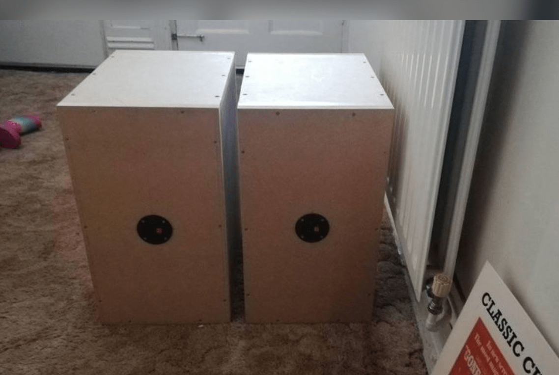

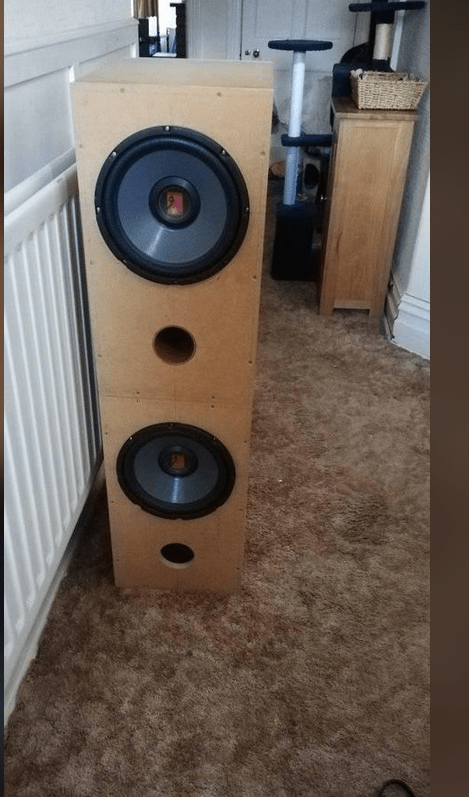

I haven't bought the (sub) speakers yet but here's some pics:

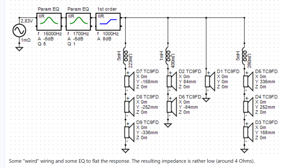

See some measured results here for a 9 driver array: https://www.diyaudio.com/community/...l-range-line-array.353658/page-7#post-7088894
With a 9 driver array, wiring gets a little easier with 3 groups of 3 drivers in series.
(series parallel, making the end impedance resemble that of a single driver)
In that same thread, starting about here: https://www.diyaudio.com/community/...l-range-line-array.353658/page-4#post-7038441 there are some simulations posted with a few different filters to get a wider vertical beam-width. Maybe there's something of use to you there. Though I doubt it would beat the Electro Voice SX 100 in raw SPL output. I have to agree, within the beam it can sound very nice. Just get your audience within that beam 😉. I run a 25 driver array myself for home entertainment. With filters these days.
View attachment 1233926View attachment 1233927View attachment 1233928
The built in crossover of these subs isn’t…..its just a low pass filter for the sub driver…..you‘ll need high pass protection for the array of you want any useful power handling…..i wouldn’t want anything lower than 200hz for your intended use.
If you can swing 9 drivers as Wesayso suggests, go for it……that’s roughly a 1 meter vertical beam……more than enough for flat plane club use…….seated ear height is 40 inches and standing height is 62……..you’re covered.
I've just set it up in a larger room. MY GOD THE HF IS SO NARROW!! DOH! I will definitely have a look at those links for ideas thanks!.
Seems it's got more sensitivity than 83dB (see post #2 above). Yes I do plan to Hi pass the array part thanks. I think it might be better to add another (bridge mode) Aiyima A07 max for whatever sub i end up with.

If you use the 4ohm version of the 3fe25 in 3 series groups of 3 wired in parallel, you get a nominal 4ohm load
The vertical array of 9 drivers with minimal spacing will be 30” and the vertical response is good out to about 10 degrees…..with an audience 6ft away thats more than enough coverage
Comb filtering rolloff will begin around 4500hz with a 3” center to center driver spacing.The 3FE has a rising response starting at 5000hz and is up on axis 10db at 12khz so it will offset the arrayed combing effect. Should have a near perfect tilted response to 10khz out to about 30 degrees off axis. You GOTTA high pass this though for any kind of power handling

Is there any way I can frequency or power shade my way through what I've got? I had a look at the link Wesayso kindly sent and struggled with it. It seems I'd have to use the 'heavy lift' solution which just won't work at hi power. (see pic below). The others seemed to be not relevant due to many more drivers required.
I guess this is why the RCF evox 8 works... they probably chose the right driver and left it un-shaded. DOH!
Anyway... Any ideas to save my array with the existing drivers in them would be gratefully received.
I could try to curve the baffle a bit? add XO's to cause time delay like here.?

4 ohm impedance isn’t low for live sound reinforcement….pretty standard practice for efficiency.
