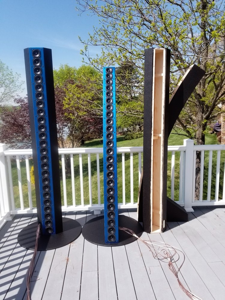

Hi, it looks like you are going down the path i went.....only you are planning more channels for the arrays than i did.
I built 24 driver TC9 columns with six channels of DSP/amplification. So four drivers per channel. I love the idea of a channel per driver !!!
The arrays I built used the same drivers/baffles that could mount in either a straight box or a CBT curved box. as shown below.
Even with my 6 channel limitation, I found it was pretty easy to use the straight array to mimic the CBT box, with delays and magnitude shading.
It wasn't quite as good as the CBT, but it was close. I think with 24 driver control it would have been better, but then again so would the CBT box...so dunno.
On the straight arrrays, i also played with frequency shading, and with delays to move the apparent acoustic center from the middle of the array to the top, for example. Tried concave as well, etc. It all worked very well.
You should have a blast with 24 channels and programmable DSP, other than all the wiring necessary and putting settings into the DSP lol.
I think you will learn so much, just from playing around easily, that i wouldn't spend any time trying to predict with simulations etc...
I used an open architecture processor too...Q-Sys. Those biamps look like a really inexpensive way to dip into multi-channel DSP, with great preset capacity.
It was so cool to be able to instantly switch the straight lines from a regular full normal line setup, to CBT mimic, to concave focus, to frequency shaded normal, to frequency shaded top, etc, etc.
Good luck!

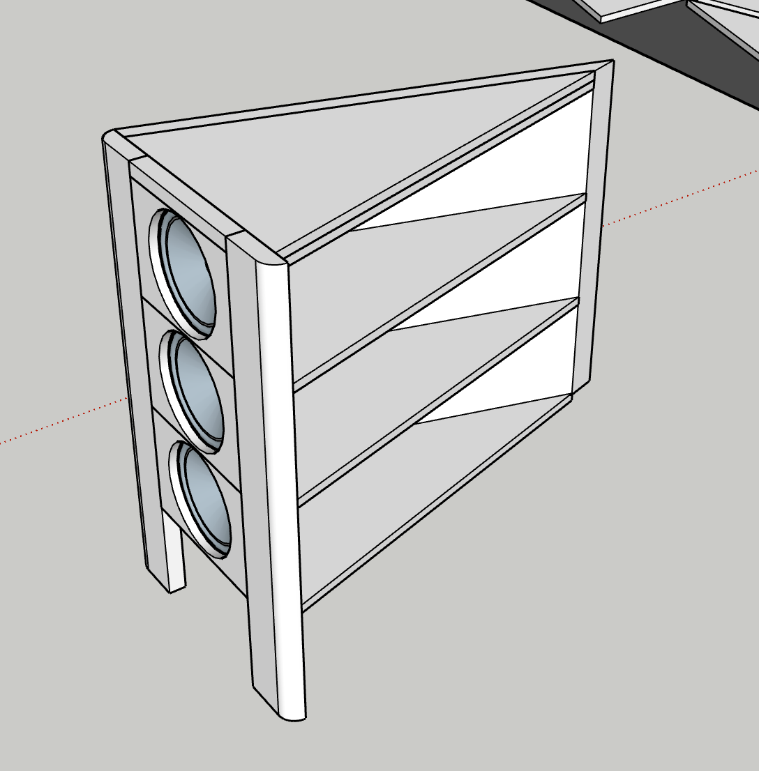

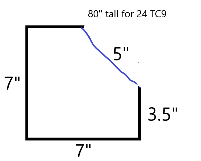

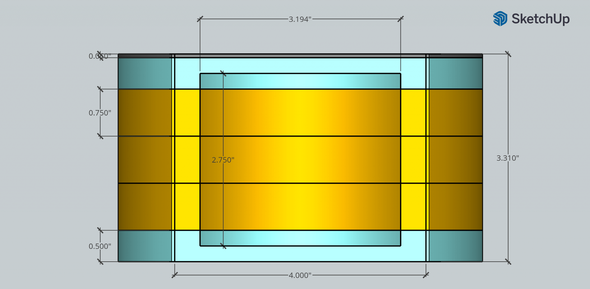

Here's a quick diagram of the internal dimensions of the straight line box. About 56L volume not accounting for a couple of small cross sectional braces, and drivers hanging in. Maybe about 2 1/4 L per driver.
I was trying to copy the Murphy Corner plans, but I had to make the dimensions a little bigger to accommodate the removable baffle I wanted, to be able to have both the staight array and CBT.
fwiw, i dont like the 'corner' array idea anymore. I think the horizontal sidewall reflections look good as mirrors in theory, but in practice create a mess. A mess that needs a lot of sidewall absorption adjacent to the lines ....
or just give up and move them out into the room, where for me they worked much better, letting the vertical line do its stuff without the lateral mess.
(Wesayso has them nailed imo.)

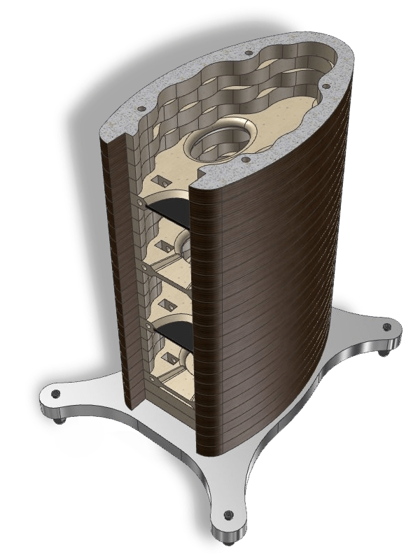

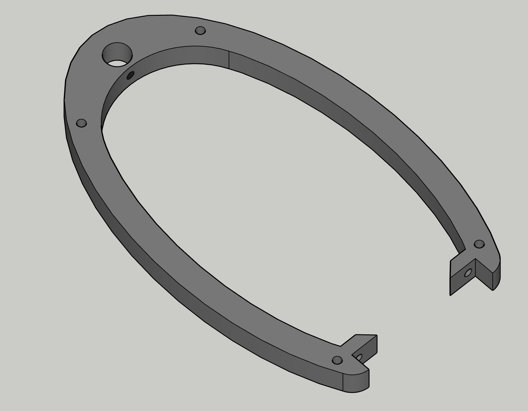

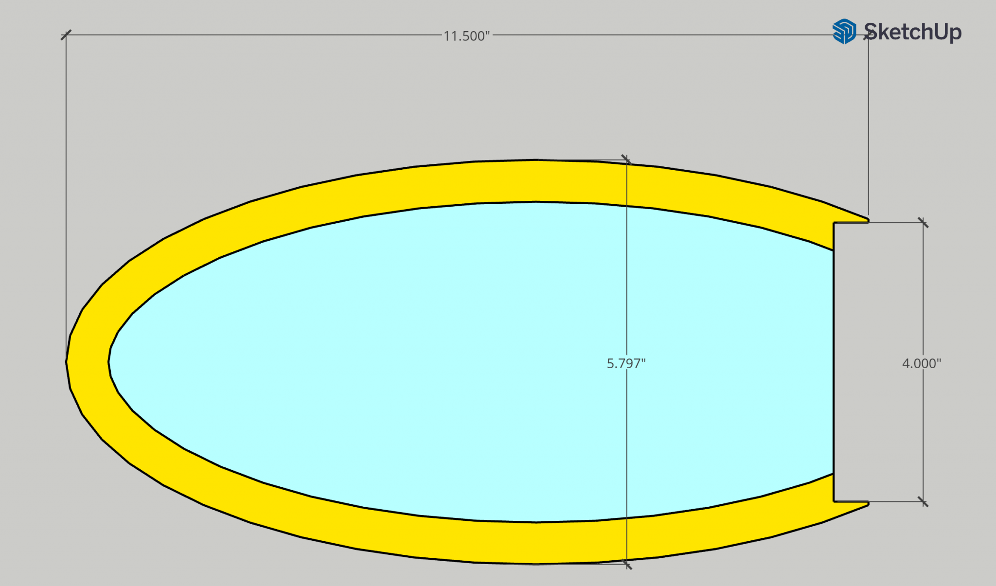

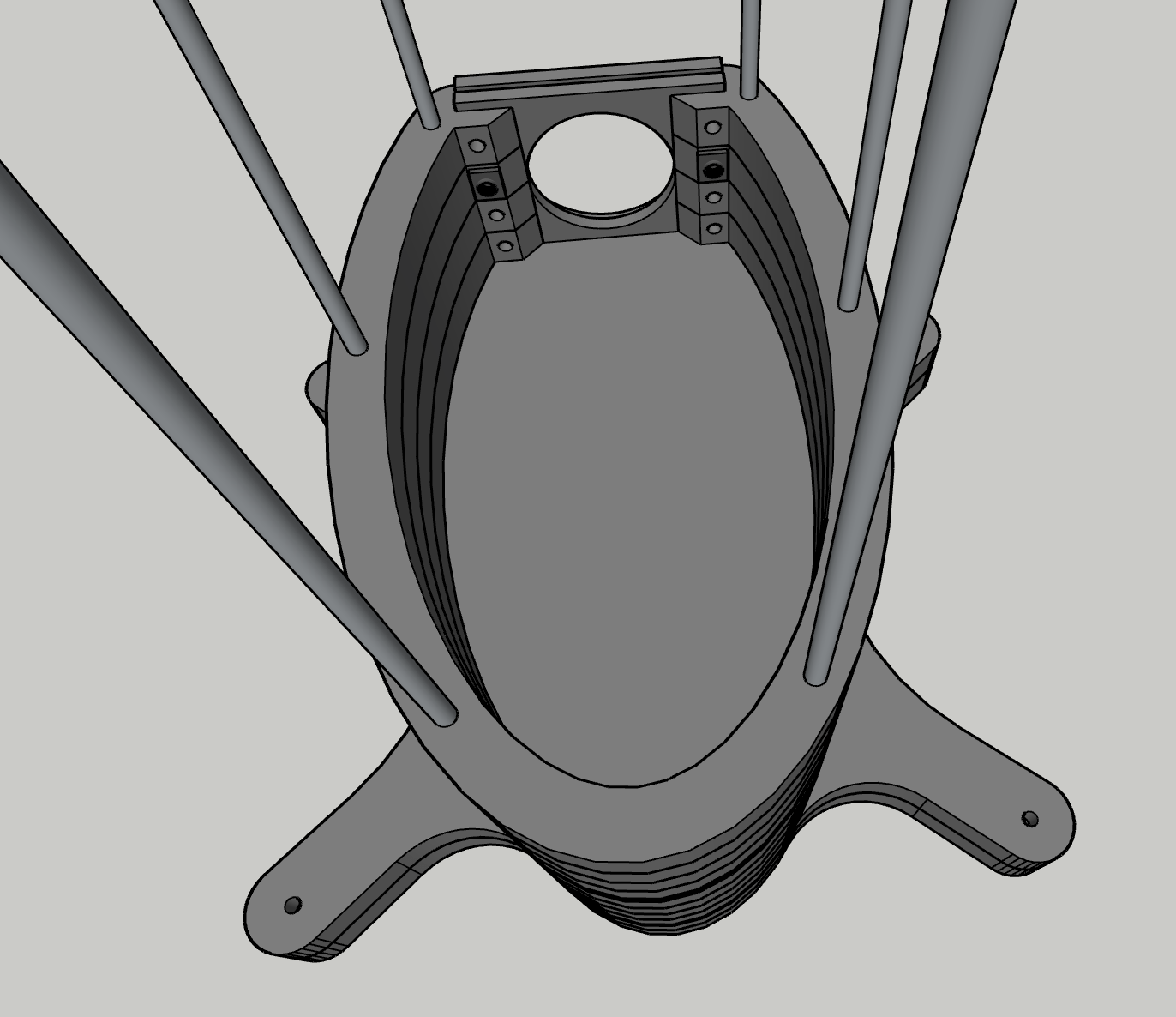

Been exploring trans-lam designs as a possibility.
The main issue becomes how do layers to give each driver its own chamber. The drivers are 3.3" tall. Using 1/2" or 3/4" MDF layers add up to 3.25", adding in a 0.06" layer of silicone rubber between sections, gets me to 3.31".
I'll add the diffusing bumps like Wesayso has in his design- still going to have the top and bottom of the chamber to contend with.
Curious if it's possible to glue these 5 layers, add in the silicone layer between modules, then stack them on threaded rods and clamp the whole setup. I saw Wesayso's cracking saga and it looks like it came down to gluing the rods in place, so def. avoiding that 🙂

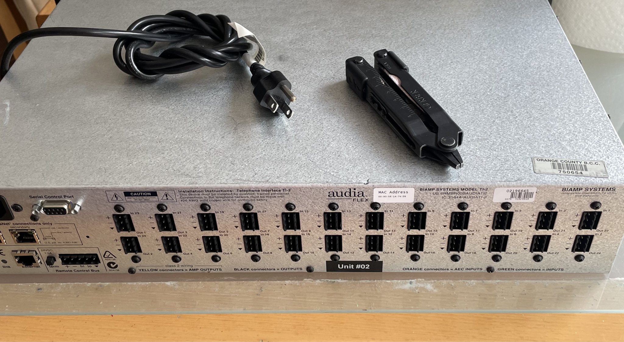

Another update- I have sourced another 24ch dsp box, so now I can do all drivers active. Confirmed that the various delay+attenuation settings can be scripted and be adjustable with a remote. Very much looking forward to clicking between various topologies to see whats my favorite.
Also worked out how to get a digital input to the dsp system, via cobranet, which was a challenge. Ended up finding an AES to CobraNet box, QSC Rave, and I'll be feeding it via SPDIF or a toslink to AES converter.

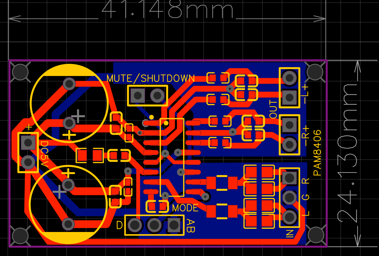

On the amplifier front I have drawn up a design with the pam8406 IC and have it populated and ready to order+assemble from JLCPCB, along with power/input+output daughter boards. The amp box with 24 modules is going to be a shitshow of jumper wires unless I decide to merge multiples onto 12ch boards, but thats out of my depth for now.

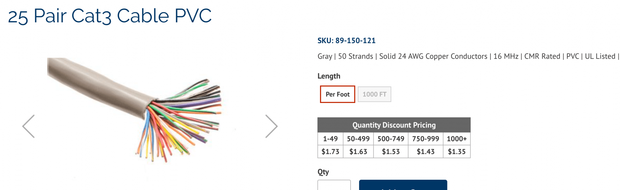

Also found some interesting 25pair, 24awg, telephone wire to potentially use from the amp to each tower with 25 pin dsub connectors on each end. I'll have to ask around if this is ok to use since its quite thin at 24awg. The run is short, (only 12' max) and its only 2W absolute max per driver.

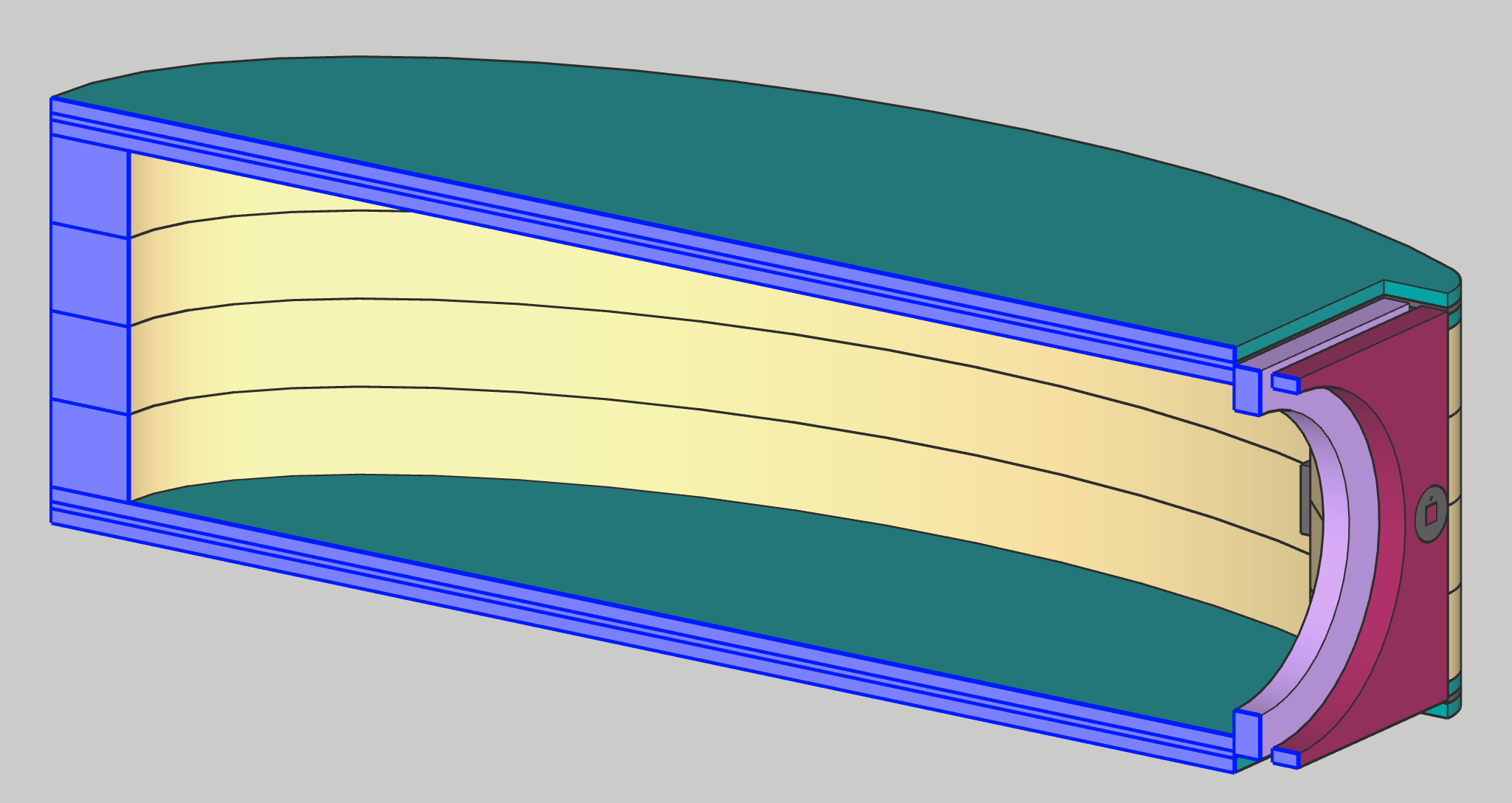

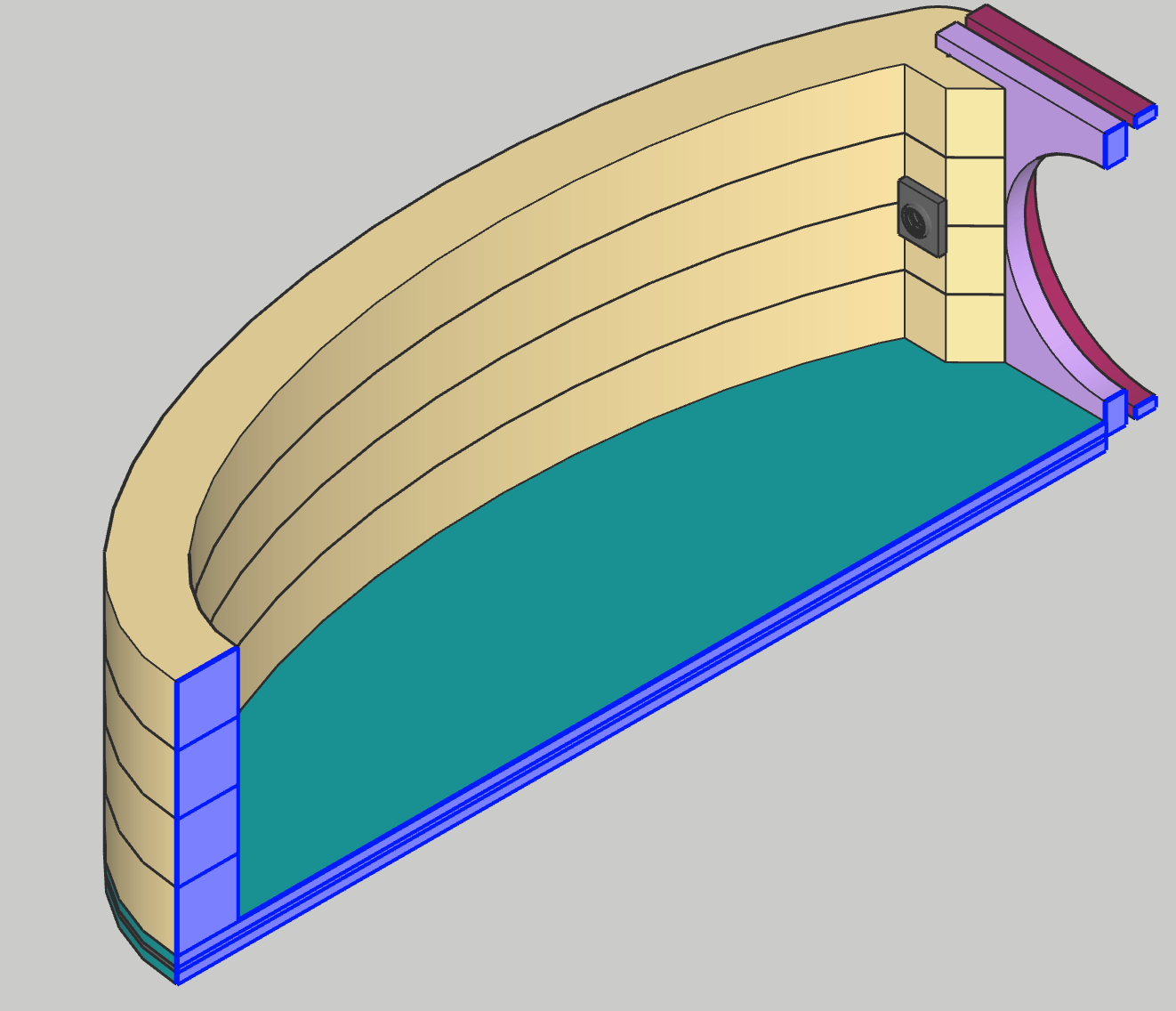

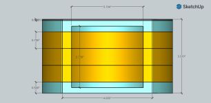

This stack looks like the best bet. Its a 1.5mm layer of taskboard, two 1/2" MDF layers, and three 3/4" MDF layers. I'm already way over on the amount of cutting I wanted to do.
Its the only arrangement I've found that gets me close to the 3.3" thickness per chamber.
Next is to explore what can be done with adding in a separately cut divider- instead of making it by milling out of portion of a teal layer.
TBD which would be less work- to do another cut with a template vs milling 1/4" out of the teal layers.

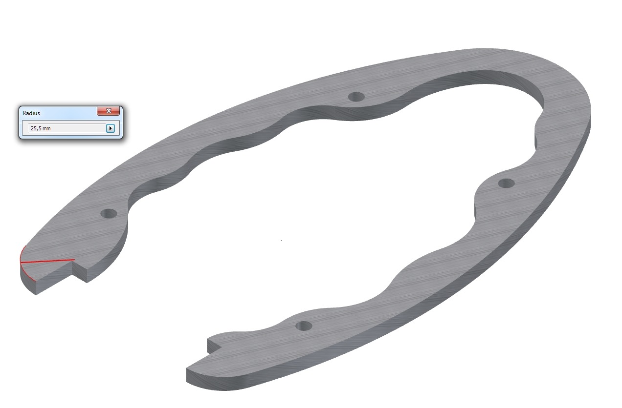

I didn't dare use MDF as I figured it changes size/thickness due to humidity even faster than Baltic birch. The use of an alu baffle was durability if it needed service. I'm glad I chose it, even if it was a lot of work. I've assembled/disassembled it quite a few times over the years and it still is good as new.
Short stacks like you are planning should not crack, but I cannot promise anything. 🙂 If I were in your shoes, I'd make the enclosure just a hair wider and round off the shape so it transitions to the baffle in a smooth flowing line... I used a 25.5mm radius.
The wavy internal pattern was offset/different left vs right so I could stack them using only one shape and just flip over every other piece.
If anything, it makes the wall thickness vary. I don't think it does much for breaking up the internal wave front (too small), but filling it with (varying) damping materials will.

I made the whole thing a bit wider to allow more space to mount the driver+baffle panels. Good call there.
So do you think its worth the effort to include the wavy pattern? I can't quite figure out how to make one that looks nice like yours.
I figure I'll line the walls with felt or carpet scrap and include a good amount of polyfill/denim towards the rear of the chamber.
Does having varying thickness of the walls improve anything?
I settled on this sandwich pattern to include the silicone/rubber layer between each chamber. It may help keep things more "isolated." and allow some room for expansion/contraction. Its available as a laser cut material from an online shop.
The 1/8" layers will probably be masonite instead of MDF. I have to look into making sure they will bond together with the MDF.
Wrt the outer baffle- I am considering doing this fastener approach. Its a lot of bolts but I don't see another way/attachment point. I'm also considering making it 24 unique sections/per driver to allow them to "float" a bit for seasonal changes.

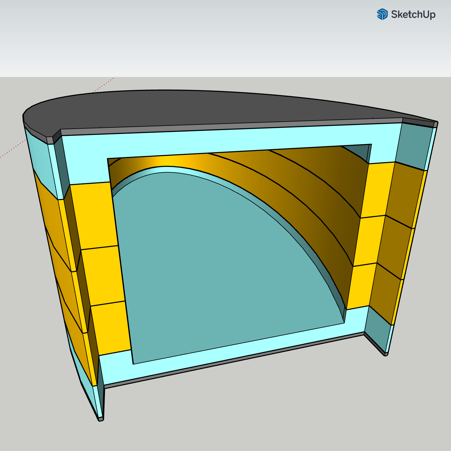

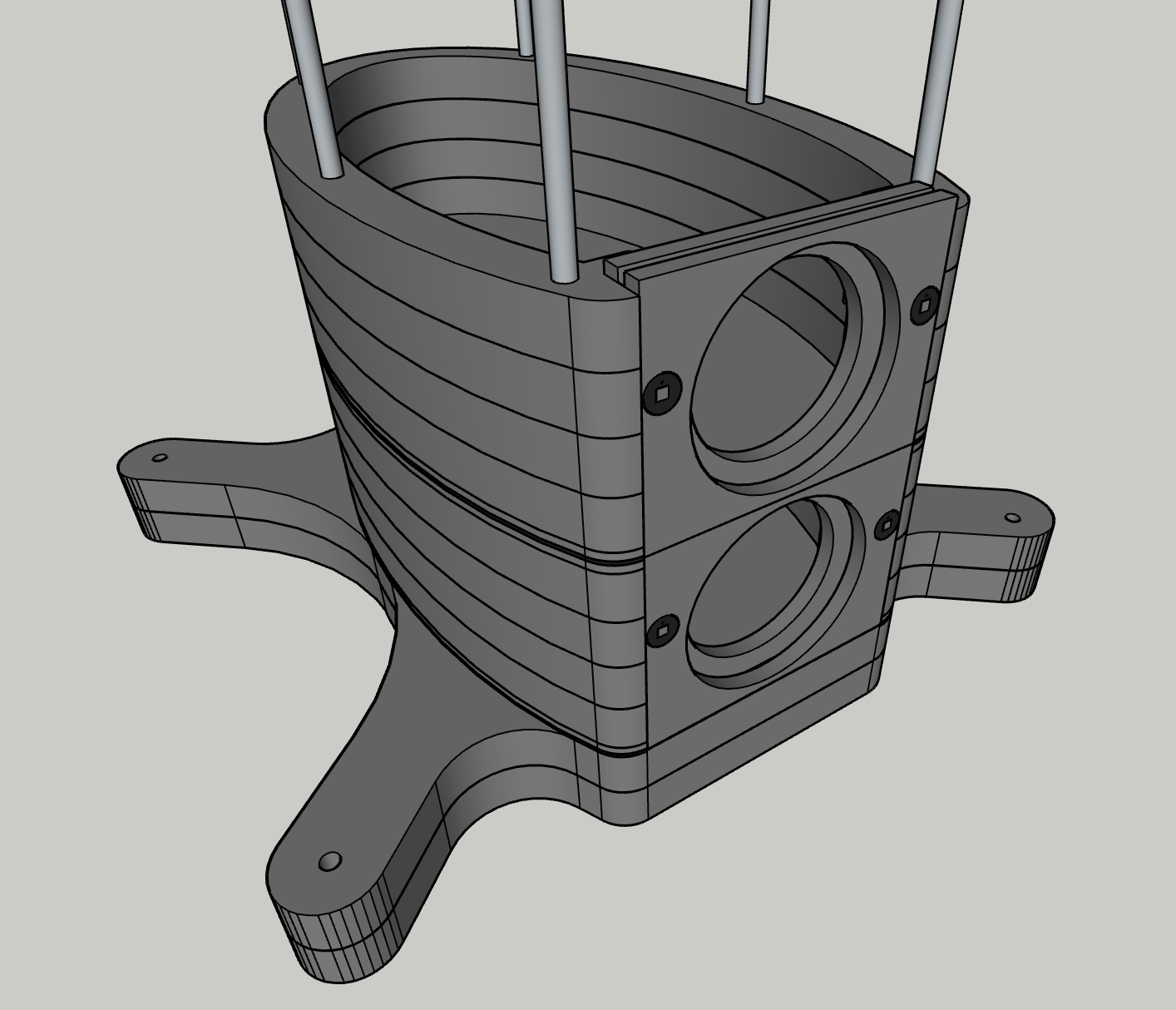

ok. had another spare few hours today. gonna start getting templates prepped from these models. I'm getting super psyched to get cutting wood in maybe a week or two!
still need to figure out how i'm running wires to each chamber. any ideas on what wire gauge would be sufficient for this? or how to determine?

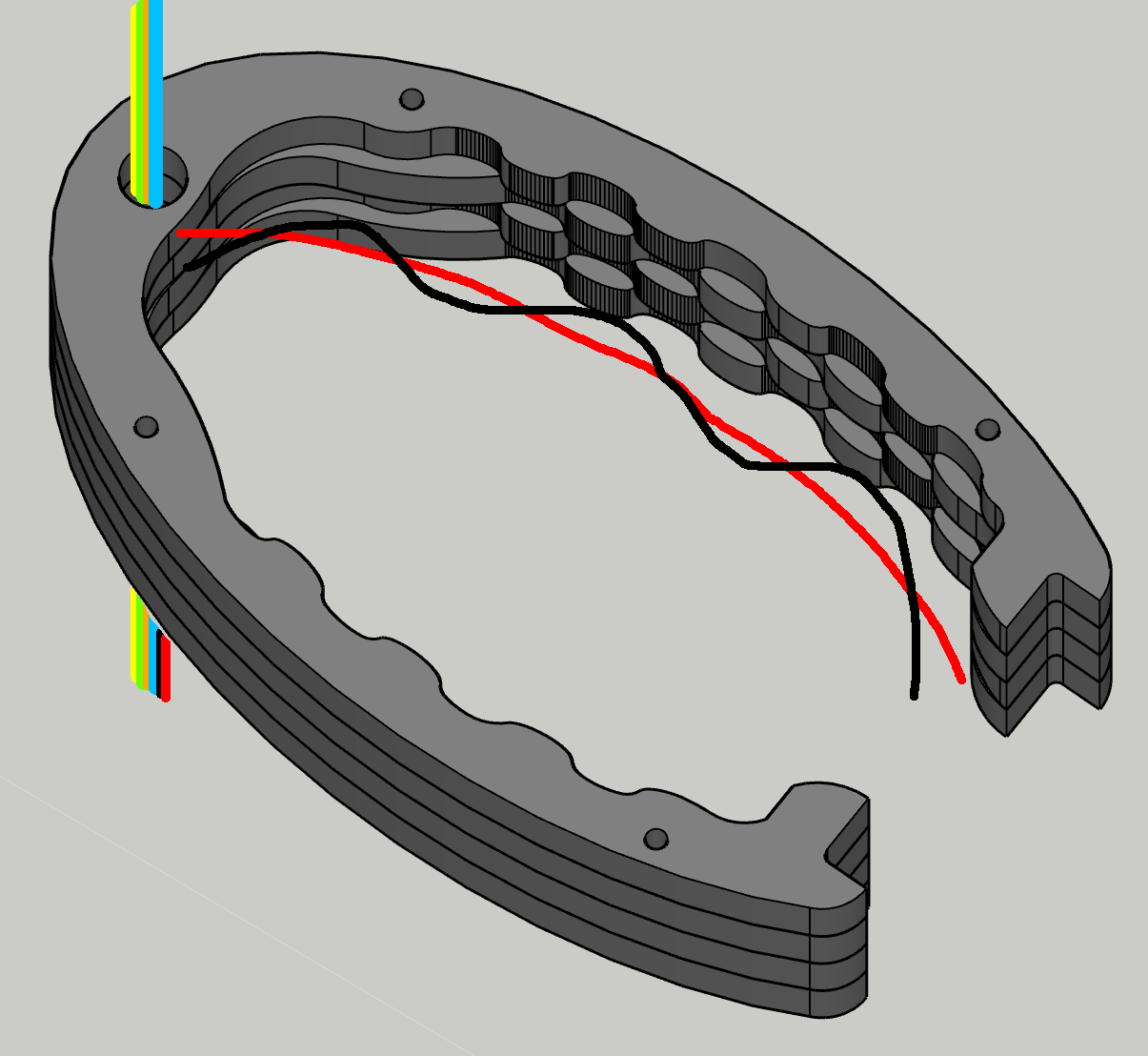

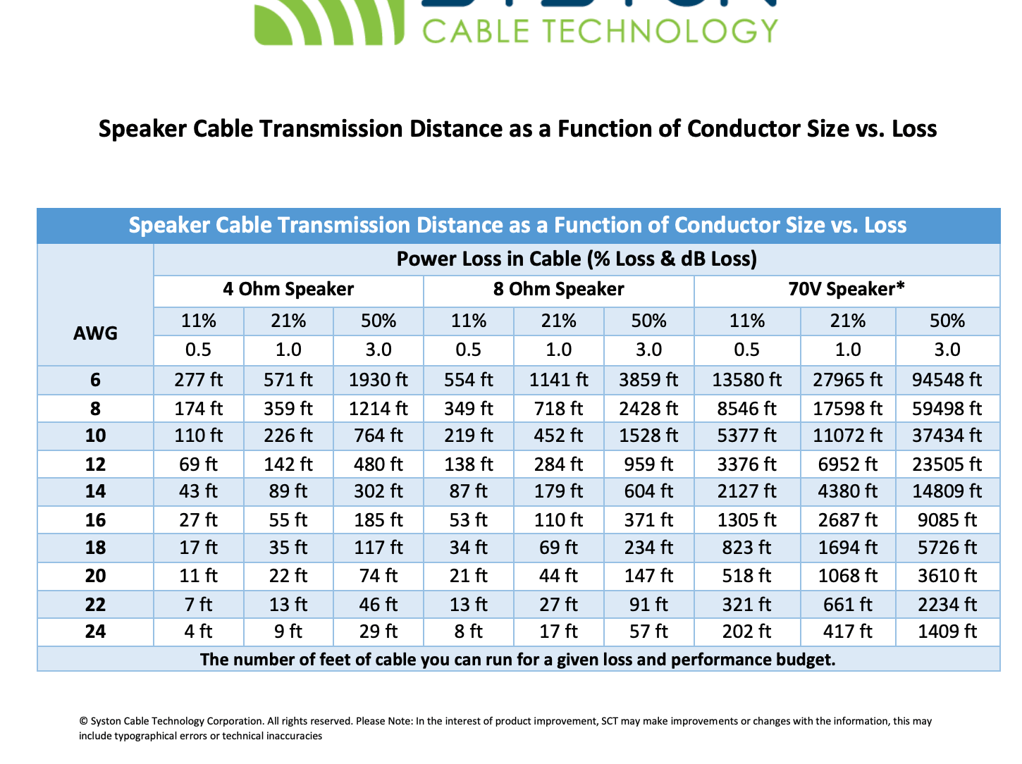

Lol, I just ran the first numbers on wiring. Each tower needs 107' of wire just to get everything to the base.
10' of wire from the tower to the amps adds another 240'
so yeah, the 24awg telephone wire is the way to go for now.

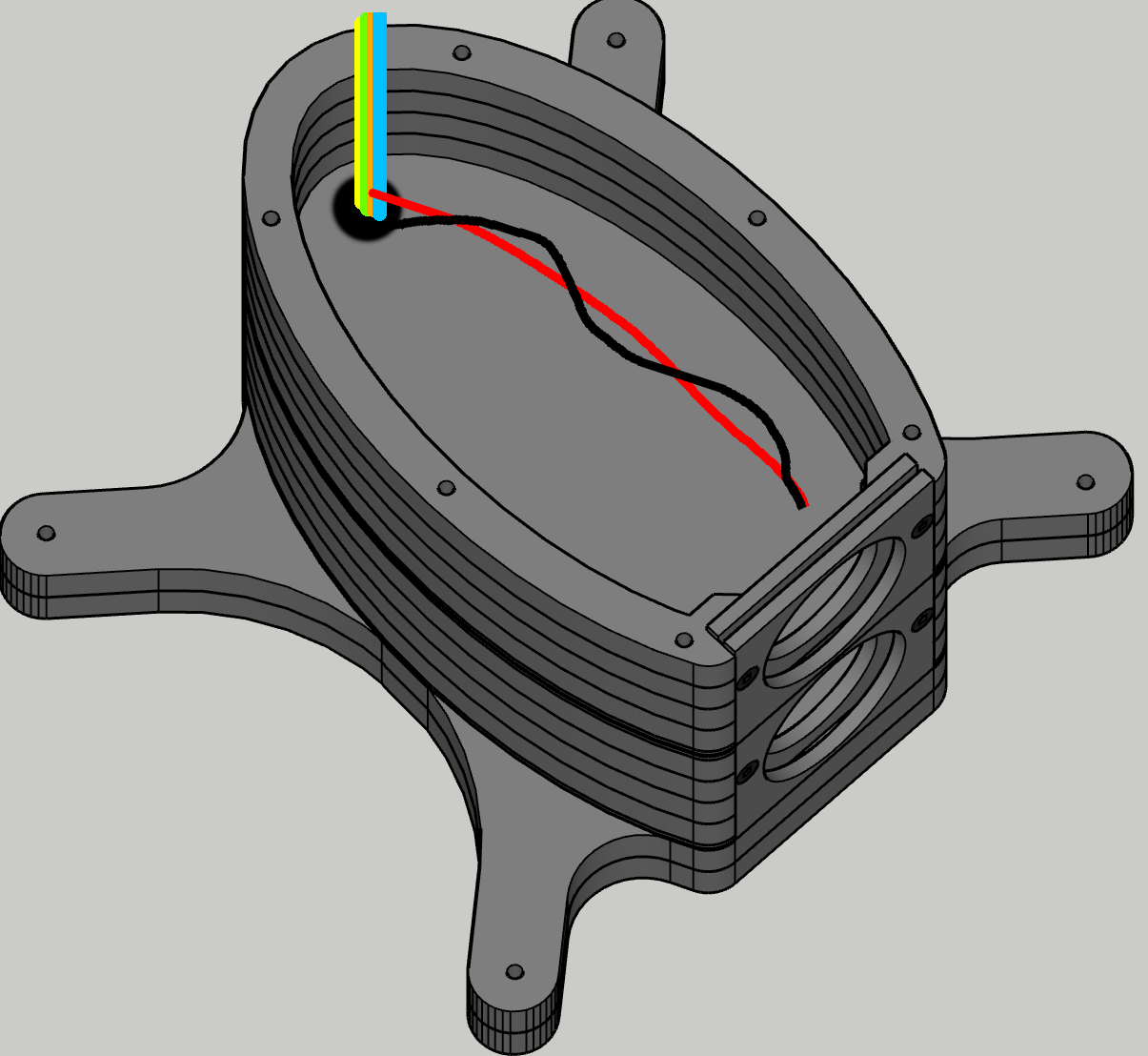

Ok I think this revision solves the wire run by going up the spine. I'll keep the other sections the same so its a minimal loss of chamber volume.
It will need something to seal the hole with the wires through it- but its going to be so tiny i'm not worried.
Don't make it too difficult to setup... wiring a line array is a tedious job already, do not make it worse 🙂.
If I were you I'd stick with simple holes between chambers that you can plug with a rubbery glue once the wire is in.
If I understand the above picture, you want to route the cable in the enclosure wall and stick out one pair of wires at each driver?
Why would you make it this hard? Just drilling a hole right before the enclosure wall between chambers would have the same function?
I appreciate the advice. You're so right - I have to remind myself that its easy to design things on the computer that would be nightmares to actually put together, all without realizing it.
I'm not sure I understand the routing you're describing. I've included two diagrams- one with the wire inside the wall. the other with it passing through the floor. Is this what you mean? You're right thats much simpler to accomplish.
