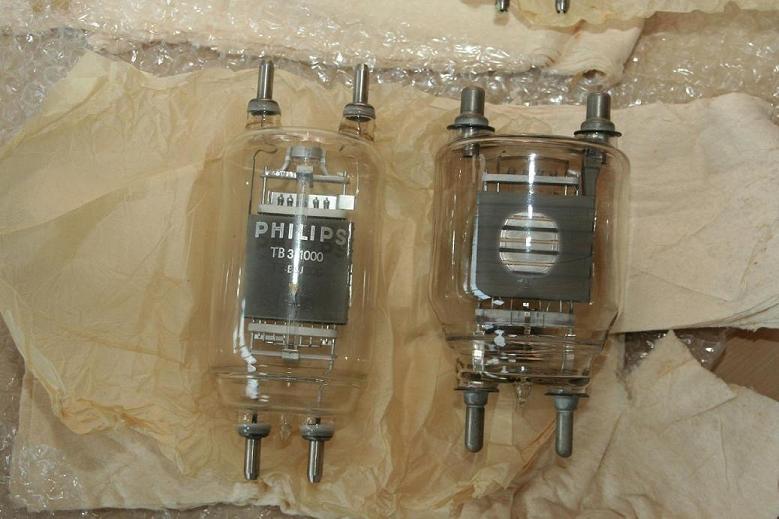

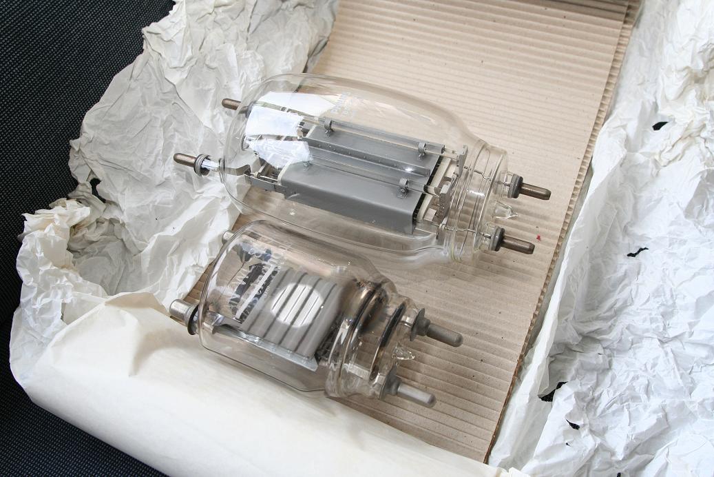

Just back from a long overseas trip. I checked Ciel they still got TB3/1000 and bought 18 tubes. They arrived safely. Yes, you are right, TB3/1000 is way better built than 833A. A technical question need your help: at 800V plate voltage and +20v grid voltage, how much will be the grid current?
Good evening Jerry,
you did a great buy ! Not cheap...but worth it !
May i suggest to print out the THREE (3 !) different TB 3/1000 datasheets on Frank's site( electron Tube Data sheets - T ). You will find at the .de datasheet (the middle one) a very usable sheet for your question:
800V - 20V at the grid......350 mA anodecurrent.
Succes with the building and if you need funny Caddock resistors (+1000V; non-inductive) ...maybe i can be of assistance.
Regards, Reinout

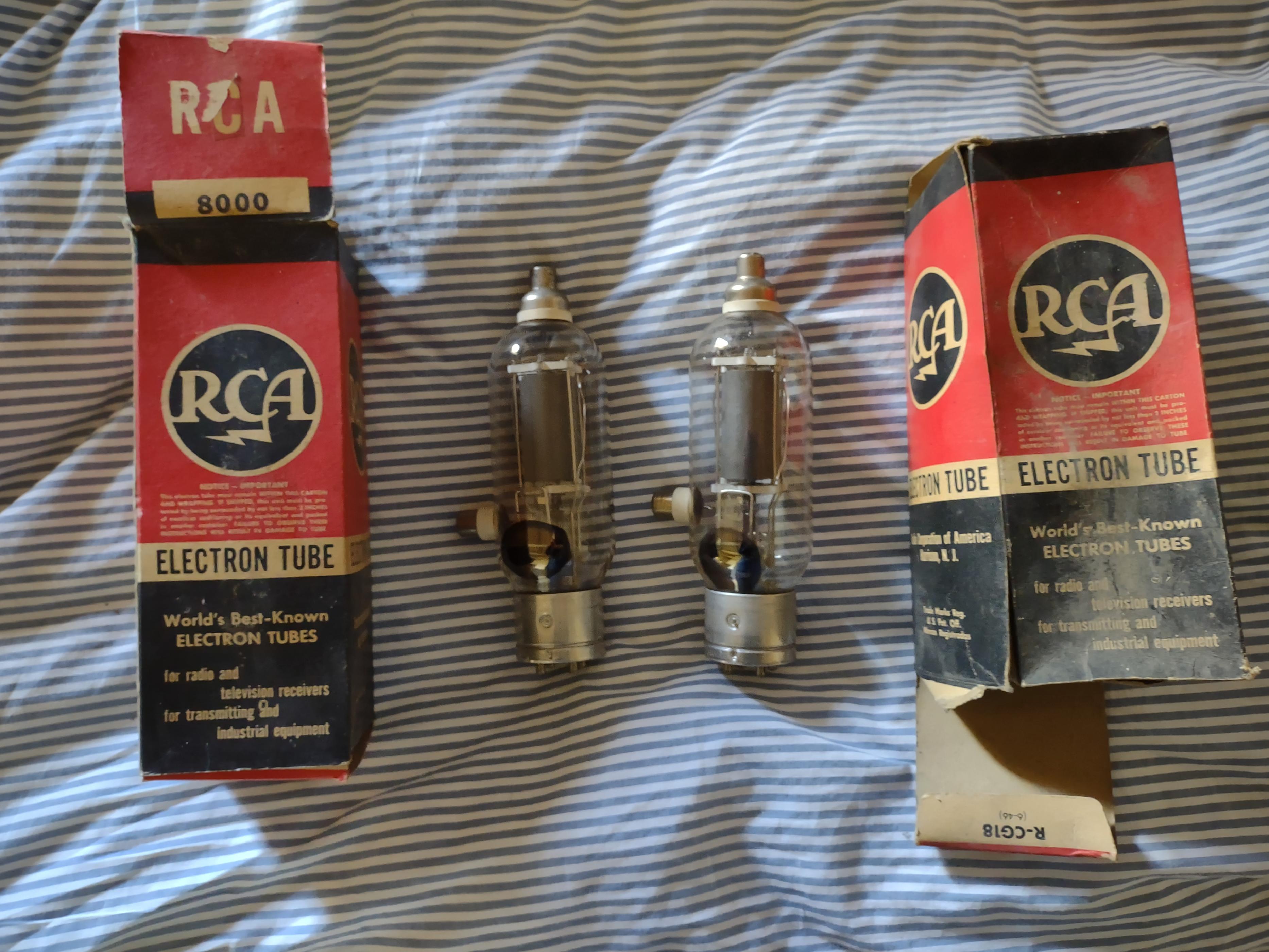

Sorry to barge in, but I have a couple of 8000 tubes, and was wondering if they have any potential use? It looked from the tube data sheet that they could work with 600V on the plate and 1000R load, but then I realised how much heat was involved when I saw the plate current would be around 400mA!
It would be too much of a project for me, but interested if they could be harnessed.
