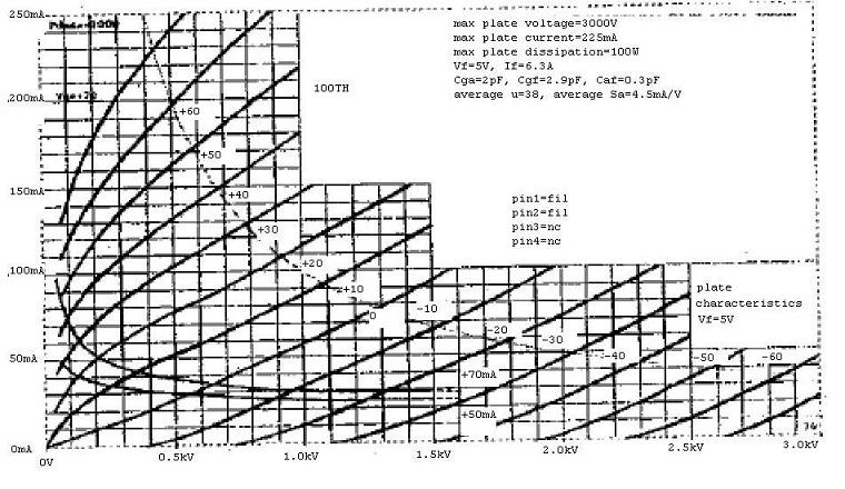

What are you going to do with 100THs? Nice (very nice actually) bottle. The plate structure makes it shine bright. I loved them.
Best thing to do, is to use it as driver for output stages. I biased it at 750V/25ma/-5v (take the numbers as indications). Rp was 18k and I CCS loaded it with mosfets (mu-follower). I try to upload the plate curves. You will find them useful.
The plate gets its cherry colour only at 50W or more.
If you plan to use it as an output tube you will need to (run it in class A2) use quite a good amount of feedback. There must be a Shishido amp somewhere in the internet.

Bona sera Gluca ;)
Thanks for your usefull details and the curves.
I will take the 100TH for an Outputtube in A2,
I think 1kv ,zerovoltbias..i have to try it...

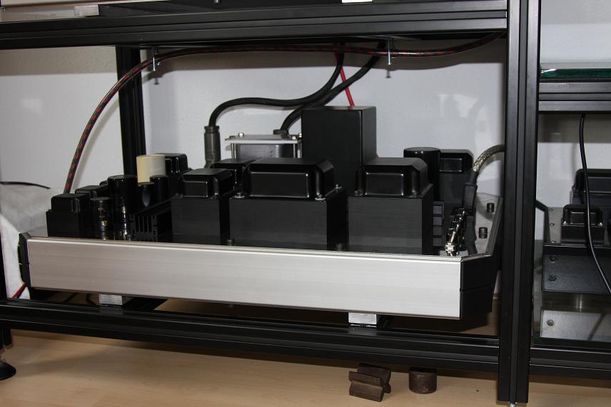

Good afternoon all,
returned from Afghanistan again. And now back to audio !
This means not only travelling to audio-collegues (Gerd finished his 833A....more than interesting !) but also doing my own projects.
One of the "things-to-do" was to get rid of the hummmmmmmmm from the B+ coil in the amplifiers. They hummed; which was not really surprisingly for i'm pushing 240 mA at 1200 V through those 10H coils. Although they were not featherweights (E126X70) you noticed a buzz; and felt it when you touched them. The endbells were of simple metal; way to this....this give already a buzz. And the space between the coil and the endbell was a perfect resonator. This had to change !
1. Coil was taken off
2. a metal housing was made (very tight fitting)
3. this housing was filled with more than 10 kilo of lead
4. coil inserted and filled with 2 component casting resin
5. at the stainless steel stud rubber vibration absorbers were fixed
6. 17.7 kilo.....and there is silence......
Pictures included.
It's good to be back. In the meantime my EL82-triode amplifier is also finished. Works great.
