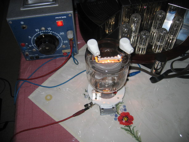

On the pic,u see the 833C heated,and with the cinese Socket,ant top-connectors....

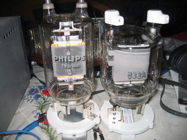

Hi Reinout,
Jippiiieee
just arrived 4 TB3/1000 from France...
They are original? stamped "PHILIPS".....
but i thought,they have Carbon-Anodes like the 833C fro China,but the Anodes are from steel... It looks like Carbon..grey-strukture,but it is ca 1mm Steel...
Is it normal?
the interne structure looks like your tubes..much better than the 833Cs...

TB3/1000 description
Hi Gerd,
no worries with your TB3/1000. They are just as they supposed to be. They don't have a graphite anod but a steel on. i do believe that it is actually molybdenium-steel....but please let me check on that for i have the complete Philips-description of these items at my home.
As you will notice there is no barium getterflash. The getter-function is done by a zirconium-coating on the anode. This is a very effective way of gettering....but expensive to make and not very healthy. It is currently seen as a old-fashioned (but VERY good) way. A remark: the zirconium getter works if it is really heated. So these tubes (like the 100TH, 35TG, 250TL.....and all other larger transmitting tubes) must always be at least have a red-blush while working. If you check out the old guarentee card that accompanies the older tubes you will see the wonderfull sentence : "this device does work properly when a cherrish red glow is visible; it is not a sign of malfunction".
All my TB3/1000's are straight from Philips. I have 2 different stampings. Both have TB3/1000 and PHILIPS. One has a 12V- leadstamp on it; the other a AIR-leadstamp. so obviously militairy stuff;
But again....no worries. The tubes are ok the way you describes them.

Re: TB3/1000 description
Hi Reinout....
Thanks for your reply....now i can come down.....
I also had a look to the Hifi-tunes Website...With your audio-system. REALLY GREAT...
The pics there have high resolution,and i compered with your TB3/1000......its exactly the same tube...
All my tubes have the AIR-Stamp,are new,but not in original boxes...
I changed the chinese-833-sockets...perfect...Heating is great...

TB3/1000 anode material
Hello Gerd,
just returned from Afghanistan........
And as promised i would find out what the actual anode material of the TB3/1000 was. And it was a quite easy search for these Philips tubes are very well described in a classic series of books in the Netherlands "Zendbuizen" (= transmitting tubews) by Ir J.P Heyboer for the Philips Technical Library.
The anode material is molybdene for this can withstand the much higher filament heath. Nickel has a melting point of 1450 C; molybdene 2600 C. Besides that molybdene is quite easy to work with; in contrast to tungsten. There is a drawback.....the price....
Sometimes tantal is also used.
And crosschecked the gettering-item again: also this triode has a zirconium-getter (grey/silver powder on the anode; so NO barium getter-flash on the glass).
