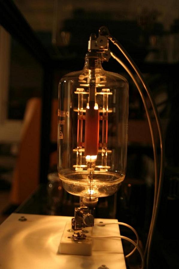

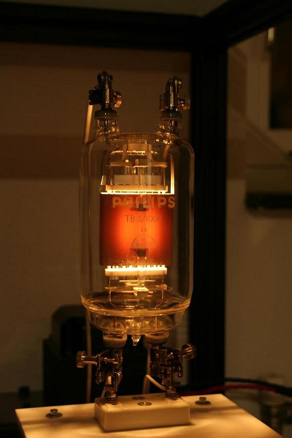

Good evening DIYaudio,
after constructing the 833A-amplifiers (see the thread "where are the 833 amps"; i've included enough pictures and text) which works great i found a whole bunch of old European transmitting triodes.
Philips TB 3/1000
Although the filament is somewhat different to the 833A (12 V / 8 A instead of 10 V / 10 A) the other characteristics are quite similar.
So i changed the 833A-amps to take the TB 3/1000. Why: because the TB 3/1000 is VERY neatly made. Not like the 833A where the plate simply hangs on the top-connector. No...with the TB 3/1000 the structure is made from bottom up. And any expansion through the heat is being taken care by letting the plate slide on glass rods !
See pictures......it works.
And soundwise.....after 5 hours of playing......musical delight.
I'll add some pictures.
The first a comparison picture of a 833A and a TB 3/1000.
Reinout

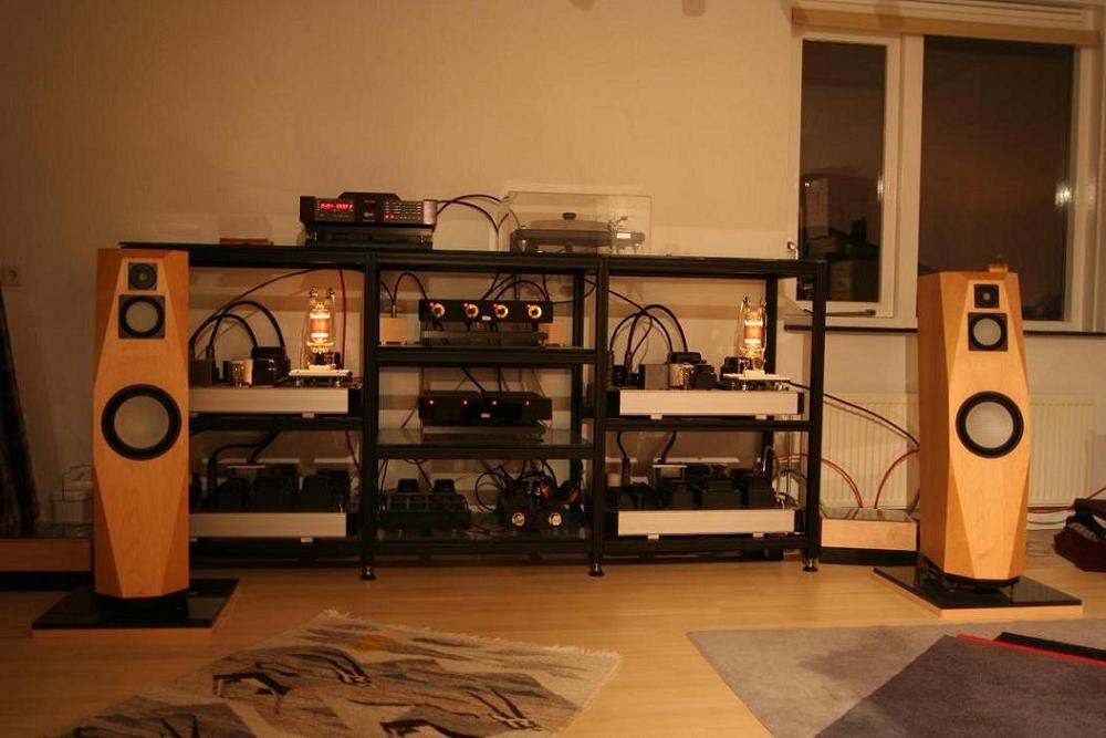

Re: TB3 1000 (2)
Very nice system, congrats! Only one thing. The hard, glass (like?) material under the Avalons (clones?) is not doing them good.
ReinoutdV said:Next picture is the set working.
The amplifiers are monobloks....and their respective power supply is below the amp. The total amp weighs in at 280 kg.
Driver is a 300B.
Incredible looking amps. 280kg is a little on the heavy side though!
With 1000V exposed on the anodes like that, I presume you don't have children or pets! (or not anymore!)

Hi Reinout,
Once more thanks for your help...
OK,i will build the amps with 833C..AND TB3/1000..
I think,i can change te 833chinese-socket tu use the TB3/1000....for measuring and hearing...
the heating i will do for 10V and 12V......
the problem is:i get the TB3/1000 in 3 days....but no sockets and Top-clips......do you have a source to get them?..

You are looking for a potent driver (300b will do nicely). You can have 2 ways op building here: or go for the classical A, negatively biased, high voltage desing.
Or go for the lower voltage, A2 biased design.
seeing the voltages you're going to work with (same as my amps) it looks like a A2 design zero bias. So you're going to positively drive the grid. It works very well but as stated in my earlier post you MUST drive with low impendance. Otherwise the 833 (or other potent transmitting triode) will simply not come alive.
With a 300b you must have a 4:1 downstepped interstage. This will lead to a low 200 ohm driver design.
With a 6C33 you can use a easier interstage-ratio. 4:1 interstages are by definition one-offs. so you have to pay for them (seriously). The amount of milliamperes that the IT must withstand is of course no more than the output of the driver (here i mixed up the 250 milliampers in my earlier mail....that's the OPT-milliamperes).
The 5K-OPT is a beast. But there are options to withstand the ridiculous magnetics here. 1000 Volt and 250 Milliamperes in a standard EI-package will lead to a HUGE transformer. With a grand air-gap in order to avoid the really present saturation. But an airgap is by definition a shortcircuit in you precious transformer. You can cheat here quite easily with a parafeed-design. This coil will take the DC-saturation away from the OPT. So my OPT is a mere EI126 (with minute air-gap in order to quench the last remains of saturation). This works brilliant. Of course this is an extra trnasformer/coil in the powersupply line....but this even smoothen the powersupply ripple. So you gain ! This is a quite standard technique .
May i suggest a 2 chamber bobbin on which the parafeedcoil will be wound. This will bring any RF-hash to XX KHz...out of hearing.
We must meet live for we have too many ideas in common. And i have quite a stash of very good high voltage stuff (caddock resistors, IXYS hexfreds, kaptonfoil, johnsons feedtroughs, etc)

you are right with the dangerous exposed anodes and filaments. But this is how the tube is made. And this triode simply becomes VERY hot. so this means or blowing forced air (lot of noise and the danger of single sided cooling....risk of cracks) or convection heat. the last is standard; it's how i do it. simple with an exposed tube.
But
Because i don't want te be known as the local terminator / death doctor /etc i made a cage around the exposed tubes. This stainless steel cage fits beautifully and has holes to let the warm air escape. the holes are small enough to withstand poking childrens fingers. But when i'm alone and listening.......no cage. this tube is a beauty to look at; especially when switched on.
To be honest: i do have a own audioroom where there is only one thing: my audioset. so it's quite easy to seperate it to the rest of the house. Evn then: when visitors are there....cage in place.
hopefully this will easy your mind and make me look a bit more realistic.
The speakers are Avalon-look-a-likes. self made. The units are Thiel. the woodwork is 6 cm thick at the baffle, 3 cm at the sides. The crossover is a serious affair of Mundorf Silver/Gold capacitors and Mundorf coils.
They stand on a 30 kg blok of granite. not glass ! The bass form these speakers is very good, but without the mass of the granite the bass is to easily transferred into the floor. I do not like that. So the speakers are set on spikes; placed on the granite block.
It works.

Granite is ok. So well polished it may well pass for glass or acrylic in a photo. But you are far more experienced than such😉
Did you use the Avalon voicing as a guide, or only the shape and units?
ReinoutdV said:The speakers are Avalon-look-a-likes. self made. The units are Thiel. the woodwork is 6 cm thick at the baffle, 3 cm at the sides. The crossover is a serious affair of Mundorf Silver/Gold capacitors and Mundorf coils.
It works.
