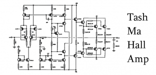

tash ma hall amp
this project is characterized by a high circulating current
especially in the differential input stage

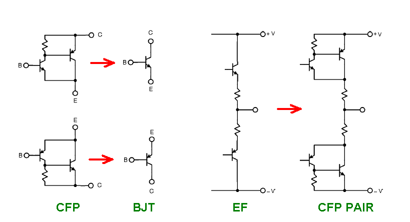

in fact is a current mirror CFP
the next stage is characterized by a bootstrap titpico schema Jeff Rowland
Then the typical triplet EF emitter follower
if you like to use the simulator calculates the optimized values ​​of 35V dual
Thanks😀
normally in the input stage using transistors with low Ic on the natural bias voltage 0.6 V
this method allows to obtain a driving current of the stadium in tension much wider because the BJT PNP has deliberately characteristics of current@0.6V higher
