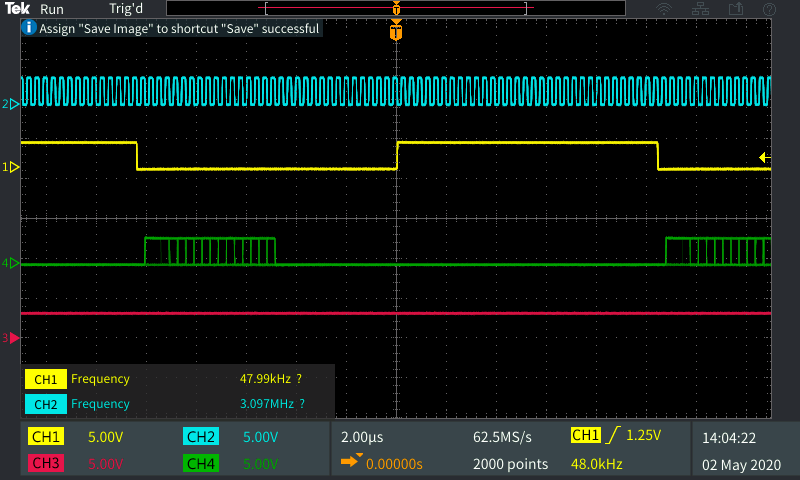

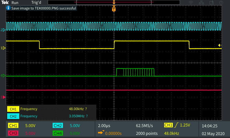

Attached to the post the screenshots of the I2S signals and the !PDN pin. They look good to me, it is a 48khz / 64FS stream, with 32bit per slot and 16bit of useful data. it is a left-right test signal, I also tried to connect another hat with other type of I2S amplifier, they play fine.

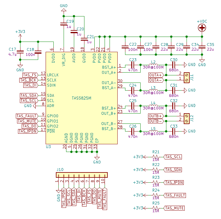

I will remove the output filters and try again if I get something new, I did't use the 10uH coils of the reference design, but some ferrite beads (in the datasheet it was fine for reduced output power). I did't change any settings to take this into account, can this be the root cause?
I noticed the small reference PCB shared by lutkeveld is using ferrite beads too, but he has 1nF capacitors and I have 680nF, as per reference design.
I finally have my PCBs playing audio... my assumption about the capacitor was correct, removing them OCP was gone, and register had right values, using very same sequence.
I put back other capacitors (1nF), no OCP and audio playing fine.
Thanks again for your support!
I was just going to reply that, but you already found it yourself 🙂
680nF is for the LC output filter, the recommended value for FB based filters is 1 or 2 nF
The upside of FB is of course size/price, but the quiescent current is almost double and filtering (audio and electromagnetic) is also much worse. But in some cases the trade-off is okay.

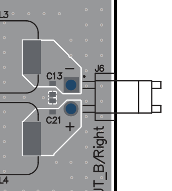

Not too bad actually. For reference have a look at the EVM: https://www.ti.com/lit/ug/slau860a/slau860a.pdf
I would move the middle bootstrap caps a bit more inward, like on the EVM:
Same for the output filter caps, position them a bit more in line between the inductor and output terminal like on the EVM:
And flip the power decoupling capacitors so that their ground side connects directly to the middle exposed pad instead of using a via.
This goes for all GND pads of the TAS, just connect them directly to the middle pad.
Nowadays, 4 layer is barely more expensive than 2 layer. So while it's possible to route the power underneath the inductors like is done now, I personally would just opt for a 4 layer and use a dedicated power layer.
