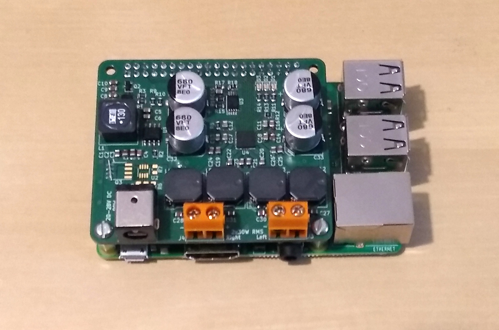

Thanks a lot for the feedback, this was enough to decide myself to build an amplifier based on this chip. I have chosen to build it as a form of an Raspberry Pi Hat:
So far I have only tested it with a 12V power supply, I have already ordered a 24V power supply with sufficient output power. It works and sounds great, it's incredible how such a small chip can output so much power with so good quality. It's a big change from my DAC + preamp + Mosquito amplifier in 19" enclosures for basically the same performances.
The TAS5825M is used with a 10µH/680nF output filter. I used the same Murata inductors as in the EVM. The PVDD power supply is bypassed with 2x680µF + 2x10µF ceramic + 100nF ceramic per channel. It uses a 2 layer PCB board, and the bottom layer almost consists in a ground plane, which I hope will be sufficient for power dissipation. I'll have to wait for the 24V power supply to test that. The 3 GPIO outputs are connected to 3 LEDs, the TAS5825M can be configured to display various information (fault, warning, automute, etc.).
I am used to solder chips with an exposed pad and with leads using a reflow station and flux but without stencil. I have applied the same technique for the TAS5825M, basically as shown there: YouTube. It was however less easy than expected, the surface tension was not so important as with a chip with leads, and thus I had to align it perfectly during the reflow. Nevertheless I have been able to solder it correctly.
The board also contains a 5V 3A DC/DC converter based on a LMR33630 chip to backpower the Raspberry Pi. It also features an LTC4365 DC input protection to protect the board from wrong polarity (as it can happen with this style of jack), under or over voltage. Mouser ran out of stock between the moment I passed my order and it got prepared, so I have not solder that part yet. I'll do that when I receive it in the next days. Finally the board also hosts a 24LC32 EEPROM to meet the Raspberry Pi HAT specification.
I have designed the board using Kicad. In the next weeks, I plan to change a few minor issues I noticed on the current board (like silkscreen, via diameter) and release the design in an opensource license.
On the software side, as an amateur I do not have access to PPC3. I therefore used the Housekeeping.txt sequence from @lutkeveld to initialize the TAS5825M. The chip is capable of way more things, I'll look at that later. Right now I am using a small Python code using py-smbus, but I plan to write a proper kernel driver at some point.

Thanks for the feedback. I wonder if it is possible to add a small heatsink over the chip. It's very thin, so it might prevent placing decoupling capacitor very close to the chip.
It's nice that you have been able to reverse engineer the register map as the TI software is not available to hobbyists (they want a real company name). Is it the same DSP that can be found for example in the PCM5242?
It is recommended to add a small heatsink on top of the TAS5825M especially when using the PBTL mode to drive the fullrange speaker or small-subwoofer. I did that, it turns out to be working better than without heatsink.

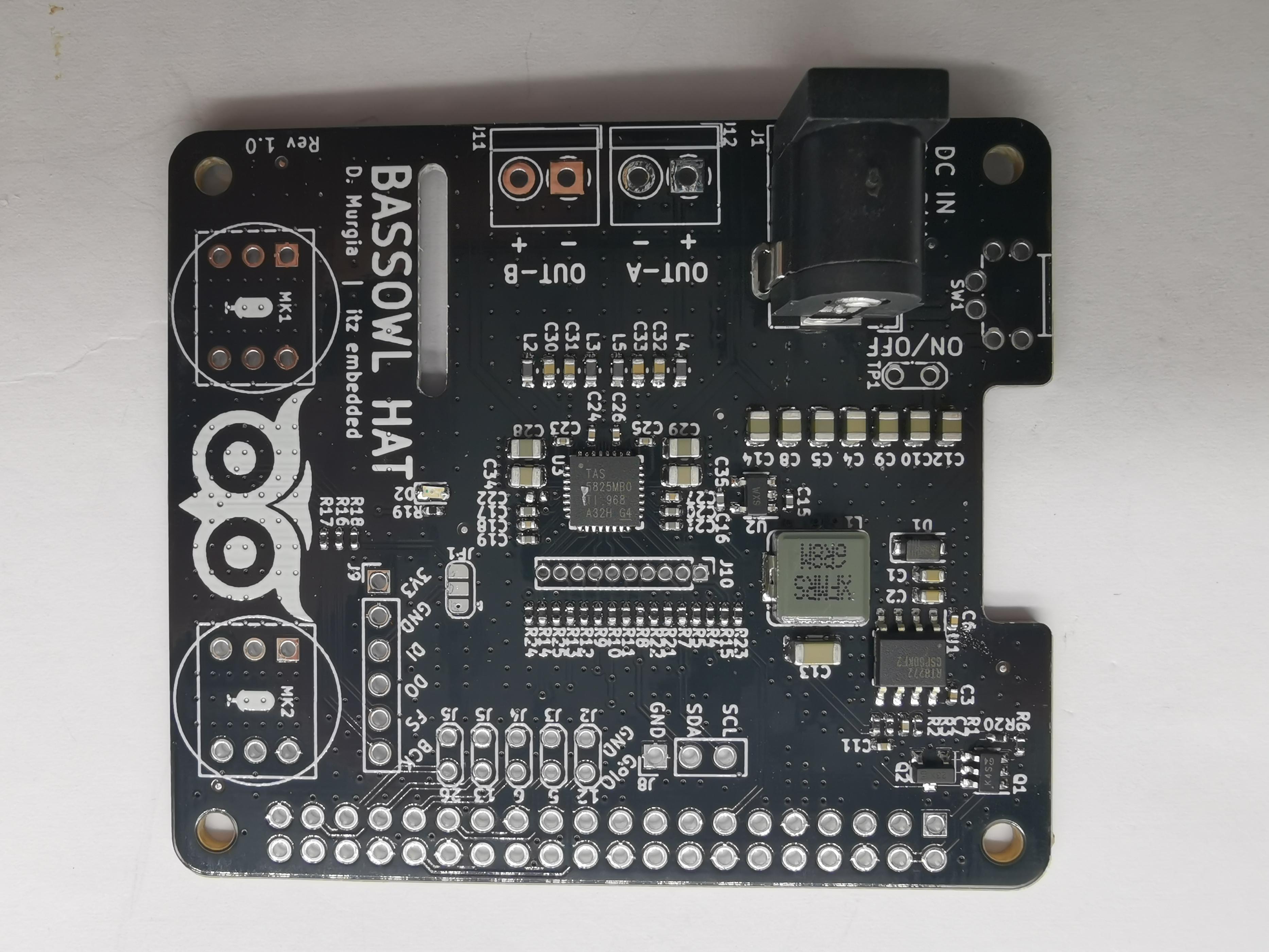

Compared the board I have built, I have only slightly changed the schematic and the PCB: changed some of the devices from the KiCad library ones now that my PRs have been accepted, value changes for the LED resistor, via diameter changes and small silkscreen change.

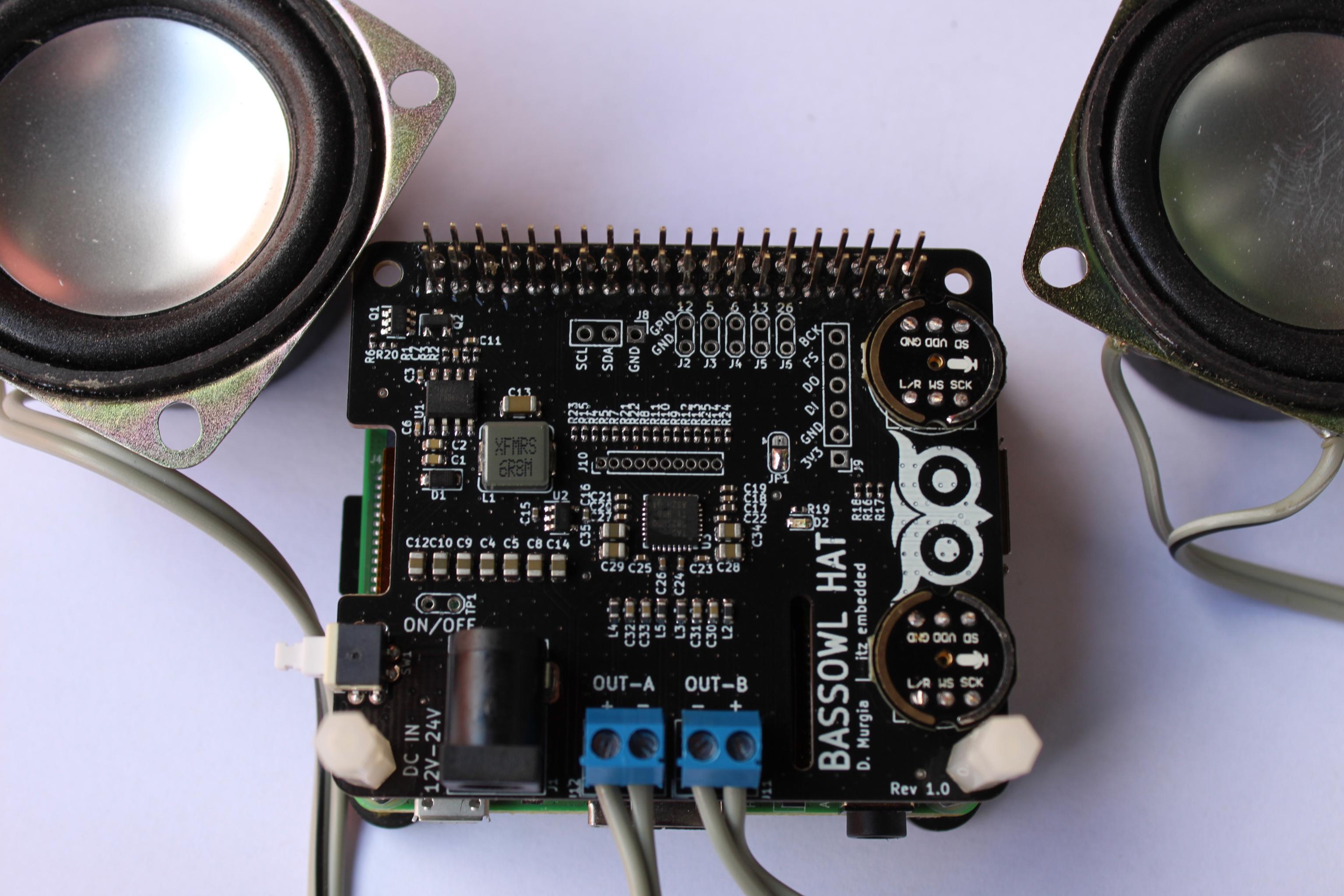

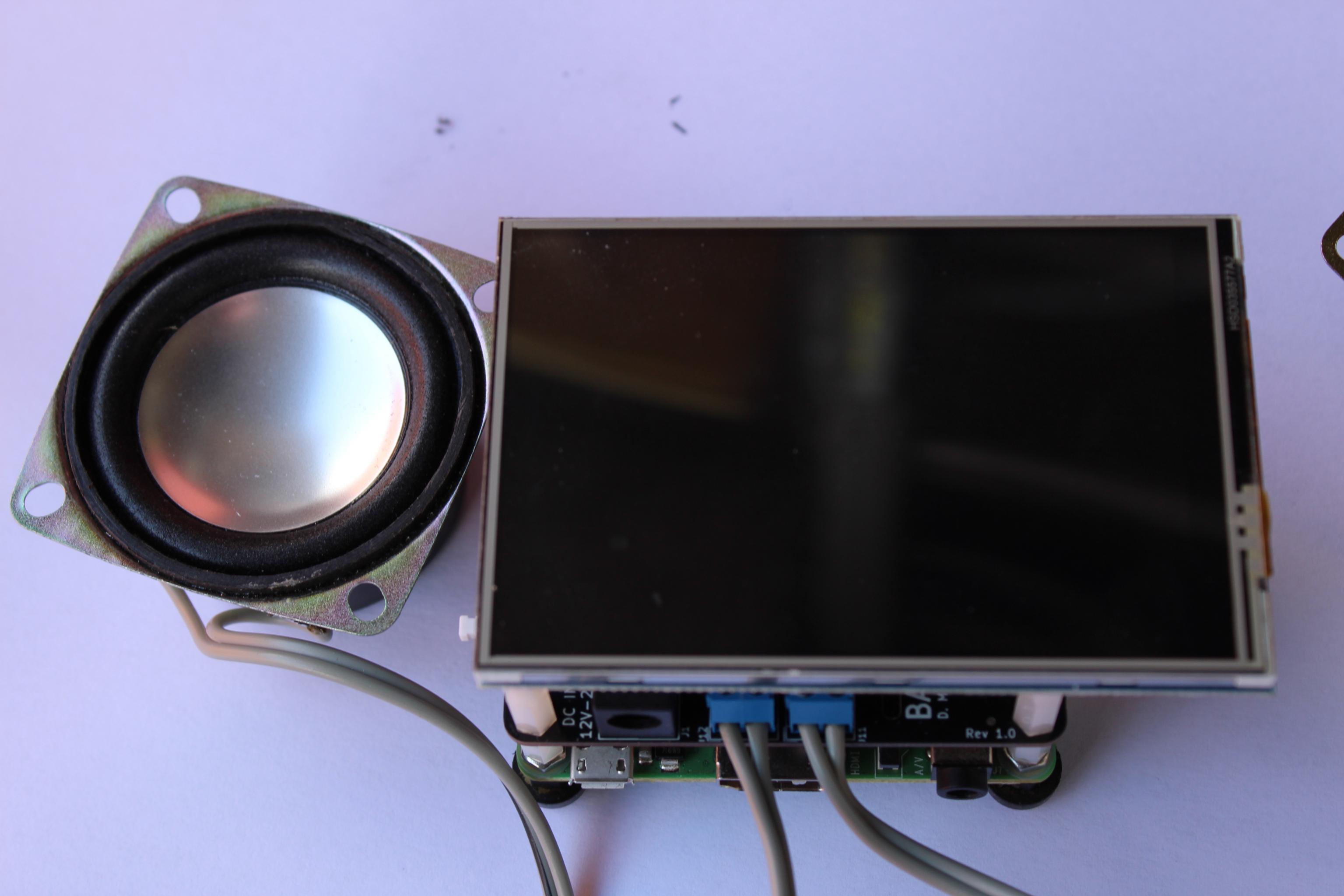

PCBs arrived from China, i'm very happy about the final result!
My plan was to verify the functionality of all blocks, this I did so far
- I2S microphones
- Back-powering of RPi
- 3.5" SPI screen
- I2C reading/writing with i2cget/i2cset
- I2S signals on the test-points, loading a generic I2S dt-overlay
Next step is to play audio. My idea was the following, already tested with other amplifiers:
- Load a generic I2S dt-overlay to provide 48kHz/16bit audio stream, always on
- Start audio playback, to activate I2S signals
- Launch a script with a sequence of I2C writings, bare minimum for playing audio (even bypassing DSP)
I'm missing the last part. I tried to look on the old threads, the attachment is this one is the closest example of what I need, but I can't find where PAGE and BOOK are defined.
I want to finalize the HW bringup before trying to implement a proper linux driver with help from some friends.

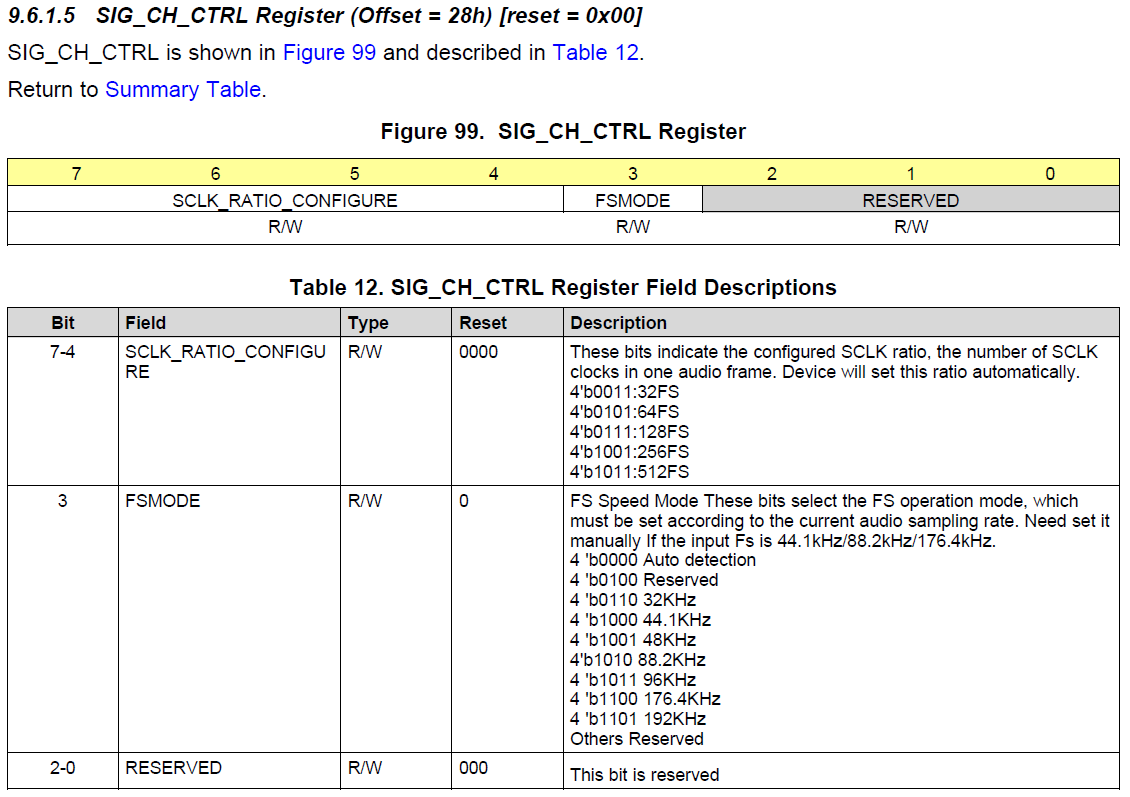

I'm having a deeper look at the datasheet, I don't understand the part attached.
SCLK_RATIO_CONFIGURE [7:4] is used for setting the number of BCK cycles in one audio frame
FSMODE [3] should be one bit only, but then they report 4 bits options in the table... then 3 reserved bits.
it is not even mentioned the corresponding setting of the default value for the first register SCLK_RATIO_CONFIGURE

For a basic init of tas5825m without any signal processing functions the following sequence will do the job:Next step is to play audio. My idea was the following, already tested with other amplifiers:
0x00, 0x00
0x7f, 0x00
0x4c, 0x30
0x03, 0x03
delay(5 ms)
0x78, 0x80
At least I would set the again in relation to your used power supply voltage to avoid clipping.
