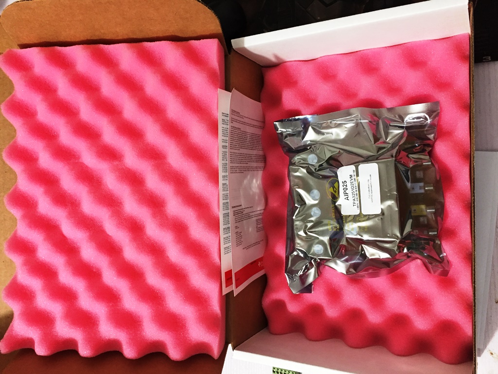

we get PurePath™ Ultra-HD Analog-Input Class-D Amplifier chip and EVM from TI company some days ago, we will test it and make one new version SMPS +class D all in one module soon.
Maybe TPA3255 have good performance than TAS5630B

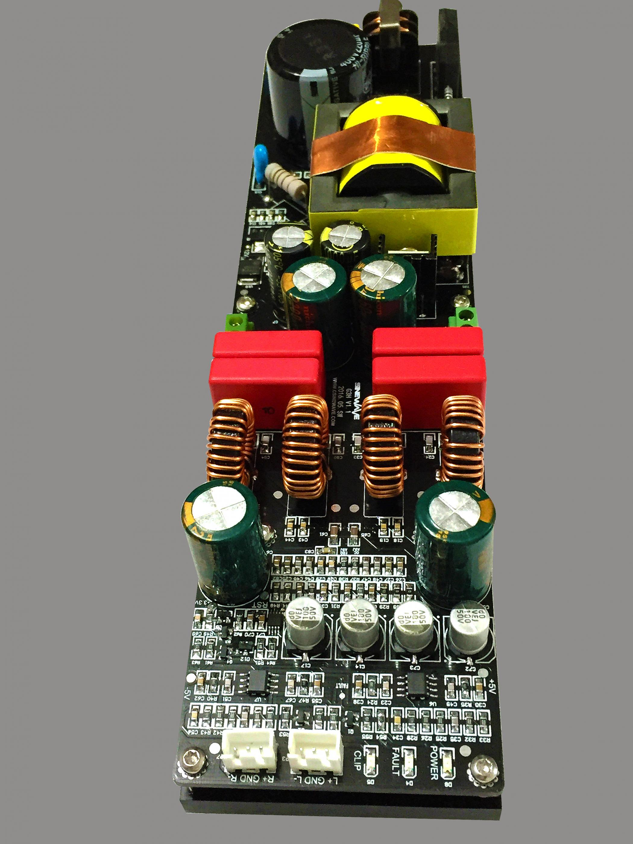

TPA3251 amplifier module complete, Ultra Hi-Fi version!
Sinewave complete the Highest class D amplifier module G3H now,Applied Ti company latest 600KHz PurePath Ultra-HD CLASS D chip TPA3251.
CLASS D AMP and POWER SUPPLY all in one design, three M3 screw bottom assembling easily
15mm thickness whole high quality aluminum block milling to perfect heasink, very good heat dissipation performance.
Wide range AC power supply, 100Vac-265Vac 50Hz or 60Hz

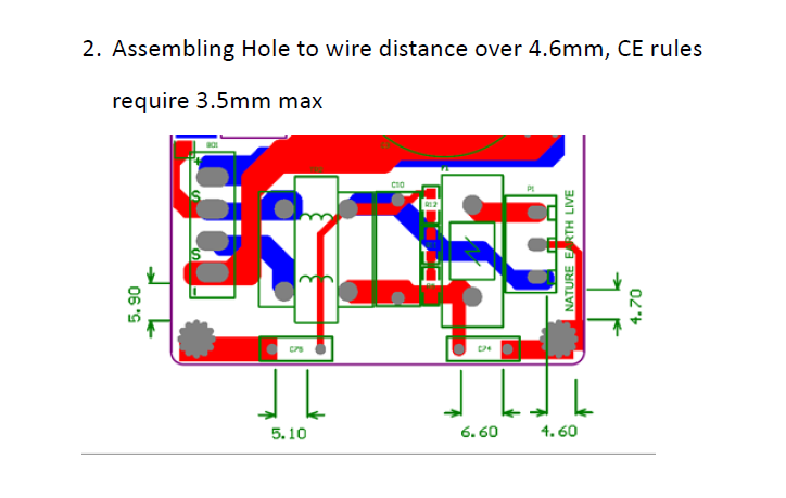

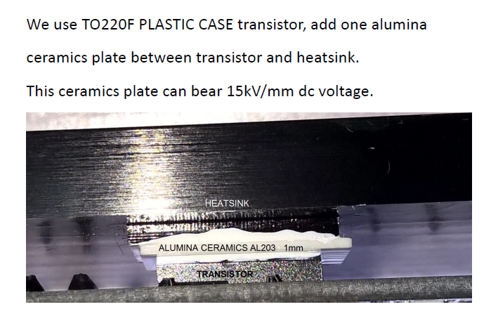

Reinforced insulation design, In line with CE rules.
The SINEWAVE G3H is fully integrated, intelligent audio power conversion solution designed particularly for highly competitive consumer and professional audio products.
IT IS HI-FI DESIGN WITH PurePath Ultra-HD CLASS D AMP
TPA3251 is a high performance class-D power amplifier that enables true premium sound quality with class-D efficiency. It features an advanced integrated feedback design and proprietary high-speed gate driver error correction.
This technology allows ultralow distortion across the audio band and superior audio quality.
The device can drive up to 2 x 175 W into 4Ω load and 2 x 220 W into 3Ω load and features and 2Vrms analog input interface that works seamlessly with high performance DACs such as TI PCM5242. In addition to excellent audio performance, TPA3251 achieves both high power efficiency and very low power stage idle losses below 1W. This is achieved through the use of 60
mΩ MOSFETs and an optimized gate driver scheme that achieves ignificantly lower idle losses than typical discrete implementations.
SMPS unit and class D stage have perfect protection each, so the constant running performance well. class D stage have additional DCP/OCP protection, works stable at some worse conditions, input signal have hardware dynamic limiter and support balance signal input, very better S/ N performance .
The SINEWAVE G3H module is EMC and safety approved and the “black-box” completeness allows for fast designing and minimized time to market.
Fixed BTL setting, user can not change working mode, due to better protection under BTL mode than SE mode and PBTL mode.

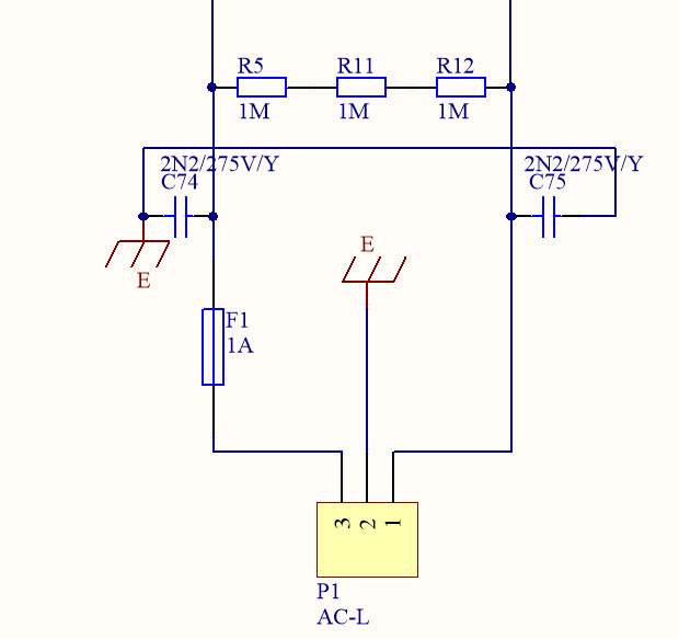

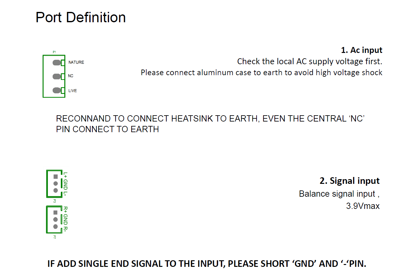

I get this module but so far can not even power it on.
SMPS power supply tripping the circuit breaker in my room.
AC connection is different in documentation and your picture.
Which one is correct?
Also it has balanced input. Do I need a converter?

Hello, emedia4u,
Our technology made one drawing of the ac specifications just now, attach here. please check.
this module have very good SMPS unit, this unit can boot from 40Vac 50Hz,
module shuntdown when the AC supply voltage down to 15Vac,and it can reboot when ac voltage up to 36Vac.
we test it under music playing and speakers connected. module run under light power out conditions.
Even you can add one 60Vdc to the AC input. the module run ok too.
if you meet room circuit fuse break, please check the ac input schematic, maybe you connect the ac input wire error. shorted in some point.
it is balance input, you can use one good convertor from SE signal to BAL, or you can connect '-' pin to the 'GND' pin directly( input port P3 and P7).
Usually, you can not make this module fault, even you add peak input signal, or shorted output ,it is hard design.
if you find this module have problems indeed, please return the module to us, we will check the reason and replace one new for you.

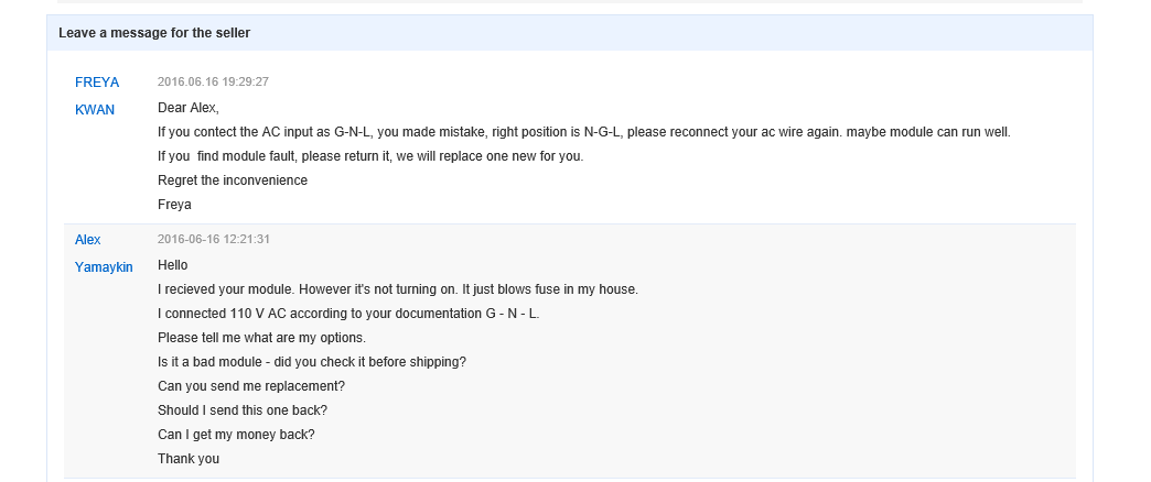

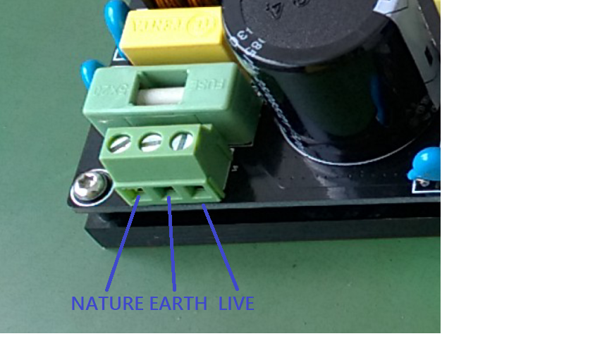

Our sales send your problems just now, we found you made mistake to connect the ac input wire.
attached right drawing below, please remember.
if you find the module, fault, please return it to us ,we will replace one new for you.

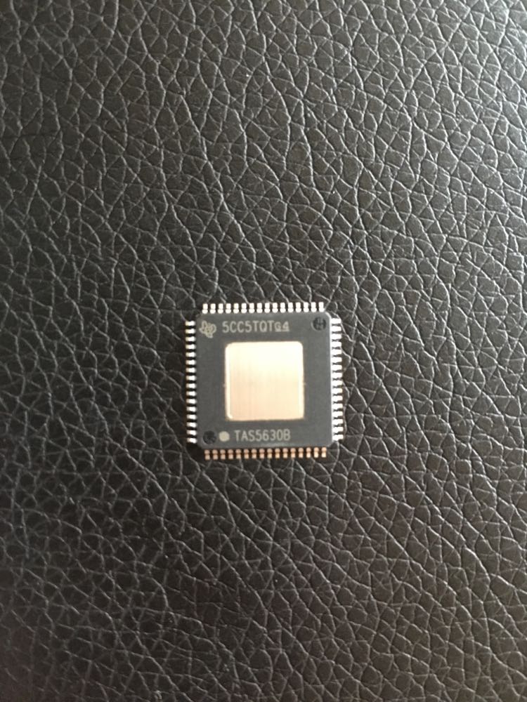

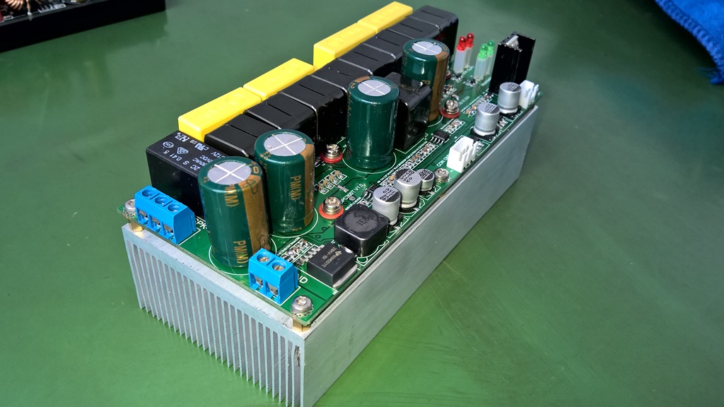

TAS5630B PERFORMANCE WELL NOW
we make one 1+1 backup amp for the high railway broadcast application, due to 48vdc supply on the train, we select TAS5630B again, in our mind , this chip unstable in the last version, but we think TI have revise the chip BUG year ago, we want to try it again.
We order some 15+ produced chip, we found current version chip works very well at PBTL conditions.
it can delivery out 45V/4ohm=506.25W , about 10-15% THD+N, shorted the output under this conditions, perfect protection, long time continous runing , no problem too.
switch to another tas5630B channel, works well too, if solder 2c mark tas5630, chip burnt when high power out.
We have burnt lots of tas5630 chip, 2013 version tas5630b have bugs too, we have not use this chip for a long time. but current testing so good, TKS for the TI eggineers efforts.
Thank you for the schematics of AC circuit. It makes it all clear. Documentation is incorrect - it should be marked as all AC connectors N-G-L or better yet you should mark it on the board itself like you did for other connectors.
The board is working now and the sound is very good - very balanced, transparent and natural. The only small concern is that CLIP LED is blinking even with a 1/4 of the power level. That means THD is more then 1% as far as I understand.
To make it truly universal it would be nice to add couple DRV134PA chips for unbalanced mode. Also you already have +12V on board and will be nice to have -12V for external modules like unbalanced converter or preamp.
Other then that the quality of the board and sound is great!

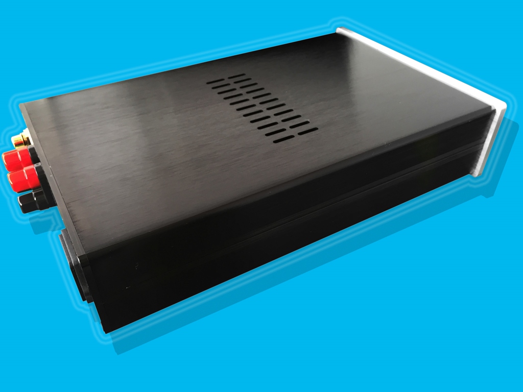

G3H AMPLIFEIR WITH MINI ALUMINUM CASE COMPLETE!
G3h have good reputation and stock shortage now, some customer ask us to make completed amplifeir with mini aluminum case, we do this amp now!
