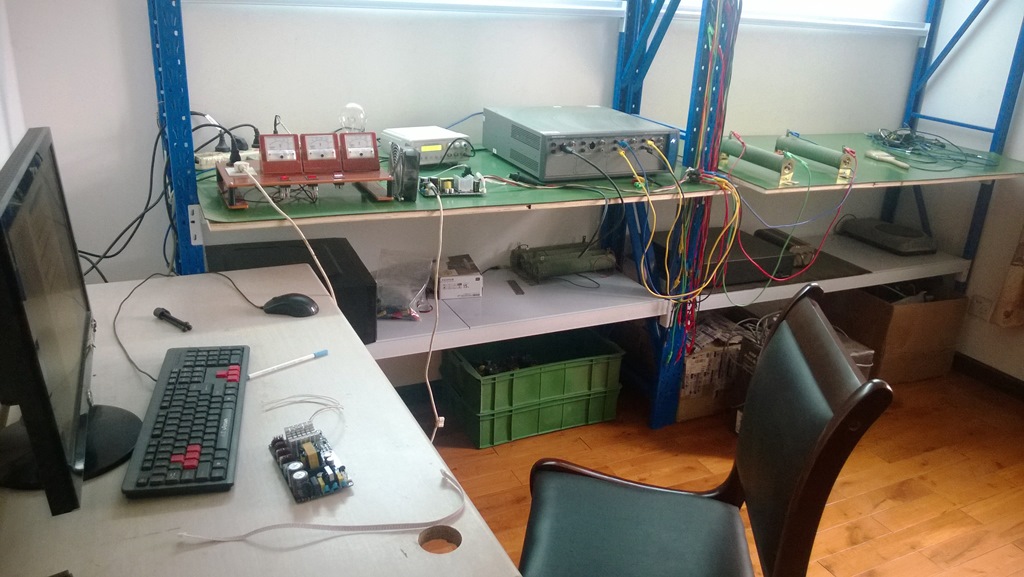

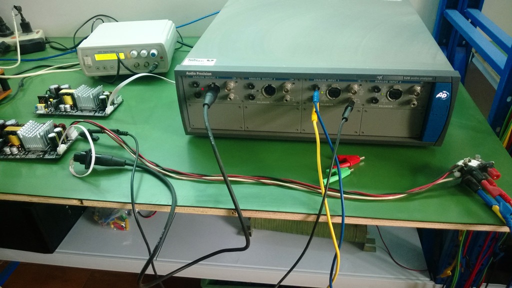

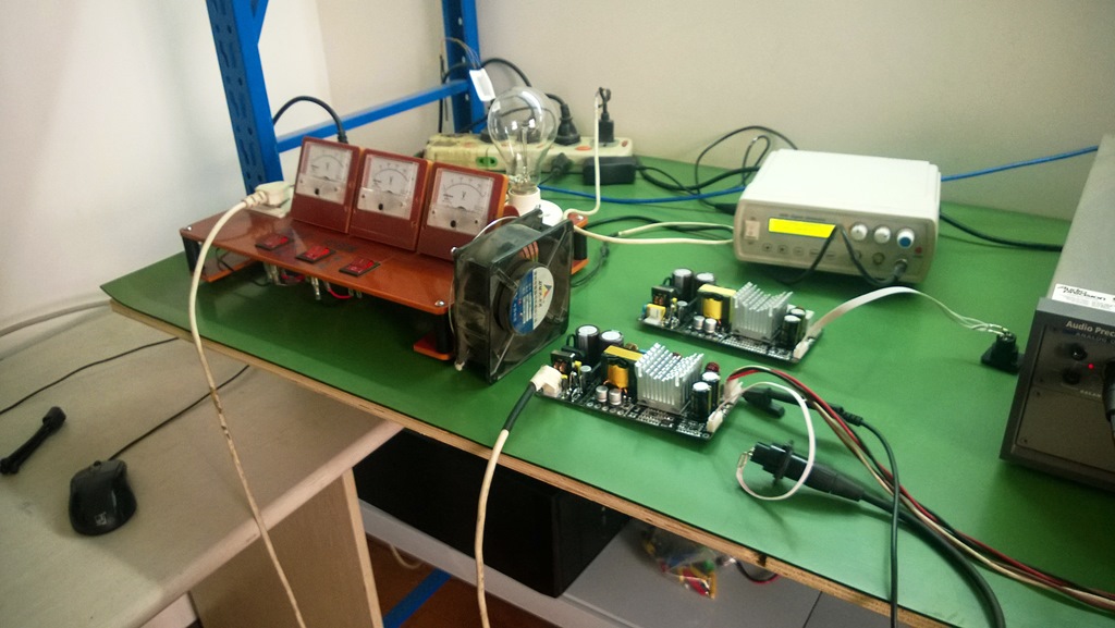

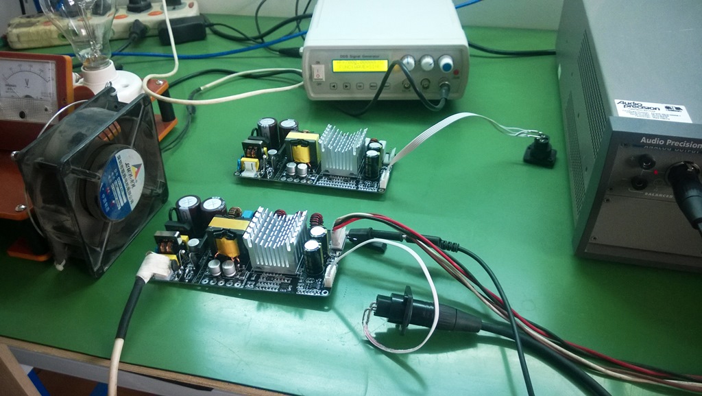

All the batch products pass our strict testing, Proamp products pass AP tester measurement and 6-24hours full loader testing.
About you ordered one sample, you can add one dc brushless fan in your case ,you can find most of the simliar products online do it like this, we only provide module, not completed amp with case, your case should have fan cooling space.
It is simple technology, if you have not fan and you canot order it in your local, you should ask one from us, we will help you get one.
we test g300v33 without any SMPS chip heatsink at full loader, only add one fan cool side, works well,you can find it in the no.1 photo
some tester photos here, please check.
on line test , we use special fixture to test output shorted protection over loader protection easily. it is common technolgy,where is the junk?

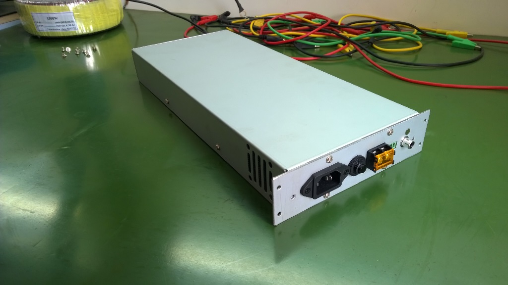

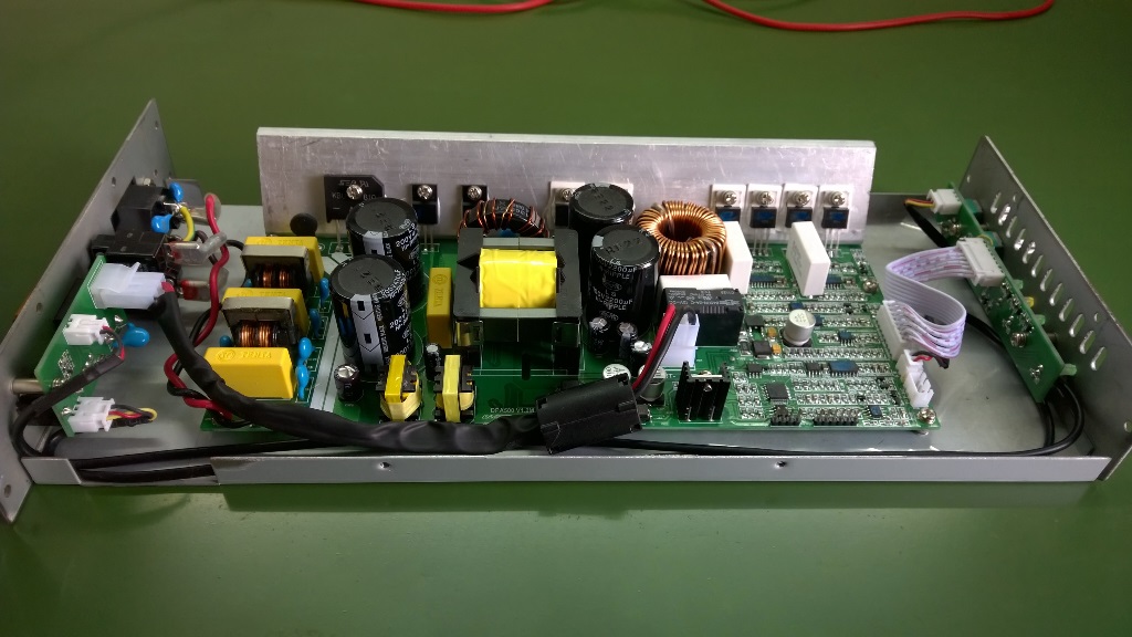

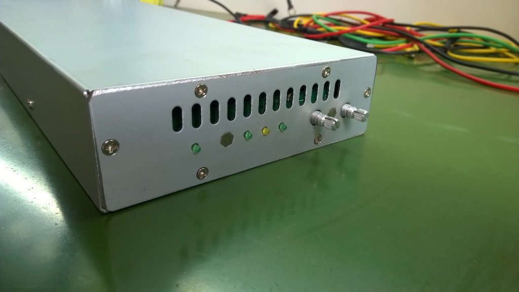

500W rms 100V Output Transformerless Amplifeir Testing
Our new 1U height 500W rms 100V Output Transformerless Amplifeir Testing now, take some prototype machine photos from our lab just now.
Dimensions:
(Body) 348mm(Length)X148mm(Width)X45mm(height)
(Rear Panel) 174mm(Length)X45mm(Height)X2mm(Thickness)
Features:
1.500W mono PA amp, RMS power @ 100V transformerless output
2.220V or 110V ac supply selected
3.1u height
4.Self test function/auto self test function/report amp status to RS485 .
5.RS485 remote standby and mute function.
6.Perfect protection function, High stablity

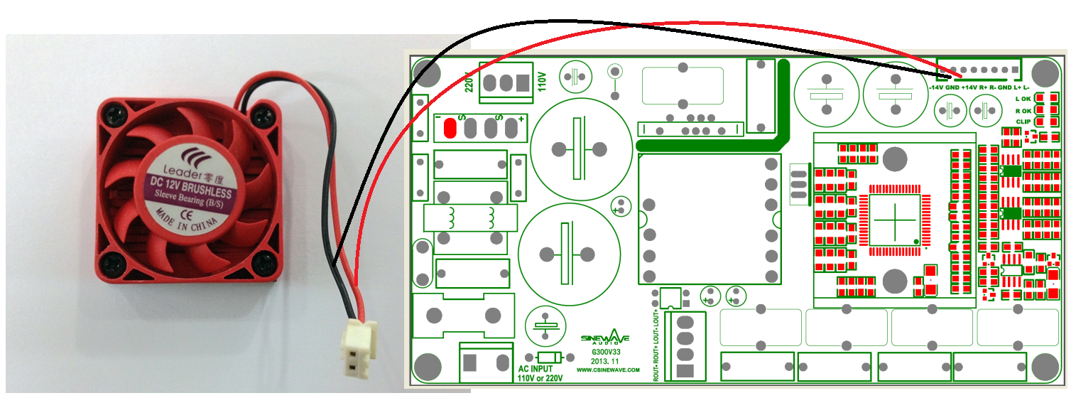

First you should know some technology, if you don't know only a little audio amp technology, let's tell you below:
Only two step necessary.
No.1 add one 12v dc brushless fan red wire to' +14v' connector pin.
No.2 add this fan black wire to 'GND' connector pin
No.3 if you fan not work when power on, please check this fan good or fault.

if you use 12v dc burshless fan with this board, and find noise bigger, please check the fan defalut current and series one 2W resisters in the middle of red wire, resister value from 1R-10R, you can test it and calculate it according to the ohm's law. usually you can find the default current in the fan mark.
If you use 24v dc brushless fan, you can add positive to '+14' and negative to' -14', 2w resister necessary at this conditions, of course u can calculte it with above conditions.
if you can't calculate this with your conditions, please let us know, we will simulate here and take some photos for you.

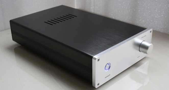

1. You ordered amp is completed amp with aluminum case, not module only
2. It is custom-made amp with aluminum case base on the G300V33BTL module, not original G300V33 module. We only make one simple for you so far. this aluminum case smaller than G300 amp.

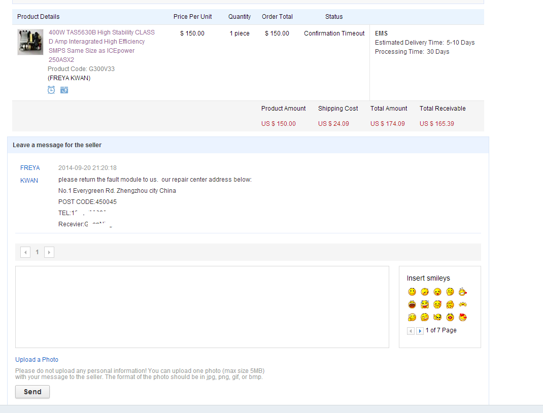

Aliexpress record you ordered one g300v33 amp module ,but our stock record list one completed amp, you change your order in the message and pay us addtional money by paypal, so there are no change in the Aliexpress.
Please return the fault amp and we will send one new for you, we will bear all the freight.sorry again.
