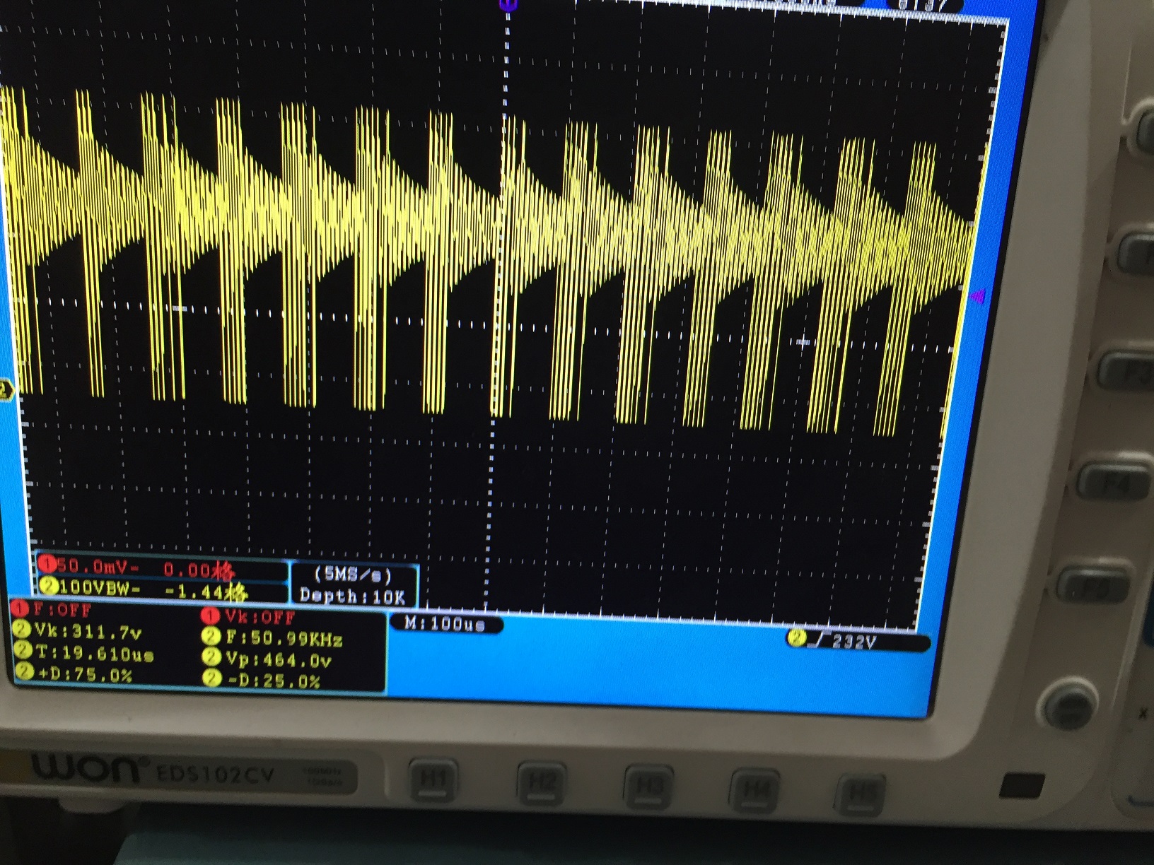

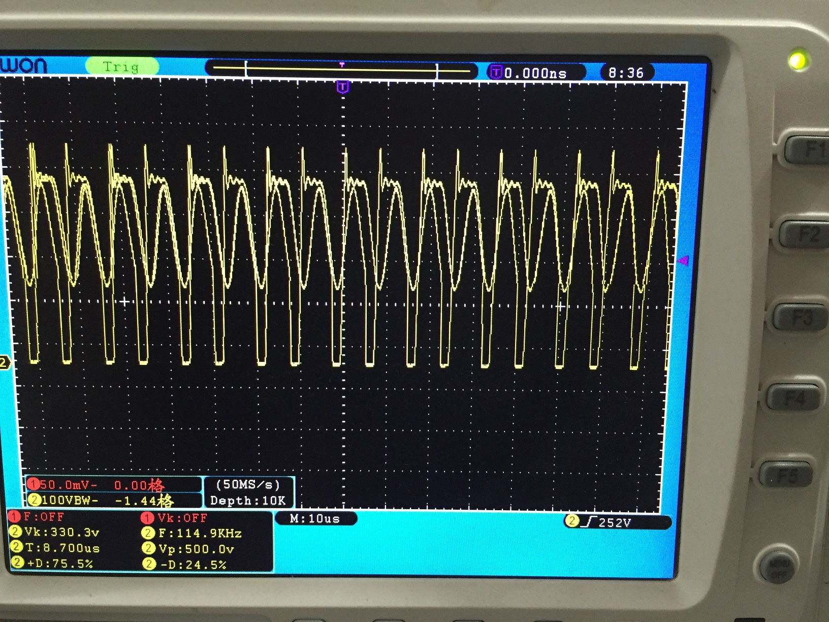

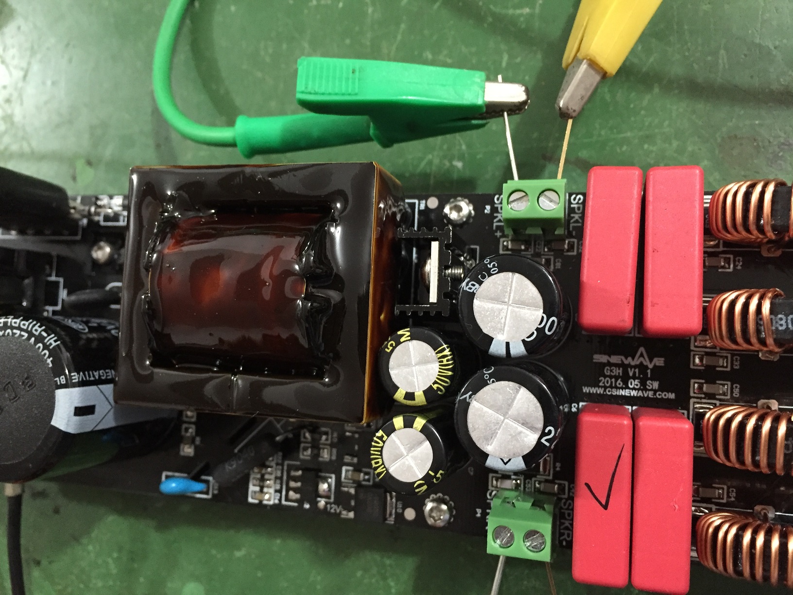

Problems:
1) transformer have very small chirp noise when standby
Reason:
1)SMPS unit run in burst mode to save energy when standby, burst frequency below 20Khz, so transformer vibration can heard,it is transformer core vibration noise, not signal noise.
Solution:
1) Ferrite core firm bonding at the interface, and use resin encapsulation.
Result:
1)After strong processing, transformer chirp noise decrease to very low level, even put ear to the transformer, only hear very small chirp noise.

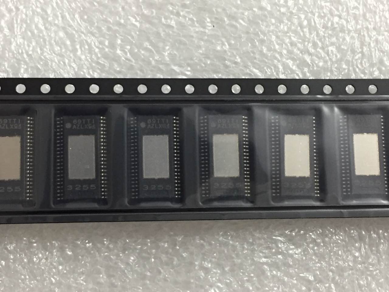

Any update on TPA3255 version? Is the resin just for testing purposes or will it be like this in the final product?
TPA3255 board testing now, we will sell this module when we find perfect way to batch order this chip, we only have some sample now.
I see. How is the performance as compared to TPA3251?

I have just recieved one of these amplifiers. I have very very loud pitch noise. It does go down after some use. I have asked for a new module via aliexpress store, but get the answer that the module is fine and meets the specifications, and I'm told to just send it back.
I will rather keep the amplifier (I have already paid customs handling fee). Can I make your modification and how?
But, even after a while of playing, some noise is still coming from the PSU. I still consider it to be a fault, since I don't have that noise in any other amplifier I own with SMPS PSU (I have a lot)
I have the first generation of G3H and the transformer shows some noise. I tried it with plastic spray to bring him silent but with only limited success. I'm now in China and bought via Taobao a second module, hopefully second generation and am curious how it will behave when I will test it next week at home again.
I just bought my amp (finished version), and of course thought it would be the version without noise. They do not tell on the aliexpress store, that this noise is present.
I have to turn off the amp if it's not in use. They will only return the price of the amp, so it's way too expensive to send it back to china. I will try to kill the noise myself.
Maybe Sinewave should sell amplifiermodules only - I mean without noisy PSU's.
Hello, Kjeldsen, you can return the problems amp to us, and we will replace one new for you , of course you have to bear the shipping cost , you know it is Aliexpress policy .
Our produce line have processed the ferrite core to decrease the burst noise when amp standby, it is very small noise when standby, if you order completed amp, it should not hear the noise.

TPA3255 AMP COMING SOON!
According to the experiences on TPA3251 amp module, we have to delay the time of TPA3255 amp module to market, we have to find more guys to try this new version module ,and give us more idea to improve it, then we will push it to the market.
We find lots of suggestions after our new module on market, even we have paied more attention when develop this new module, it is small chance to make it perfect first time, but our customers need perfect products as their ideas, so we have to pay more care and get more suggestions first.
